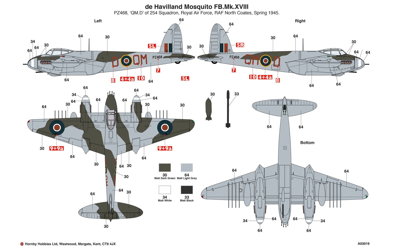

Not many people know this, but the best fighter-bomber of WW2 was the De Havilland Mosquito. Twin Rolls-Royce engines aka "drivers" and marine plywood construction. Sounds unlikely, but there it was.
Light and rigid airframe, albeit with a tendency to crack and shatter if landed heavily. Bit like his big Monitor 40 3-way loudspeaker:

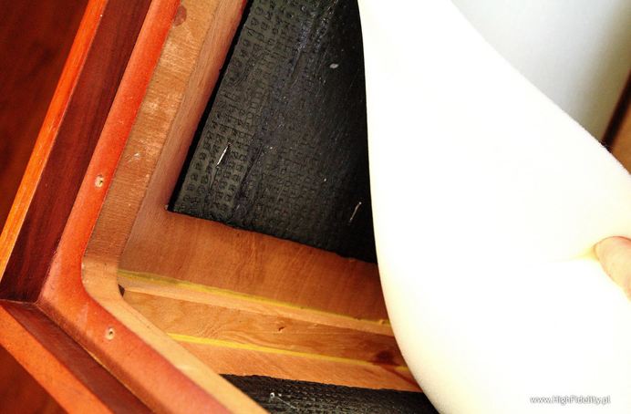

Most everything you need to know about lossy cabinets in one picture. The reason the front baffle is screwed on with a bit of rubber strip damping, rather than glued is the "cracked bell" idea. A cracked bell doesn't ring too well. 😎

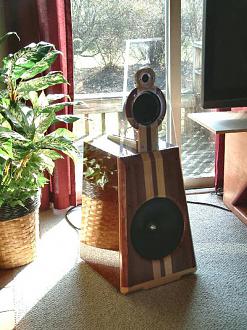

Some questions arise..
At which point (stiffnes) would you consider speaker cabinet walls as another effective mass (spring mass system) and worth the time tuning its properties considering its non-linear stiffness coefficient?
For higher frequency duty, do the walls need to have highly conductive properties? Is inner damping even wanted?:
It is perhaps possible to tune the side walls of a cabinet in a way, that it radiates sound waves to cancel/smoothen diffraction patterns radiated by the front baffle edges? Would something like that function at all, accoustically speaking, and if it does: would side mounted drivers be a more efficiënt approuch for someone as simple minded as me?

The general public have become so accustomed to hearing the box resonances that are present in the the majority of affordable commercial loudspeakers that they regard the sound they produce as normal.
Although open baffle speakers may be regarded by the majority as being lightweight in bass reproduction, their aficionados would describe box speakers as sounding blurry and coloured by comparison.
Could a mix (boxed/omnipole bass, dipole for the rest) be considered serious? Or does combining the good result in bad?

I think I am right in saying the main benefit of lossy cabinets is the lightness and rigidity, which pushes cabinet resonant modes higher up to say, 300Hz, where they can be damped effectively.
