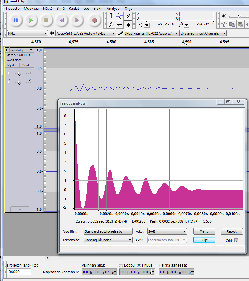

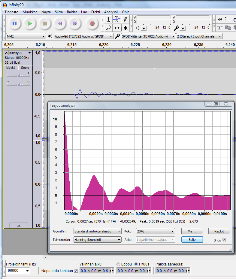

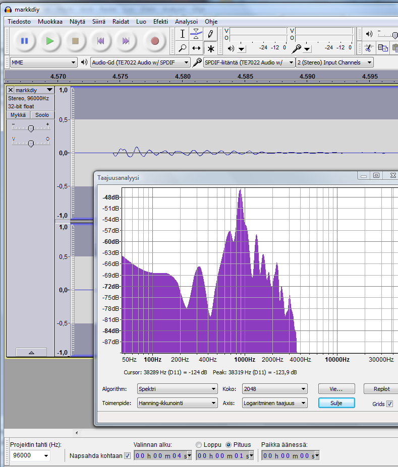

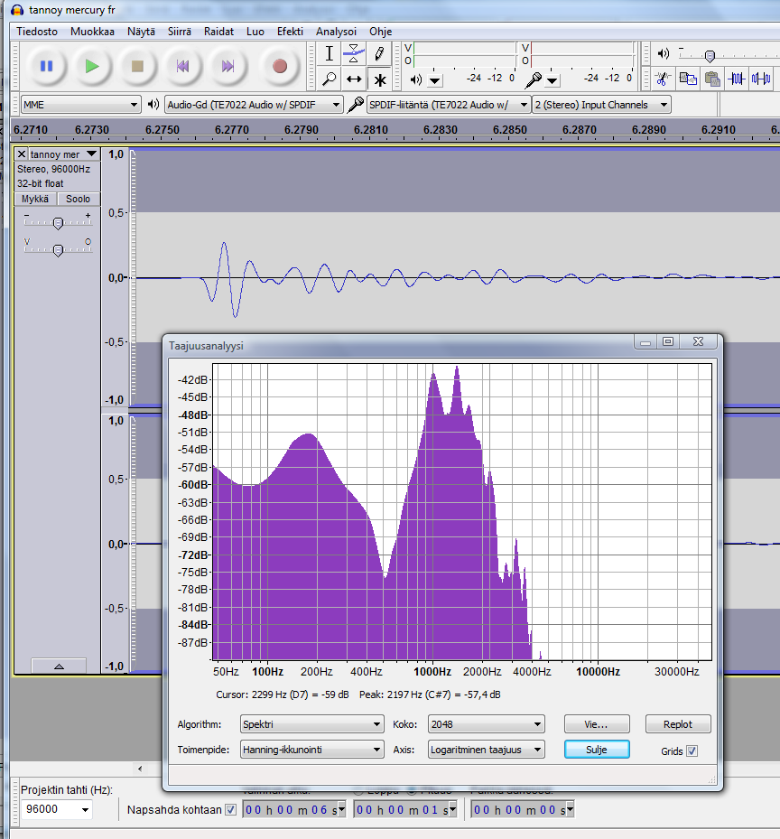

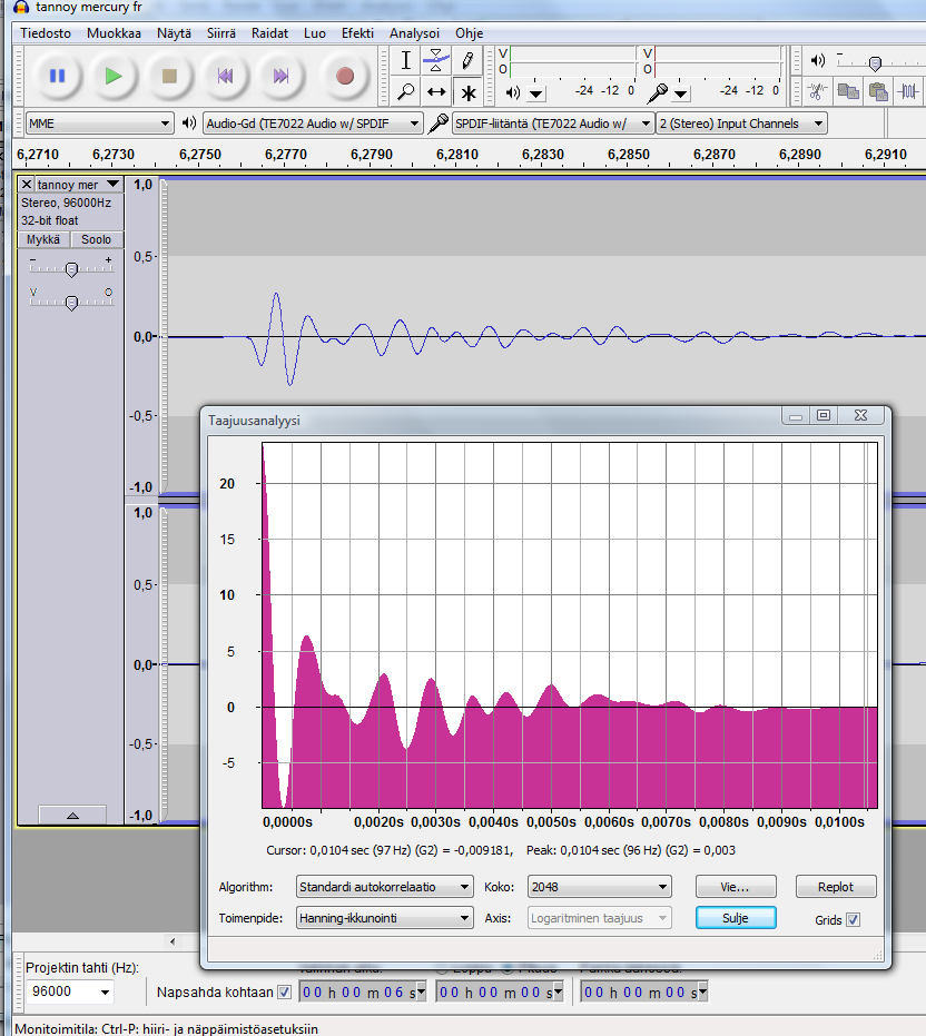

Different finished speaker cabinets measured wit Zoom Q3
Factory-made Tannoy Mercury FR (LDF 9mm, 3Liter BR, no braces,additional stuffing)
Factory-made Infinity Alpha20 (MDF12mm 12liter BR, no braces)
DIY ZaphL18/MarkK ERD18DXT (MDF 25mm 14liter BR, braces, moderate stuffing
