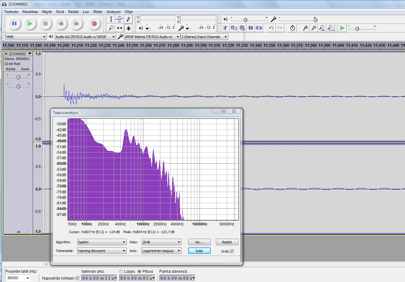

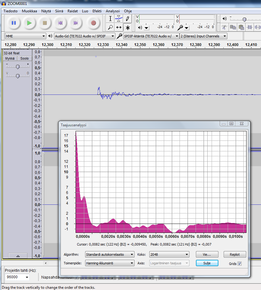

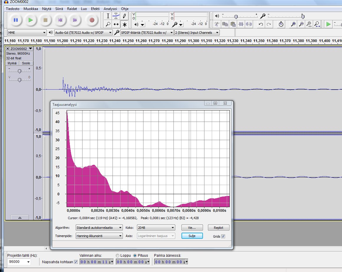

I'm about to make a new sub and I just got the panel sheets today. I made some knock-tests on different materials just of curiosity. I'll make more measurement as the project goes on.
Sorry the scales vary in graphs. Pay attention to dominant freq and ringing
The thread of my sub here http://www.diyaudio.com/forums/subwoofers/223960-bench-style-cabinet-subwoofer-2x15-closed.html
Method:
sheet of board held hanging in air with fingers
Microphone 10cm from the board on the opposite side of knock (knuckle)
Apparatus Zoom Q3, software 2.01 Gain L 24/96600Hz wav-format
Analysis Audacity 2.0.0 Windows 7 64-bit (program 32-bit)
Spruce plywood 21mm 42x104cm
MDF 25mm 40x85cm
I don't show all measurements but the size of the sheet makes a big difference.
