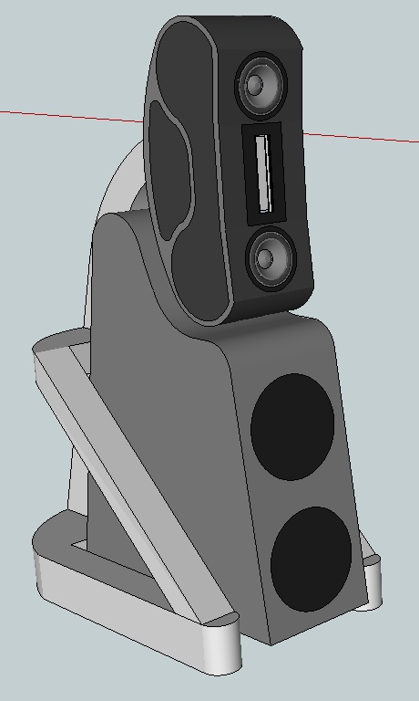

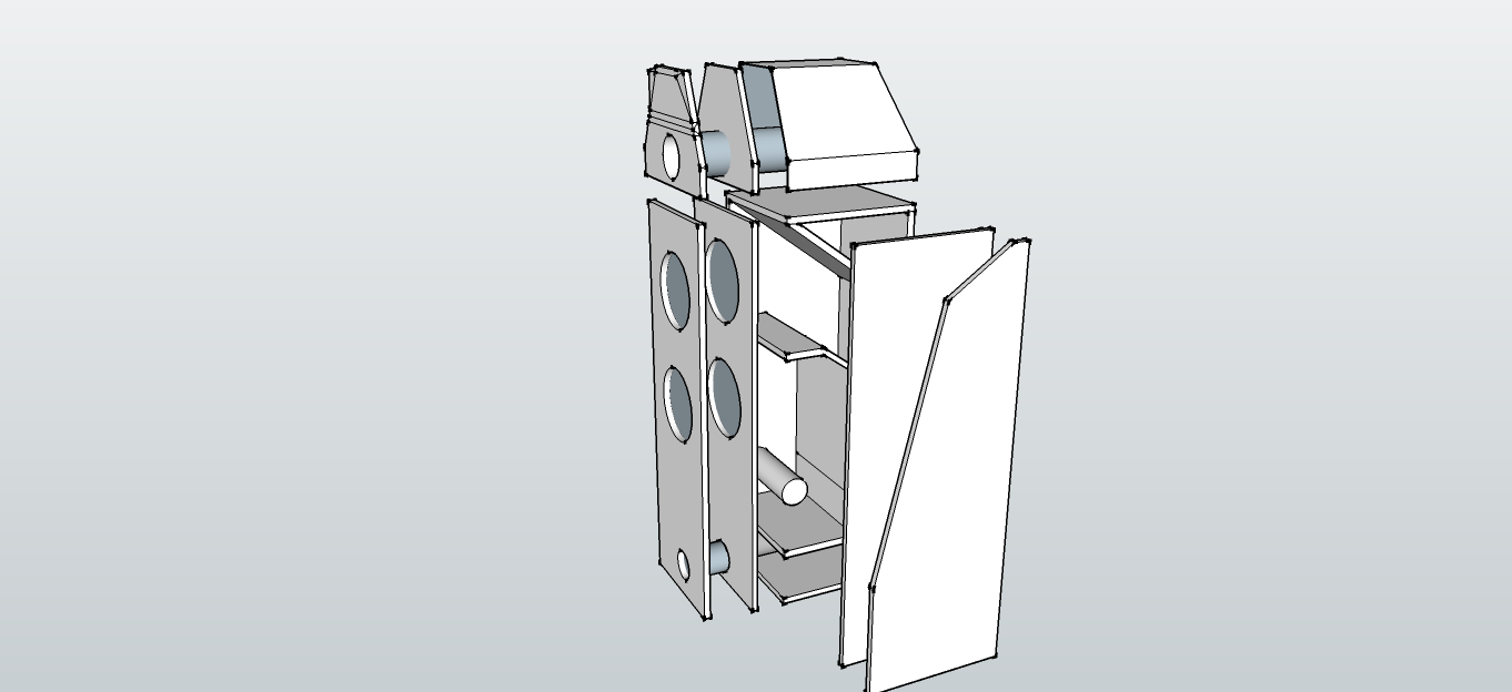

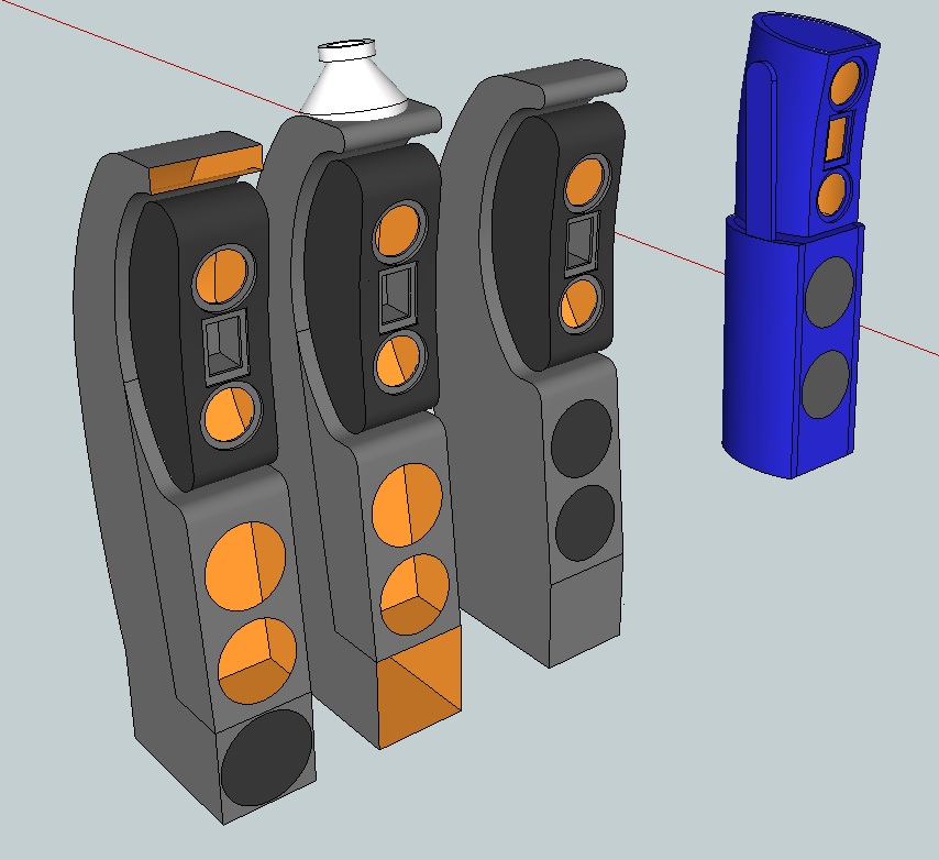

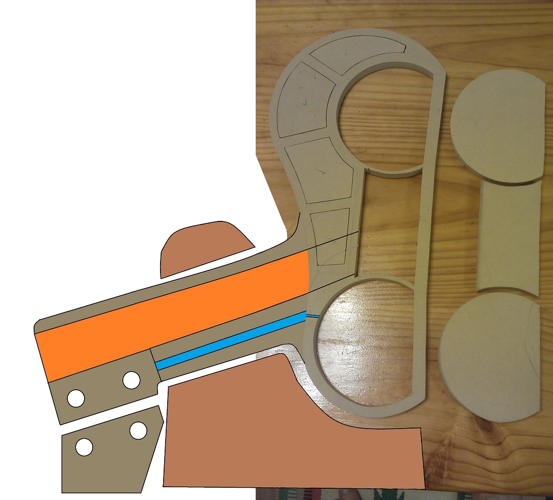

I have done various iterations to get to here... It was when I put the arms on the stand to better support the top speaker that I realised that I had inadvertently created a design similar to the ugly CD rack and had a great laugh since I hate it so much.
This version was called the "Jelly Bean" but I want something less symetrical so I started thinking about a question mark ? / face, so this version is called QMII
The other pic was just a couple of early thoughts.
Also solved my port problem... I will incorporate the port into his neck, which will also carry the wires and form part of the stand.

That first design is probably the koolest and most original speaker I have ever seen. GJ!! I want a pair!!! and the second picture has some kool ideas. If you build the the one in the middle you better choose a beauty of a woofer for that infinite!!!
I may still go with the arms and legs like that... once I have the head done the body will be done to suit.
Just playing in paint with the neck a bit more...
With the tweeter off to one side and the mids off to the other kind of has a Picasso feel to it.

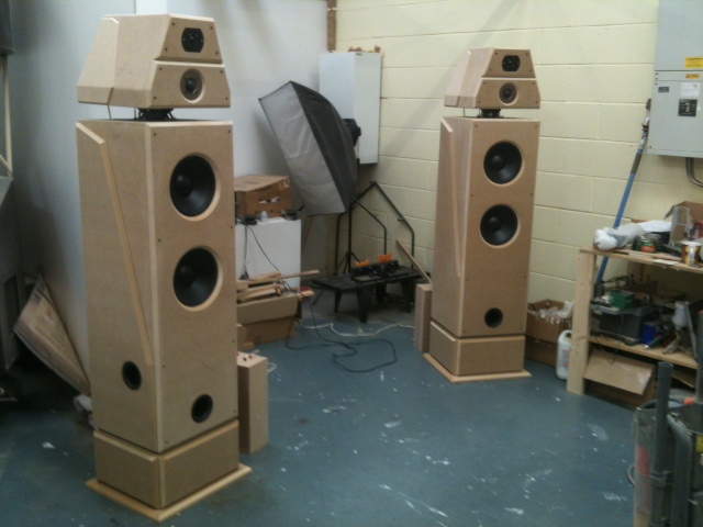

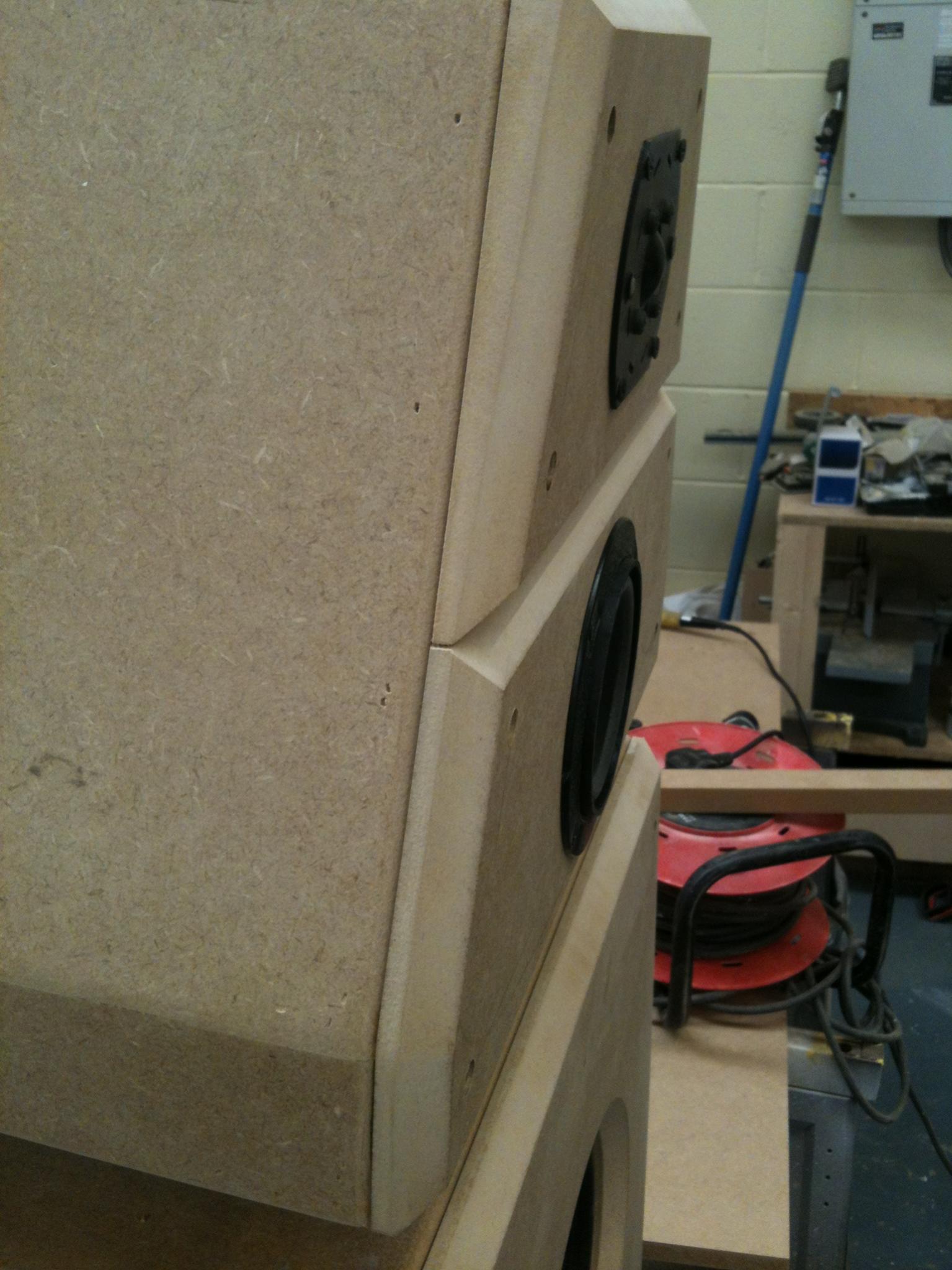

Take a look at my design, only took me 4 months and careful planning, the tweeter is angled downwards mainly because they are just over 6 ft so weather you are stood or sat you get the sweet spot as the whole head tilts too, I've just finished the build, and now just need cosmetics, it's certainly true though, a speaker shouldn't just look good it needs to sound as good as it looks if not better.
My inspiration came from the focal utopia and Wilson watt puppy

It would be cool if you made the head swivel up and down a few degrees. I like the second pic the most.

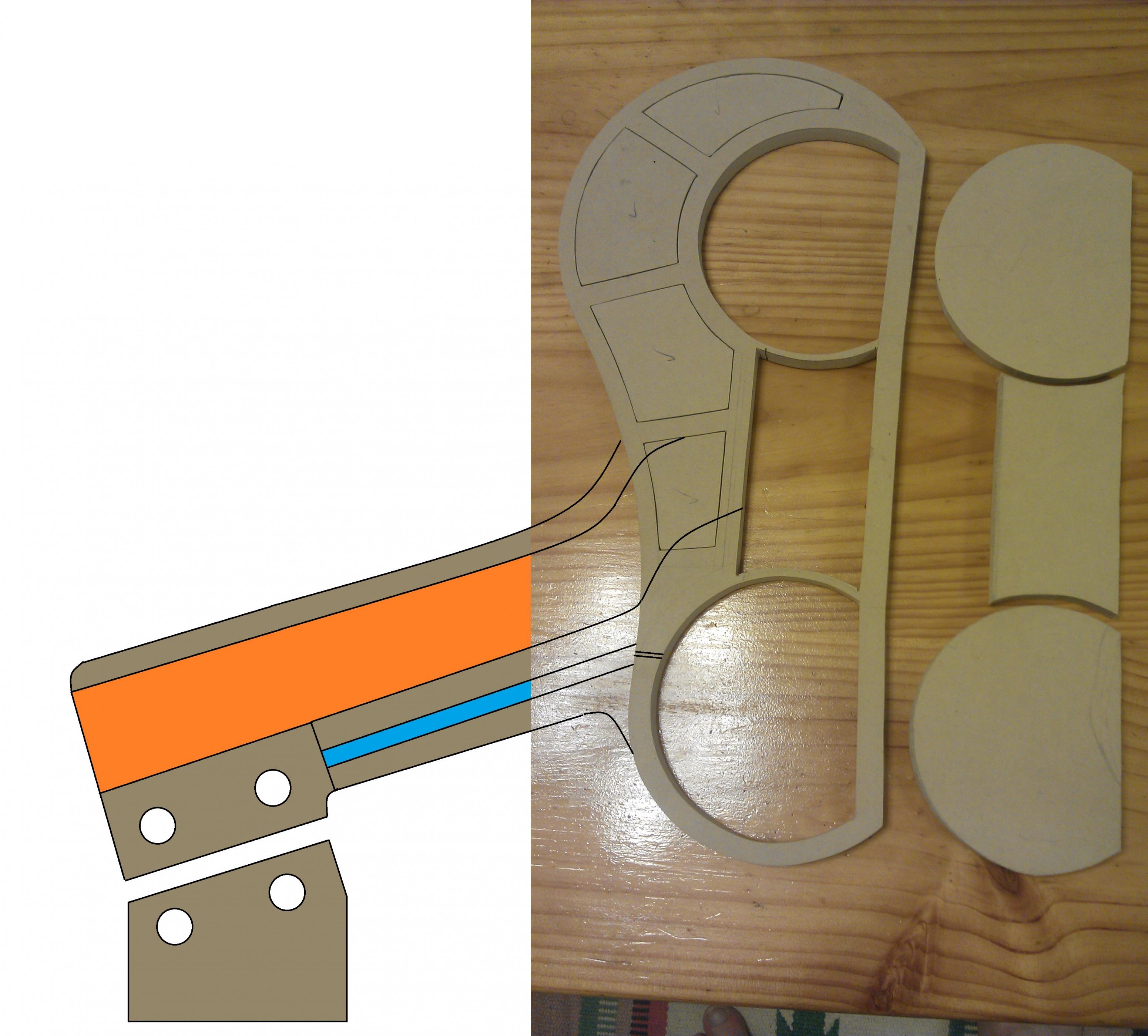

I was thinking I could possibly raise the back of the stand if I needed a bit of tilt. I was originally planning on tilting between the head and the neck but incorporating the port makes that a lot more difficult. I also think from a support perspective there are better places to try do that.
The main back stand is probably a better place to achieve some tilt, because the stand will be made with several layers of interlocking MDF(think fingers from both hands interwoven) If I do it on the back bone I can have more overlap giving a much better grip.
Can't think of anything worse then his head dropping from lack of grip at the neck.

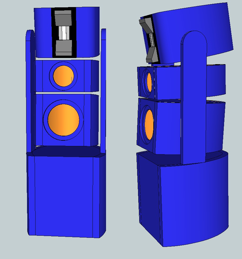

Funny you should say that because the Focal Utopia were also a source of inspiration to me too. I was originally looking to make seperate cavities for each of the drivers like this.
A bit of a cross between the Cremonas and the Utopia. Finally I decided on a fixed curve as a compromise.

sorry yes heres my effort
