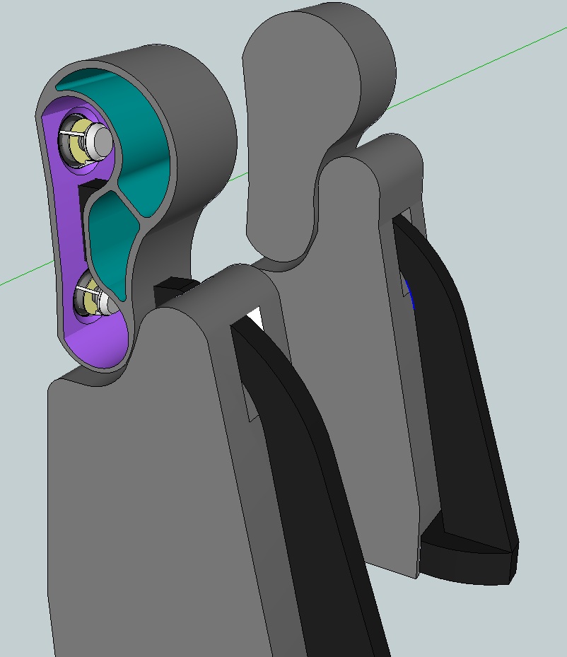

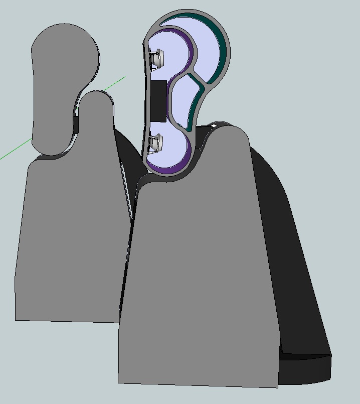

To me, these are the most beautiful speakers ever made. The kind you need a ladder to set up.

whats a good tool to use to design things...google sketch or something like that?

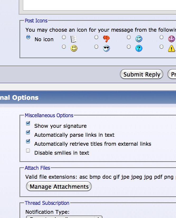

when I try to attach an image.
'Post Reply' then down to 'Manage Attachments'

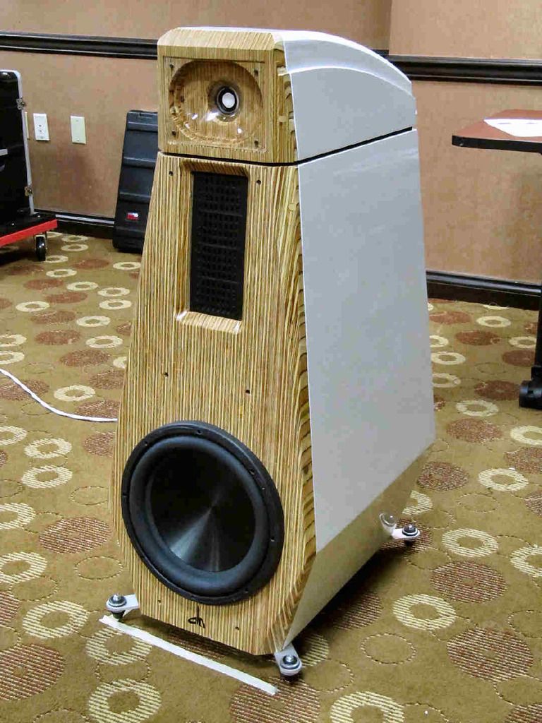

Dan...wtf, not one damn front shot of those things?????
COMMON!
nice....also, whats the back rectangle for...looks like a birds nest in there. DId you come up with a hybrid 3 way/bird coup?
Seriously...I dont recognize that woofy. Nice built in wave guide for the tweet.
what is the mid? A planar?
COMMON!
Got it, thanks Cal.
stoopid thing all the way down at the bottom...

Mid is the BG neo10 planar, in an open back configuration. The woofer are new, but the no longer available TCsounds TC1000, pretty much the same woofer that Salk uses now in his top of the line Soundscapes. Tweeter is a Transducer Labs N26C ceramic dome. Build thread here:
Introducing: Echelon - Techtalk Speaker Building, Audio, Video, and Electronics Customer Discussion Forum From Parts-Express.com
Here's a shot from the recent InDIYana DIY event.

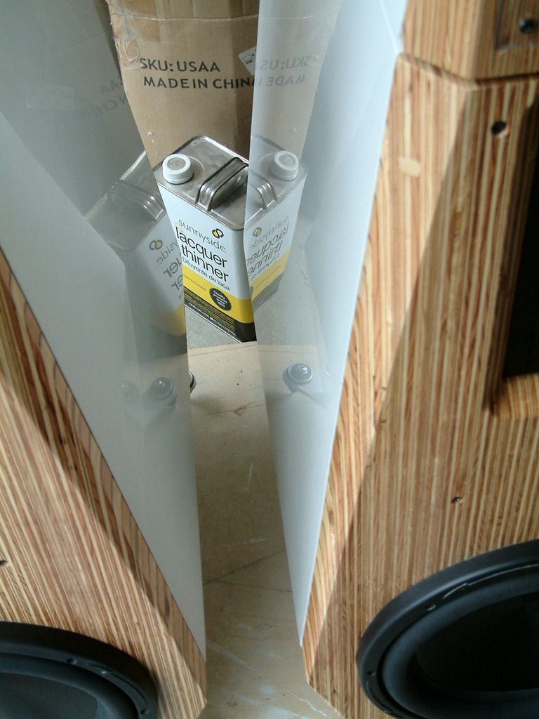

You know Dan, I'm not a fan of exposed wood laminates but damn, that makes them hard to dislike.
Yeah, exposed laminates can be too much at times. That's why I went with simple gloss off-white on the remainder.
Surprised mine haven't shown up under the "ugly but interesting" catagory...
Far from run of the mill, but I was looking for function over form.

The woofer is amazing (freq responce graph on the link)
Sealed was the only way to go with that TC...I see it.

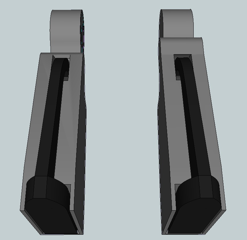

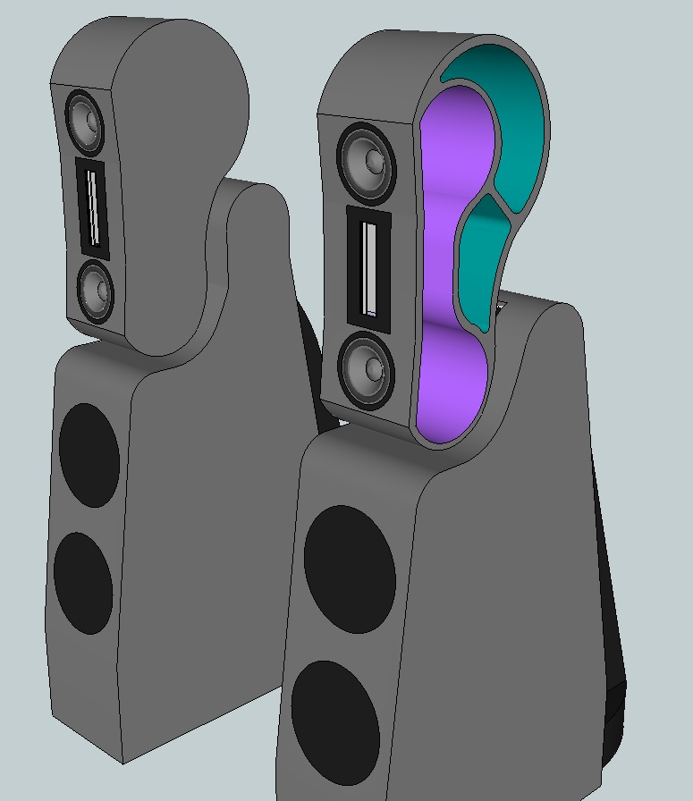

Actually looking to port it... http://www.diyaudio.com/forums/multi-way/211482-port-placement-pro-cons.html
Will run the port across the back to get the length I need of around 12"-13"
Haven't designed bottom cabinet yet... Will wait until top cabinet is finished, see how it balances and then design lower cabinet to suit.
No, I meant Dan's.
I would port yours for sure. WHat are those..2 X 8's
