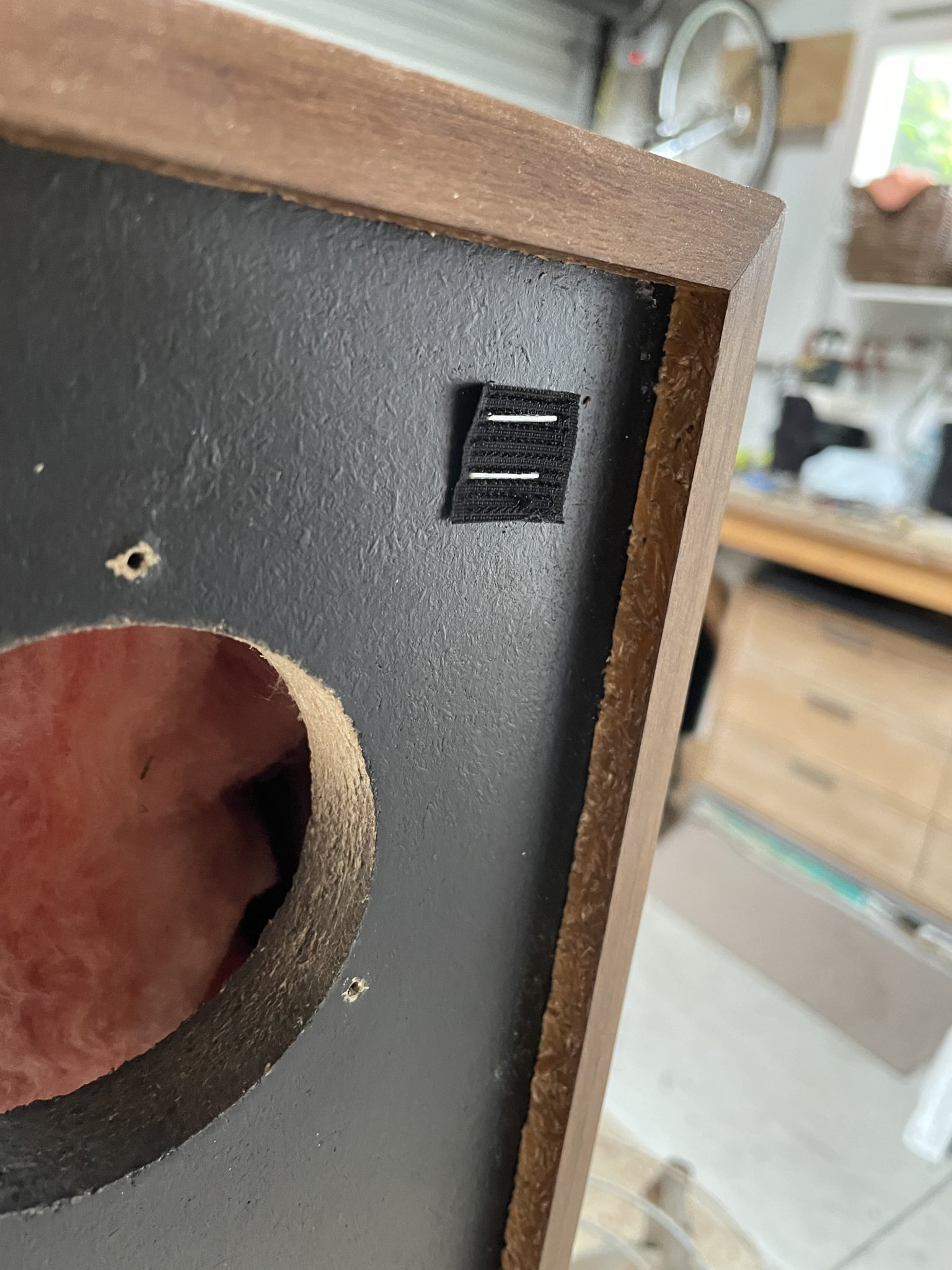

Eyeballing the photo, the cabinet front baffle is approx 464mm H and 308mm W.
530mm H x 230mm W. There is a raised step on the edge that the grill sits inside of.

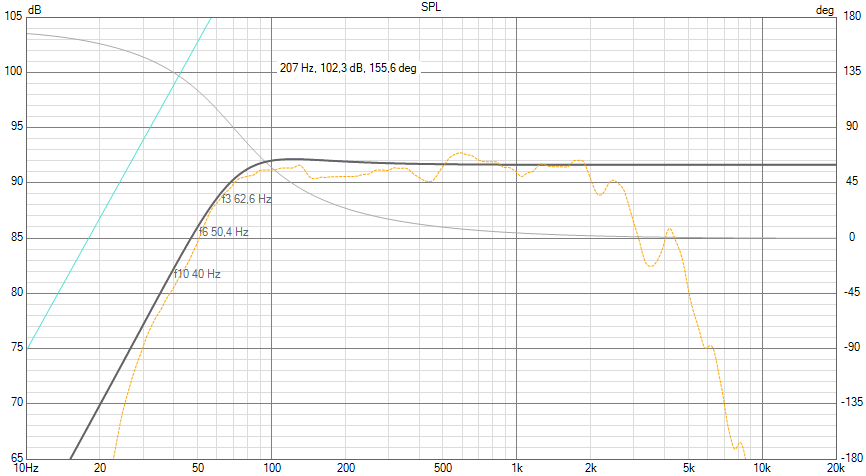

The seas datasheet says that the curve is already measured in 4pi in a 28L cabinet, so you do not need to consider any baffle step response.
Below you can see the overlay of your traced curve and the bass response for a cabinet of 28L calculated in VCad Enclosure tool.
PS
If you need to include the baffle step response in your bass response, just export it from Diffraction tool and load the response in the Align tab of the Enclosure tool.

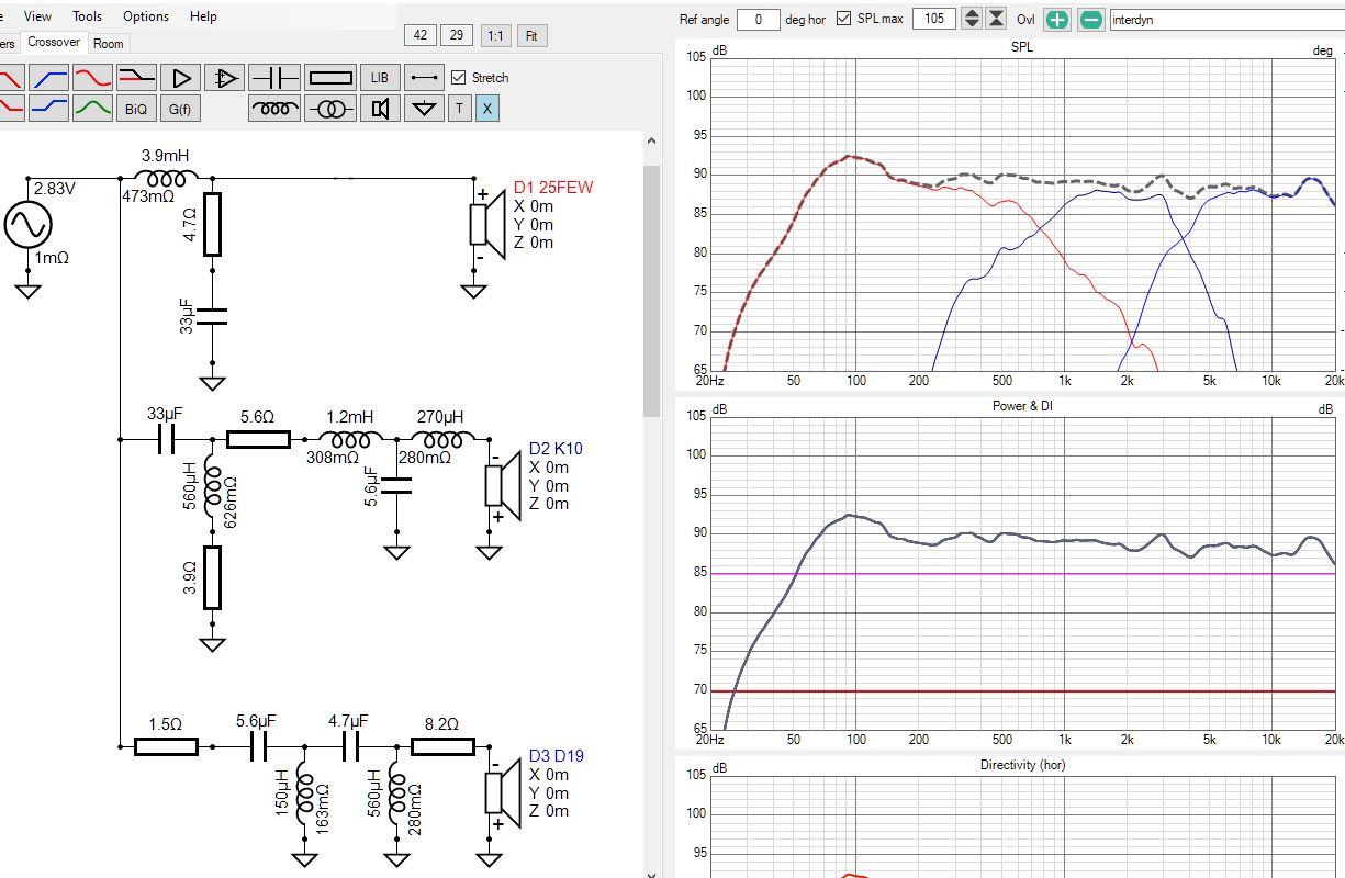

OK, gents. Learned a lot. Here's another go at a sim. As per @shadowplay62's eagle eyes, the old Seas datasheet was already measured in box.
Corrected scale of the old D19 datasheet. Applied baffle diffraction to mid and tweeter, though it seems to do little in their bandpass regions.
Ended up bass-mid XO @700hz LR2-LR2, and mid-tweeter XO @3.5khz LR4-LR4, cause the D19 doesn't easily fit BW3. Mid + tweeter inverse polarity.

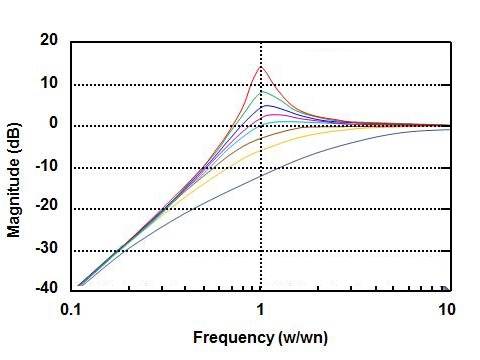

A capacitor and inductor resonate, and this working together has definable characteristics. The driver is a 'load' on the resonance that takes energy from it, and forms part of how it can be characterised.

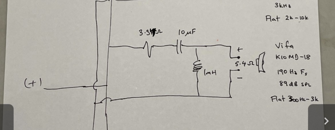

Thanks. So for the example attached, I understand the resistor will reduce the absolute level. If I look at the speaker inductance on the plot, it is between 7-8 ohms from .5-3 khz. If I look up a 10uF capacitor at 8 ohms the frequency cutoff is 2 kHz, for a 1mH inductor it is 1200 Hz. Does that mean for this circuit there is a sharper attenuation curve below 1200 hz, starting to flatten at 2khz? And there is no low pass element at all.

I'm not sure which example you're referring to, I had some concerns about some of the posted schematics so I'm not wanting to guess.
In any case, 1mH and 10uF resonate at 1600Hz. They do more than just work on their own. Their relative phase keeps the energy between them and they can even create an output level higher than the input (just to make a point). Examples of resonance...

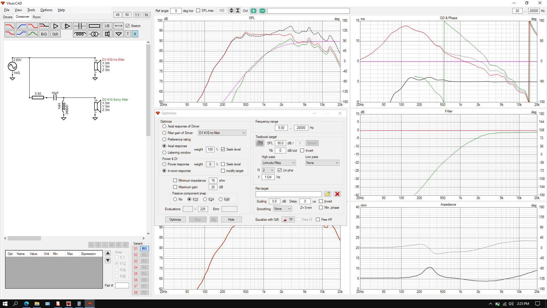

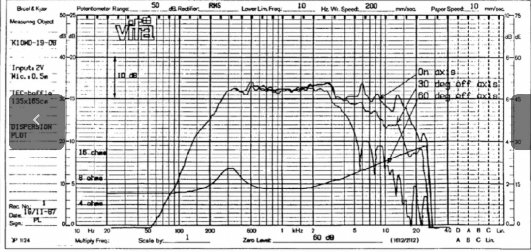

@Kevviek I applied your written high-pass filter to the K10 - it models thus - not sure what they were trying to do, TBH - closest acoustic response is roughly LR2 about 1100hz that loses precision within 1 octave.
No low-pass gives...I have no idea - this doesn't match anything - so I struggle to see how they hoped for good blending with the troublesome D19 with its very high resonance frequency of 1750hz. Maybe borne out by an irritating treble as you said.
Red = unfiltered K10, Green = K10 + Sony filter, pink = textbook curve

I added the pics a moment later but you have answered my question. I assume then that if I increased the capacitor to say 22 or 33uF, with that same inductor, the resonant frequency would be closer to the target 800hz.
