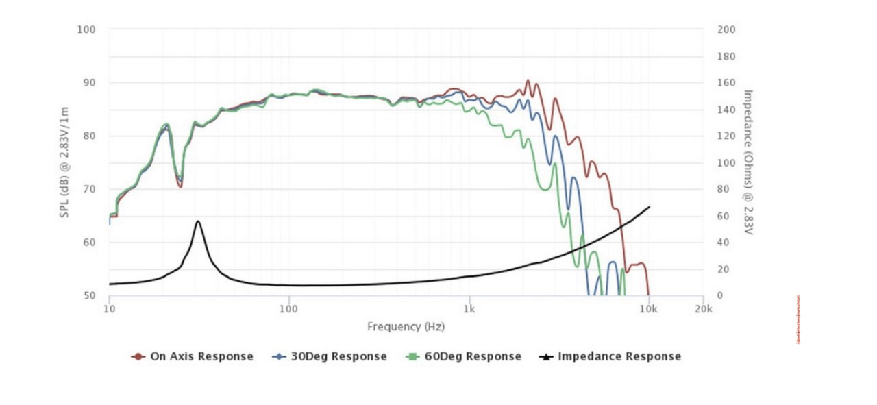

The response attached, is what happens if you model a pair of the very highly regarded jeff bagby adelphos speakers using the manufacturers specs, and that's using super high quality and linear drivers known to be very consistent with their published parameters. Your results are likely to be exponentially worse.

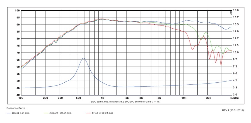

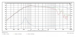

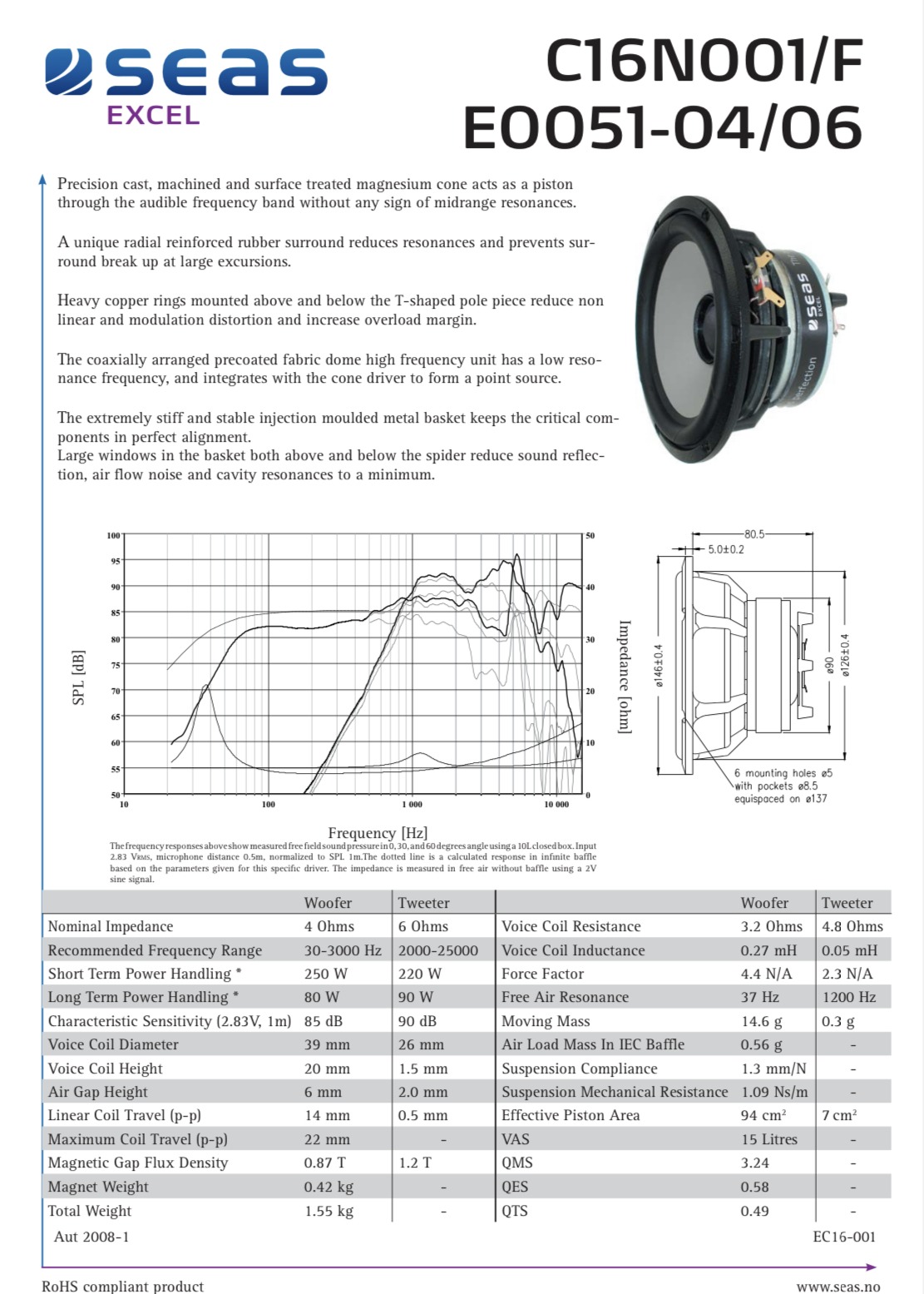

And you say it uses factory response data? This is from SB Acoustics site for the TW29R...

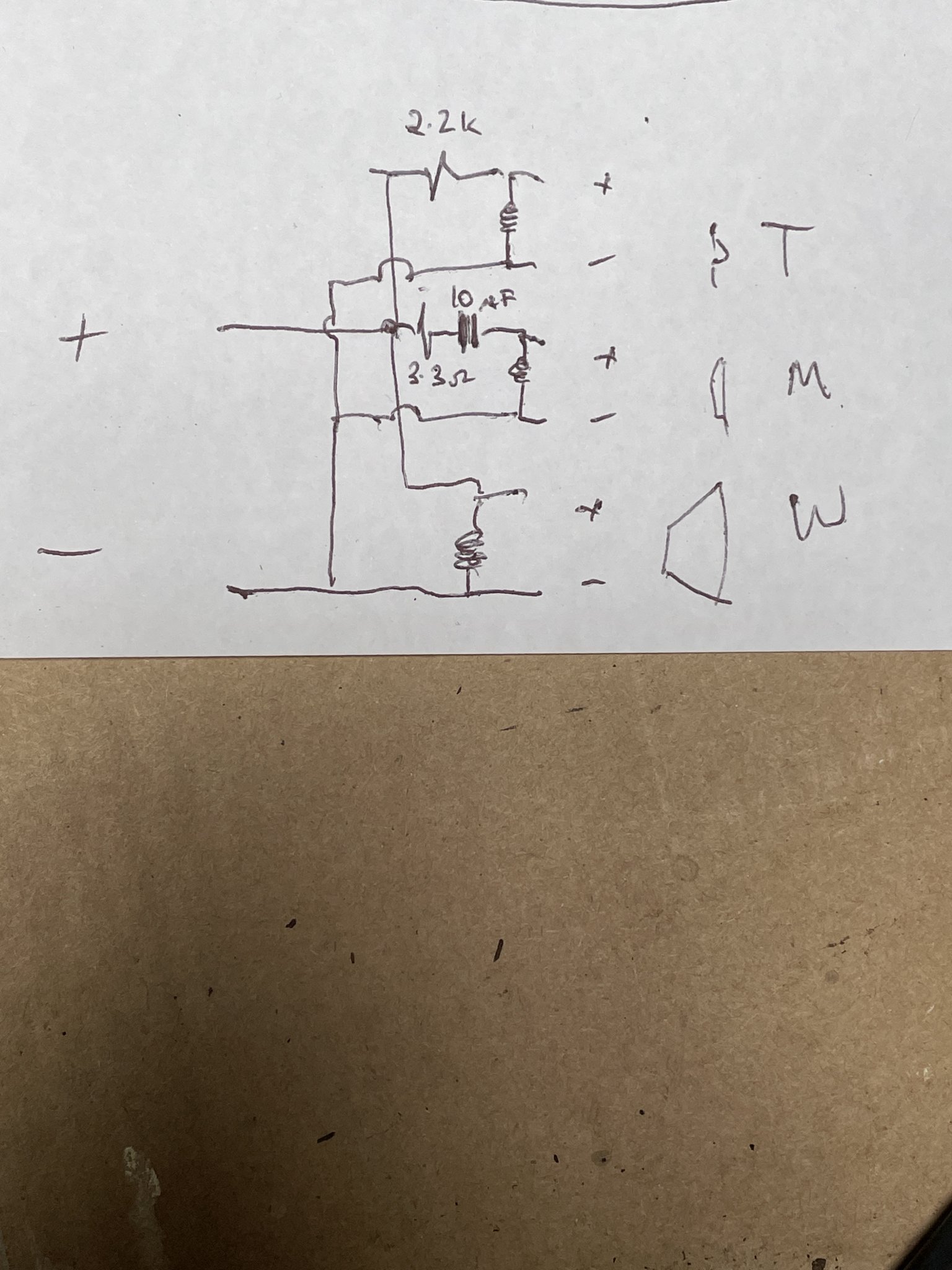

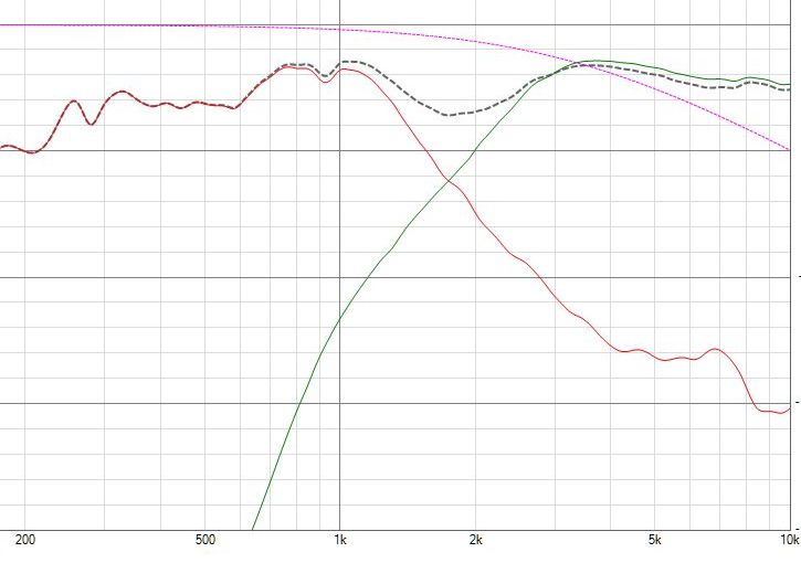

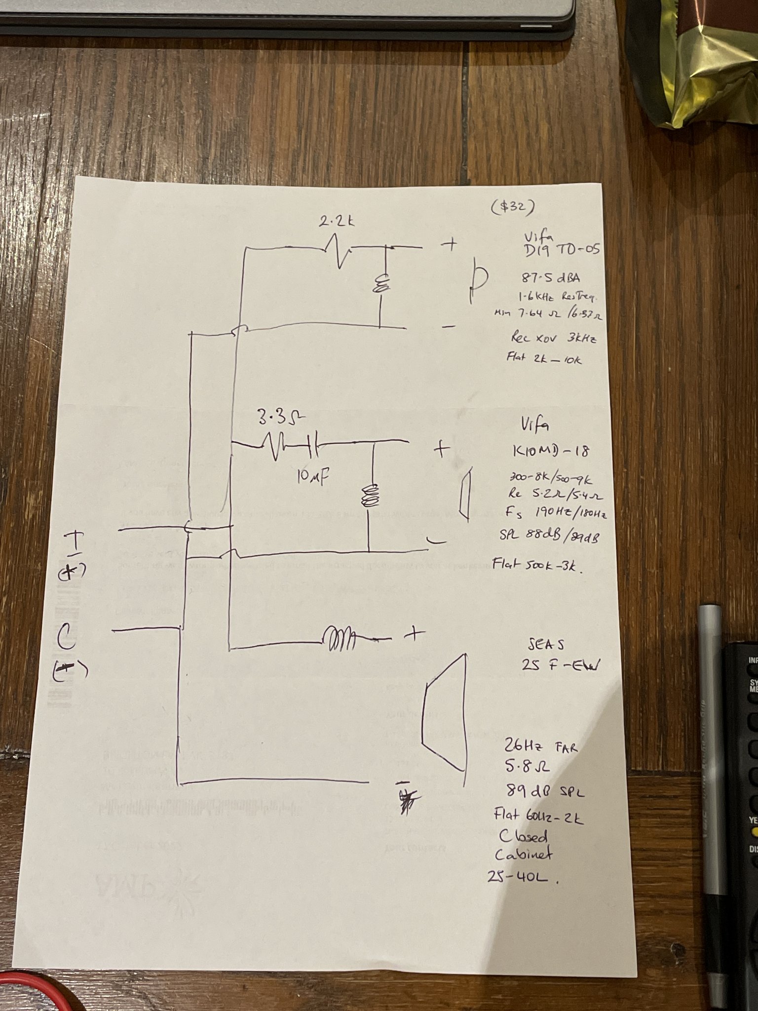

Back on topic, of course my simulated XO will be imperfect compared to having real measurements.

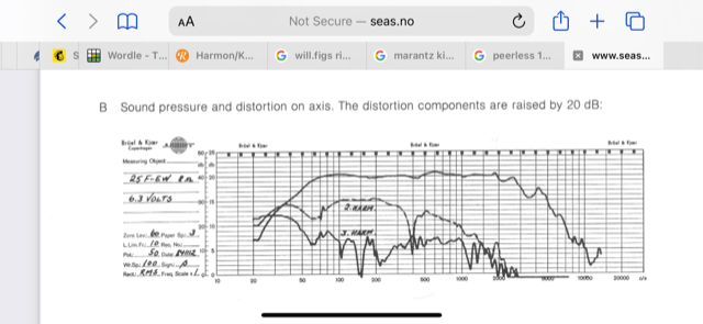

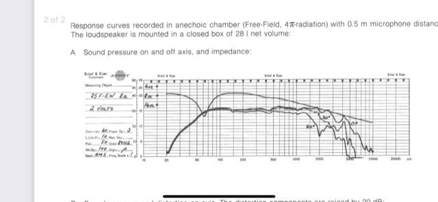

But let's get real, these speakers are what 20-30yrs old, and the owner has swapped in a different woofer from another speaker, didn't like the sound of the original XO (which used 1st order on bass around 2k, 2nd order highpass around 2k on mid with no low-pass at all, and 2nd order electrical around 7k on tweeter with no tweeter attenuation). The Seas datasheet measurements were taken in a 28L box. I applied the diffraction anyway to the mid and tweeter from Jeff's Diffraction spreadsheet, and used XO points of 700hz (recommended by Vifa for the mid and well under beaming range for an 8" woofer) and 3500hz (2 x FS for the D19 tweeter, and before off-axis drops too much the mid). I chose LR2-LR2 bass mid to reduce parts cost, and LR4-LR4 cause that tweeter is difficult to work with for any other slope.
Remember also the swapped in woofer is the one used in the Dynaco A25, which we know is used with no low-pass at all, relying on its unusual natural roll-off. You could say it's not the best choice to mate with a mid at all, unless you want to run that mid only from 2k, and it seems weird nowadays to run a 4" mid to 7khz.
Anyway, I'm not saying it's going to be ruler flat, but I think it has a higher chance of sounding better than what it is doing right now.
If this is just coming down to parts cost on 1 coil, well here are all the files. See what can be done with this strange woofer. Have at it.

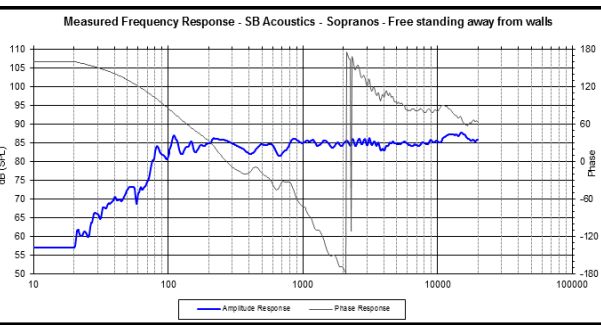

FWIW, I did the same steps (datasheet inputs applying diffraction) against Jeff Bagby's fully documented Sopranos (SB12 + SB26TCN) - it didn't come out completely horrible. Taken from 200hz (below which the filter does nothing).

Thanks @Moondog55 - yeah I have no experience with any of these drivers, and have no idea what the current speaker sounds like. Just the Vifa datasheet recommended to use 12db slopes with it from 700hz. The upper end response of the K10 is also kind of shocking from 3k - it seems to fall off a cliff. Bottom line, It doesn't seem easy to get any kind of normal summing slopes with this group of drivers; not to say they can't be forced to.
I've no direct experience with that Vifa 4" but I've used similar cheap mids and I think you need to use much steeper slopes to get it clean down to around 500.
Whether that is worth doing is up to the individual but using a bigger midrange compartment seems to help me when doing stuff like this and that shorts the woofer of working volume. I Prefer first and second order crossovers and if I have to go steeper I use electronic or digital now
Behringer CX units are so cheap it seems silly not to go that way

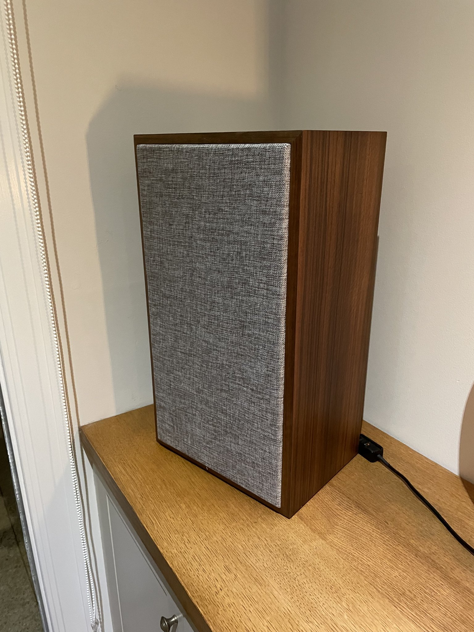

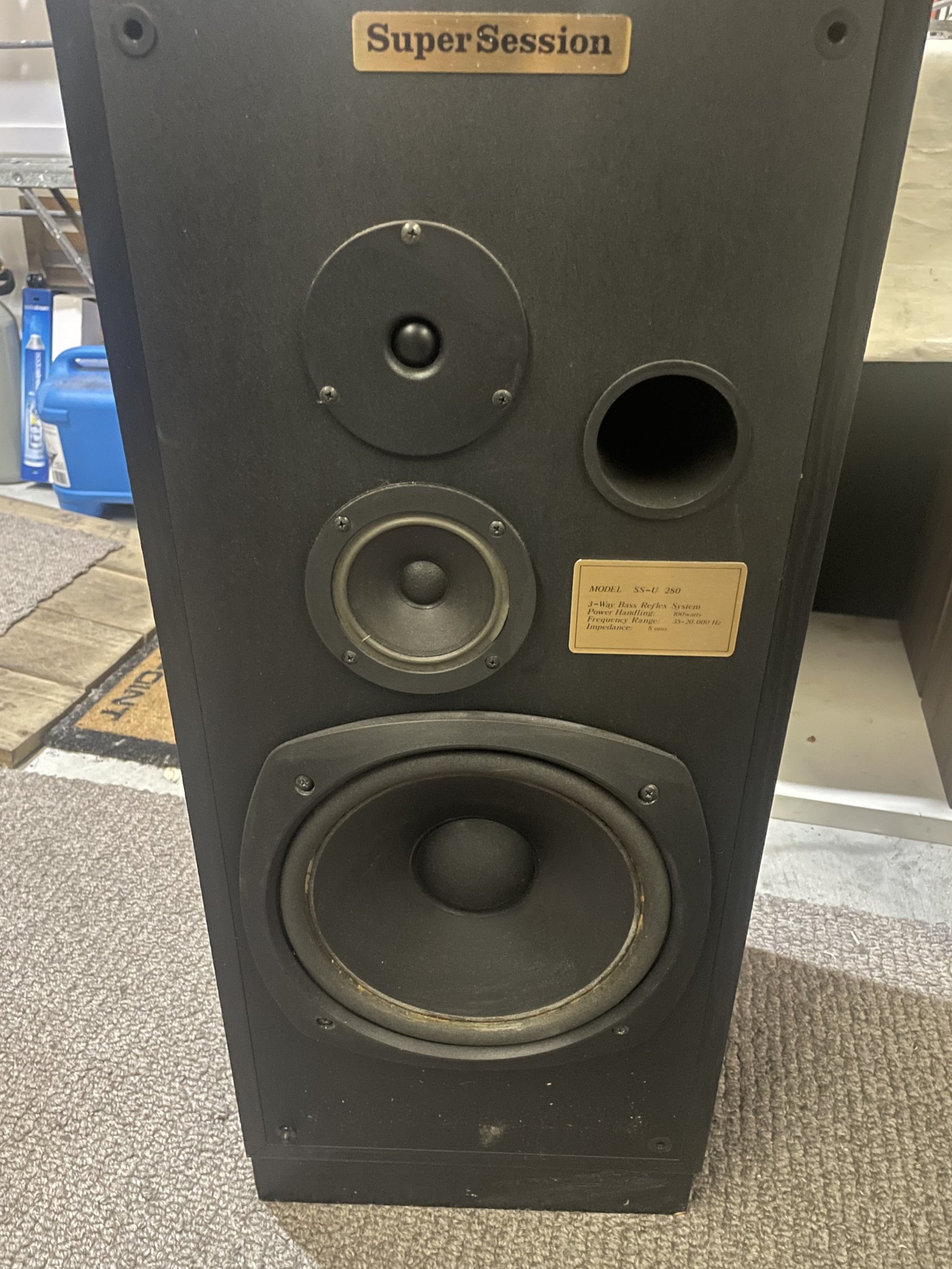

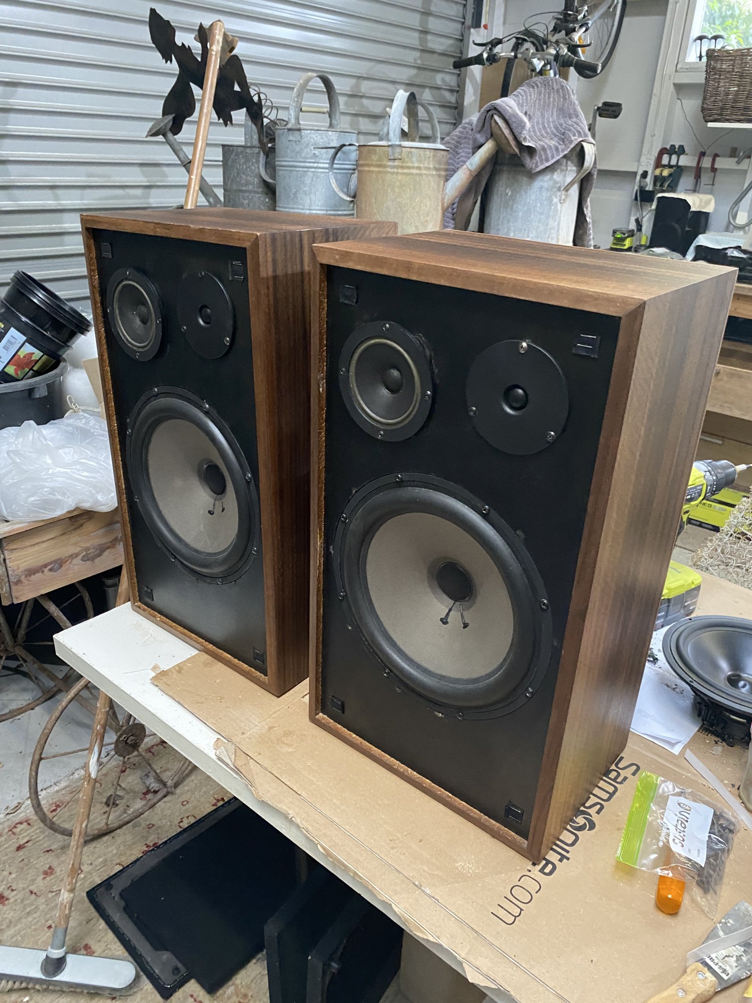

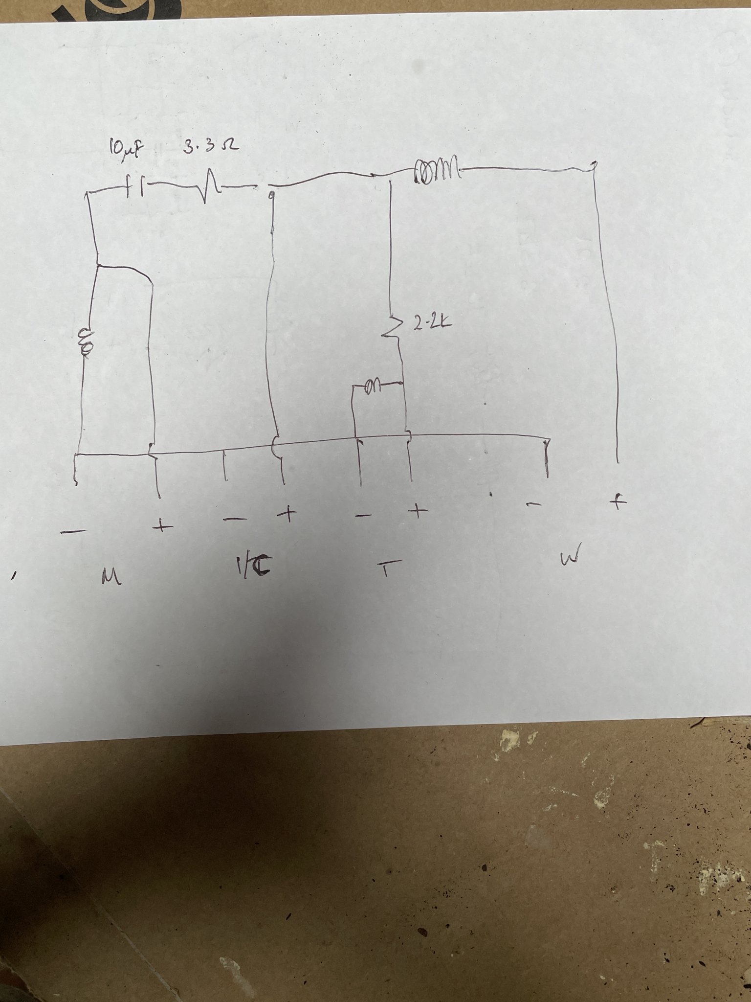

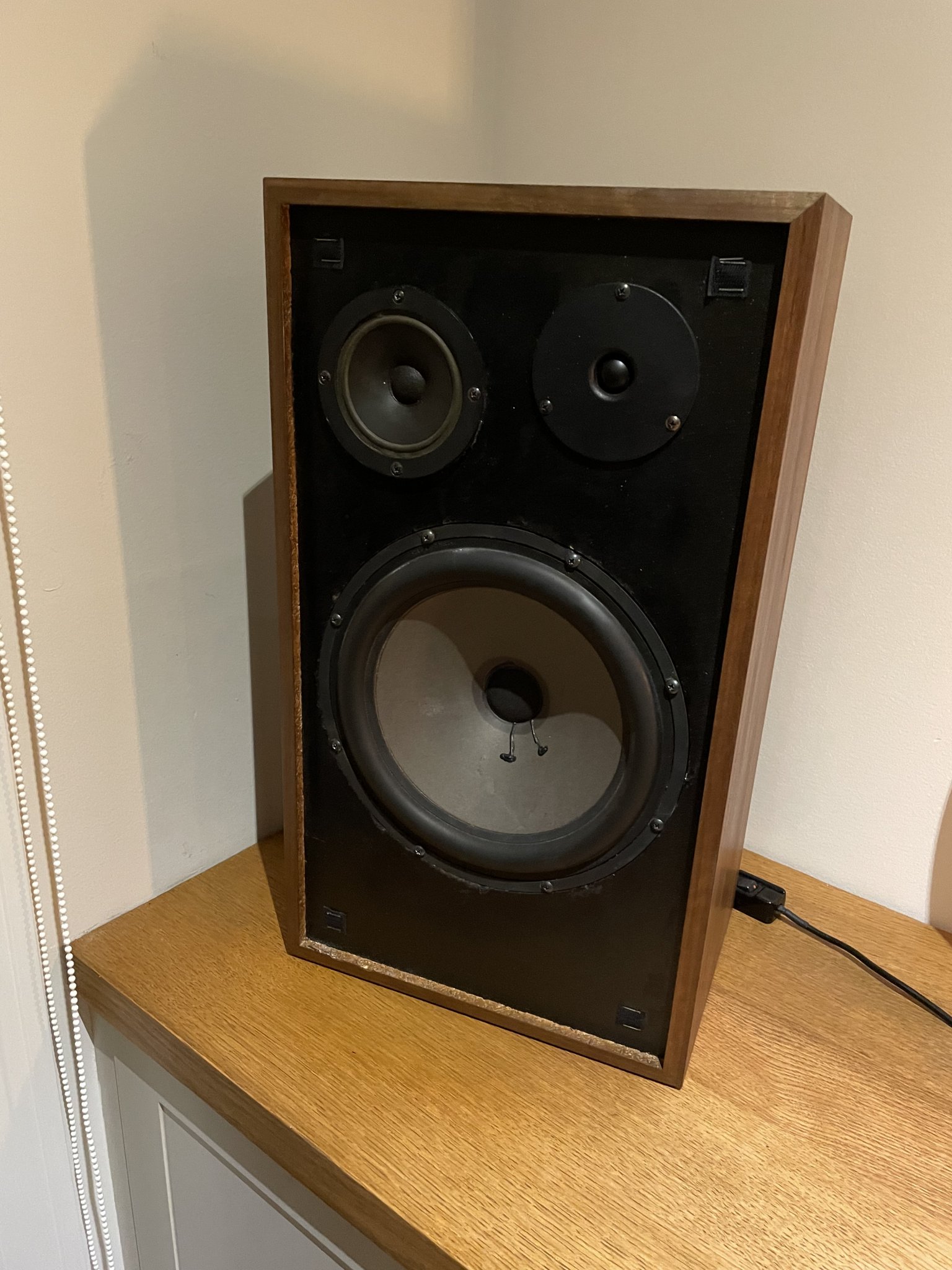

For both you and moondog I sincerely appreciate your inputs. It’s not being put off for the cost of one coil, and this has been a valuable trip down memory lane. I built many pairs of speakers back in the eighties whilst in uni to make some spare cash, including hand winding the inductors, and I’m now remembering plus learning some more. I wanted to experiment with the crossovers I already have, to see what could be done. To build the new ones per the design I need to order parts from three different suppliers, which will take weeks to arrive and then I have to fabricate them. In the meantime I have finished the cabinet restoration and am enjoying listening to them…

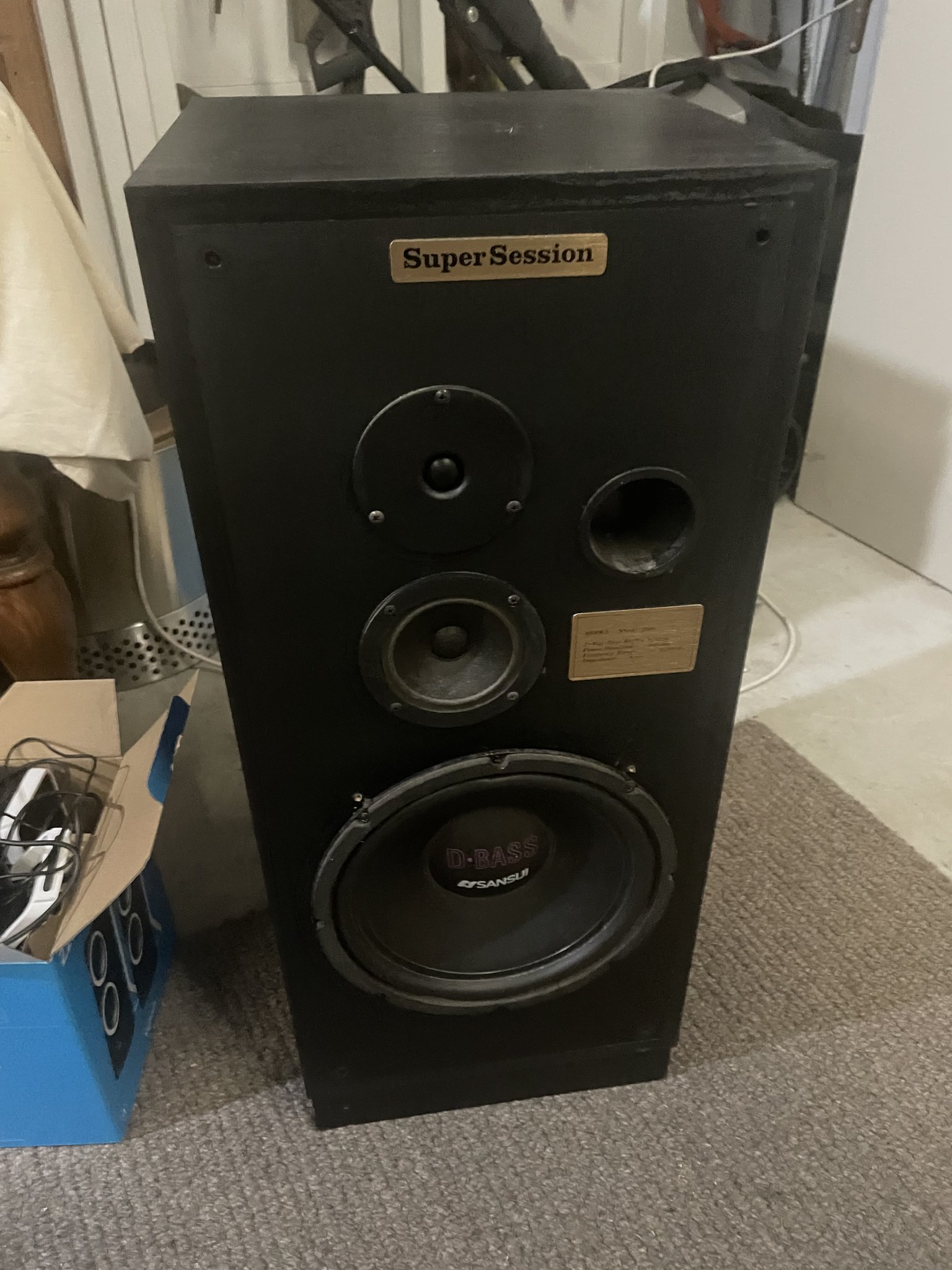

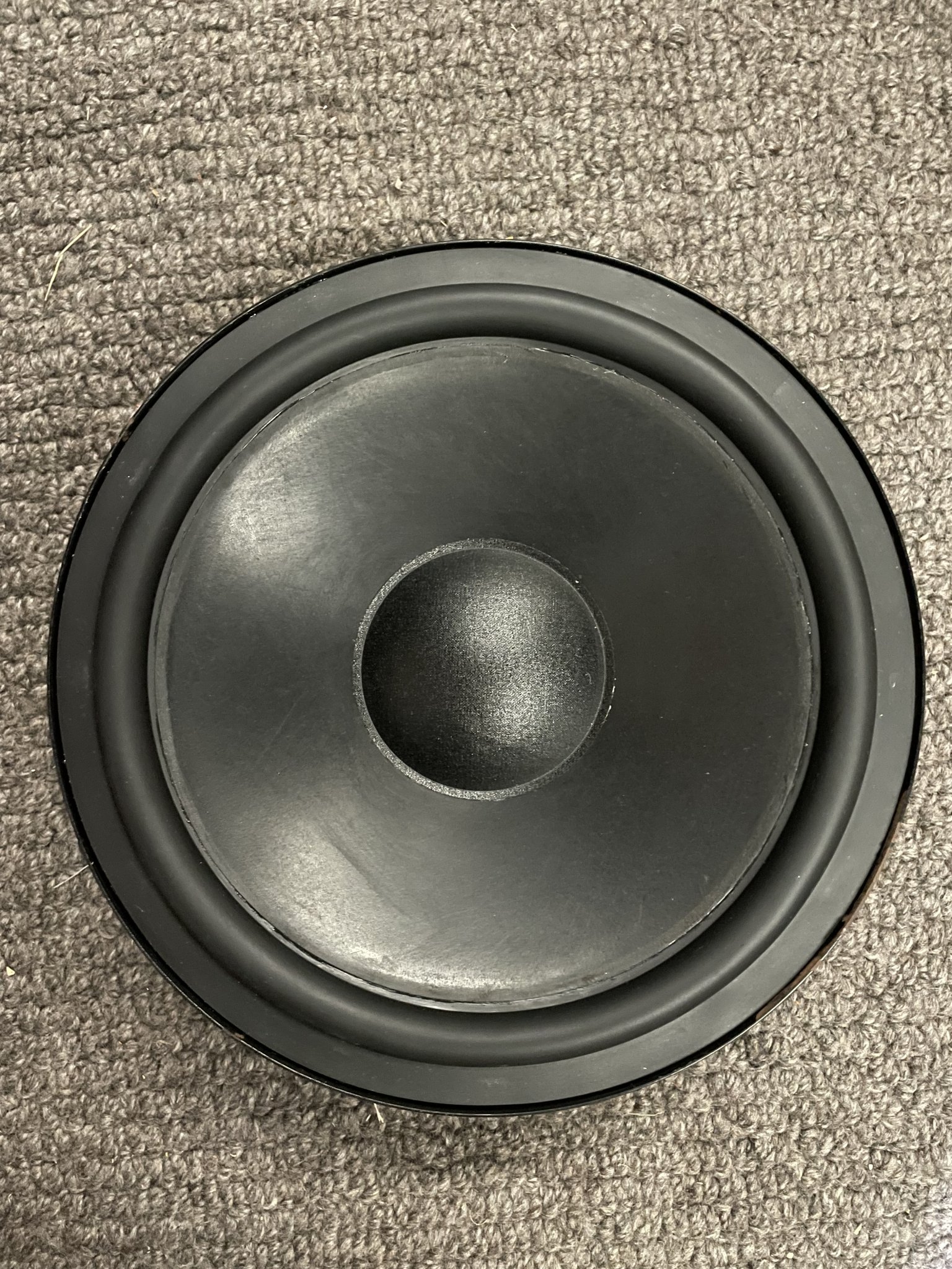

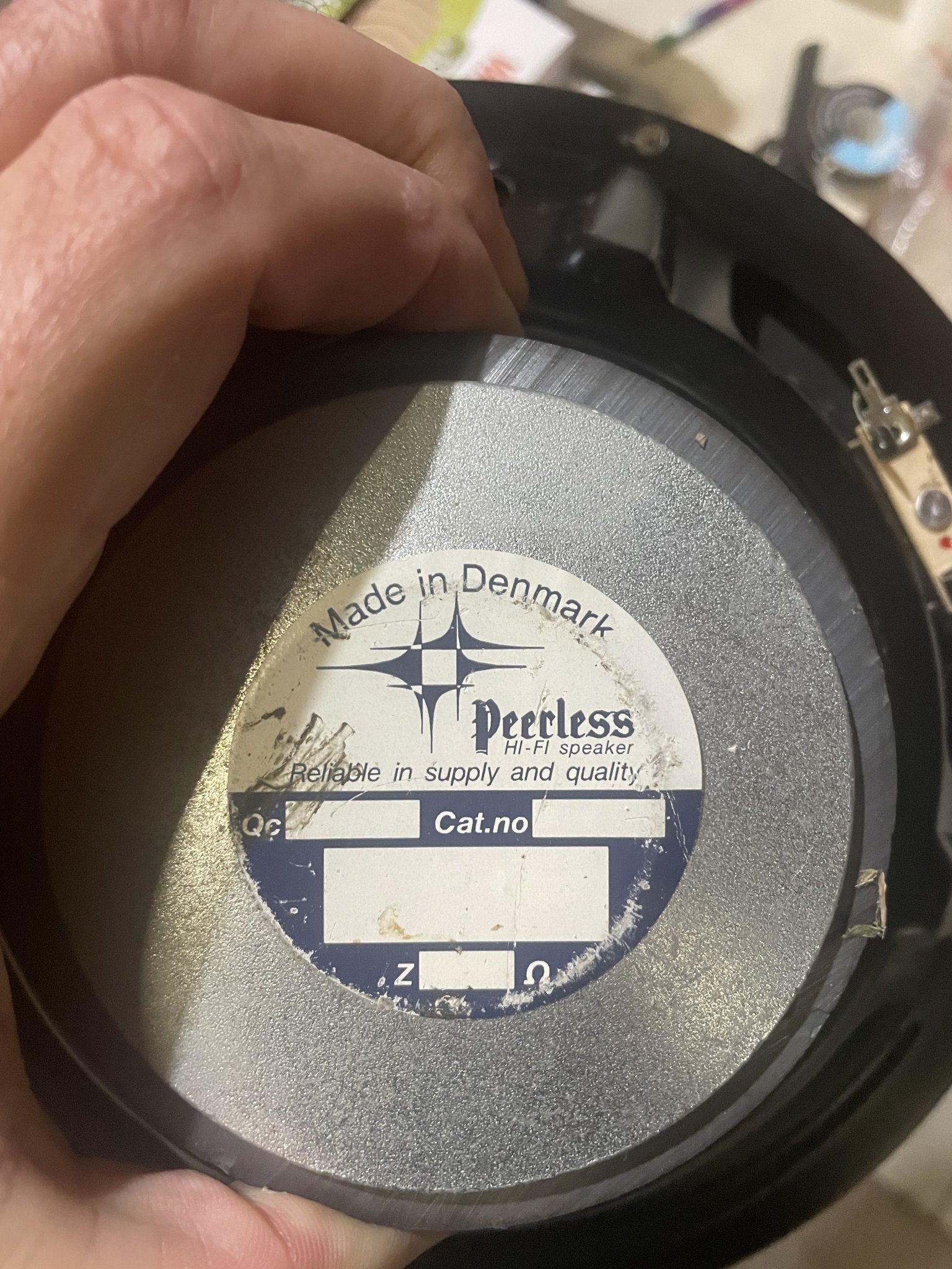

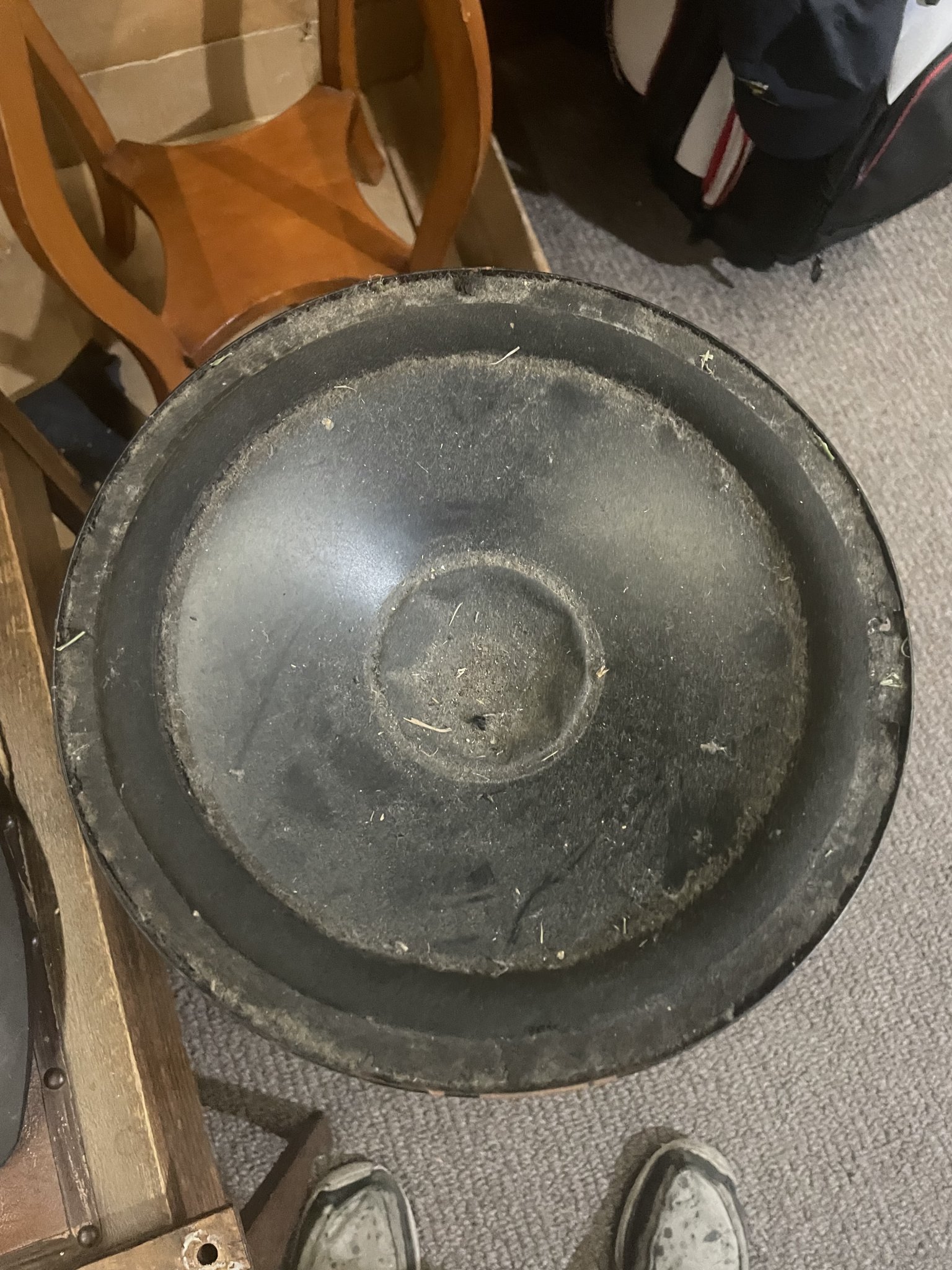

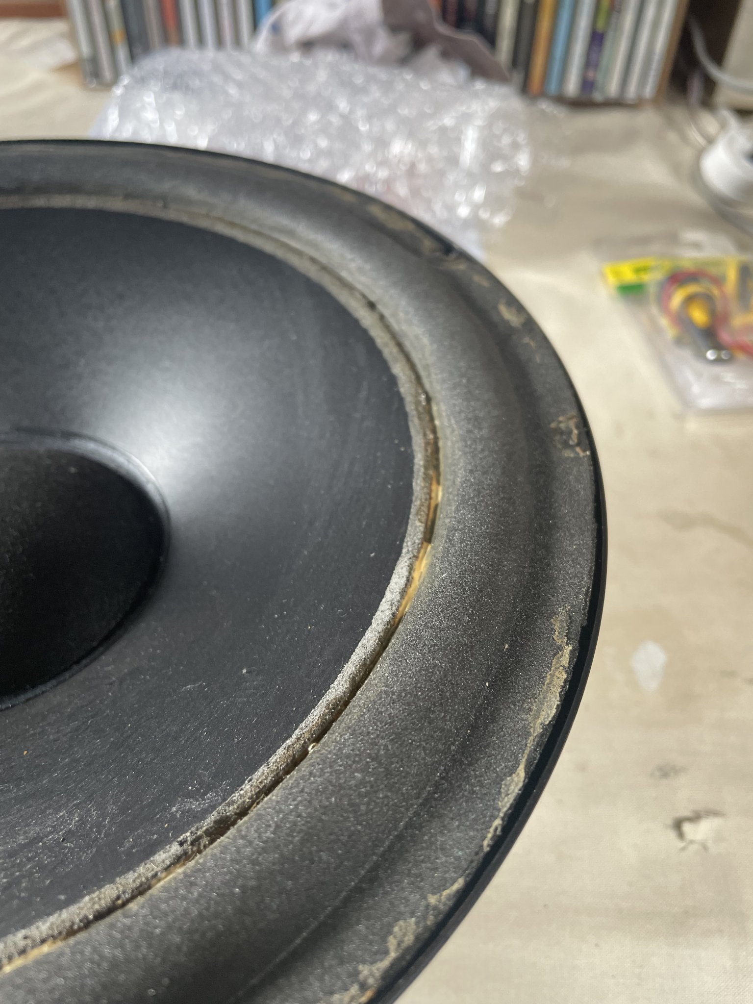

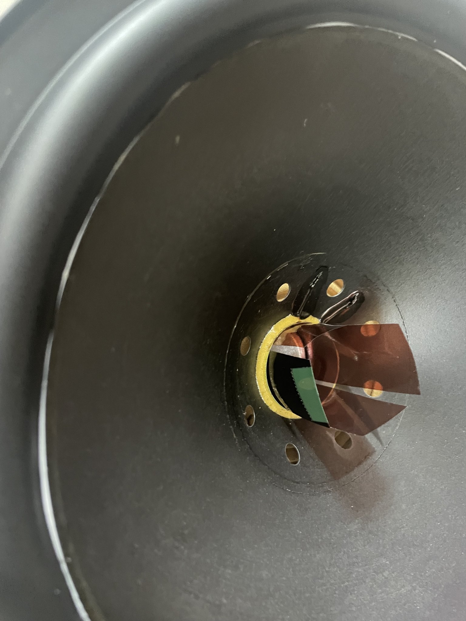

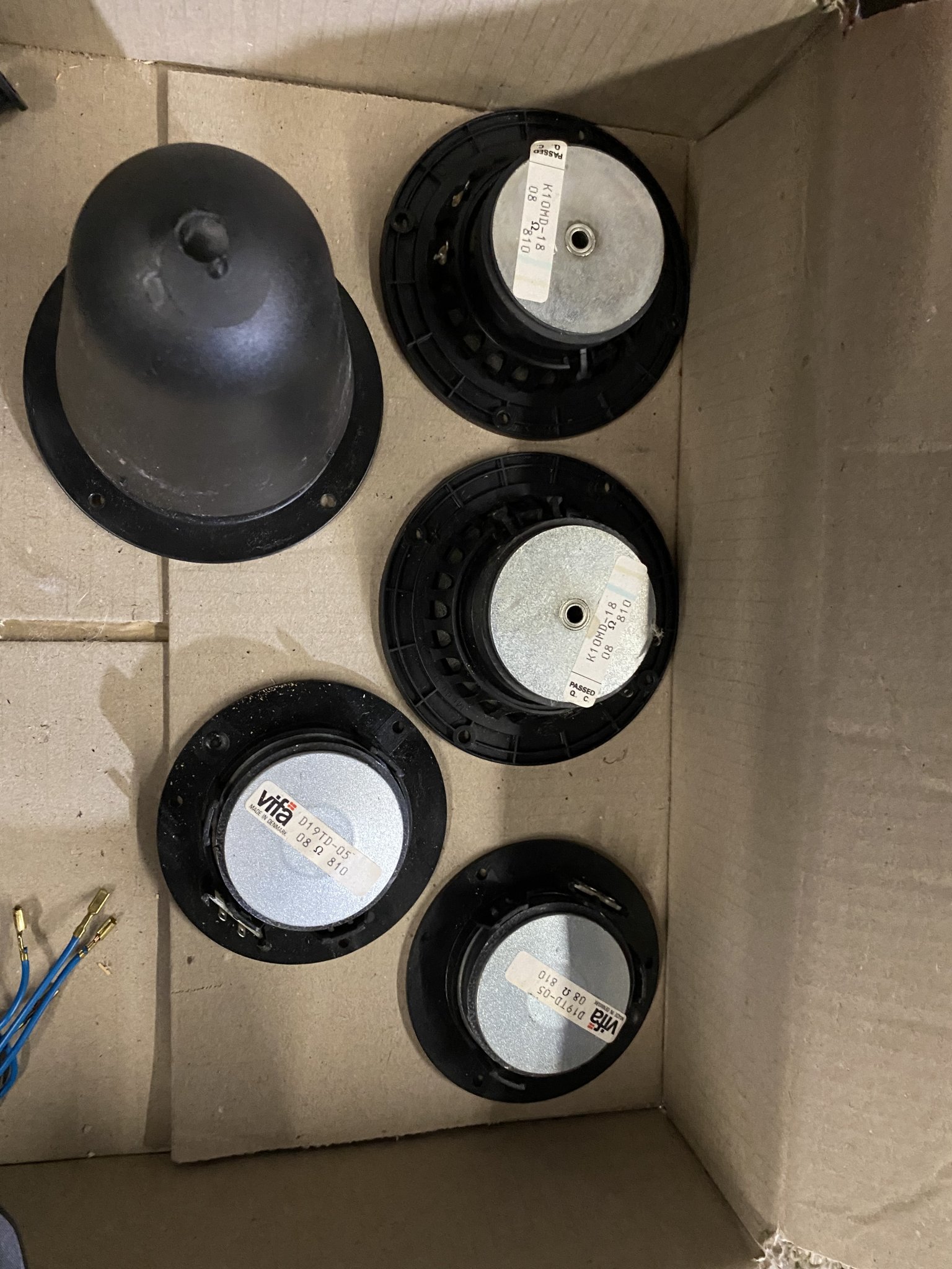

Rekindling this old thread….would you believe it, I found another set of these SSU-280 speakers, this time with good cabinets but only one original woofer. I bought them (for $20) to use the tweeters/mids as spares and when I picked them up the owner said he still had the other woofer. I took it home and tested it, it still works but the foam is gone.
So, the question now is how to identify this woofer - it’s a Peerless also made in Denmark - and where to source a refoaming kit!
