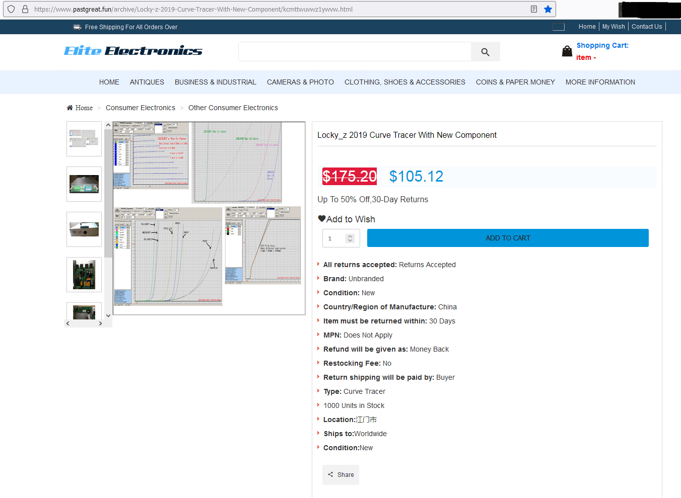

Here is one picture from the shop...
- several things are contradictory to me on the site...
