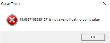

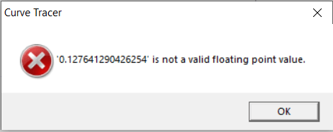

I need your support regarding the software. I measured around 50 NPN BJTs (hfe vs. Ic) and saved the data in a *.cuv file. Later on I tried to load the saved curves and got to error message shown below. Browsing to some old measurements and loading them failed as well. I use software V3.5(Script). Could you please help me with this.
Thanks and BR Uwe
...if I delete the line with the value it will error out for the next value and so on. To me it seems to be a bug in the software.
I had a similar issue with another software package on Windows, where the software mixed up the decimal separator between a dot "." and the separator configured in the Windows Format Settings (in my case it was set to a comma). What is the separator setting on your Windows machine?
In English as well as in China, the decimal point is used as '.'. Curve tracer software converts floating point numbers to text and saves them in cuv files using '.' .
but in some regions the decimal point is ','. So when reading these words in those windows and converting them to floating point numbers, the symbol '.' will not be interpreted as a floating point decimal point. and report xx.xxxx not a float number.
I feel the software should be able to recognize the number format that was used for writing the data (the dot format), no matter what the Windows setting is / was. If the software always uses the dot format for writing the data, it should always assume the dot format for reading the data.
