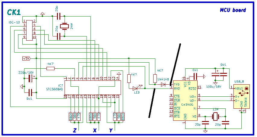

Yes you can use another USB-Serial adapter connect it,
attachment.php
cut off CH340 pin2 and 3, connect to your USB-Serial adapter TXD/RXD。
The stc mcu output is 5V level.

tried a another normal Windows PC, driver CH340G recognized but the tracer tool show the message: "Device Not Found".
(1)
Any hints please. Could be that the STC has gone?
If 2019 Version, power up the led on mcu board will flash 5-6 times. this mean mcu is ok.
If another version, short three X/Y/Z terminals and power up, you will hear 5-6 relay sound. this mean mcu is ok.
(2)
If mcu is ok, and in windows device manager can find the 'ch340 serial com port' , then run the software and click the 'auto detect & get parameter' buttom.
If still not found. also the ch340 chipset wrong.
(3)
If (1) is not OK, check 78L05 output is 5V, if 5V is OK, the mcu wrong.

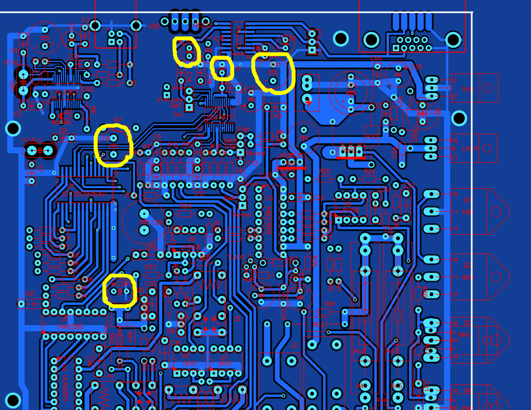

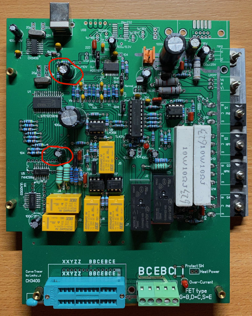

not recognize with MacOS => will try at next my adapter that is working with MacOS.
The "left" caps (see markings on my pic) are in spec.
The other caps you marked at the top isn't there on my board, please see pic (<2019 version).
+5V at 74hc595 ist present.
Next step is to use my adapter and ty it again.

Morning,
changed to a working adapter .. but no control to the board. :-(
- removed the CHxxx
- adapt the new USB adapter and Windows / MacOS recognized the new adapter but no communication to the board ... changed again RX / TX to the STC for test => nothing
- put the CH again to the board (of course without the new adapter) => nothing
So I think it will be the STC ...

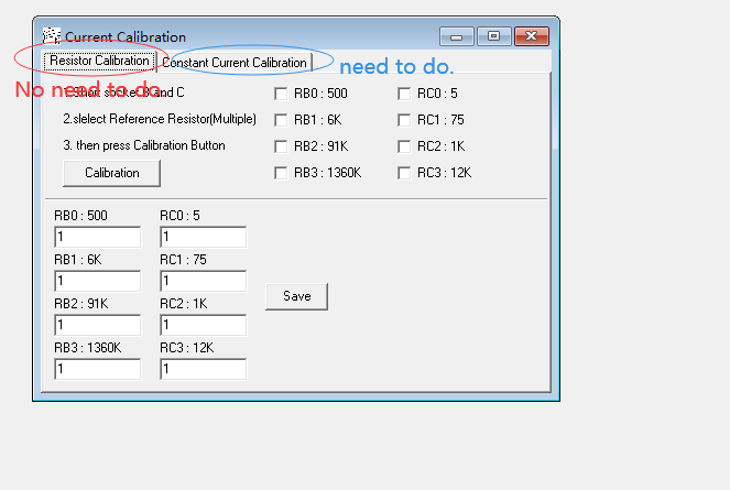

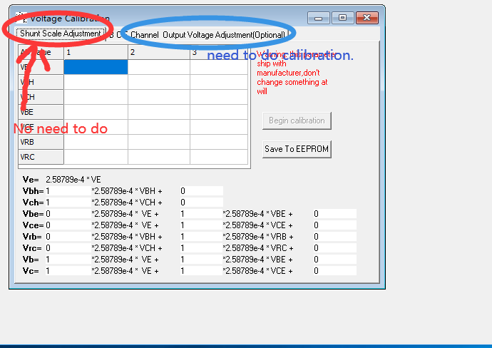

After some restarts and repowering the curve tracer it worked 🙂 Don't know what was the fault. Anyhow now I follow the sw manual and do the calibrations. Question: The manual says you have to perform following calibrations:
  • voltage calibration -> BCE Channel Voltage Adjustment
  • current calibration -> Constant Current Calibration
So the other calibration Tabs (shunt adjustment and resistor calibration) are fine as is? I did a calibration for testing but didn't save ist since there is a warning message saying: this parameter ship with manufacturer, don't change something at will.
Hello Locky,
thanks for clarification. The curve tracer is working and I already captured some Ic-Hfe curves from some power transistors. The do this up to 2.5A is awesome and I know nothing comparable (and affortable) on the market.
Thanks Phonoton
