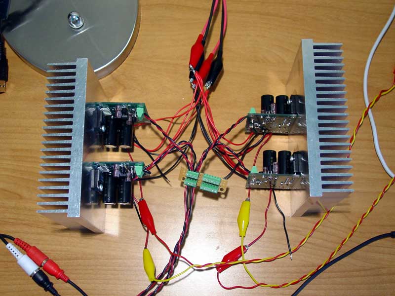

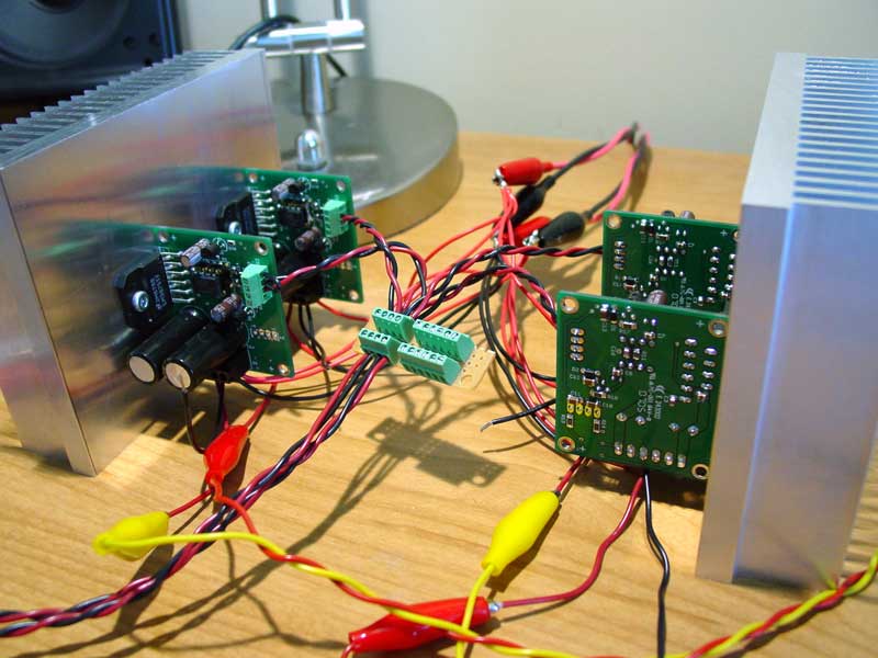

It took a while but the other boards got built, managed to find their way onto some heatsinks, and get wired up to a suitable power supply. I was going to fit 4 amps per heatsink but the 680uF caps I used were just barely too tall so 2 per sink was the decision. Quite overkill and as a consequence the aluminum chunks don't even get warm with my 8 ohm speakers. They could each be used separately for 4 channels but I've only got 2 speakers so why not bridge them? Since each board is an instrumentation amplifier bridging them is as simple as wiring the inputs in reverse polarity for each half of the bridge. The input impedance (inverting and noninverting) for each board is 100k, so using two in parallel gives 50k.
Currently the left channel uses OPA2134s for the input op amps and the right uses LM4562s. The OPA2134 channel has a small pop at turn on and plays a little music through the left speaker about 5 seconds after powering down the supply. The LM4562 channel has no pop at turn on and no noise when the supply powers down. So far the LM4562 sounds more precise than the OPA2134. The OPA2134 seems to have a slightly looser bottom end and slightly more shimmery top end, for lack of a better way to describe it.
