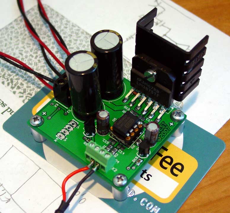

The parts came in and I made some time to build up a board which you can see in the photo below. The fake credit card is under the amp just to give you an idea of the actual size. Bulk caps are 680uF Panasonic FM, op amp caps are Elna SilmicII, op amp is OPA2134 (but I'll eventually give the LM4562 a try too). Supply rails are regulated +/-20V for the LM3875, which is regulated down to +/-17.9 for the op amp using 2N3904/6 transistors and 18V zeners. The 3875 rails can obviously go higher but I don't want to push it with the small heatsink you see in the picture. It doesn't get too hot to touch but it is nice and toasty playing into a 4 ohm nominal load (my two 8ohm speakers in parallel).
In it's current form I just routed the source ground to the inverting input and the source signal to the non-inverting input (both inputs have a nominal 100kohm input impedance set by the 100kohm resistors to ground). It sounds very nice and I can't wait to get another channel up and running. Using balanced inputs should be another step up in terms of noise performance but I don't have a balanced source/preamp.
It's worth noting that neither a zobel or parallel resistor/inductor are used because they don't seem to be needed with my setup. I'll be putting about 20 boards up for sale in the trading post if anyone is interested (details will be included in that thread).
what size is that heatsink?
Looks about 10 to 14C/W to me.
You must be close to shut down driving a 100r resistive load and you go and connect a parallel pair of 8ohm speakers giving a reactive 4ohm load.
I thinks you're bonkers to rely on the chipamps self protection circuits to save your amp from destruction.
Honestly, the heat sink is only toasty, I can hold my hand on it indefinitely no problem. I've felt the heatslug on some of my Tripath based class d amps get warmer! Besides, I want to test this thing out, make sure it works and all.
My speakers are 90dB @ 1W/1m and I'm sitting 3ft away so the amp really isn't being pushed that hard. The case they are going in will provide more adequate heatsinking 😉
If I had to guess I'd say the heat sink shown in the photo is probably around 10 degC/W (maybe a little less).

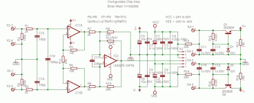

Hi Owen. Did your schematic look like the one posted a few pages back? What op amp and power op amp did you use? And finally, you made it sound like you never got to actually hear it. If you did, how would you rate it against a standard configuration? I'm slowly working my towards a differential signal chain
Upon request, here is the schematic with all part values. These are what I am using on my boards with very good results.
C14, C15, C16, and C17 are optional EMI/RFI filtering caps. I would recommend at least using C16 or C14, C15, and C16 if possible. C14 and C15 should be 5% tolerance or better.
C9 is an optional rail to rail bypass cap. 100V rating minimum.
R13, R14 and R15, R16 may need to be recalculated if you plan on changing the zener voltages.
R17, R18 are optional loading resistors. Be careful of the rated power dissipation if you decide to lower their values. I would recommend using these to help ensure a symmetrical supply voltage and to help discharge the supply caps when the power is turned off. This configuration only has a small turn on click and a small turn off click accompanied by some other rather quiet noises due to the op amp supply rails discharging.
Q1, Q2 can be changed to any suitable NPN, PNP devices. 2N3904 and 2N3906 are cheap and widely available.
IC1 is the dual op amp. I'm using the OPA2134 but other devices may be used. I plan on trying the LM4562 when I get the itch to swap out the 2134.
IC2 is the chip amp. I'm using the LM3875 but other devices may be used as well. If you use a different chip you may change the feedback resistors to change the gain of the chip amp. Be careful with stability issues and lower gain settings.
The gain of this configuration can be changed with only one resistor - R11. 20k gives an overall gain of 20V/V. 10k gives an overall gain of 30V/V. Set your gain based on your source and power supply voltages. The gain formula is on the schematic.
