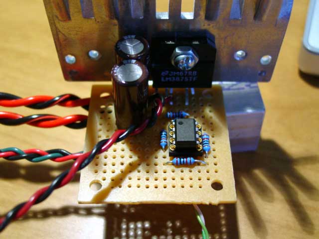

Here's a bare bones implementation of the instrumentation configuration. Lovingly cobbled together on high quality Radio Shack perfboard using only the finest bits and pieces lying around my workbench
It's wired it up for 2 dual supplies so I can independently adjust the rail voltages for the opamp and LM3875.

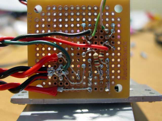

And the underside. Layout and wiring is straightforward since there aren't many parts. Removing the unused pins on the LM3875 helped make some space too. I opted not to include any bypass caps on either the opamp or LM3875 simply because I'm lazy and wanted to see how it works/sounds.
The blue body resistors on the top are 10k and 20k 1% metal film types. The two resistors on the bottom are 2k 5% carbon film types but I matched them to 1%. Matched resistor values are critical for proper operation of the instrumentation amp configuration.

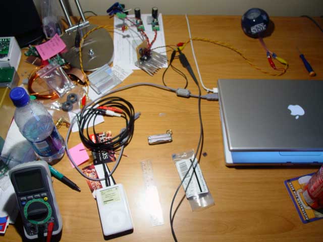

The prototype is up and running. I only have one amp so I hooked up my 8ohm speakers in parallel to at least get a front and center soundstage and used an old ipod as a source. To be honest I didn't expect it to sound this good at all! With no local decoupling and wires all over the place I expected at least audible hum from my speakers (90dB @ 1W/1m)... but there is none. Only if I put my ear right next to my speakers can I hear a faint white noise. DC output offset with the input shorted was about 10mV The OPA2134 opamp supply is a regulated +/-12V (~100mA current capability) and the LM3875 supply is also a regulated +/-12V (dual LT1085 regulators with 23-24V unregulated but very stable input) with a lot more current capability.
As you can see below my setup isn't even close to being optimal

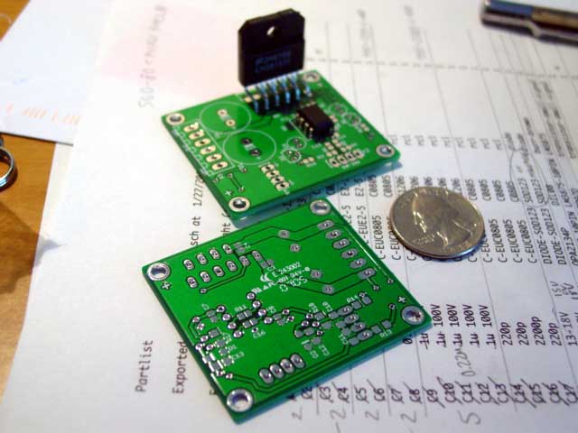

I've put in an order for some PCBs, so in a few weeks I'll let you know how they work. If all goes well, I'll have about 20 extra PCBs and will put them up for sale in the trading post. At the quantity I ordered, pricing will be $15 per board. The boards will be 2 layer, 2oz. copper, green solder mask, double sided silk screen, with outer dimensions of 2" x 1.75" (nice and compact), mounting holes for 4-40 screws, and mounting hole center spacing of 1.75" x 1.5".
a nice layout, well done.

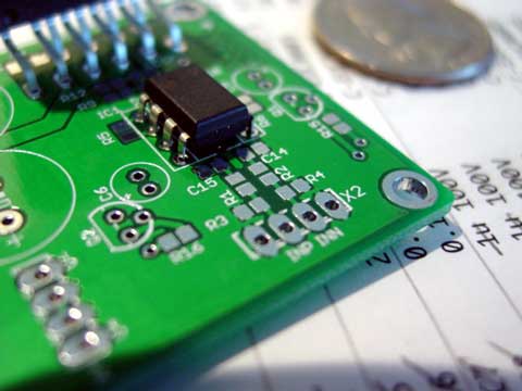

If I wanted to fit wired ended resistors, can the smd pads be drilled to insert the resistors in stand up mode? or are there traces on the other side? are the pads big enough for 0.7mm holes?
Matching of resistors for balanced mode cancellations should be better than 0.1%.
Why did you choose carbon for those two resistors?
Thanks Andrew.
There are traces and parts on both sides of the board and the pads are only 1.3mm x 1.5mm so you can't really drill through the surface mount pads. You could solder through hole resistors to the pads without drilling through them but it really is easier just to use surface mount resistors. I would have made a through hole part version but I'm used to working with SMDs and there's no way I could have made it as compact as the surface mount layout.
The feedback resistors should be matched as closely as possible, as should the input resistors and capacitors (if used). I plan to order 1% resistors and 5% or 2% C0G/NP0 caps and hand match them.
Those two carbon resistors on the bottom of the board are carbon simply because I didn't have 2kohm metal films.

They were delivered earlier than expected and they gave me a couple extra boards for free. They usually do that when they want to fill a whole panel Fit and finish are top notch as expected. Time to order parts...
If you're interested in parts as well, I could probably do that. However, the parts I plan on getting will be good quality and may end up costing more than you'd be willing to pay. For example, the resistors I have in mind (for the feedback, filtering, and gain setting positions) are 0.1% metal film types that are about $0.70 each at a quantity of 10 or more. The important ceramic caps will be C0G 1 or 5% types (others are X7R 10%) which are also around $0.80 each for 10 or more. Looking at my current BOM the cost of parts will be in the neighborhood of $30 (at quantities for about 10-30 amps), including the LM3875TF chip. If you were to get all the parts from my BOM for two boards by yourself the cost would end up being about $40 for parts alone.

The input common mode RF filter caps need to be matched or they will throw off the CMR. Think of the input resistors and caps as a bridge circuit. If the bridge becomes unbalanced then CMR is reduced. Luckily there are only two of these caps. The other way to cut costs is to not use them at all, in which case I would populate resistors in their place. In most/some cases they may not even be needed. I would still use the differential filter caps across the input pins of the opamps and the input pins of the 3875 to ensure that RF signals are common mode.
