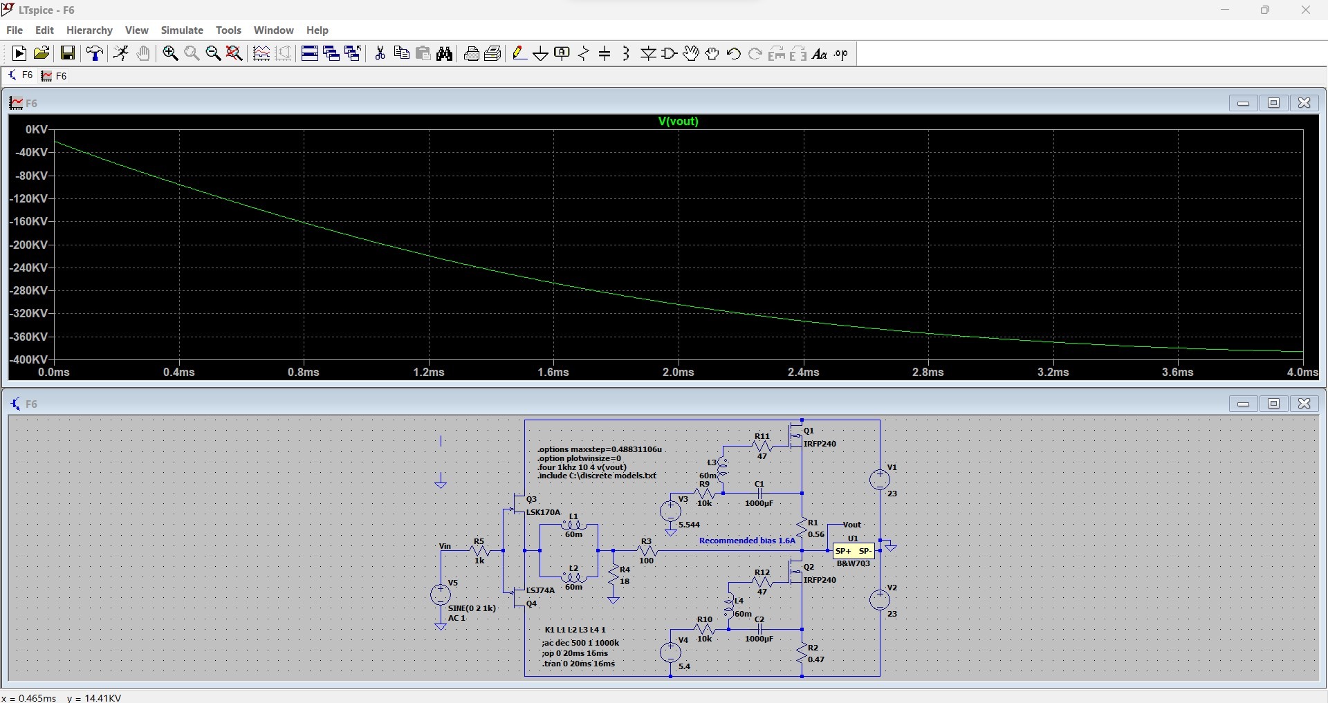

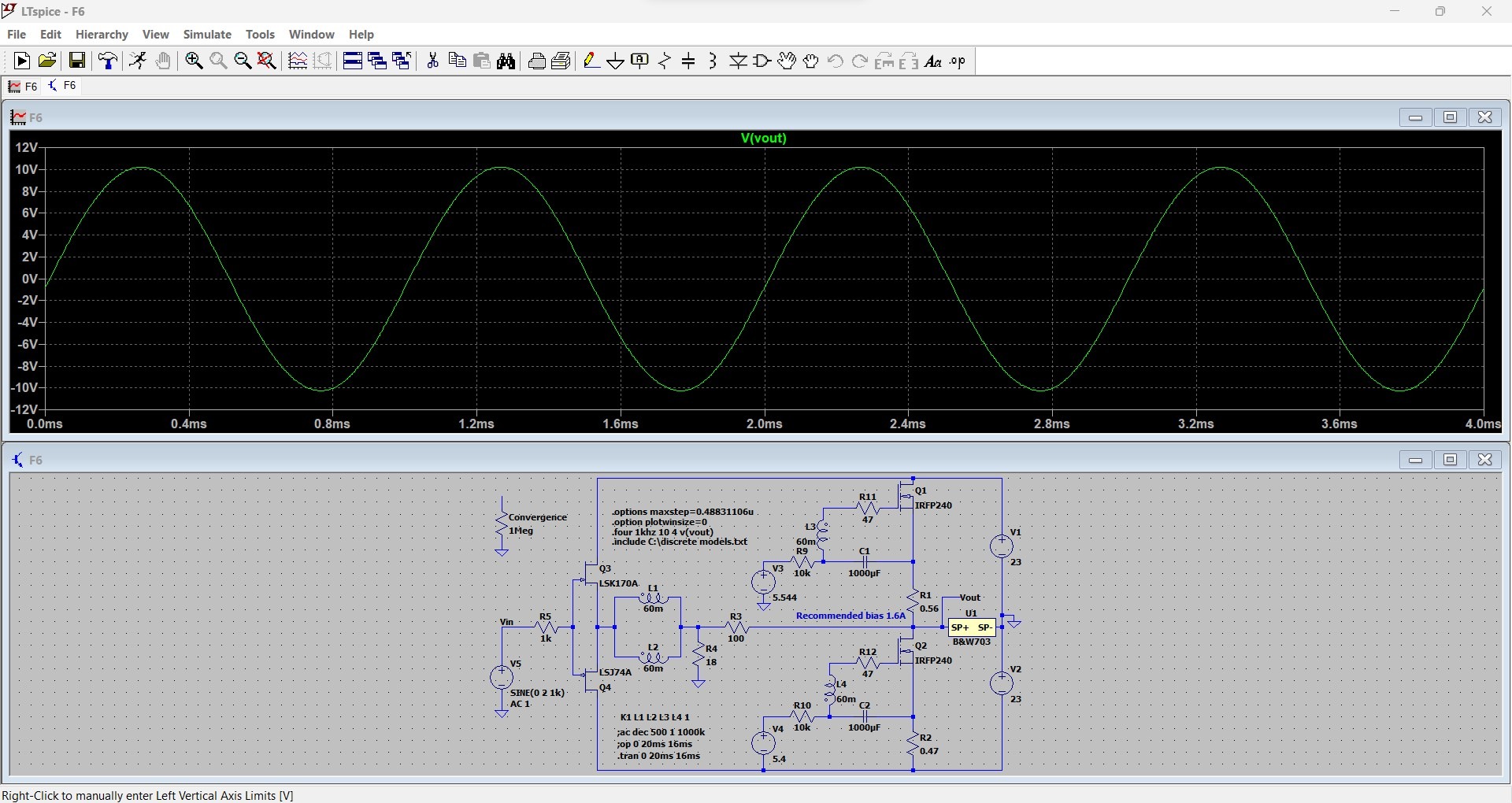

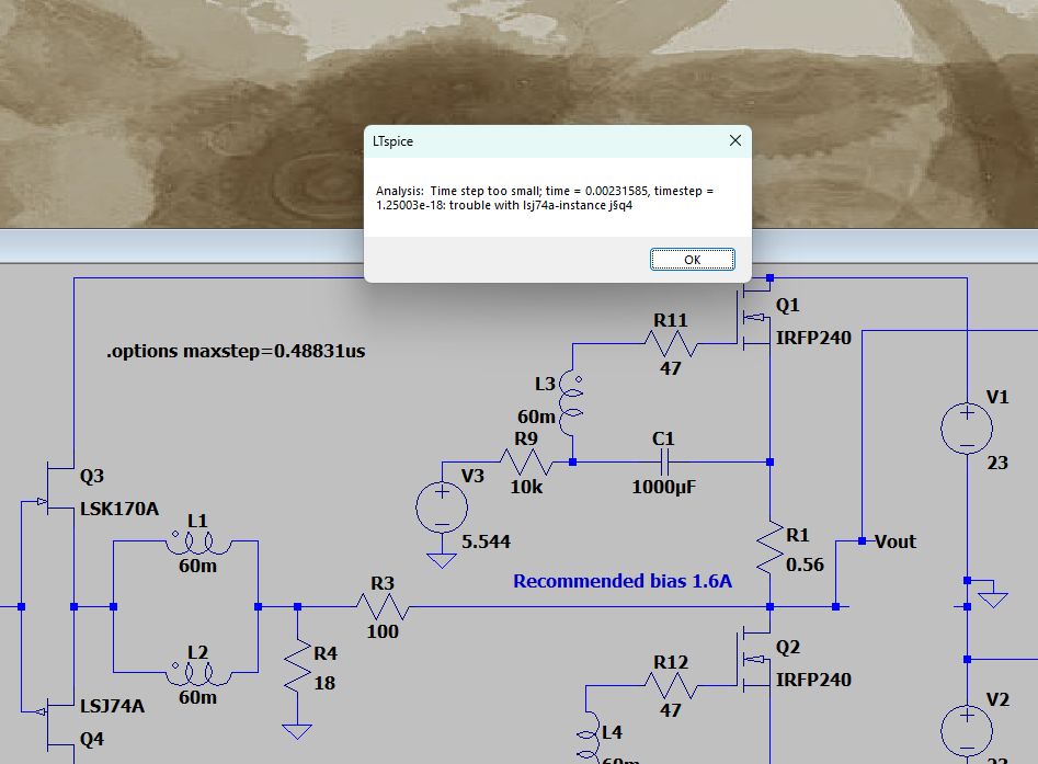

Strange convergence problem. I put a sim together of the F6 amp for fun and find it won't drive a model of the B&W703 speaker. Adding an unterminated resistor (any value, even a million meg ohms) to ground and the sim runs. Resistor at the top left.
And without. Look at the scale.
The speaker model actually starts with a series 1 ohm and so should not be to weird.
Do you mean that just having that resistor on the schematic, not even connected to anything but ground, solves the problem?
I do indeed, yes. It seems to work if you connect a single resistor to other points as well.
For example this works:
I'll post the two .asc's if anyone wants to try and also if anyone wants to try it on LTXVII.... in fact I'll do a new single sim.
Further discovery. The timestep seems to effect it. Delete that and it runs.

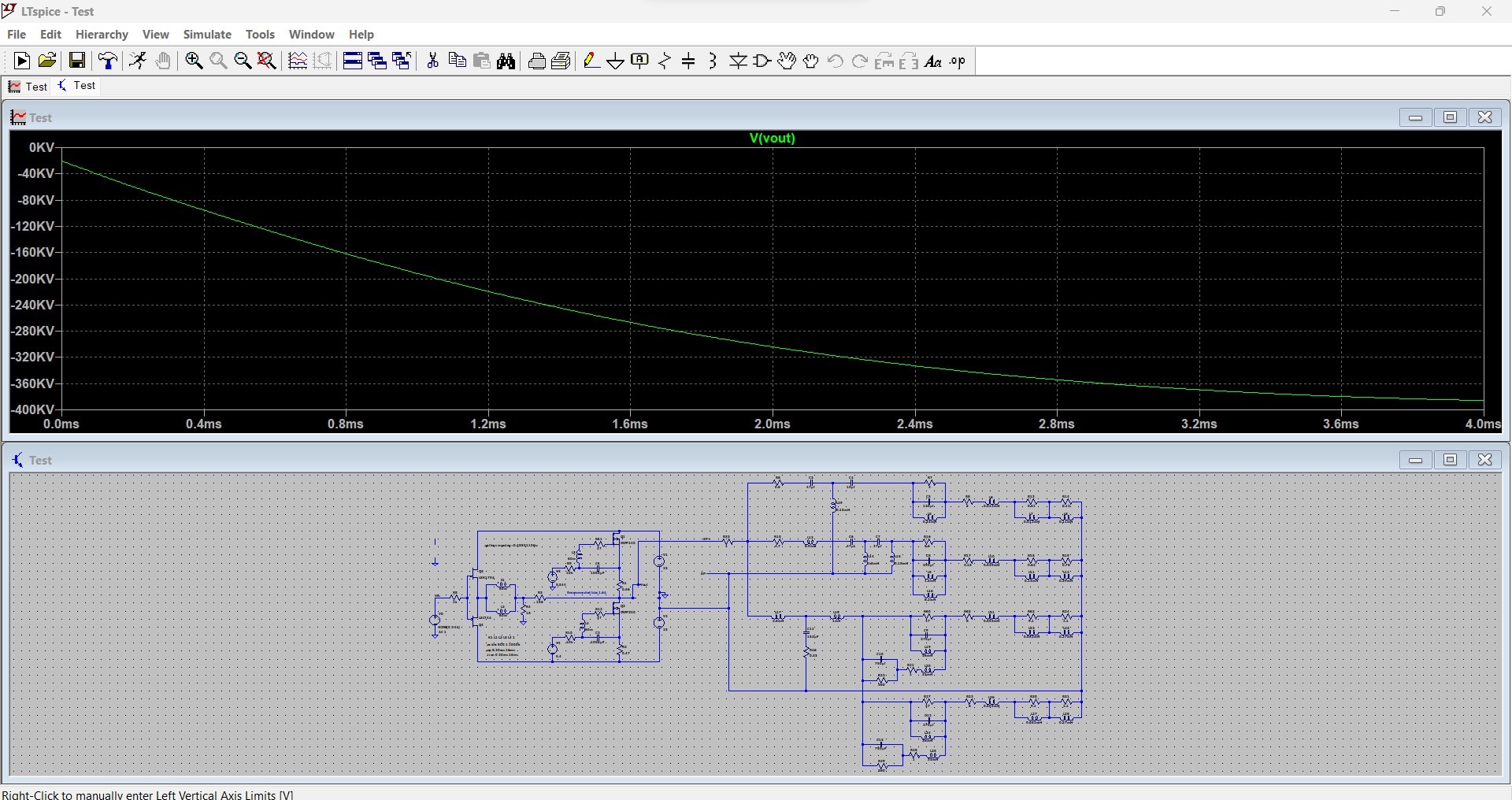

Here is a single sim. All default models, no convergence resistor.

I've certainly come across convergence problems before in the other version but this one seemed a bit different. Why would a resistor not connected to anything but ground get it to run... I have no idea on that one.

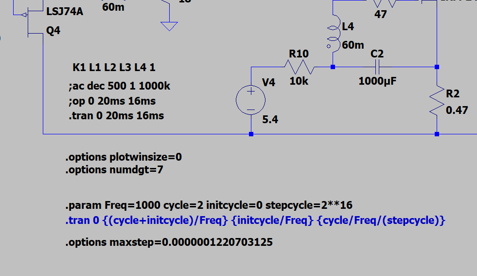

How are you calculating that value?'maxstep' should be chosen more skillfully
It certainly seems to work but then so does changing other things.
The last parameter in '.trans' is the maxstep.
There should be a power of two here (as a divisor).
0.0000001220703125 has been calculated as 2 to the power of 14
.param Freq=1000 cycle=2 initcycle=0 stepcycle=2**16
.tran 0 {(cycle+initcycle)/Freq} {initcycle/Freq} {cycle/Freq/(stepcycle)}
The time interval for the measuring points in the requested time window is always a multiple of two (2,4,8,16,...).
This is the same with FFT.
If there is no specification for 'maxstep', it is set automatically by LTspice.
LTspice sometimes doesn't accept the user's input and only strange things happen.

Interesting, thanks. I looked back to how I used to calculate it and I got a difference answer (lol)
So the sim runs for 20ms and gathers data from 16ms onward giving 4ms 'run time' for data. As I recall we calculate 4ms/262144 (which is the default number of samples LT is set to) and doing that I get 0.0152587890625us
Now that works and takes a wee while to run at 19 seconds.
Just trying the full 20ms/262144 as a timestep and that... well that actually freezes at 2.1% completed.
Maths is not my strong point I'm afraid
I'll have another play around.
Mooly, I ran your .asc in LTXVII and had no problem with whatever setting of timestep starting from 10nsec to 10usec including your timestep.I'll post the two .asc's if anyone wants to try and also if anyone wants to try it on LTXVII.... in fact I'll do a new single sim.
Hans
I used Mooly's .options maxstep= xxxxMaybe it depends on the processor of the PC.

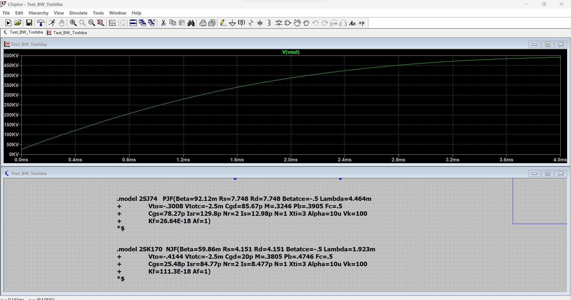

With Toshiba's JFETs it also works with the old timestep.
Now that doesn't run for me... is that odd?
If I change the upper 47 ohm gate resistor to this then it runs:
Which timestep did you use for this?If I change the upper 47 ohm gate resistor to this then it runs:
(at 47 ohms, not 47.0000001)
I ran it without altering anything and I can see the timestep I put in originally...
Which I took to me it ran with that timestep and your FET models.

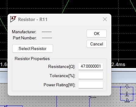

I ran further tests with version 17.0.35.0.
The 'Test.asc' file runs without errors.
However, there are problems with the 'Test_BW.asc' file.
In this case, if I change resistor R11 to 47.0000001, there are no more problems.
