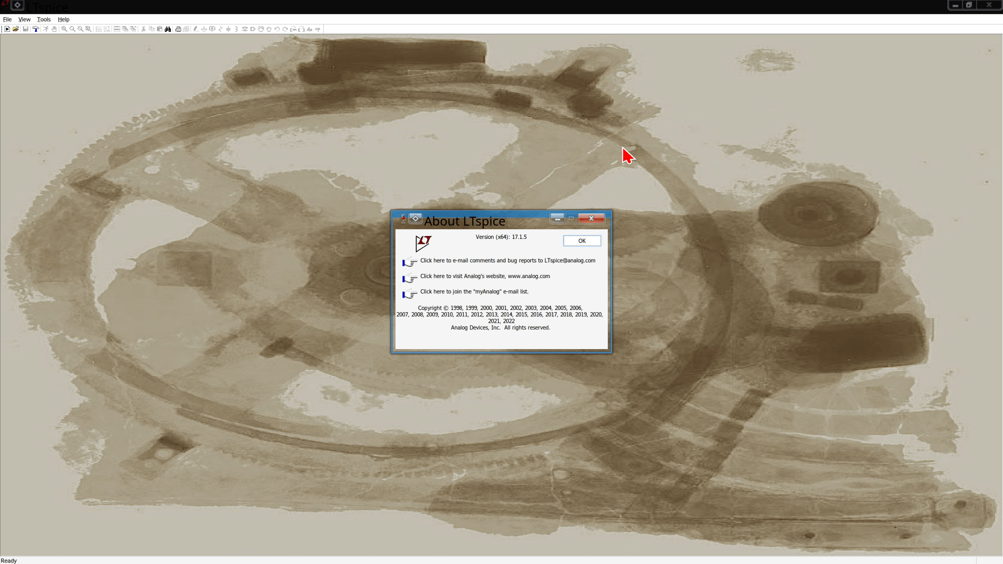

Hi Guys !! :)
Just poppin in to let you know that I have the new LTSpice 17.1.3 running under WINE in new a install of Kubuntu 20.04...........
I'll be settin' up 22.04 shortly ( again ! :headbash: ), while I'm waiting for the new stuff to come out again. :)
Not having a great time with 22.04, t looks nice and all but it needs some much ironing still ! ;)
No issues yet as far as the install goes, as I have yet to sit down and start creating some projects in it.
As far as do I know...............
The .asc's I do have seem to run just fine.
The only issue I have is since I switched to 2x 4K monitors all of the fonts ,icons, and most everything is smaller and very hard to read (see pic) . :/
Hopefully that can be fixed later. ;)
Else all is Great So Far !!! :D
Cheers !!! ;)
:cheers:
jer :)
