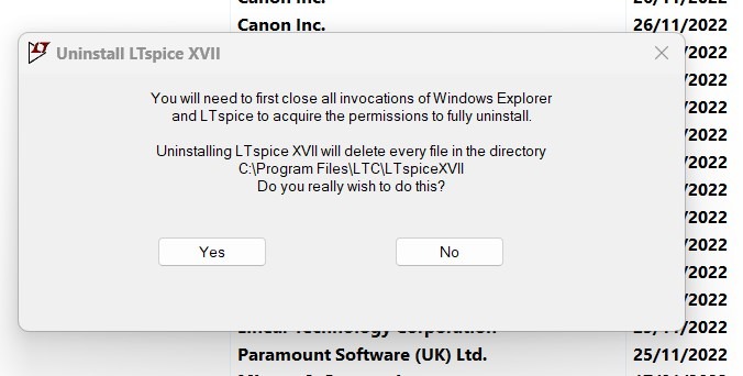

2/ Uninstall the existing installation of LTXVII via Windows 'Control Panel' by going to 'Programs and Features' and clicking on LTXVII. Follow the on screen instructions. Also
delete or unpin any shortcuts you may have on the taskbar, start menu and desktop. The program deletion will not affect any of the existing LT files in your user Documents Folder. This includes the 'Example' and Lib' folders.

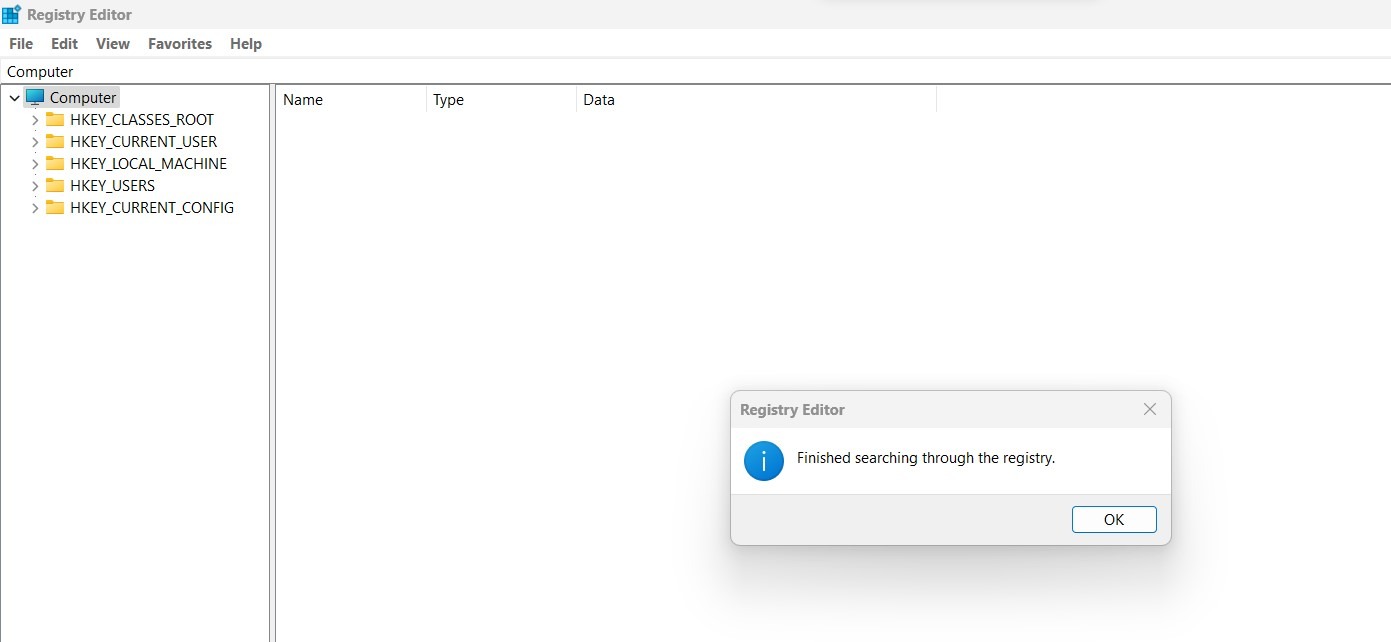

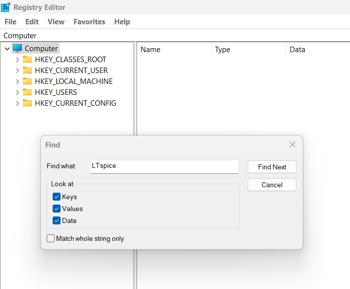

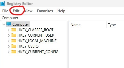

7/ Warning. Do this next procedure at your own risk. Modifying the registry can cause system instability if done incorrectly. What I am doing here is deleting all references of LTXVII that have been left behind following the uninstall.
Open 'Regedit' and click 'Edit' and 'Find'. Delete all entries relating to 'LTspice'. Use 'Find Next' to work through the registry. When completed restart the PC. A further check should now reveal no instances of LT remaining.

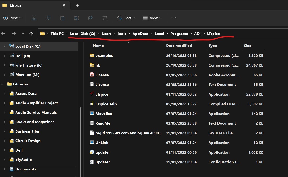

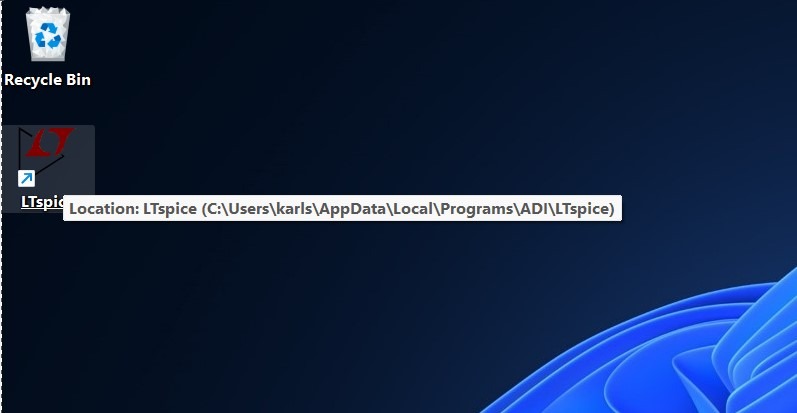

9/ You will now have a new desktop icon for LTspice. Hover over the icon and note the file path. I would recommend you create a text file and paste all these file paths to
that as a means of keeping a record of what is where. This is very important because the installation is now in a non indexed location which is a major plus point for
anyone who uses disk imaging. This is because the Windows index file is not normally included in a disk image and it can take a long long time to rebuild following a
restore. Before I started this I had around 38k indexed items. This figure is now around 25k with most of those 'missing' entries being the tiny model files included with LT.

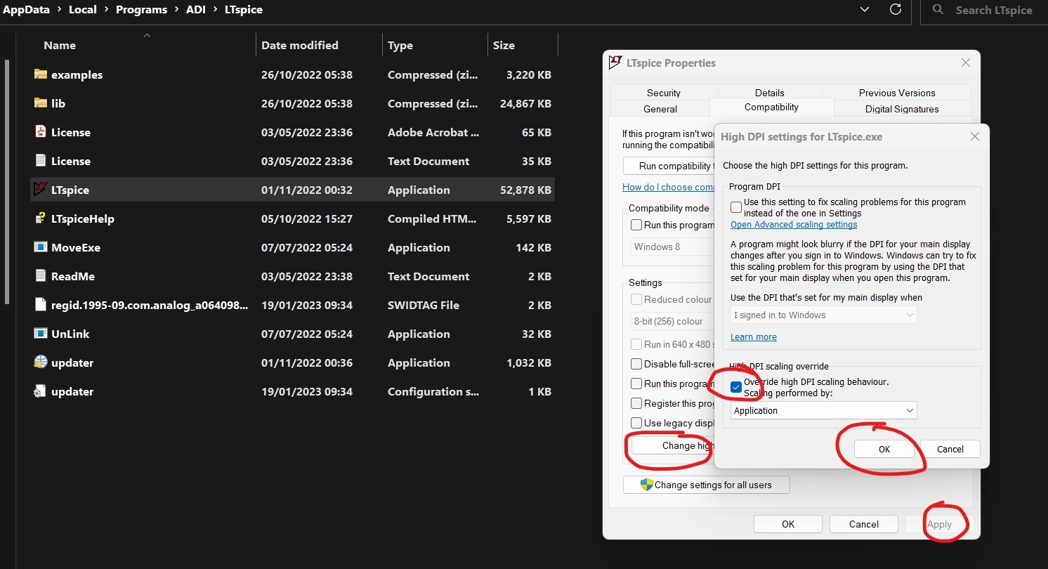

10/ The first thing I noticed opening the new version is that the new version doesn't scale correctly and the text on the top toolbars is not as sharp as it should be.
That may be because of custom setting I use within Windows. To correct this close LTspice and then right click the desktop icon and click 'Show More Options' and
select 'Properties'. Copy the file target file path which for me is:
C:\Users\karls\AppData\Local\Programs\ADI\LTspice\LTspice.exe
and enter that file path in Windows search box to open the location.
Right click the search result and select 'open file location'.
Alter the High DPI setting as shown.
11/ Reopen LTspice and the text should now be pin sharp. If Windows opens a box asking Did this program work correctly' answer as appropriate. Hopefully a yes.
I would suggest you now familiarise yourself with the main differences in how LT operates and works with files and folders. Remember that target file path from
earlier. If you look at that but this time delete the end part of LTspice.exe you will open the location of the files if you paste it into the Windows search box.
You should see the familiar 'Example' and 'Lib' folders are now located here (see above image). Notice they are now zipped (compressed) folders by default.

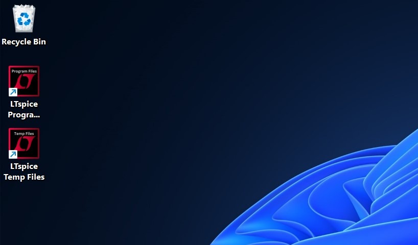

13/ At this point I think it useful to create a shortcut to open the location where LT now resides. I placed two Icon Files (.ico) that I created earlier in the new location that LT resides in and
created a shortcut using these icons. One is for the Program Files and one for Temp Files which we will cover later (Step 13 below).
To add the .ico image. Right click the shortcut and select 'Properties' and the 'Change Icon' tab. You need the file path of the icon to paste into the location box.
If the icon symbol does not display when applied to the shortcut then just 'refresh' the desktop.
The program file shortcut should open to this.

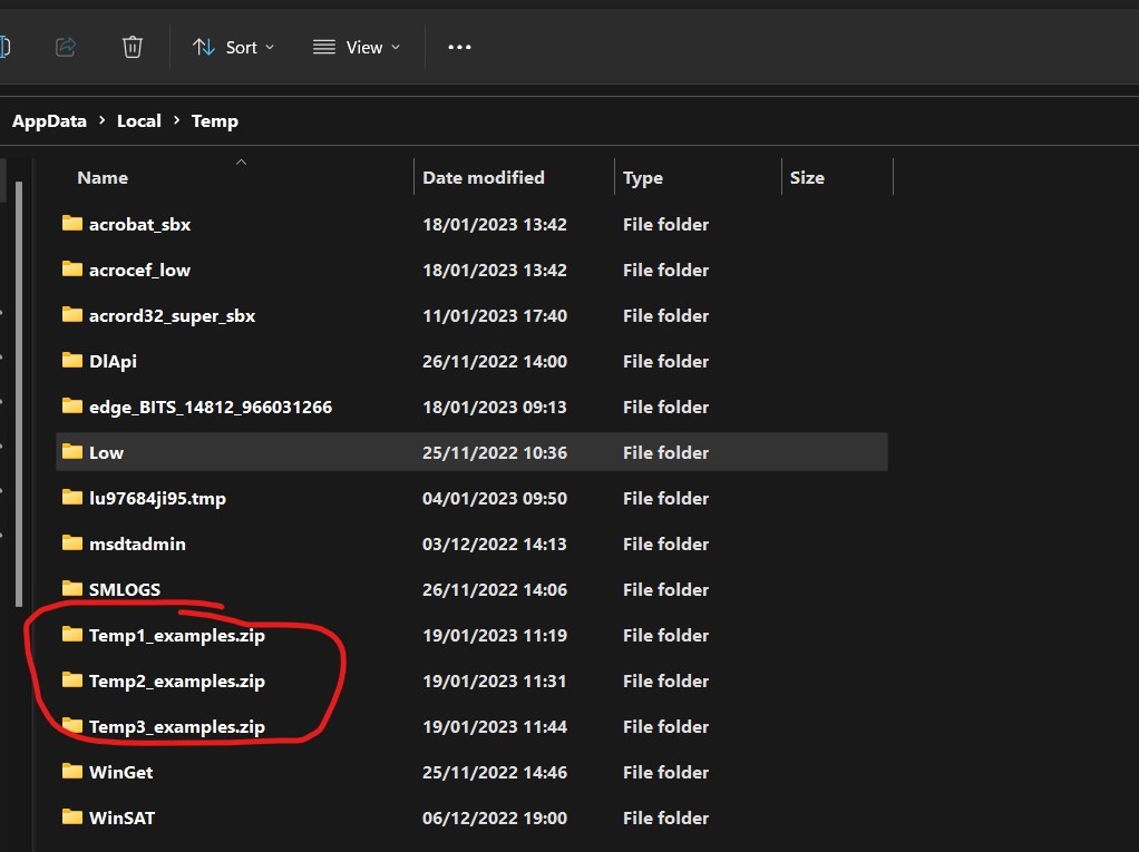

13/ We will now look at a major difference in the new version. Open LT again and click 'Control Panel' (the hammer symbol on the toolbar). Click the 'Operation' tab and
note the filepath for temp files. This is my file path.
C:\Users\karls\AppData\Local\Temp
I would recommend you copy and paste that file path into a new shortcut which will give you easy access to this location.
Close LT again.
14/ Navigate to this new Temp File location and you should see a Zipped folder that was created when you ran the example above. It remains there until you delete it. Each temp
folder contains the three temporary files we are familiar with in the old version.
Run another simulation and another zipped folder is created. So by leaving LT at its default settings we find we have a new zipped folder that is created for each occasion that a simulation is run.
This is something to be aware of this as the space these take up will increase over time.
Close LT again.
Keeping tabs on all these is why I recommend creating those two shortcuts to give you easy and instant access to the file locations.

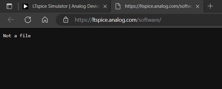

is it supposed to look like this when you click on the link
