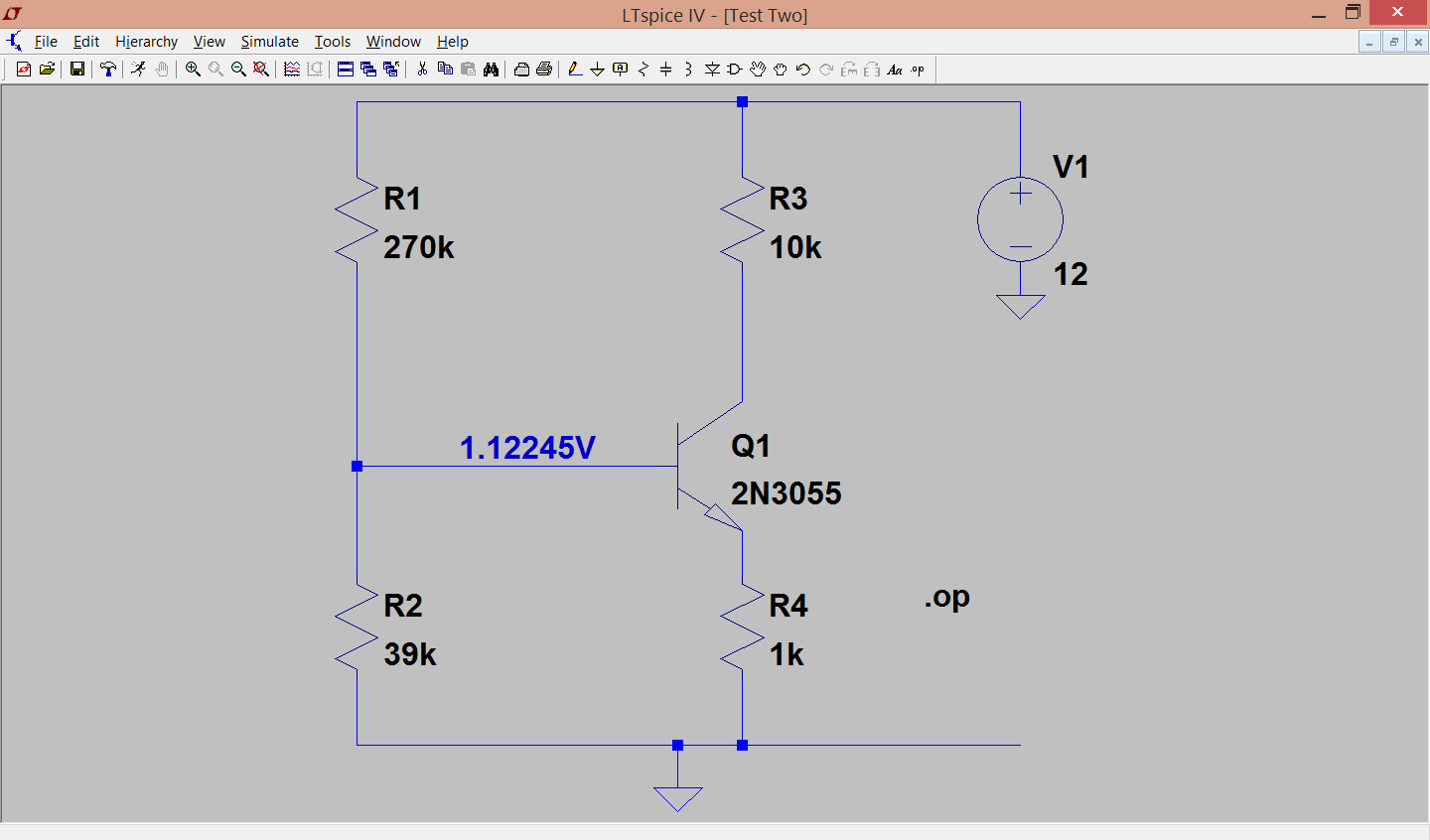

It doesn't show a voltage when I initially click on it or any time after. Just three question marks. Even right beside the 12 volt source shows question marks.
OK, I'll just talk you through what I am doing... you do exactly the same.
Attached to this post is another LT file devoid of all the commands. Its called Test Two.
1/ Download and open it.
2/ Right click the workspace and select <Edit Simulation>
3/ Select the DC op pnt tab and click OK. That lets you drop the .op command onto the diagram.
4/ Right click the workspace and select <run>
5/ Close the new window that opens.
6/ Move the cursor over the horizontal trace wire that goes to the base of the transistor.
7/ Left click it slowly twice and you should be able to attach a voltage.
Do you get that far ?

I've figured out what I'm doing wrong. My mouse is set too fast. By the time I get the second click I've moved off the wire slightly. Thanks.
Excellent. A speedy mouse 🙂

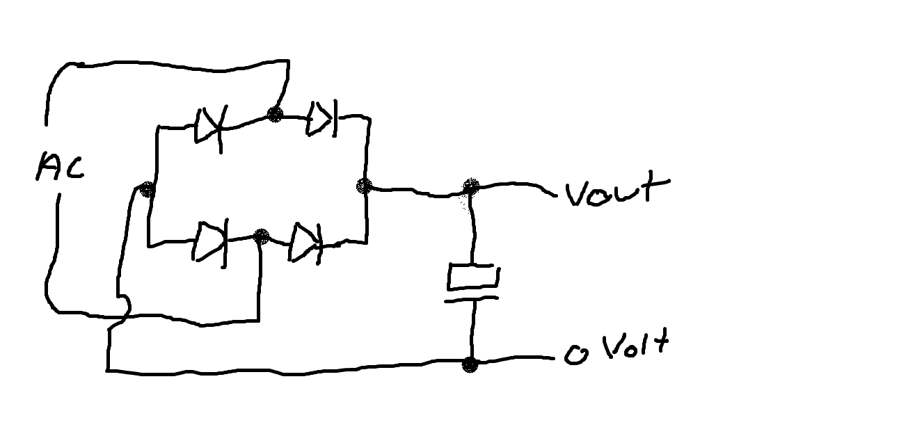

Lets now us LT to do something a little different. We will attempt to design a simple PSU and use LT to look at the voltages and ripple produced. We will build on that and later add a voltage doubler and a simple regulator.
Firstly we need some idea of the actual circuitry we will use. A typical idea might start off like this...

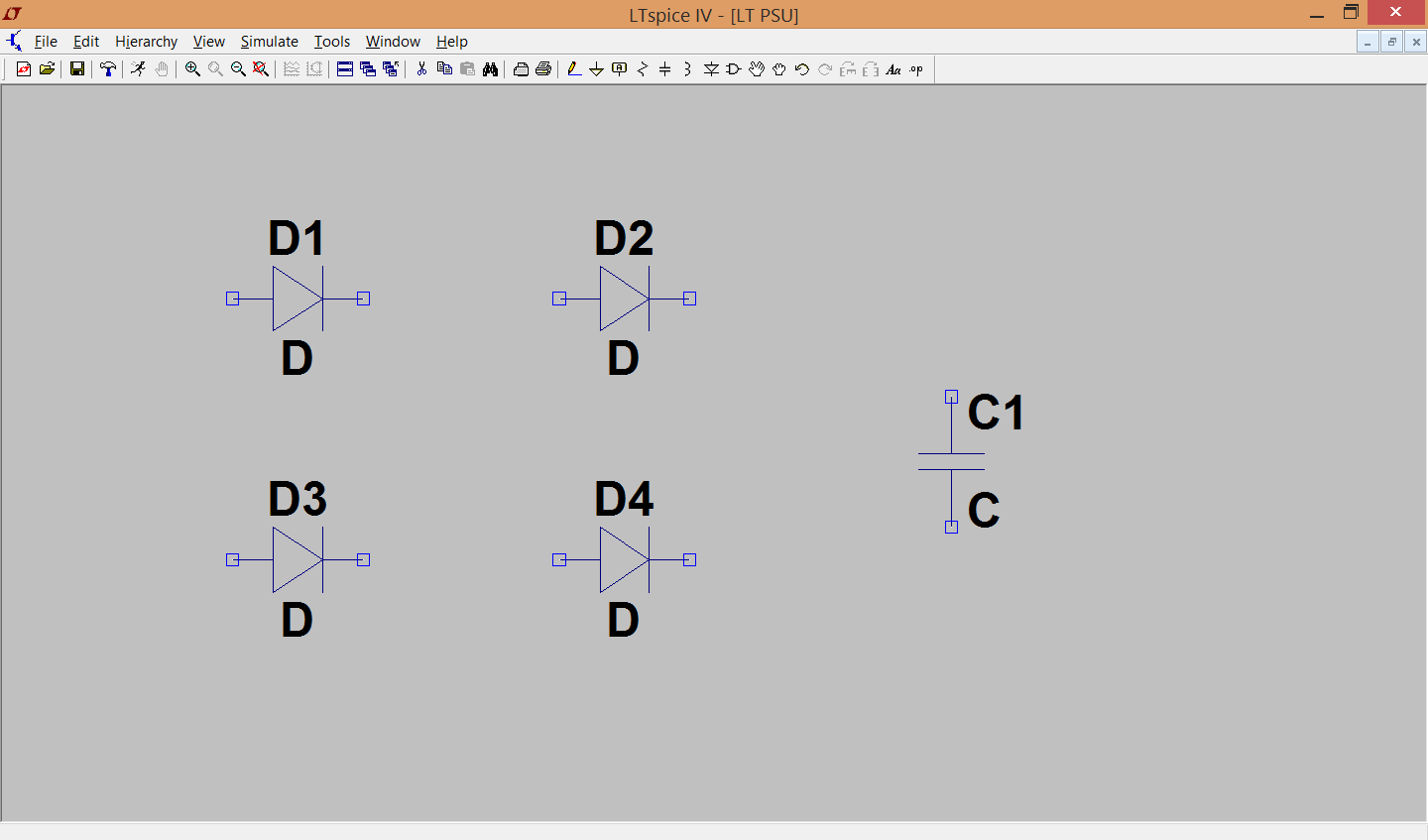

We need to translate that into a simultion so we begin by opening LT and creating a "new schematic" which you can then save under a new file name in your chosen location.

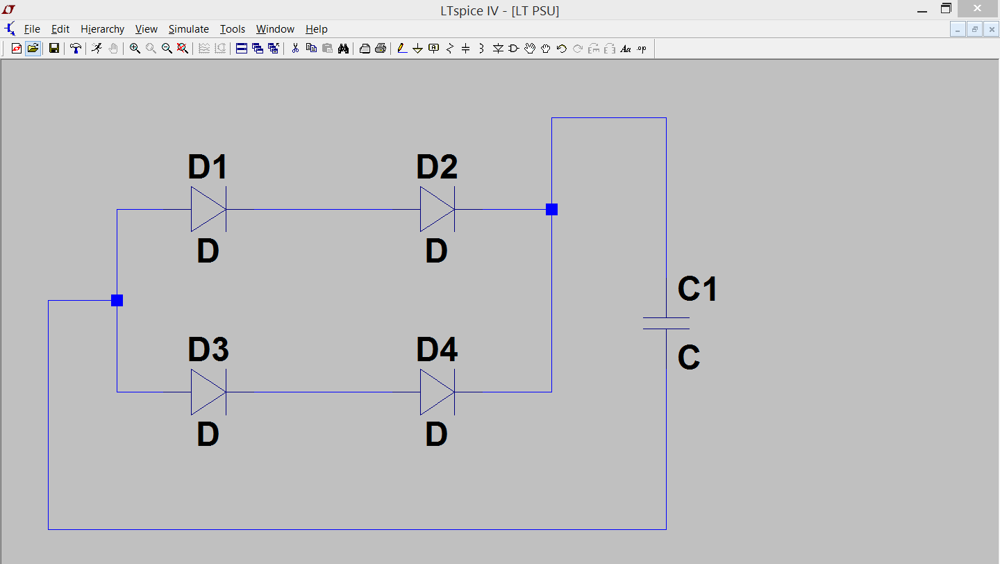

To build the circuit we need four diodes and a cap to begin. Click the "diode" symbol on the top line and drop four diodes onto the workspace. Before you make the drop, carry the attached symbol over to the "rotate" symbol (4th in from the right) and orientate them so that the circuit can be drawn out logically. Having dropped four diodes, do a right click to deselect the diode drop and now using the same method drop a cap onto the workspace.

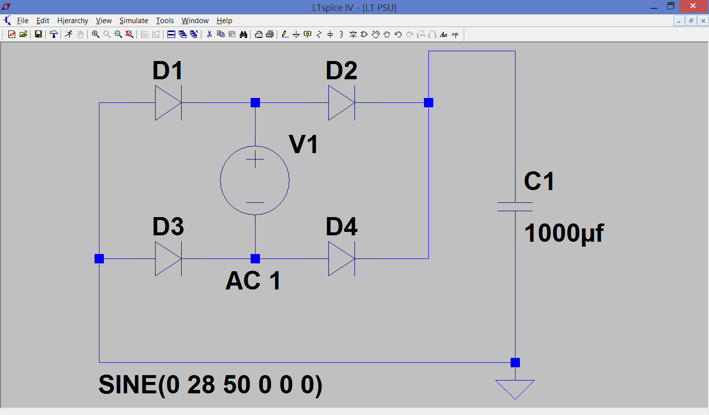

Now wire it up neatly.

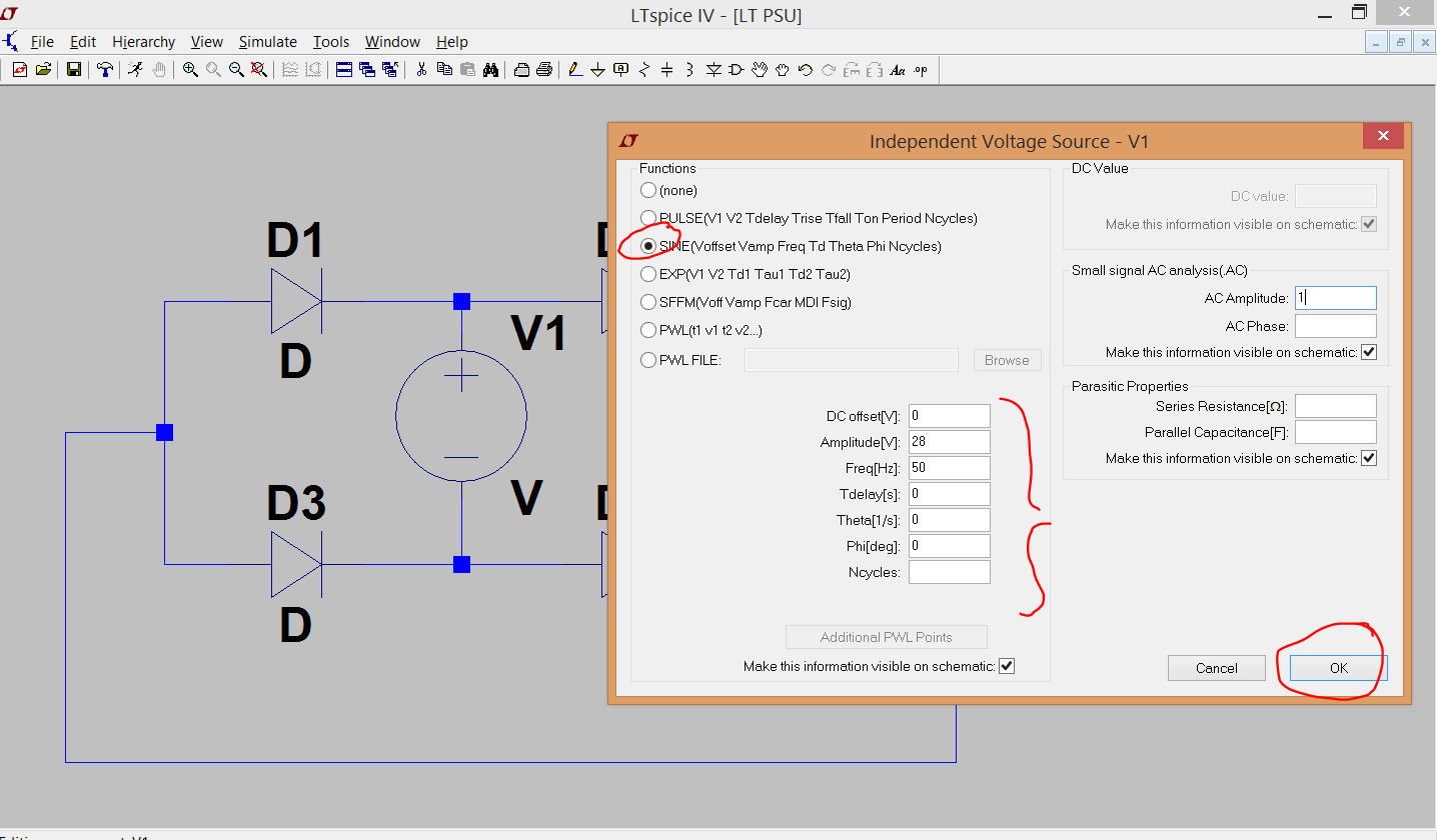

Our voltage source will be sinewave, just as if transformer fed. So we need to add a voltage source to the diode bridge input. Using the "component" symbol on the top line, open the component library and select a "voltage" source and add it to the diagram. Let us assume we have a 20 volt transformer. That 20 volts is an RMS value and LT needs a peak value to set the source up. So we multiply 20 by root 2 to arrive at 28 volts. We enter that value by right clicking the voltage source and selecting "advanced". We can also enter the other details at this point too.
What might be a good reservoir cap value. Lets use a modest 1000uf. Right click the cap and make the value 1000uf. We also must add a ground symbol to the diagram, so do that now attaching it to the 0 volt line. We also need a suitable diode. Right click each in turn and using the "pick new diode" option select the MURS320. That is a typical silicon diode. At this point we also tidy things up by using the "hand" symbol.
Information... if you right click the diodes text, that is to say the MRS320 text you get a window with options of how to palce the text, or to make it invisible if space is short.
So we can go from this,
To this.

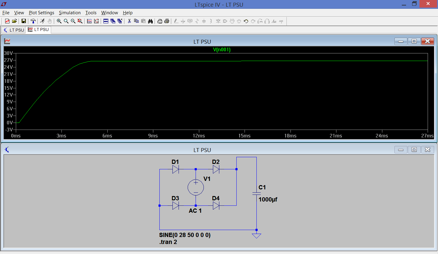

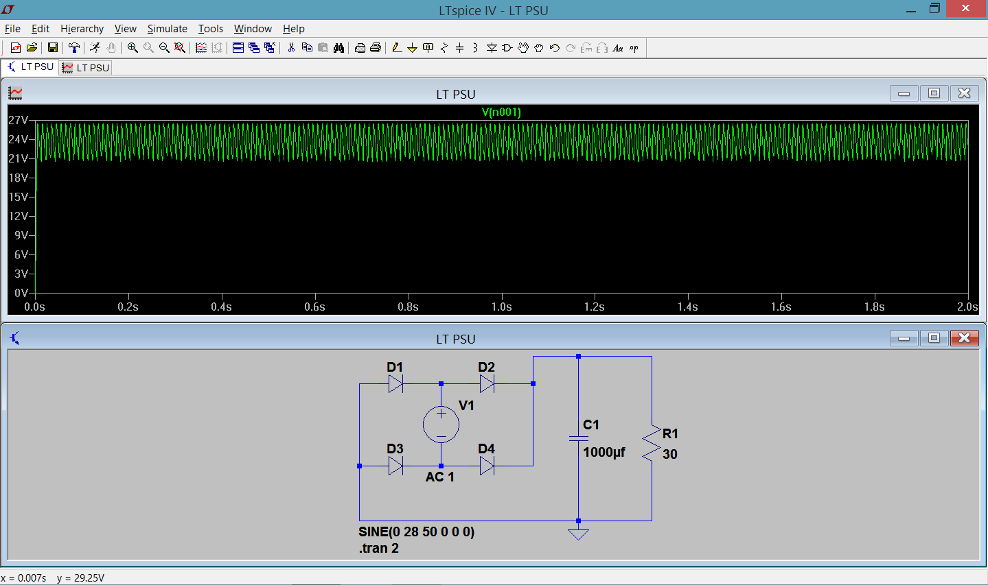

To simulate the circuit we will initially run the sim for 2 seconds, so open the <edit simulation> option (right click the workspace) and set 2s as the transient stop time.
Now run the simulation and probe the voltage on the cap. You should see a nice steady 27 volts or so (LT has correctly accounted for the diode volt drop of the bridge). Do you remember how we could expand any section of the trace by putting the cursor over the section of interest and drawing a box around the part to expanded ?
Look closely at the start of the trace. The charging of the reservoir cap is shown correctly and if you look at just that portion of the waveform you should see something like this.
Why have we no ripple on the output ? It is because we are drawing no current so what we can do now is add a load resistor of say 30 ohms.
That will draw just under 1 amp. You should know how to attach that by now so go ahead and add the part and re-run the simulation.
Now we have lots of ripple.

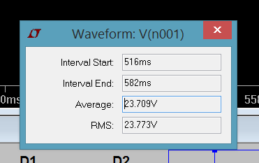

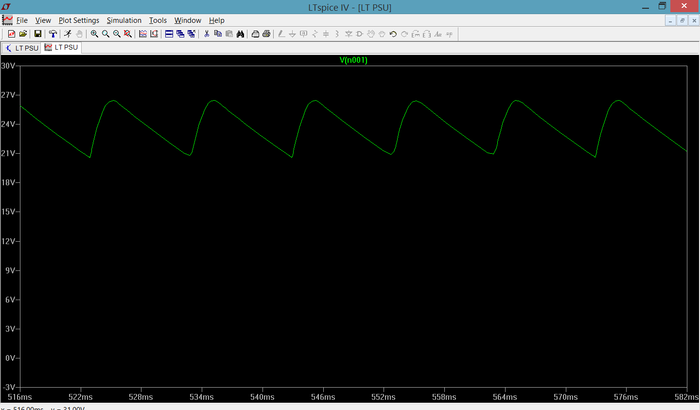

Expand the trace and look at the detail.
If you hold CTRL and left clcik the trace label then just as before, we can see the voltages.
