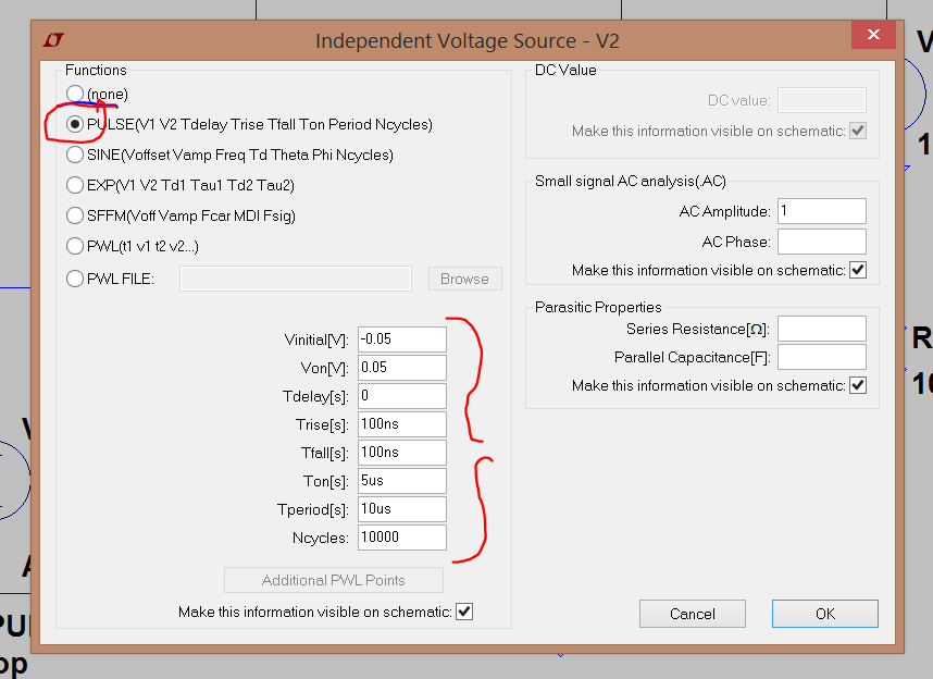

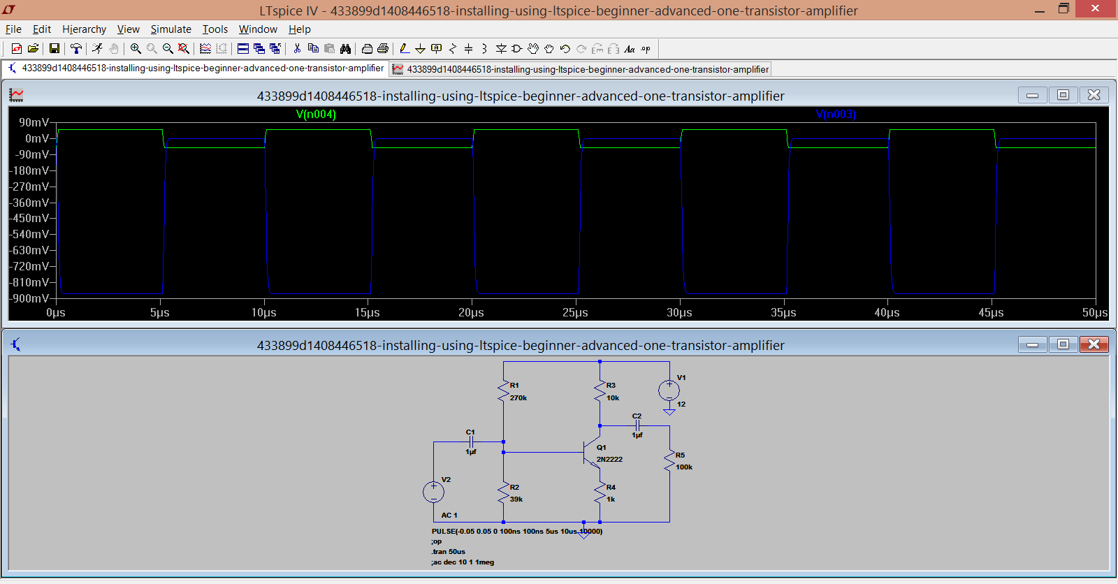

Open the file and change the input and output capacitors back to 1uf. Lets test the amp at 100kHz. To do this we now set the input voltage to deliver a
squarewave, so right click the voltage source and set the following options. Why so many cycles ? You will see in a moment. Click OK to enter the settings on the simulation.
Lets just run through those settings. You will notice we have to tell LT how long each cycle lasts and how long the "on" part of the cycle is. To do this we now calculate the period of one cycle. So 100kHz has a period of 1/100,000 (reciprocal of 100k) which is 0.00001 or 0.01ms or 10us. Whichever you prefer, LT will accept any. That is the period. For a squarewave we want it to have a 50:50 duty cycle, so that means the "on" time must be half the period. That is the 10us (period) and 5us (on time) settings. The amplitude is set by Vinitial and Von. In other words the voltage of the bottom and top of the squarewave. Setting one as a - (minus) value and the other as a + (plus) value gives a symetrical waveform centred on zero. The rise and fall times areself explanatory. 100ns seems a reasonable value typical of a mid range function generator. Tdelay sets the point into the cycle the waveform appears. So zero means it starts at the begining of a cycle.

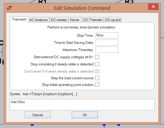

Now we have to set the simulation run time. Let us display only 5 cycles for clarity. The sim therefore needs to run for 10us (the period) times by 5. So 50us in total. Now open the <edit simulation> window and enter 50us as a stop time. We can't do distortion measurements on non sines so we can dispense with the maximum timestep.
Now run the simulation and probe the input and the output.
Do you see a problem ? or does it look OK.

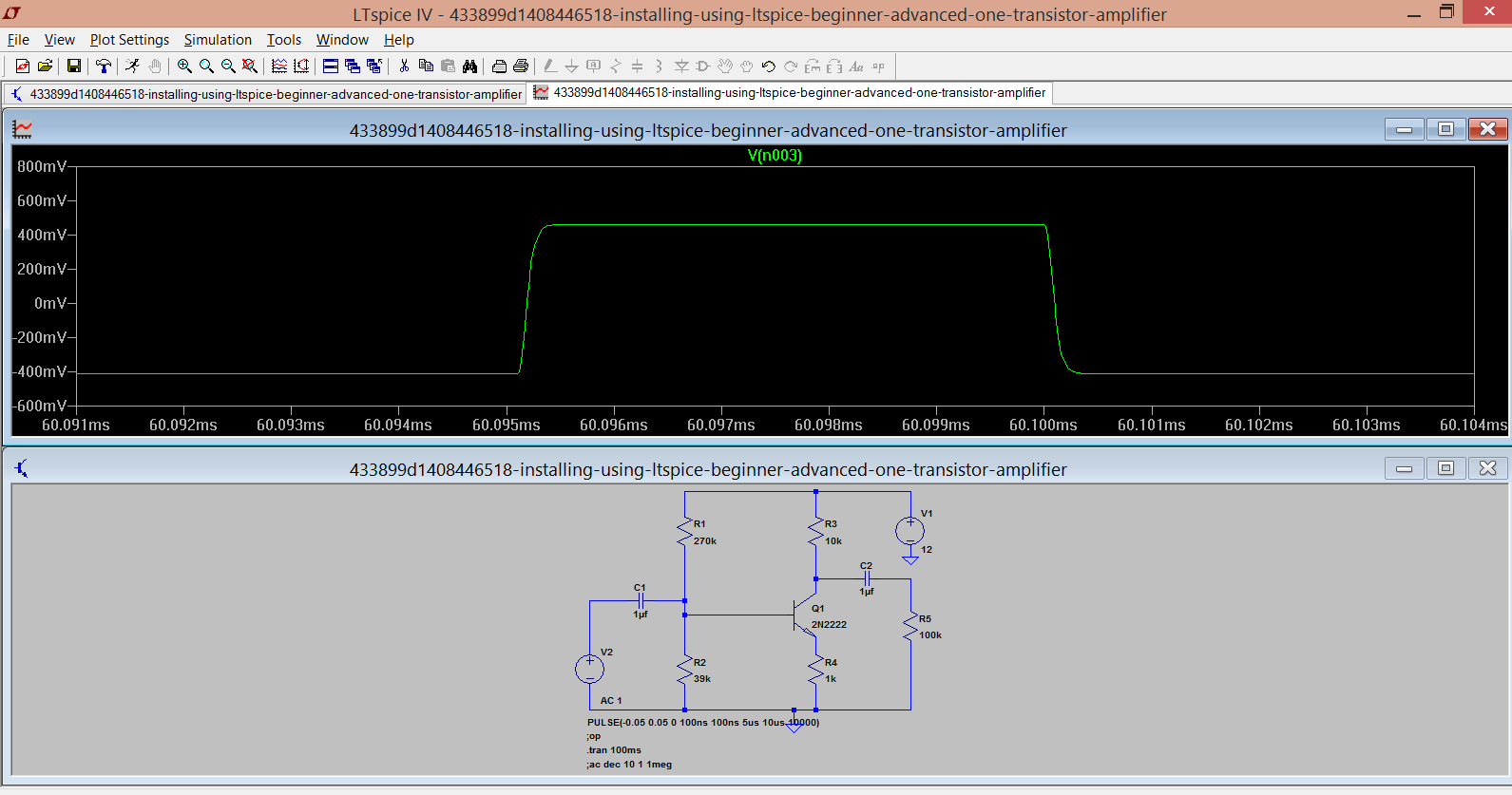

Double click the input voltage (the circuit nodes/traces not the actual source) so it is in focus and the only trace showing. Look at the amplitudes. It should be nicely centred around zero. Now double click the output voltage and look at the scale. Its all negative going. Now I know if I built this for real and scoped it, the output would be centred around zero. What has gone wrong ? Well again, it is the caps and their time constants.

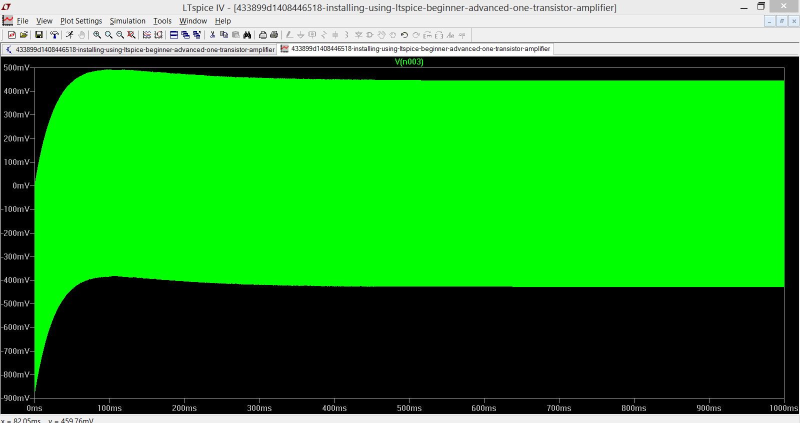

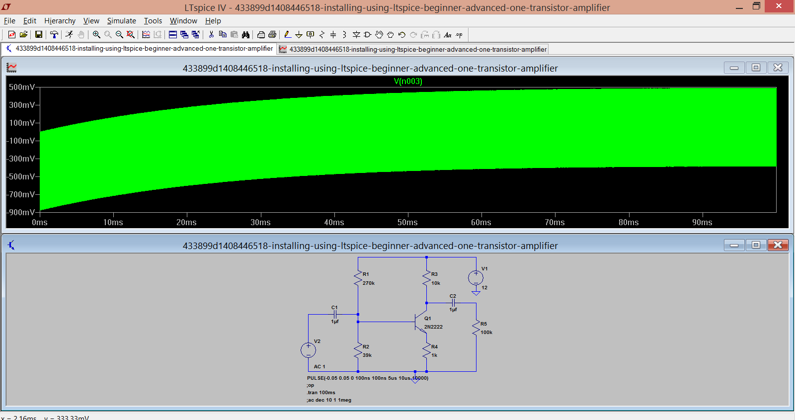

Remember all those cycles we added to the input voltage source. Well now change the transient tab (goto <edit simulation>) to 100ms and rerun the sim.
Do you see how the output DC shift rises. In fact 100ms isn't really enough but you get the idea and see the problem. I will leave it to you to experiment
with adding even more cycles and a longer run time (hint... just add a zero to both settings). If you run it long enough the output should settle to a symetric square centred around the zero line.

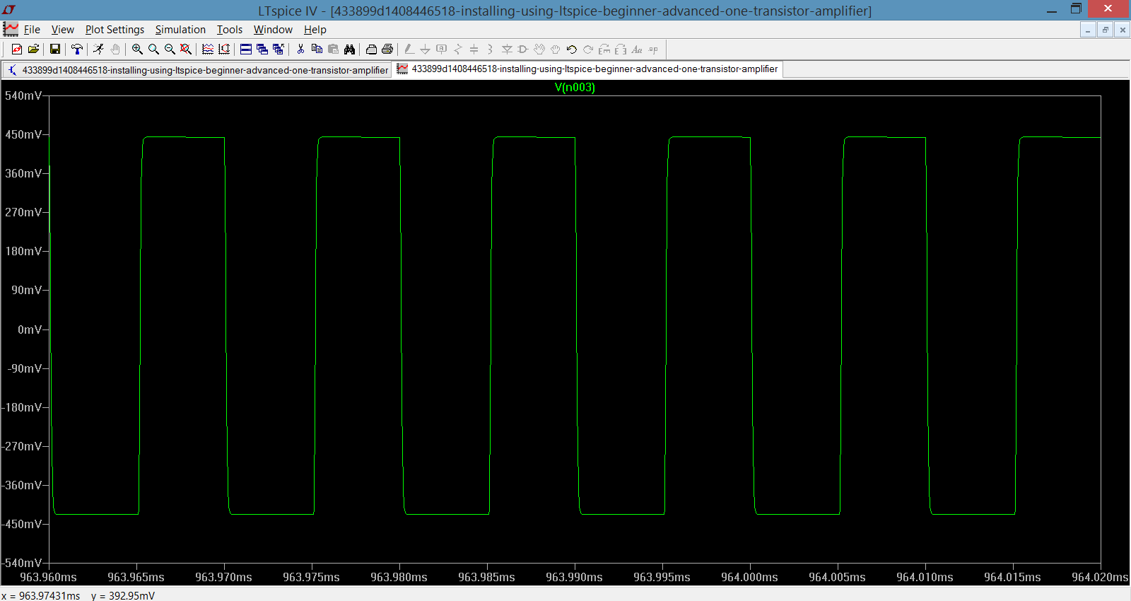

We can now demonstrate a new aspect of LT. If you now hover over a section of that solid green trace (must be above it in the black area) and left click
and hold and drag... you can pull an oblong box over the waveform. Just make the box a few mm wide and covering the top and bottom of the trace. When you release the left click that portion of the waveform is expanded and displayed. You can do it again and again to zoom in on any part. Want to get back to the original... simply right click and select "zoom to fit"
And finally for this section... I just learnt something new. Remember I mentioned about having enough cycles set to cover the run time you want. Well it seems if you leave the box blank it runs continuosly. So here is the output waveform settling to a value centred above and below ground as the sim is left to run for longer.
And expanding the last part of the trace as we outlined earlier, we can see that after 1 second the output is pretty much stabilised.

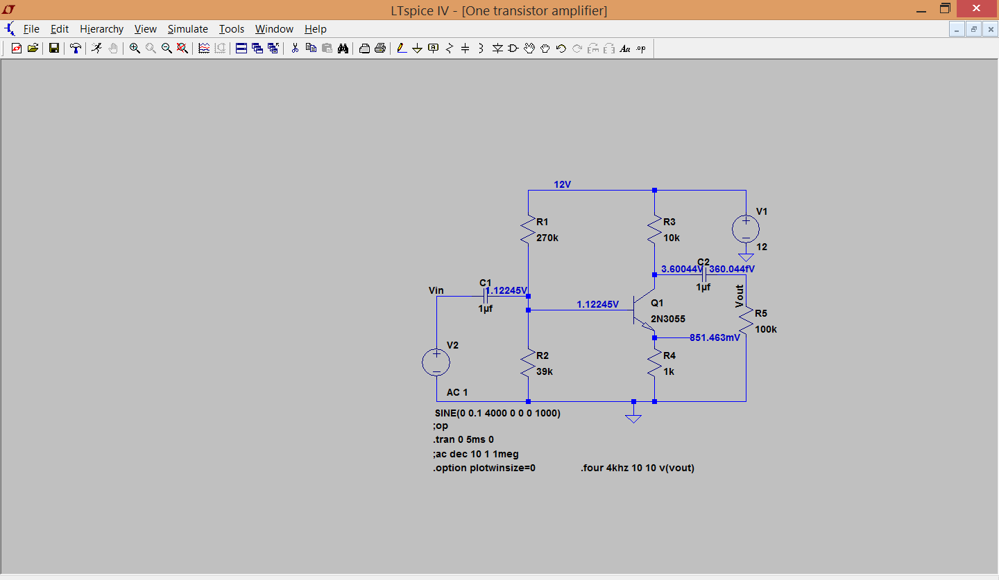

If you can go back to the basic circuit and set it up for a 4kHz sine input of 0.1 volts amplitude and also set the <transient> tab for a stop time of 5ms. Leave the "maximum timestep" box blank.
An non deliberate error has crept in to the screen shots of post #16 (AC Analysis)... anyone spotted it ? ... but we are going to replicate that error now in order to show how to gather useful information from the various traces. I say an error, it was actually me taking a screen shot of the frequency response (the AC Analysis) using the 2N3055 I asked you to revert back to use the 2N2222.
So can you now make sure you have the 2N3055 selected as the device to use. Set the <AC Analysis> tab for a "decade sweep", "ten points" per decade and start and stop frequencies of 1 and 1meg respectively. Click OK to bring the tab into focus on the diagram.
Now run the simulation and you should see the response like this.
What would be the -3db or the 10db points ? You can estimate just by looking at the graph but we'll go one better than that.
If you right click the trace label at the top (the V(vout) text) a window opens. Select 1st and 2nd from the drop down menu and click OK.
You should see this.
Now drag (by left clicking the vertical cursor lines) along the trace. The values relating to each are displayed in the window at the lower right. So by moving the cursor to midband and noting the level you can then move up or down the trace to find where for example the -3 or -10 db points might be. The midband gain is around 18.7db and so the -3 db point is at 15.7 db. You can see that here with the overlaying cursors. The window gives the frequency and amplitude of each cursor.

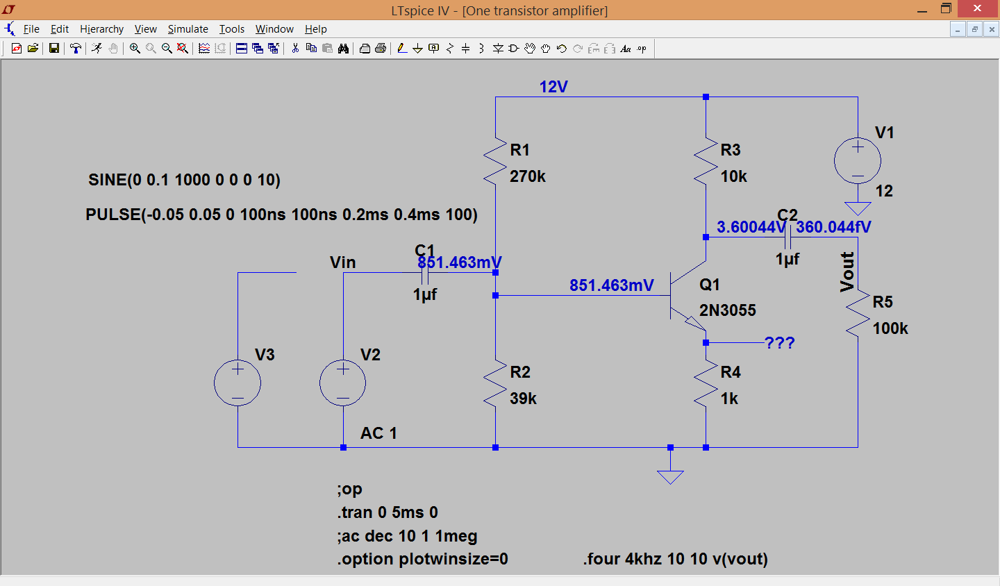

Setting up multiple signal sources and running two simulations in parallel.
Please explain the sine(0 1 1000 0 0 0 10) and similarly for pulse and others.
How do we supply two signals?
Can we change from one signal type to another and back again?
Can we gate a sine ON and OFF? and start at different parts of the waveform eg max +ve voltage, max -ve voltage, or zero voltage or some other?
same for a stream of pulses that needs repeating?
And a big Thank You !!!!
Lets have a look now at some more of the questions Andrew raised. The first we have covered, the second, changing from one signal to another......

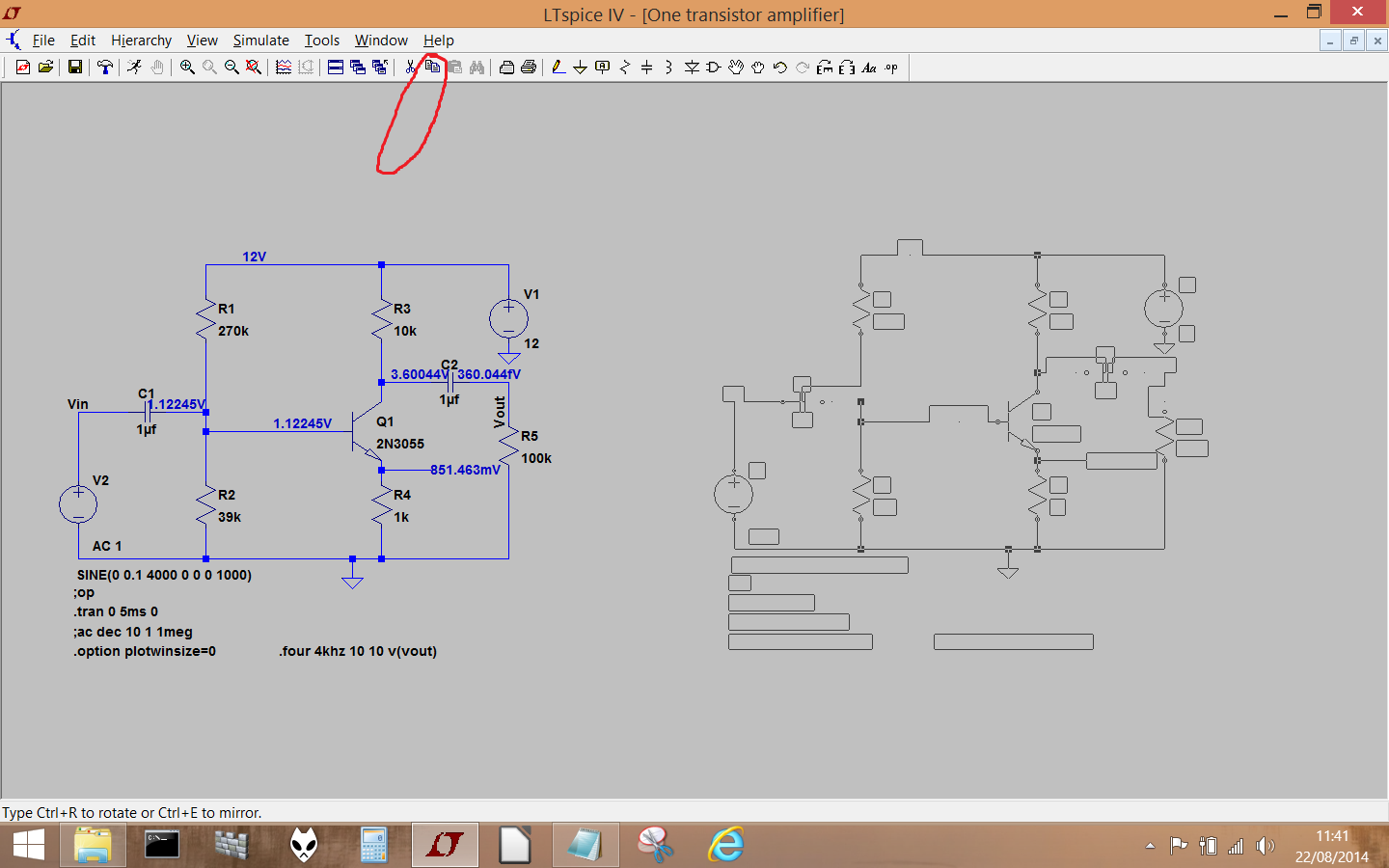

What I tend to do for that is this. I set up the required inputs, say a sine at 1v and 1kHz, a sine at 10kHz and perhaps a squarewve as three separate voltage sources. I then use the scissors to cut and connect just the required source.

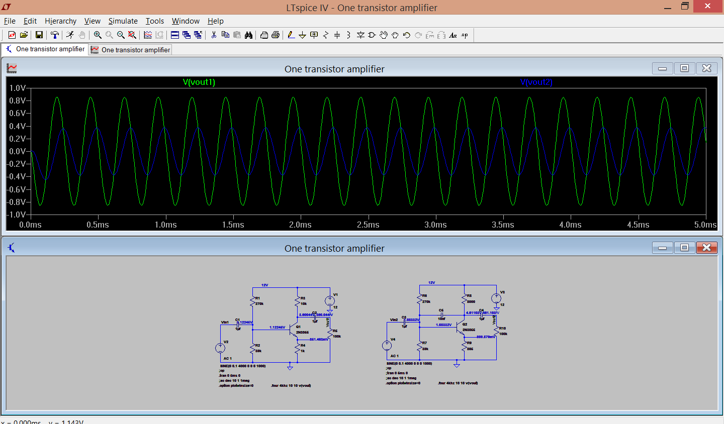

One neat trick with LT is that we can copy a circuit and run it in parallel to the original. Suppose we are optimising some aspect of a design, squarewave response for example. This is one way to do it.
Open the sim and set it all up for the appropriate simulation to run. Now zoom out the circuit to make it smaller.

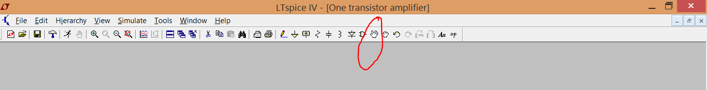

Now click the "Move" symbol.
Place the hand at the top left of the circuit such that you can drag a box around all the circuit and commands because that is what will happen when you left click. You will find you can place a box around all the circuit and its commands. Make sure you cover everything (or that bit will get left behind). Drag the circuit to the left of the screen and drop it down with a left click.
Now use the <copy> tool and again draw around the circuit and drag a copy over to the right and then drop it down on the workspace.
As it now stands the circuit won't run because there are duplicated commands and voltage sources. So it needs a quick tidy. Actually, its just the now paralled Vin tags that are the problem. We can cut them out, or relabel them. I've relabeled them as Vin1 and Vin2 and also relabeled Vout in a similar fashion. You could also run both circuits from one source and one supply. Remember to use the "zoom to fit" option to centre it all on the screen again (right click workspace). I've now altered the right hand circuit, changed a resistor and added a cap to make them perform very differently.
Now run the <transient> simulation and you can probe both circuits... great if you examining minor changes, one vs another.
So there is huge potential with that trick.
