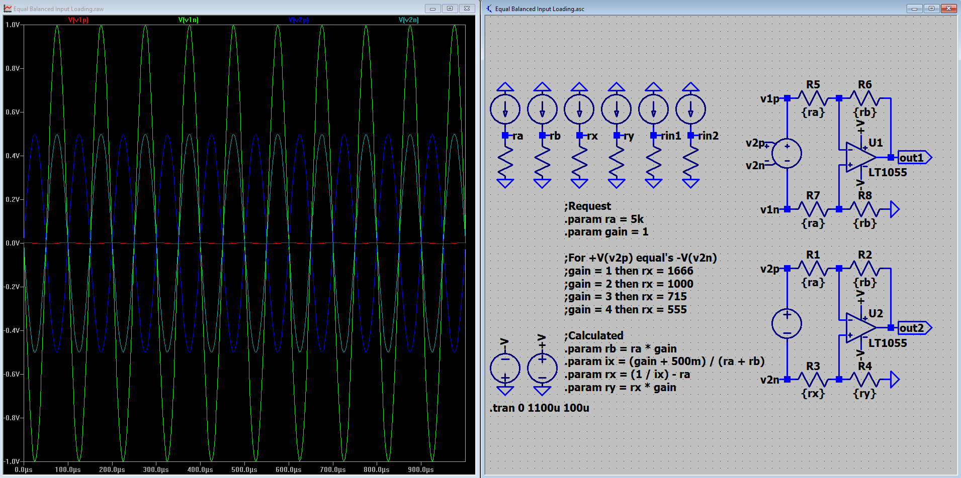

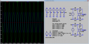

Not a THD calculator (sorry) but a resistor calculator, just one of the uses for a simulator (as a calculator). This was actualy an interesting problem, I wanted to calculate op-amp-gain-setting resistors for equal voltages (against ground) on both input pins. Demonstrates using the voltage-dependent-voltage-source 🙂
