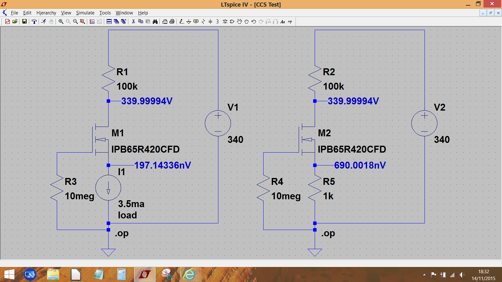

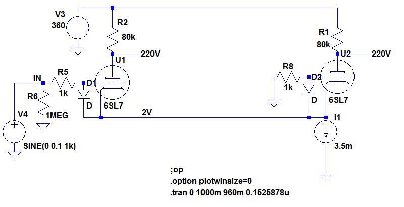

I now found another glitch. I have trouble getting some circuits (but not all) containing ccs to work properly.
In teh circuit below, a rather simple LTP, I get the right op points in DC, but in transient, the AC signal at the plates is in the microvolts range. If I put a 1k resistor in parallel with the CCS, then the circuit works correctly. Any idea why?

No. The calculated gain is >30 from input to each output. Paralleling the ccs with 100k gives a gain of 0.1 and with 1M something like 0.01. The gain is basically what I would get with just the R and no ccs at all.
It runs just fine... GIGO, please check your tube model.
I use Kevin's model from the sticky thread in the tube section. Worked for me correctly in other circuits. But I'll try the Ayumi model and see what happens.

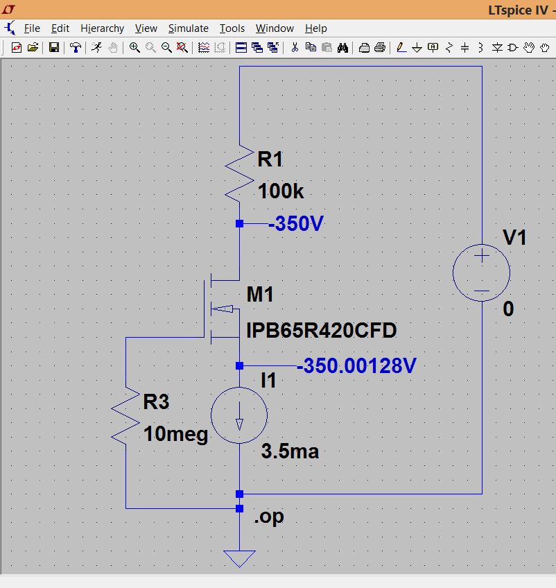

I just threw a CCS into a quick sim and it didn't behave as expected for me either. The current source actively 'pushes' its set current value into the circuit, in other words its fundamentally different to a 'current sink' as we know it.
The voltages in the right hand part of the first diagram are correct.
Try this and see if it works correctly.
OK, found my error. I used node labels to label my 2 plate dc voltages, instead of text. I didn't realize that when you use the same node label in 2 places, it connects the 2 points electrically but you don't see it on the diagram. I had assumed the node labels are for user clarity only and the sim keeps its own node numbering system.

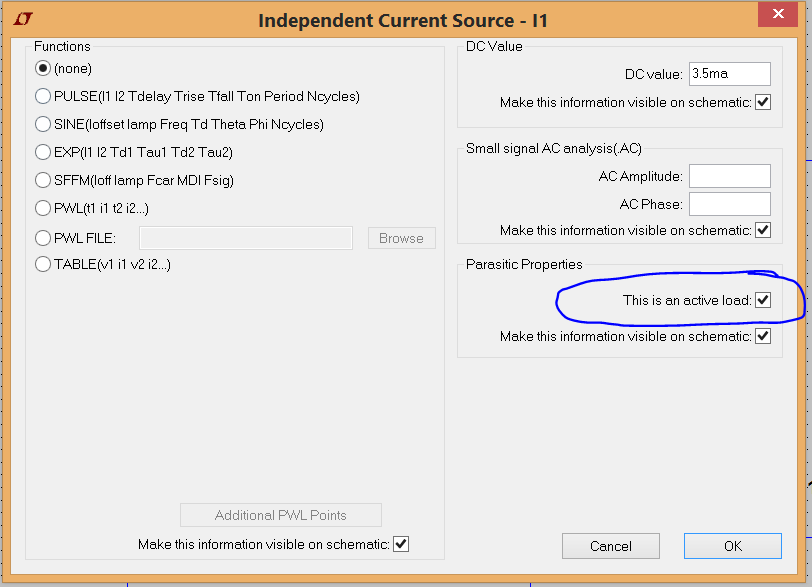

Edit: I don't know what it means and what it does when you check the "active load" box, but when I had ccs issues, it didn't work right with either setting.

Syntax: Ixxx n+ n- <current> [AC=<amplitude>] [load]
This circuit element sources a constant current between nodes n+ and n-. If the source is flagged as a load, the source is forced to be dissipative, that is, the current goes to zero if the voltage between nodes n+ and n- goes to zero or a negative value. The purpose of this option is to model a current load on a power supply that doesn't draw current if the output voltage is zero.
This load flag looks promising, would have to play with it to see exactly what it does.

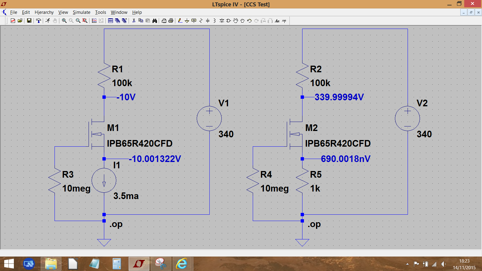

The perfect current source isn't really what we want in the tail of the LTP because it will force its set current back into the circuit. You only have to reduce the supply voltage to zero to see that the current source back feeds everything, developing a negative voltage. Change the 'active load' flag and it behaves as expected.
I'm not a regular user of LTSpice, but when I tried the LTP circuit that dgta posted, it made no difference whether the Active Load is switched on or off, they both worked without issue.

I can't quite understand this if I'm honest because the current source in LT has in effect, an infinite open circuit voltage. So why does that sometimes work as expected in a circuit and sometimes not. If you place a 1ma current source into LT and slap a 1meg across it you get 1kV across the resistor. So although its a current source, its also a voltage generator when presented with a load.
Sure all curent sources produce voltage to drive the current thru the rest of the circuit. Just like a voltage source will produce current to keep the voltage constant across the circuit. The problem comes from perfect sources. Which will output infinite current/voltage in either polarity if needed to keep the current/voltage constant.
Yes... but... when you think of the real world LTP example and having a 'current source' in the tail, that current source would often be a single transistor, or a FET, both of which generate no intrinsic voltage of their own. If we simulate both those examples, they work as expected. More correctly, its a current sink in this example.
