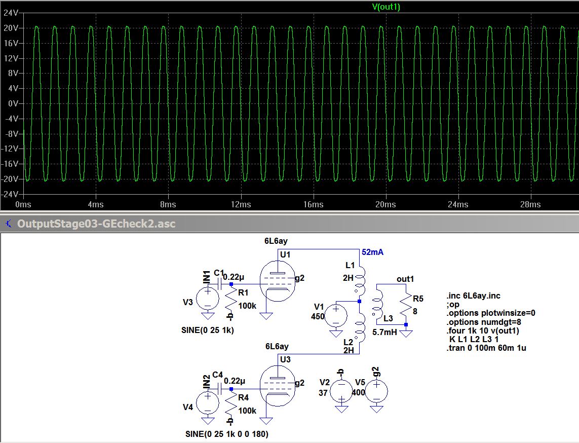

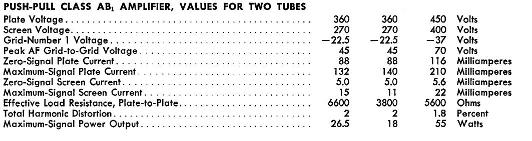

I'm attempting my first sim of a tube output stage (for learning purposes, not a real design) and although it's working, the output seems wrong.
It's a simple 6L6 PP stage where I bias it per the GE data sheet. The model is Ayumi. I can only get up to about 27W ouput before clipping (at 7%THD), which is wrong both from the GE datasheet and practical experience. Any more input and it clips.
Any help pointing out my error(s) would be appreciated.

@euro21, thanks but I believe you didn't understand the question. I didn't ask for an opinion on design. I am asking for help making the sim work correctly. The object is to play with the sim and gain knowledge and experience with spice.
OPT includes resistances of 100ohm primary P-P and 0.3ohm secondary. Not trying to sim any specific OPT, just picked some reasonable numbers to make the sim work.

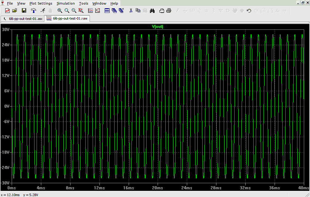

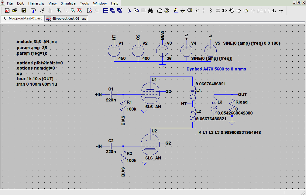

I copied and pasted some values for a Dynaco A470 OPT that swiped from a spreadsheet from a fellow member here, Robert McLean. I got over over 50 watts at 1.5% THD. Heres's a couple of pretty screenies to look at. 😀
Try this (zipped file in the attachment below) in LTspice.
  • 6l6-pp-out-test.zip
    6l6-pp-out-test.zip
Could you explain the coupling factors for the transformer?
L1 = 9.066
L2=9.066
L3=0.05426
K L1 L2 L3 = 0.9996
