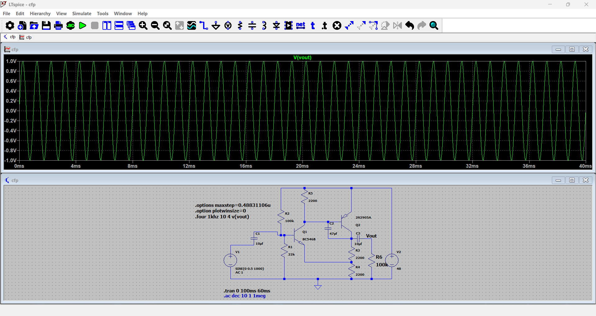

Hi Mr Mooly really sorry to disturb but i am very lost with FFT
I have tried to follow your very precious directions but i think i am doing mistakes with settings and actions
I would just like to get the 1kHz distortion spectrum and stop of the simple circuit attached below
Maybe i have entered values of components wrongly I see Farad for caps ???
Could you please me redirect to the relevant post in this thread where the passages to get a FFT are depicted ?
thank you very much indeed

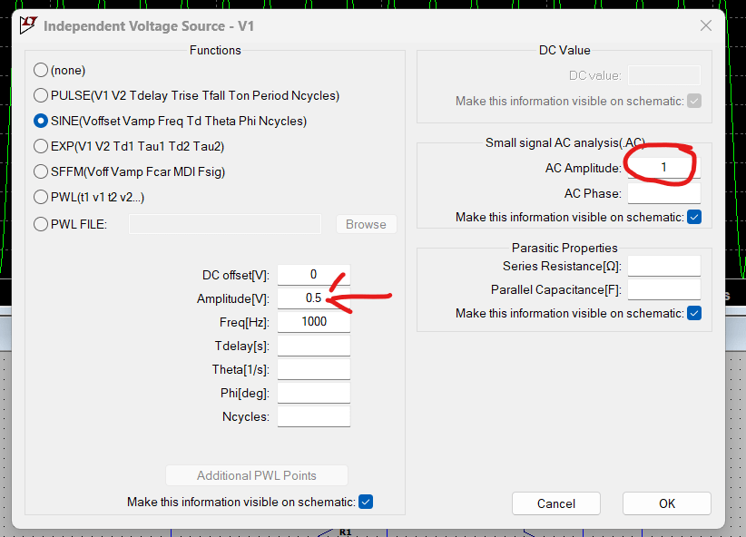

A couple of things wrong 🙂
The AC input should be like this. You set your amplitude here and the '1' is a reference designator for that voltage source, its not an amplitude setting:

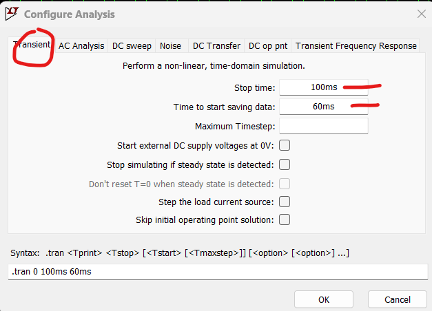

Set the sim to 'Transient' and set a suitable run time such as 100ms which would display 100 cycles at 1kHz. Set a 'Time to Start Saving Data' and it lets the sim run for that time before displaying the result.
Add a load resistor and you can also label the output. Also add the Spice Directives shown to set the 'window' for sampling:

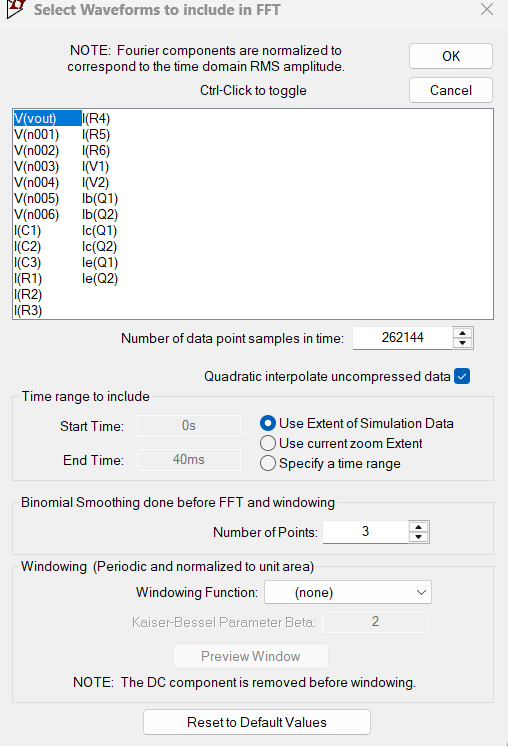

And the FFT Right click the area with the trace and select FFT:
Select Vout as the node to view:
If you make the caps massive and run the sim longer you get a more detailed FFT. Make the electrolytics '1' which is 1 Farad and set the sim times for 1000ms and start saving data at 600ms:
Modified sim:

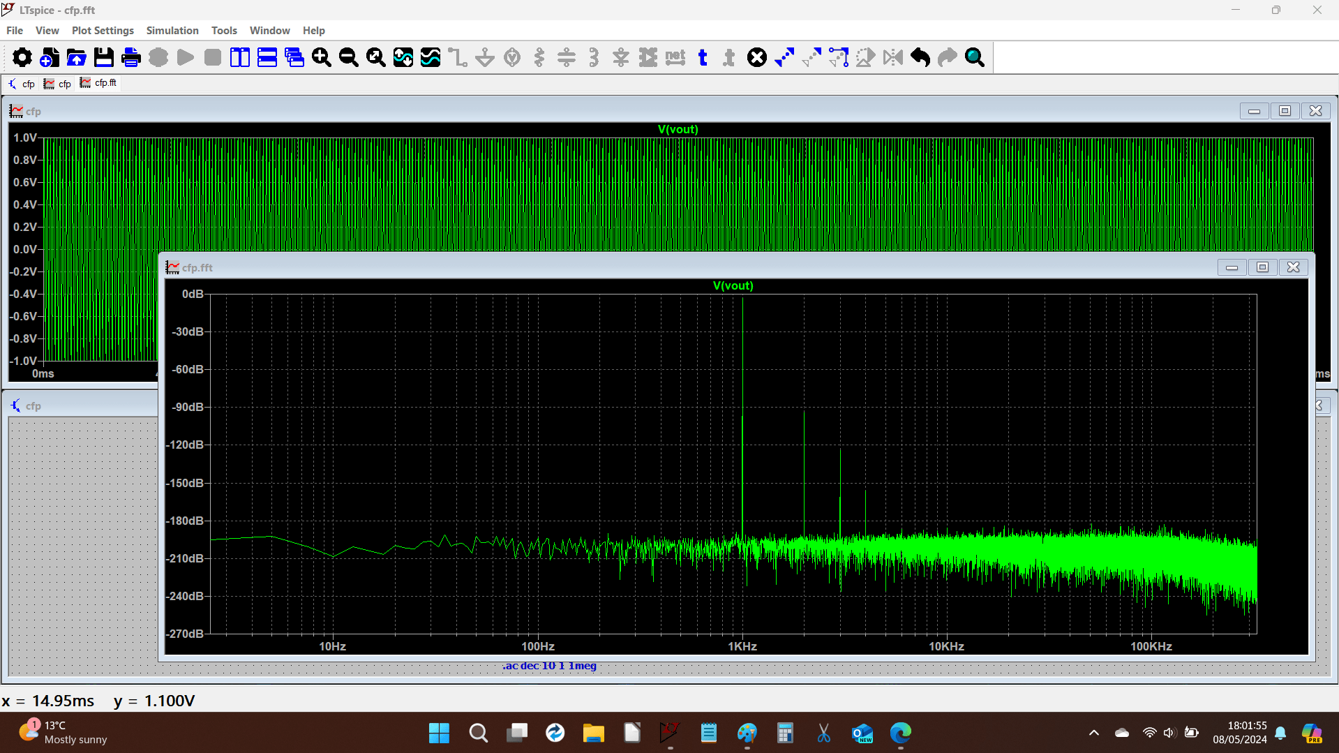

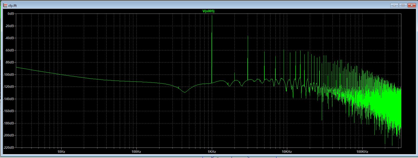

Good evening Mr Mooly and thank you very much for your extremely kind and valuable reply
I tried to follow your instructions and settings
I think i have set something wrong because i get an ugly looking fft (file .asc and jpeg of the fft attached)
I run your modified file and it is perfect 🙂👍
So there must be a problem with options setting and four 1kHz 10 4 v(vout) 🙄

1. The max timestep needs to be a (binary?) multiple of the signal frequency and "Number of data points in time" (defaults to 262144=2^18 in FFT dialog), ie something like {1/1k/4096}. Otherwise you get a bent bumpy ~noise floor. There does not seem to be a windowing function that works better than "none" with harmonic sampling.
2. Coupling capacitors need to be huge, ie 1 farad. Otherwise, you get a slanted noise floor that rises on the left low frequencies. But using too large a value (~100) causes some kind of math problems and all the detail is wiped out, straight line.
Hope this is useful.
3. A huge time sample is unnecessary. 100mS vs 1S is fine.
OBTW, your version of cfp.asc has two R3's so I changed one to R6.
Its missing the timestep which can be calculated (see post #19 in this thread).
You can keep common settings as a notepad file and just copy and paste them in simulations.
For 1kHz:
Code:
.tran 8m
.options maxstep=0.48831106u
.option plotwinsize=0
.four 1khz 10 4 v(vout)
For 10kHz
Code:
.tran 400u
.options maxstep=0.02441555u
.four 20khz 10 4 v(vout)

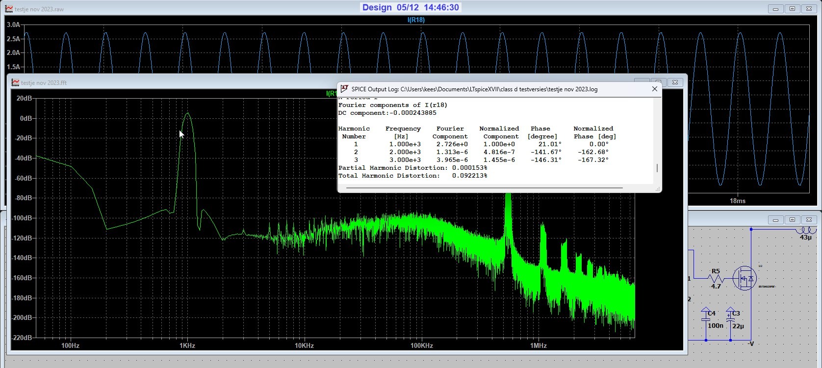

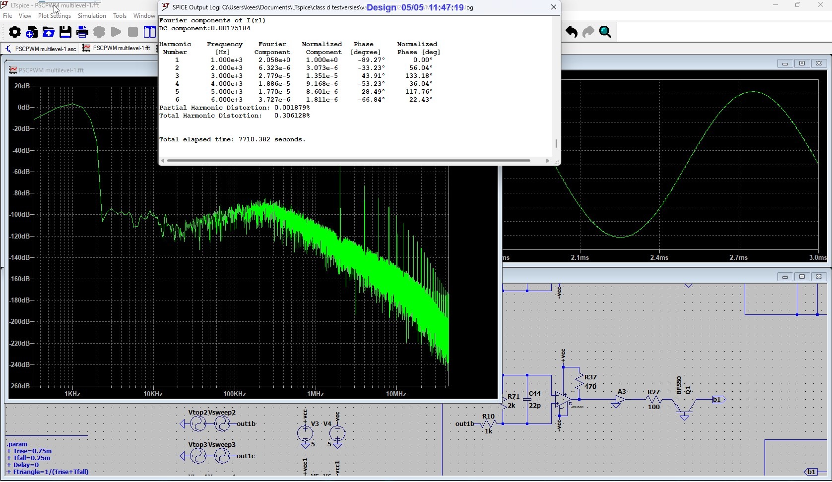

The FfT plot, I get very low partial distortions, and high total distortion of 0.3 procent while the FFT let see that all signals are around -100dB, maybe because
it is a class d it takes also switching with it. Other possibillity is I set the stuff wrong in FFT. I go try the old one for this.

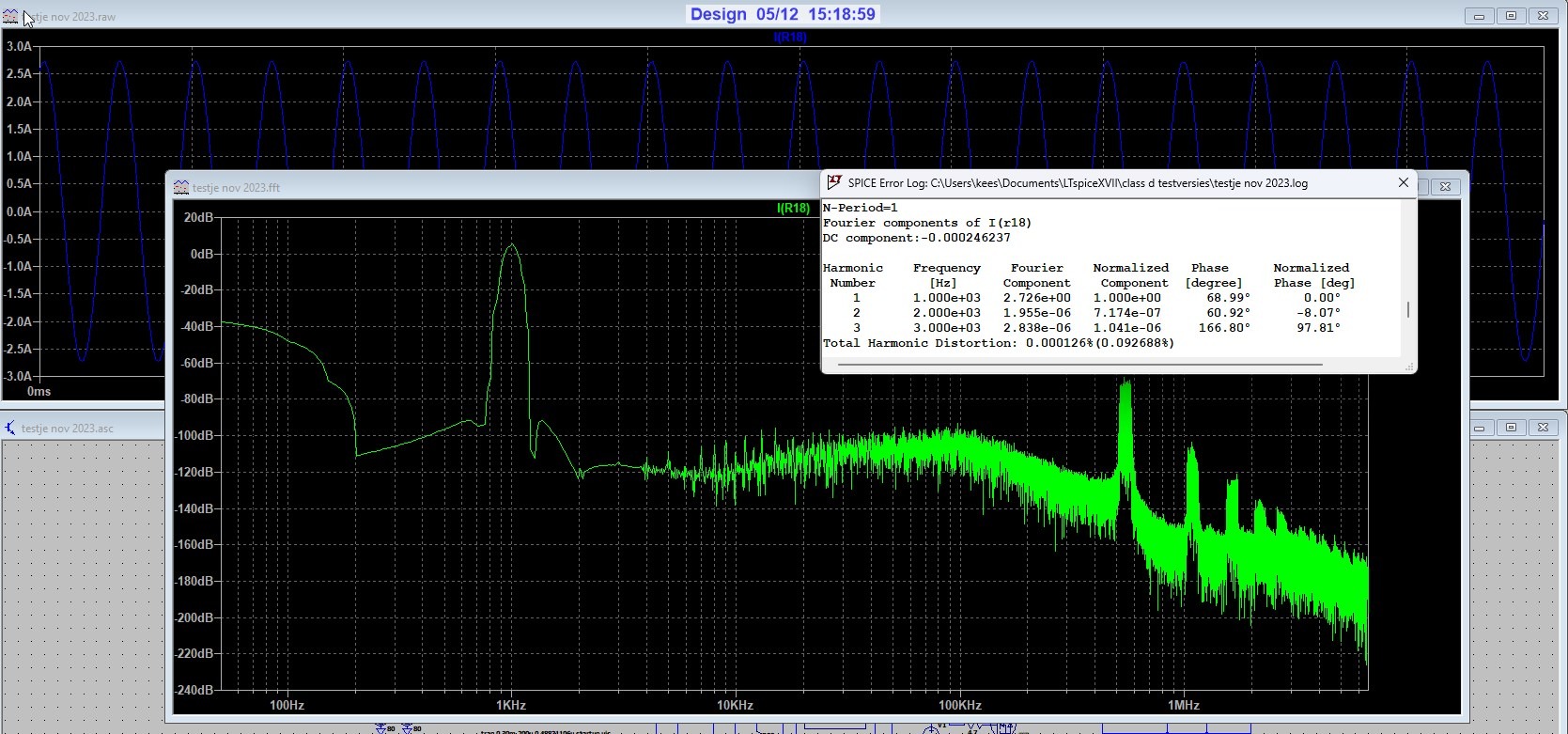

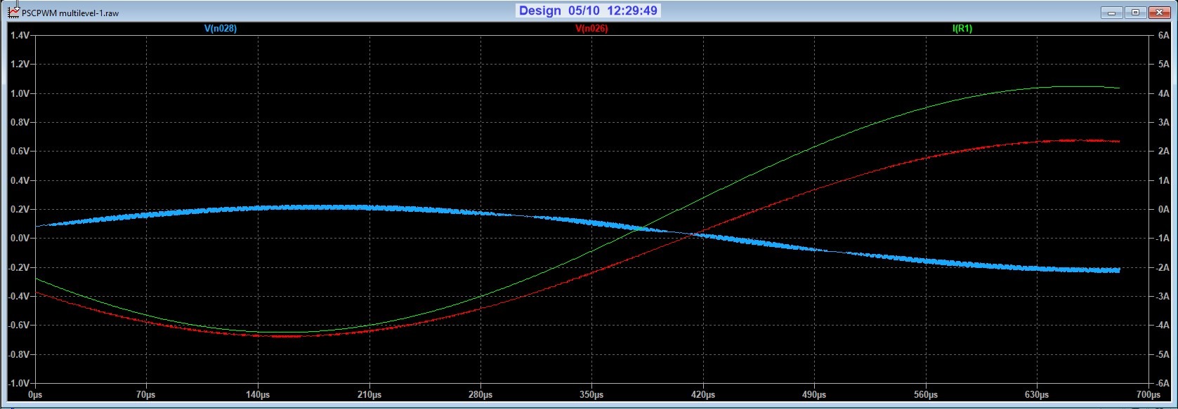

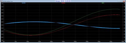

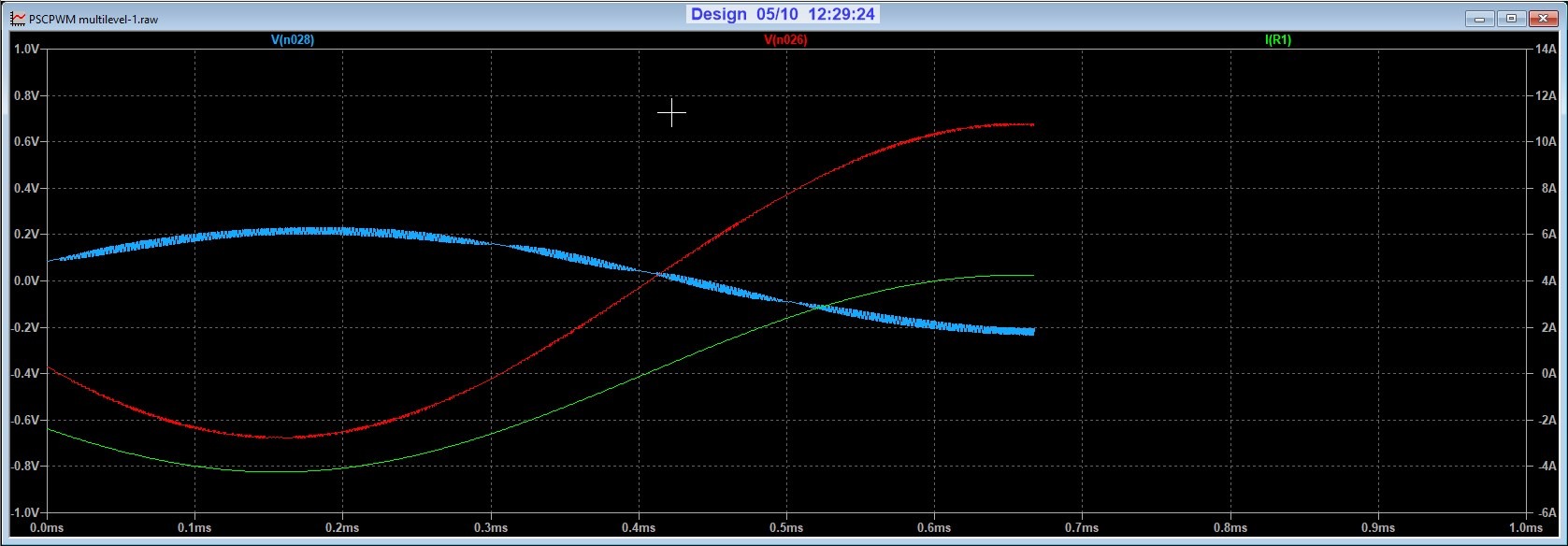

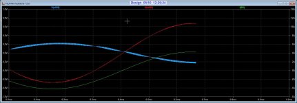

I did discover another problem.
When I do FFT on a signal, and close it the signals are suddenly out of middel, and give 12 ampere in stead of
4, and out of offset, when I do zoom te fit it is oke again. But the red signal is still 4 amp, that stays oke. Liitle confusing
plot.
So still bugs, a lot things to do for this program is free of that.

Distortion measurents, I get in XVII and in lt spice the same outcome, but I am a little confusing about the total distortion and the partial distortion,
that is in the older ltspice XVII total harmonic distortion, and between brackets partial distortion. That can mean, ltspice do measure wrong and the way around, special when FFT does -100dB or lower, then the partial 0.000126 procent is much closer then the total at 0.092213. So there is something wrrong,
total distortion do not match the FFT of -100dB.
Afcause, I maybe can do something wrong, but for me now, it looks like a error in the program because the old XVII does have the right outcome, and the partial between brackets.
