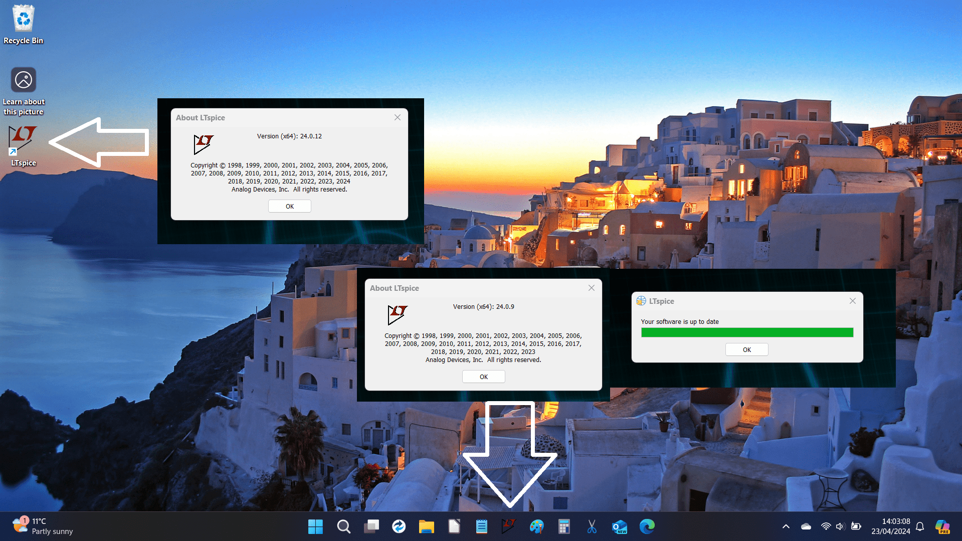

Has anyone had any issue with the latest LT update creating a completely new installation in the Program Files rather than the AppData area?
I now have two versions, one new and up to date and one that says it is up to date but isn't. The 'new' version has carried over everything from the original AppData setup.
Could this be because I selected 'Install for everyone using Admin Option' which was the recommended choice rather than the 'Just for me' option although I'm sure I've used that option before. I've added this over on the LT forums because I've seen others complain over this.
Just to add to the above... now fixed thanks to Macrium (restored back to previous disk image). If there are any comments over at LT I will update this thread.
I've tested this again on a test set up and installing the update using the 'Install for Any User' rather than just the current user does seem to duplicate the installation in c:\program files area.
So this is how I see it 🙂

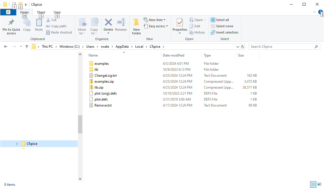

When this occurs I found the existing install in AppData consistently and incorrectly reports as being up to date when it is not. The all shiny and new install in program files is the new version. If you use the 'Install just for me' option the AppData program updates as expected and nothing is written to the program files area in c:\programs
Apparently (I haven't tried this) .asc's saved under the older non updated install actually still open that version when clicked... what a mess.
It might be worth anyone checking that you have only one install of LT present (if that is what you expect and are not deliberately running multiple installations).
What I have assumed to be the default and recommended one is the one in AppData. You should see this if you search this file path:

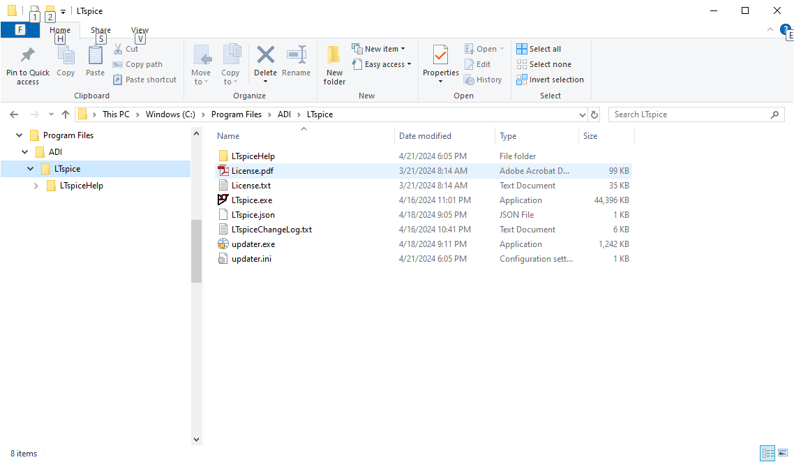

If you also look in:
there should be no entry under 'ADI' if you are using and expecting only the AppData location to be the only version in use.
Code:
%userprofile%\AppData\Local\Programs\ADI\LTspice
Code:
C:\Program Files

I just allowed LTspice24 to update its model files and noticed that the models were updated in the AppData folder, but that the lib.zip and Examples.zip files under "Program Files/ADI/LTspice" were not. Those files carried a date of April 18, while those same files show the current date in the AppData location. So it appears that the Program Files location is not being updated but that the AppData location is. As an experiment, I have deleted the lib.zip and Examples.zip files from the "Program Files/ADI/LTspice" folder and will see what happens on the next update. Deleting these files did not appear to "break" anything when I launched LTspice24 afterward.
It's also worth noting that the Program Files location does not contain the actual model files; it only has the ZIP files which contain the model files, along with the LTspice.exe application and its supporting files.
At least this is what I am seeing. I don't see any evidence of a second installation.
EDIT: My installation is for all users even though I am the only user on this computer.

It's puzzling, to be sure. On my computer, the Program Files folder just contains the executable, help files, and log files. It contains no library or user files; see screen shot below. This seems consistent with other Windows program installations.
My AppData location contains only library files and no executables; see screen shot below. This is also what I would expect a "normal" Windows application to do.
Since I don't see any duplicate installations when looking at applications that can be uninstalled I will leave my installation alone for now and see what happens on either the next model update or the next program update. My installation seems to be working OK at this time.
Your install seems to be a true 'Install for All' configuration. I can not remember now what options were offered at the moment of first installing LT24 but wonder if consistency is the key and you should not switch options (Install for All vs Install for Everyone) during updates.
Maybe that option is something new for the updates but I can't really remember for sure. One thing I do remember from the other day was a message saying that the required file path already exists and 'Do you wish to overwrite the files...' which subconsciously is a kind of validation that all should have been correct but in my case was not. I will certainly be more observant next time.
