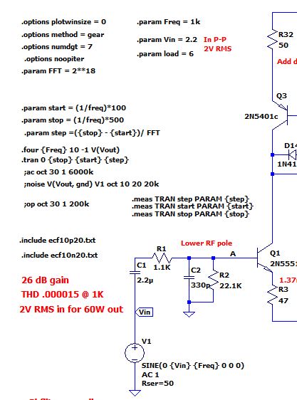

I am having trouble with the relationships in my commands. Depending on the number of samples, a function of time, I can get THD results from .000014% to .23%
Left of the fundamental depends somewhat on number of samples, which I also do not understand.
In the View for the FFT, the FFT size is set to match the fft parameter.
I know on the bench, I can measure around .003% 1K @ 5W. ( 60W amplifier) So it is a good amp, but magic!
As far as tweaking the schematic, I believe the trends are correct, but the values are unbelievable to both extremes. Curious, short runs are higher, but much longer, like 5000 cycles, are also higher distortion. What am I not understanding here?

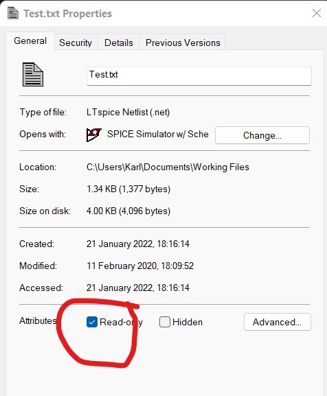

Now right click the new Netlist and in 'Properties' select 'Read Only'. This will prevent LT from ever modifying this file.

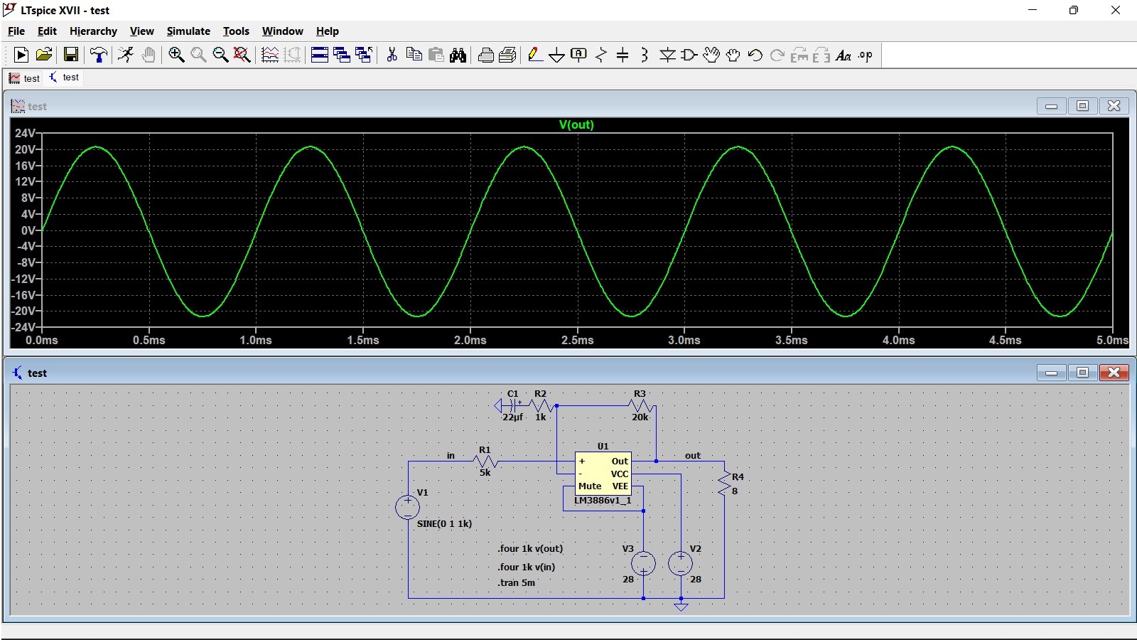

Hi Mooly,
I'm attaching the test circuit and the model +.net file,
That runs straight off (apart from 3 pins not connected on the IC and V3 set to zero) but maybe that is because I have that model set up anyway.

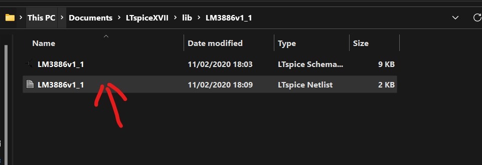

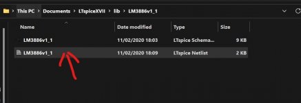

When you look in the Lib folder you should have the netlist as in the image here.

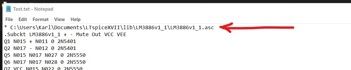

If you copy and paste the file somewhere else you can play around with it. If you right click it and open it with Notepad (do not accept the option to always use notepad to open these, do it as a one off) you will probably see the line at the top saying:
*C:\Users\Karl\Documents\LTspiceXVII\lib\LM3886v1_1\LM3886v1_1.asc
which is of course incorrect for your PC. Try changing that line using notepad and resave the file. When you are happy do it for real on the file in the Lib folder.
