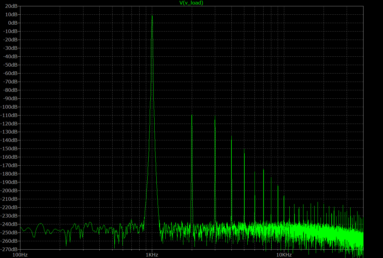

I found on the forum where it was suggested to use the "Kaiser-Bessel" windowing function.
I setup my FFT as such (mostly through experimentation and using other peoples setups and configurations):
  • Number of data sample points = 131072
  • Number of points = 31
  • Windowing function = Kaiser-Bessel
  • Kaiser-Bessel Parameter Beta = 101
plus on my schematic the following parameters are set to:
.param Freq=20k (or any other frequency such as 1KHz)
.param numcyc=256
.param dlycyc=0
.param FFT=65536
.param simtime=(dlycyc+numcyc)/Freq
.param dlytime=dlycyc/Freq
.param numsampl=simtime/Freq/((simtime/numcyc)*FFT)
.param timestep 1m/8192
.tran 0 {simtime} {dlytime} {numsampl}
Here is the output:

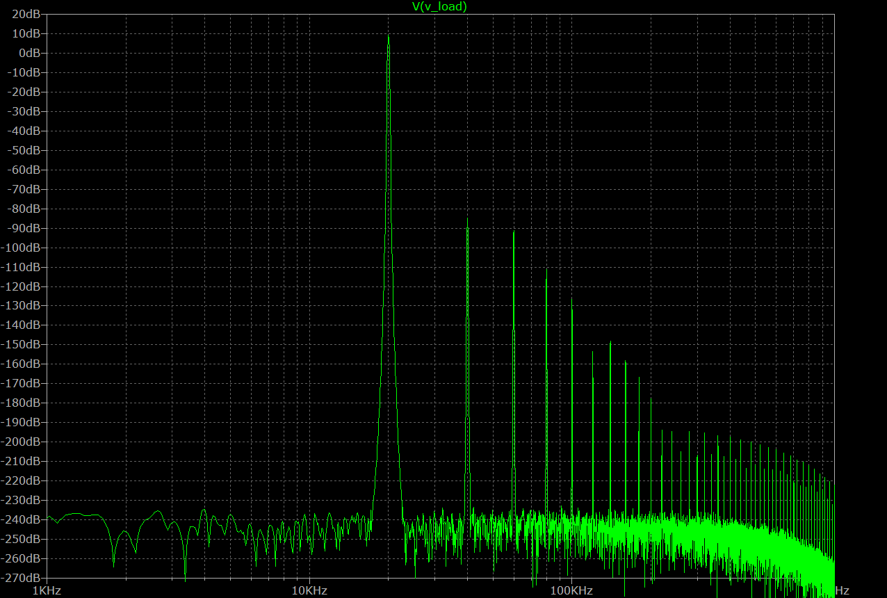

1KHz - 1MHz @ 20KHz output, you can see the FFT starts rolling off at around 400KHz.
Here is the same configuration but for 1KHz, graph set to 100Hz - 40KHz:
Is the proper way of configuring a FFT output graph ?
I was hoping one day someone would explain in simple terms the mathematical relationships between all the FFT parameters.
Code:
As used this parameter is the maximum timestep to be used during the simulation. Since this expression is written in a non-standard way, it is difficult to read and understand what is actually being calculated without one makes reference to how LTSpice evaluates expressions. For the benefit of potential readers, the time step should be such, that it guarantees that every cycle contains a whole number of samples to avoid having samples overlapping cycles. It is also important to use a sufficiently high number of samples per cycle. Do not use low number like 10 samples per cycle, but try 100 or so, until the FFT does not change considerably.

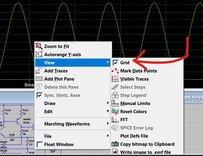

I'm the lucky owner of a brand new Win11 Dell PC with Alderlake processor.
However, when plotting graphs in LTSpice, I have a problem because the gridlines are missing, no matter what I try.
I also have a Win10 PC, with exactly the same LTSpice release and exactly the same installation settings.
But nevertheless, gridlines are absent in the new PC.
The PC is equiped with NVidia GTX1660 graphics and to exclude this board from the problem, I interchanged it temporarily for the GTX750 in my old computer that's having no issues.
So obviously it's not the graphics card but either the Intel Alderlake CPU, Windows 11 or the combination of both that's causing this strange problem.
Anyone else having the same trouble ?
Hans
That does sound odd. You mean Grid as in these? I'm running W11 but on unsupported hardware... and its been brilliant.
I know you are an experienced LT user Hans. Are the graphics clear and pin sharp like they should be? Can't think of anything really.
That’s the solution you gave, never to old to learn.
Thanks a lot.
What amazes me most is that LTSpice on my new computer is 6 times faster, 4sec versus 25 sec for the same simulation !
Hans

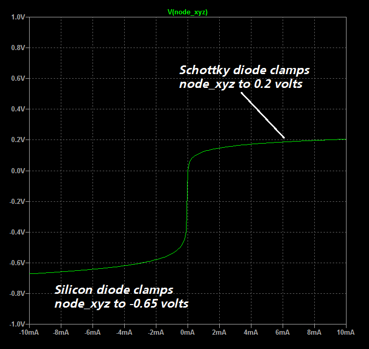

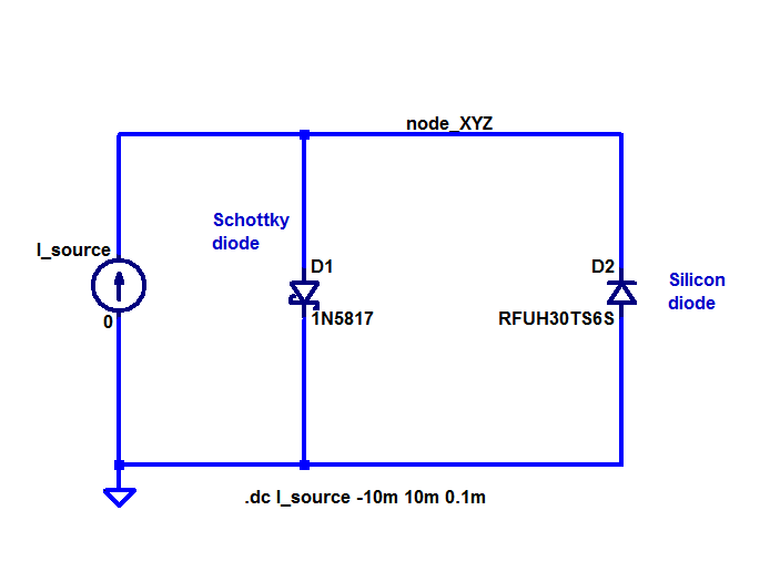

A beginner question. I have a basic circuit drawn and want to run a dc simulation. I have followed posts #2 and 3 in this thread and got to the point where I get the operating point window up on the screen but I am unable to get to probe to hold over components to see voltages etc. The black window that displays the graph is not appearing either. Both of these will run on a more complex circuit which Calvin kindly sent me a while back so I know the program is OK but I want to learn how to get to that point myself. Any help much appreciated! Thanks in advance.
.OP analysis only presents a table of voltages and currents -- it's the Operating Point
.DC analysis varies an independent source and presents a plot whose horizontal axis is (the independent source that was varied). I attach an example, in which an independent current source is varied from -10 mA to +10 mA. Simulation results show the difference between the Schottky diode and the Silicon PN junction diode.
  • dc_analysis_example.asc
