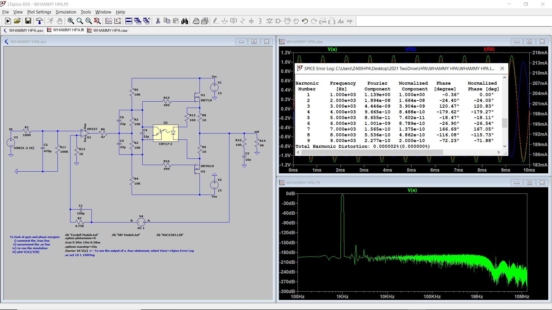

Does anyone have a good sharable LTspice file for op-amp plus booster output stage headphone amplifier? Something like a op-amp plus Class A or AB booster
WHAMMY (designed by the preamp guy at Pass Labs, and sold in the diyAudio Store) is an opamp plus class A booster output stage. Maybe you could visit their Forum thread and ask whether anyone is willing to share their LTSPICE file.
"WHAMMY" Pass DIY headphone amp guide

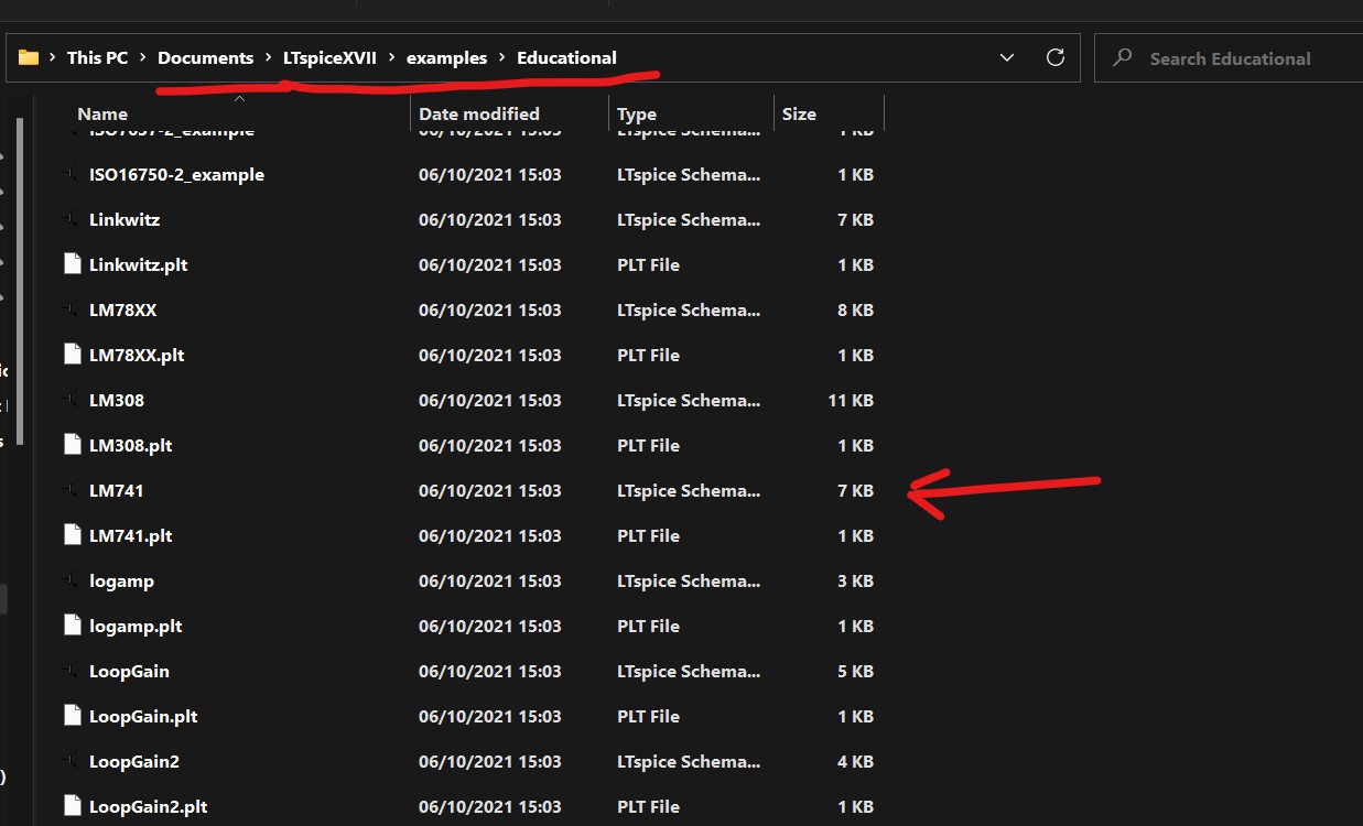

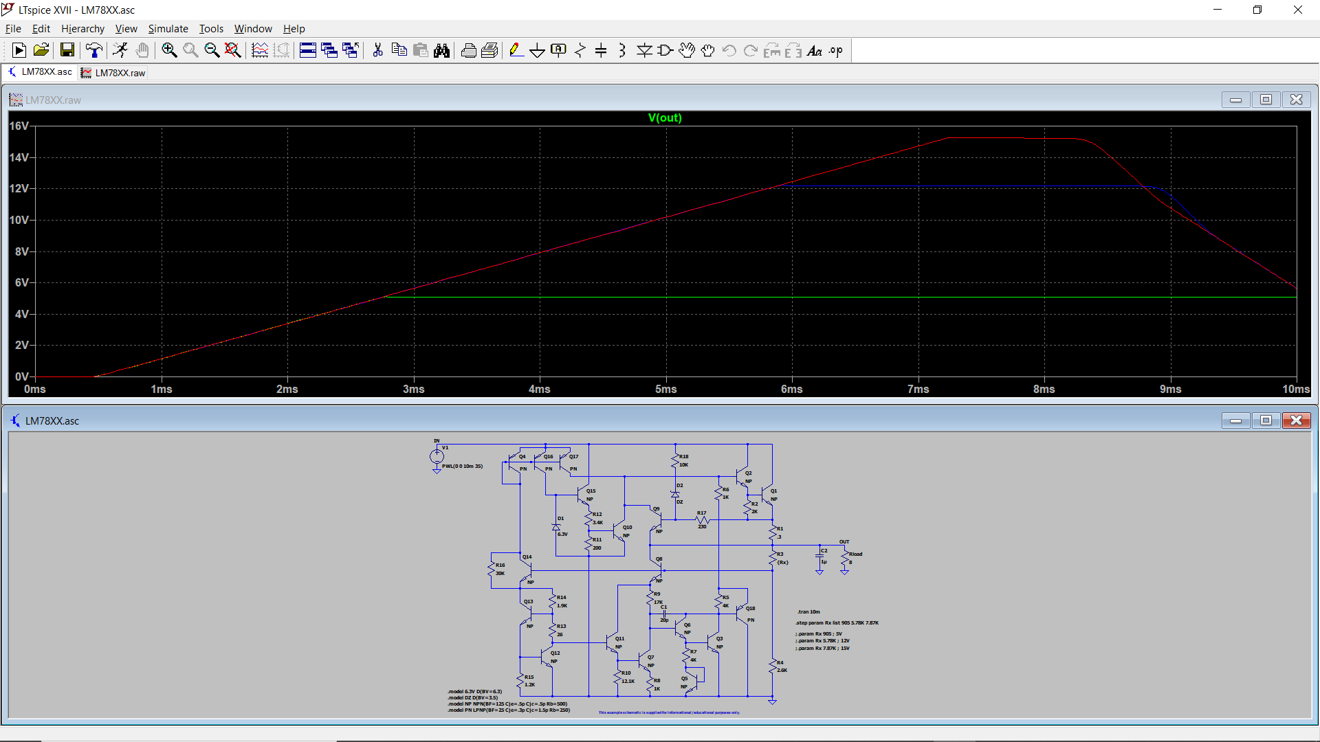

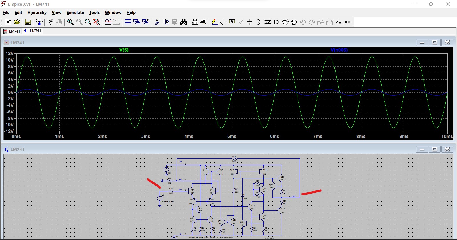

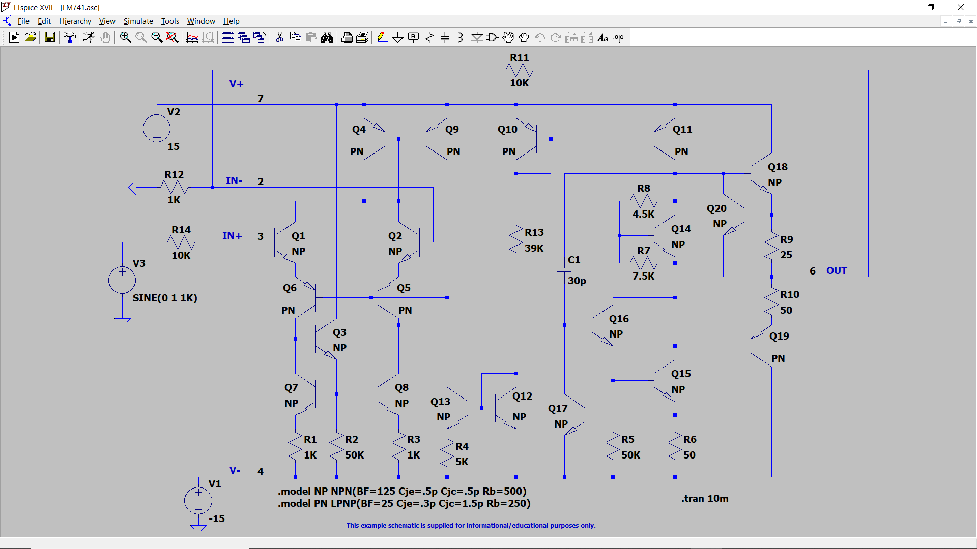

If you want a sim of the insides of a real opamp then go to your LTspice folder in Documents and look at the Examples folder. In there is a folder called 'Educational' where there is a 741 (probably the best known opamp of all time).
If you want you can save the sim again somewhere else with a new name to preserve the original and you can have play.
Run the simulation and see if you can figure out how the gain is set. Remember the Quad earlier and I described how the gain was calculated.

But it is not how it looks inside. The actual inside has many more parts than is shown. As is usual, these are only 'simplified internal circuits' to show general topology. But even an LTspice model most of the times has more parts than this.
You normally have to know a very few things only for evaluating circuits with opamps. The most simple is that the voltage between the input pins is the output voltage divided by the open loop gain. Since the open loop gain is very, very high, a rule of thumb is that the voltage between the input pins is zero, so they can be considered being at the same voltage. The other important thing is that the inputs don't require input currents (for a 1st level analysis).
Look at Mooly's example above. The input voltage is connected to one input pin of the opamp. From what I just said, you know that the other input pin has the same voltage. Then it is only the ratio of two resistors that sets Vout.

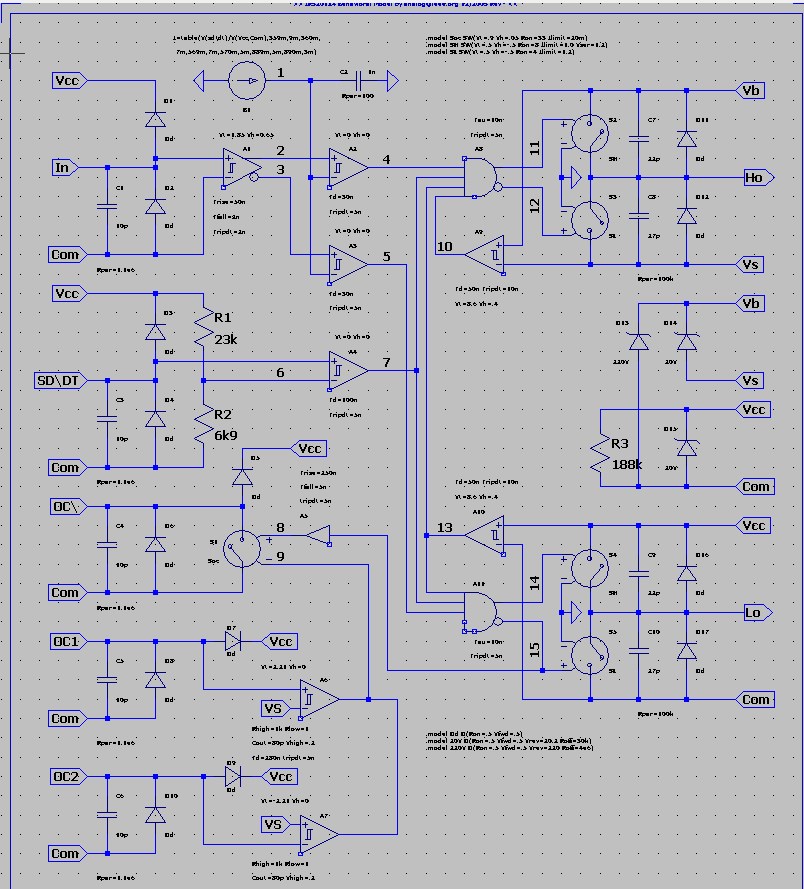

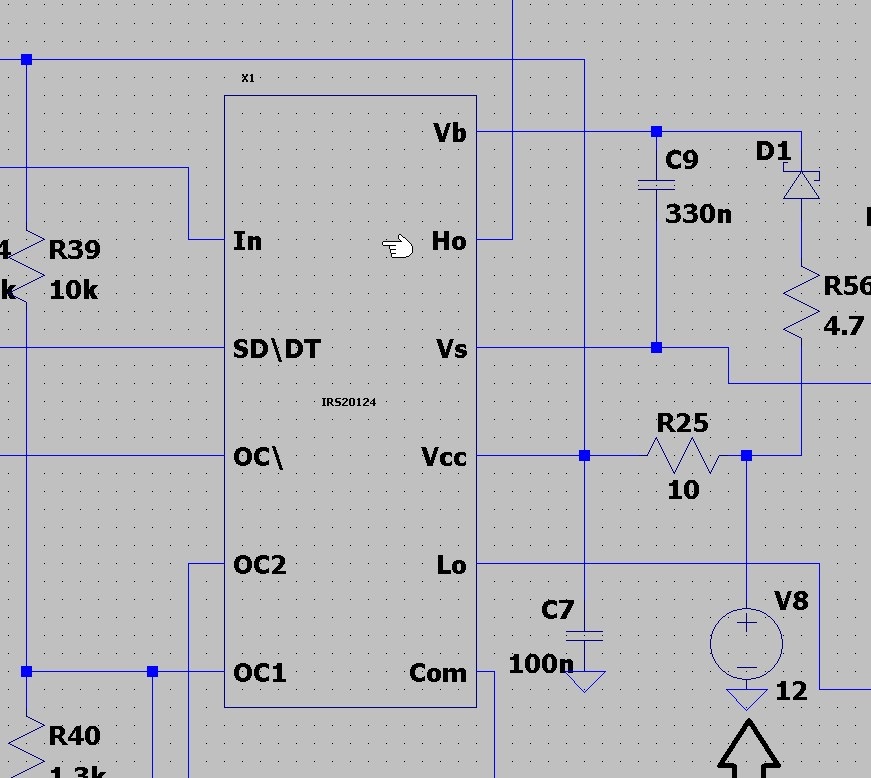

Hi All
I have a model of a gatedriver for mosfets, I did use it in class d, there is a problem, the supply of 12 volts for the ic IRS20124s needs to be connected to COM for reference to inputs and negative rail voltage, but when I do simulating with dual supply,s it does not work, when I connect 12 volts to ground it does work.
This is not right, normally I need to reference to Vss, like the other ic,s, the ic can be used for double supply, I have others who do work fine with Com or Vss to -V reference.
Maybe someone can see in schematic block there is something wrong.
thanks.

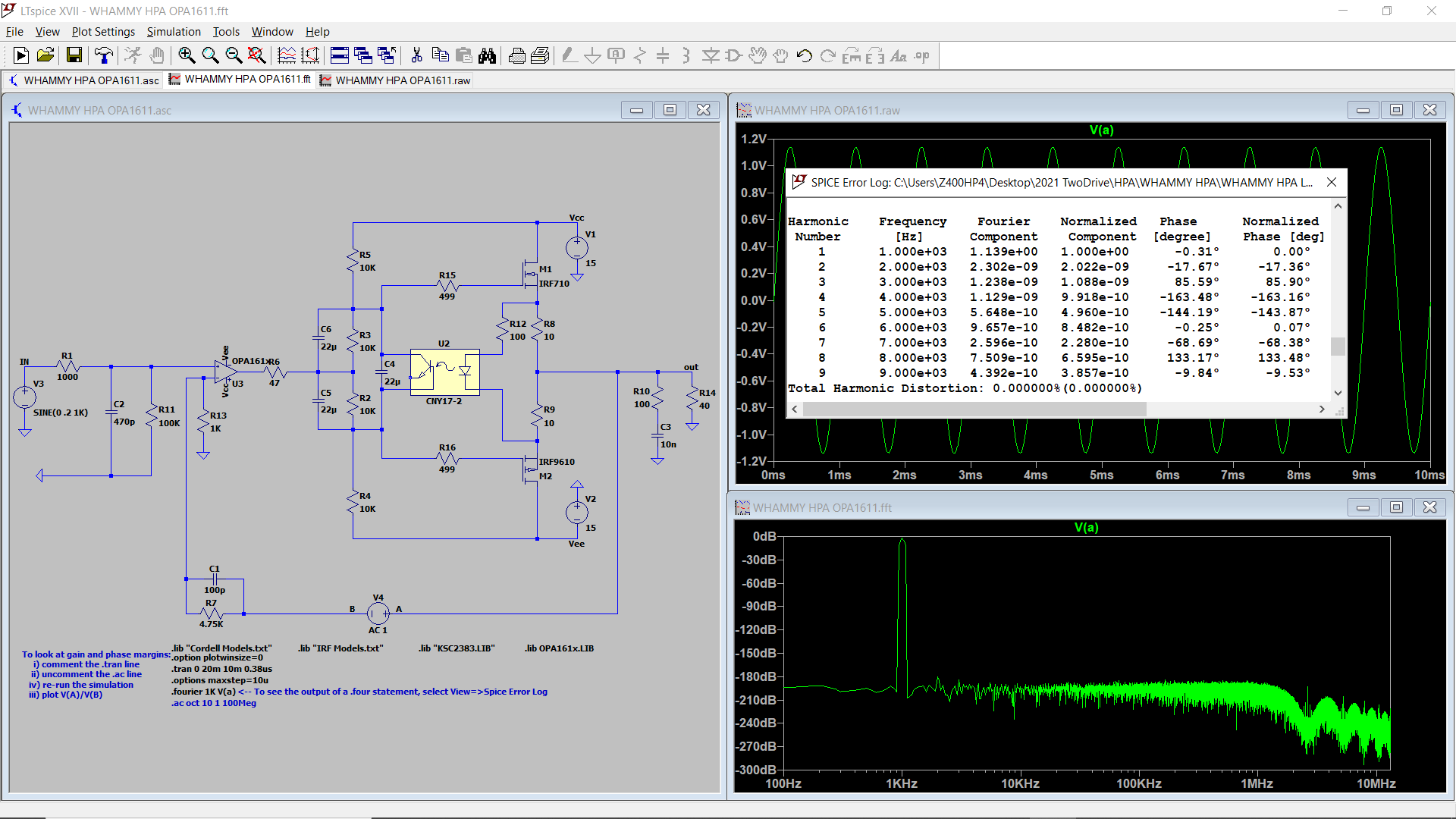

Can someone tell me which good audio op-amps have accurate LTSPICE models?
I am simulating a variety of HPA in LTSPICE and would like to know which op-amps models are particularly accurate and trustworthy. (See attached example simulation.)

What you can assume is that the output stage of the Whammy in your sim is working OK and that any distortion will be mostly down to the opamp used. I assume the output stage is biased to the correct intended current... it should be even allowing for different models with a bias scheme like you have.
12 opamps chained - measurements
I saw that post. Yes, that seems to be the problem.
Do you know of any good audio opamps where the distortion is modeled?
I'm afraid I don't, its not something I've ever looked into tbh. Your best bet might be to look at real world test data such as from Samuel Groners 'Op Amp Distortion' where FFT plots and so on are shown for lots of popular devices.
Attached is with the OPA1611 model from Ti. Distortion is zero so it appears that no attempt is made to model distortion. (And distortion is not listed as a model feature in the model comment lines.) Presumably it is simply too difficult for SPICE models to model opamp distortion? Too much modeling effort for the manufacturer and/or simulation speed issues?
I assume then LTSPICE can be used to approximate and tune the rest of the circuit and the datasheet distortion curves are used as the first reference for what the opamp will do.
