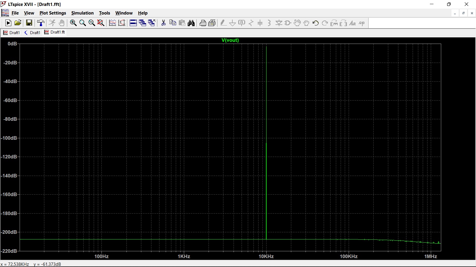

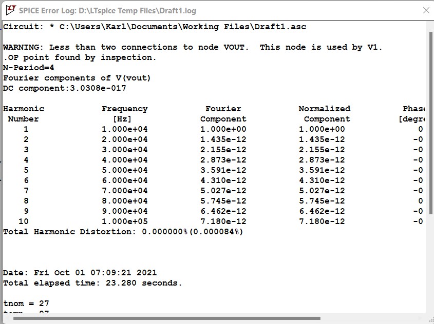

I notice that doing a fft on a sine wave source directly only yields a modest THD, unless certain directives are used. One such is ".options plotwinsize=0", but that may still not result in ppm THD?? What else? I also notice that the fft is phase sensitive??
Also, while you can now copy and paste between schematics, the same is not true for symbols, which would be very useful for op-amps, etc. The best trick I have so far is to copy and past text from one *.asy file to another.
Somebody posted this a while back... and I can not remember who. Just dial in whatever frequency you want.

Experimenting with this I found that what matters is maxstep <= 1/freq/1024
.tran 0 {10/freq} {5/freq} {1/freq/1024}
1000 cycles is asking for a very long simulation time and according to the help
"The Fourier analysis is performed over the period from the final time, Tend, to one period before Tend unless an integer Nperiods is given after Nharmonics. If Nperiods is given as -1, the Fourier analysis is performed over the entire simulation data range."
So .tran 0 {2/freq} 0 {1/freq/1024} works OK.

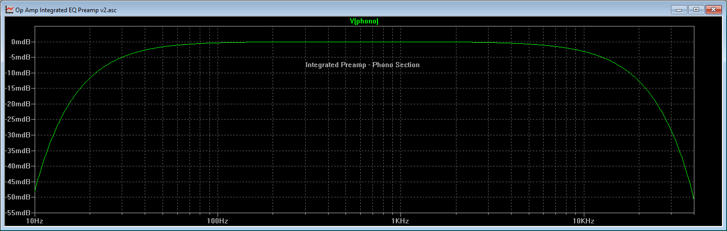

As an example, attached is the frequency response plot of an op amp based RIAA phono preamp that I designed. The simulation uses a mathematically precise inverse RIAA source so the RIAA components were chosen to precisely match those required to implement the RIAA filter. One might say that the results are "perfect" within the audio band. But I wouldn't expect the measured results to be perfectly flat like this. However, it would expect it to be very close.
In summary: don't strive for "perfection." In engineering, there is such a thing as "good enough."
