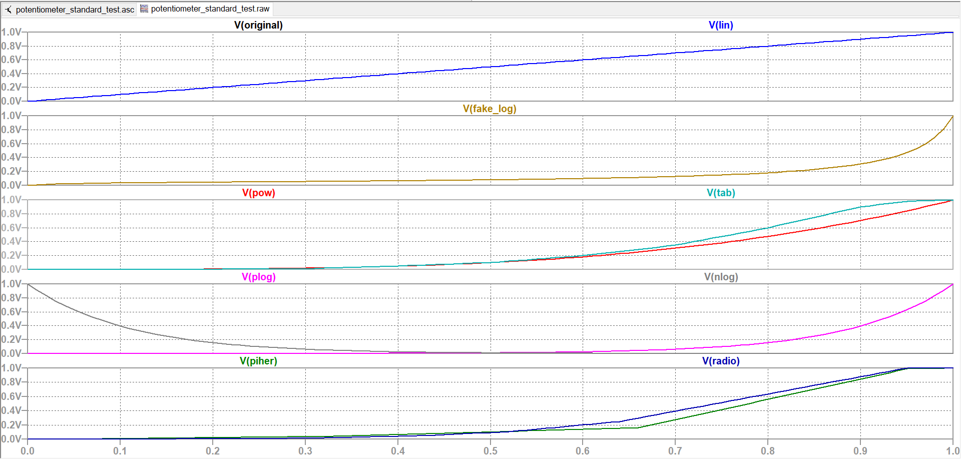

I've attached a zipped folder with a selection of nine pots from the LTspice users group. Unzip the folder and open potentiometer_standard_test.asc. Click Run and it plots the response of the various types of pot.
Note that for all these pots the rotation is 0-1, not 0-100%. There are instructions for use on the schematic.

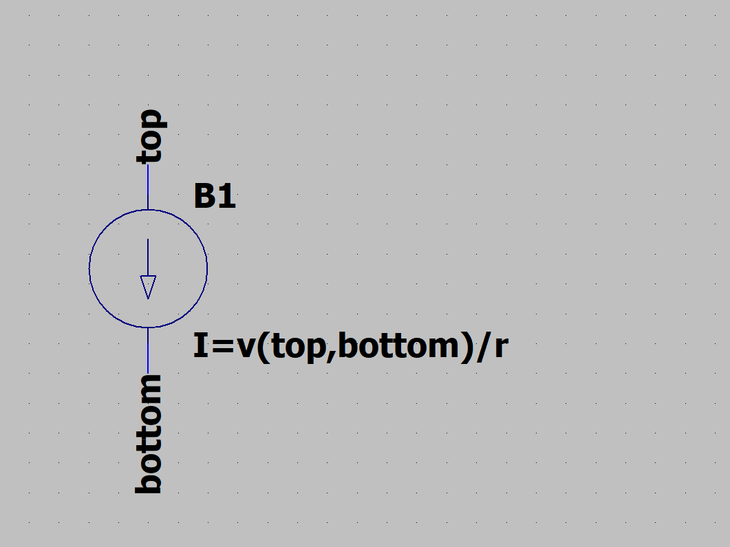

The point is, a resistor is depicted as (in the example given) r=u/i
This can be translated to a current source as i=u/r
The example given uses a current source (in the example attached B1)
The voltage across the current source is given by v(top,bottom)
The current then would be v(top,bottom)/r where r is the resistor to be simulated
The point is, what could be simpler, one component B1 and one formula i=v/r

The potentiometer questing was answered by using 2 simulated resistors, by way of an set of current sources, and a set of functions (where you can substitute any).
Any way, this is now about the difference between simulating and emulating, the potentiometer can be emulated by two resistors and then step commands can be used to emulate, when using simulation (like using the current source) no stepping is needed and a (pseudo) continues workflow may be used. It just depends on what is needed.

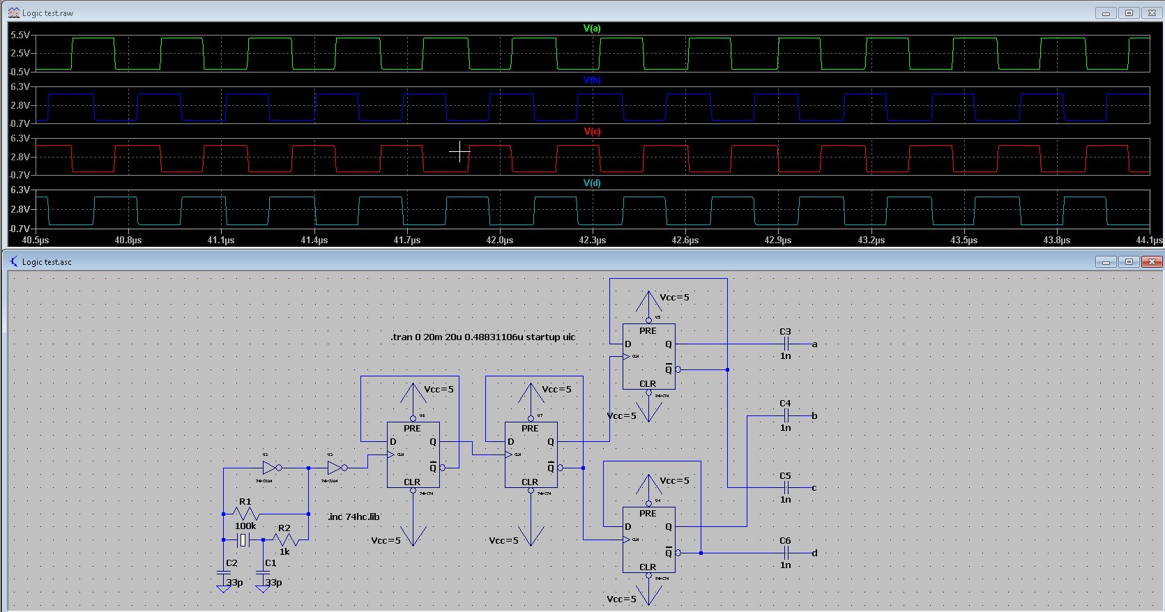

Hi All

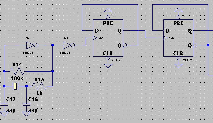

I get no signal from the flipflops, doe someone now why? I have only signal 5v top from the oscillator to input first FF but no output. Maybe the PRE or CLR pin?,.
thanks.

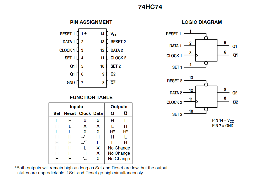

Have you tied the PRE and CLR to the wrong rail/logic level? The dot or circuit indicates that those signals are inverted or active low instead of the normal active high.
I suggest you try switching the PRE and CLR to the opposite logic level (high) and look at the linked datasheet and attached function diagram.
https://www.mouser.com/datasheet/2/308/74HC74-108792.pdf
Everything works (or doesn't work) the way you have drawn. You know that the circle on the input means that the active input level is "0". By connecting the setup and purge inputs to the common you are doing setup and purge at the same time, which prevents the triggers from working the way you want them to. Feed "1" to the ill-fated inputs. I don't know what parameters you have set in the logic elements, so I don't give the value in volts.
But even by making these changes your circuit will not work (or will not work at the right frequency). Normal logic elements do not work in quartz oscillators. You have to get a 74HCU04 which will work in the circuit!
Oke thanks, I am not so experienced with logic, but you are right need to read more. the rfeason is I did use standard digital components before and not the lib versions, these are clr are grounded and work, so I was confused now.

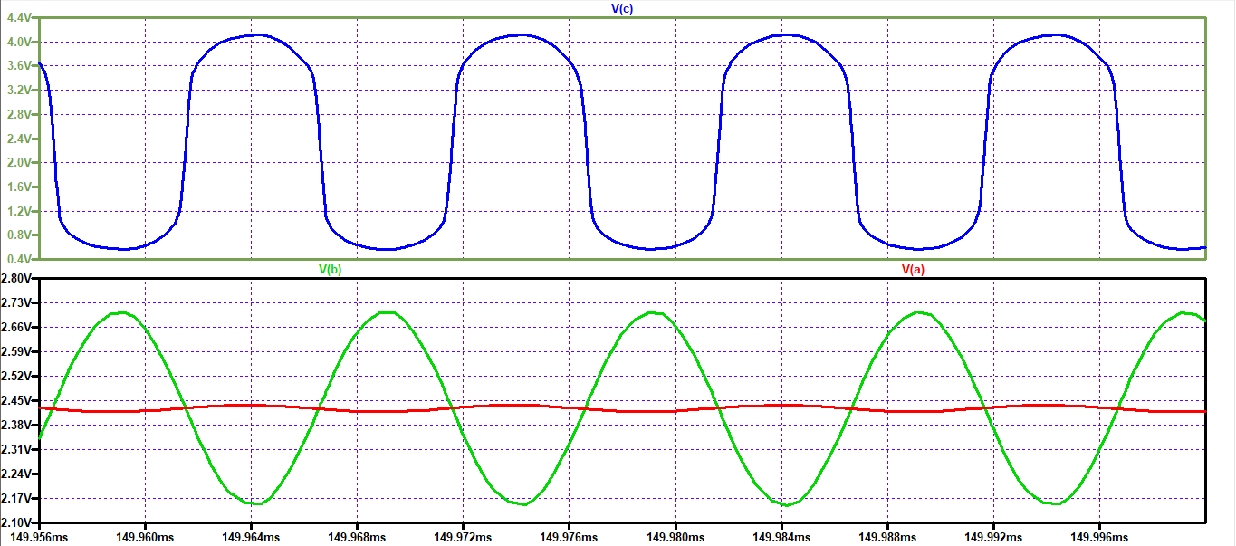

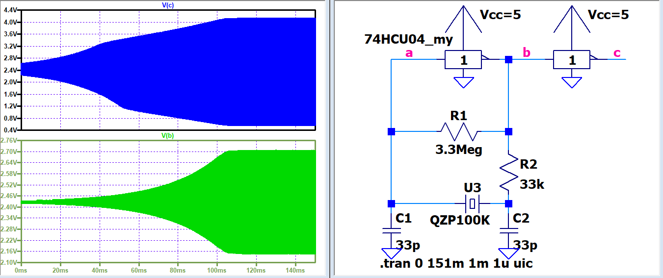

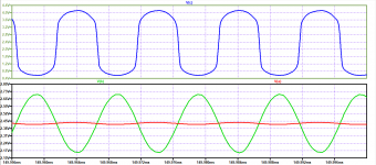

Oke, have done what you guys advise. It works now. But I have just one question left, the capacitors before the integrator opamp does charge, so before it is not a good triangle, can I set in LT spice something so the capacitor charged such that signal on opamp is right, I hope I explane right.
Thanks.
Thanks.
I suggest to use the highest resistance shunting the xtal possible. The usual values are about 10M, but I have used up to 22M in my designs. In such a way, the reduced load in the xtal increases its stability, amplitude and reduce drifts. This is only possible with all CMOS gates. TTL gates are not suitable for such a high rasistance values.
