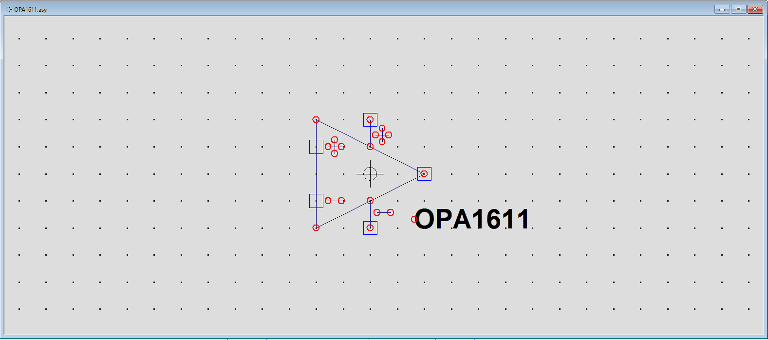

The only thing still missing to test our OPA1611 is an .asy file.
First inspect the OPA1611.lib file by clicking on it to find the line with
.subckt OPA1611 IN+ IN- VCC VEE OUT
This tells you in what order the pins on the .asy file should be placed.
Close this .lib file and continue within LTspice with "File - New Symbol".
Now draw the triangle symbol of an op-amp, 4 points high and 4 points wide, but it could be anything else because the shape is unimportant but just convenient to keep it the same as the available LTspice models for ease of interchanging op-amps.
Place in the same order the 5 pins to the drawing, again similar to how LTspice uses to present their standard op-amps.
Once you have made such a model, you can reuse it as often as you like for other op-amps by renaming this .asy file, so you only have to do this once.
What you have made now should look like the first image below after having saved it as OPA1611.asc in the same \NewFolder directory as your .lib and your .asc files.

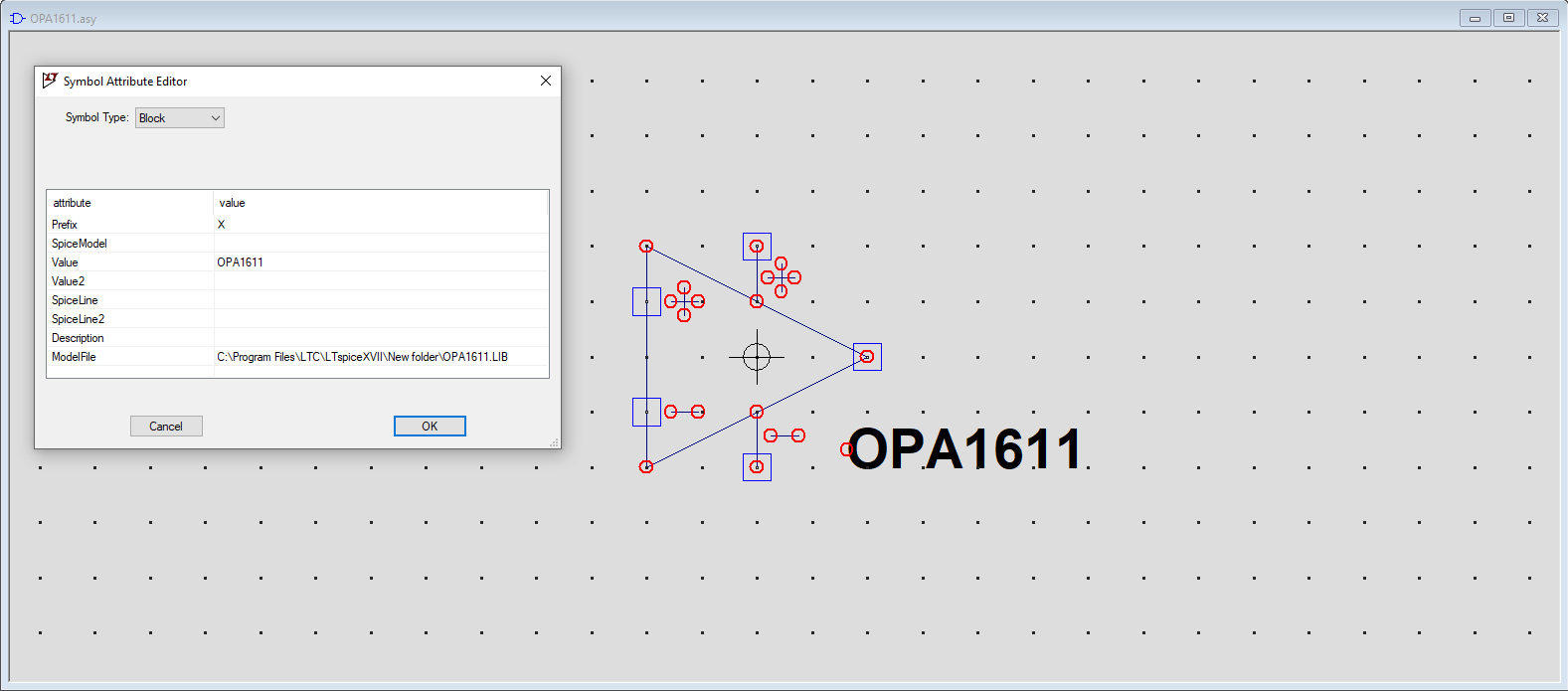

You still have to edit the attributes and tell where the .asy should get its information.
So still within the .asy file, click resp. "Edit - Atributes - Edit Attributes" and the following window will pop up, see second image below.
See to it that you fill in the all the things like here including the correct link to your .lib file and save the .asy file

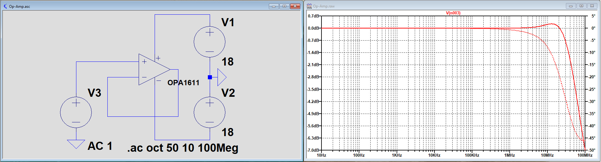

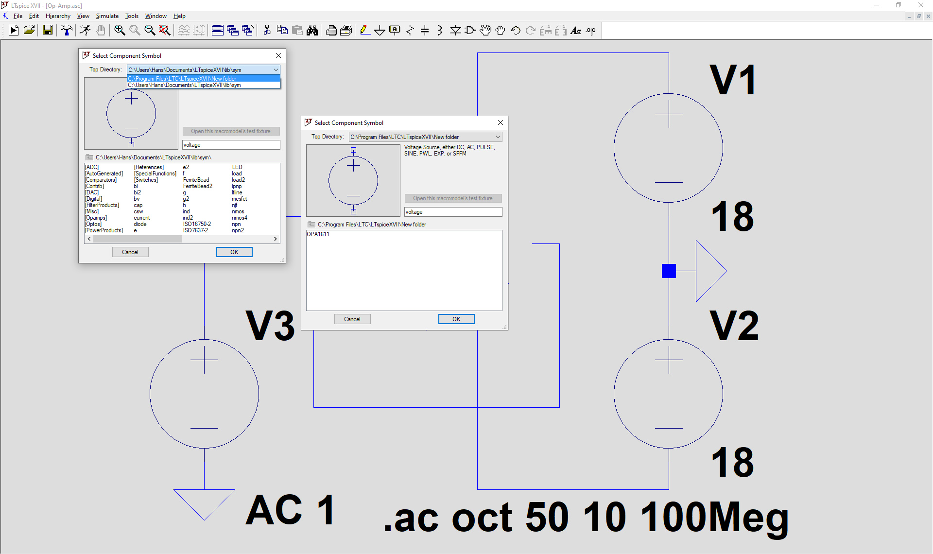

Reopen your Op-Amp.asc file and insert the OPA1611 by going to the Component selection symbol and resp. select New folder in the top line and the OPA1611, see third image.
After having selected the OPA1611, place it in your model and run the sim, see fourth image.
When at a later stage you want to use the OPA1611 in another directory, you will have to copy the .asy file to that directory.

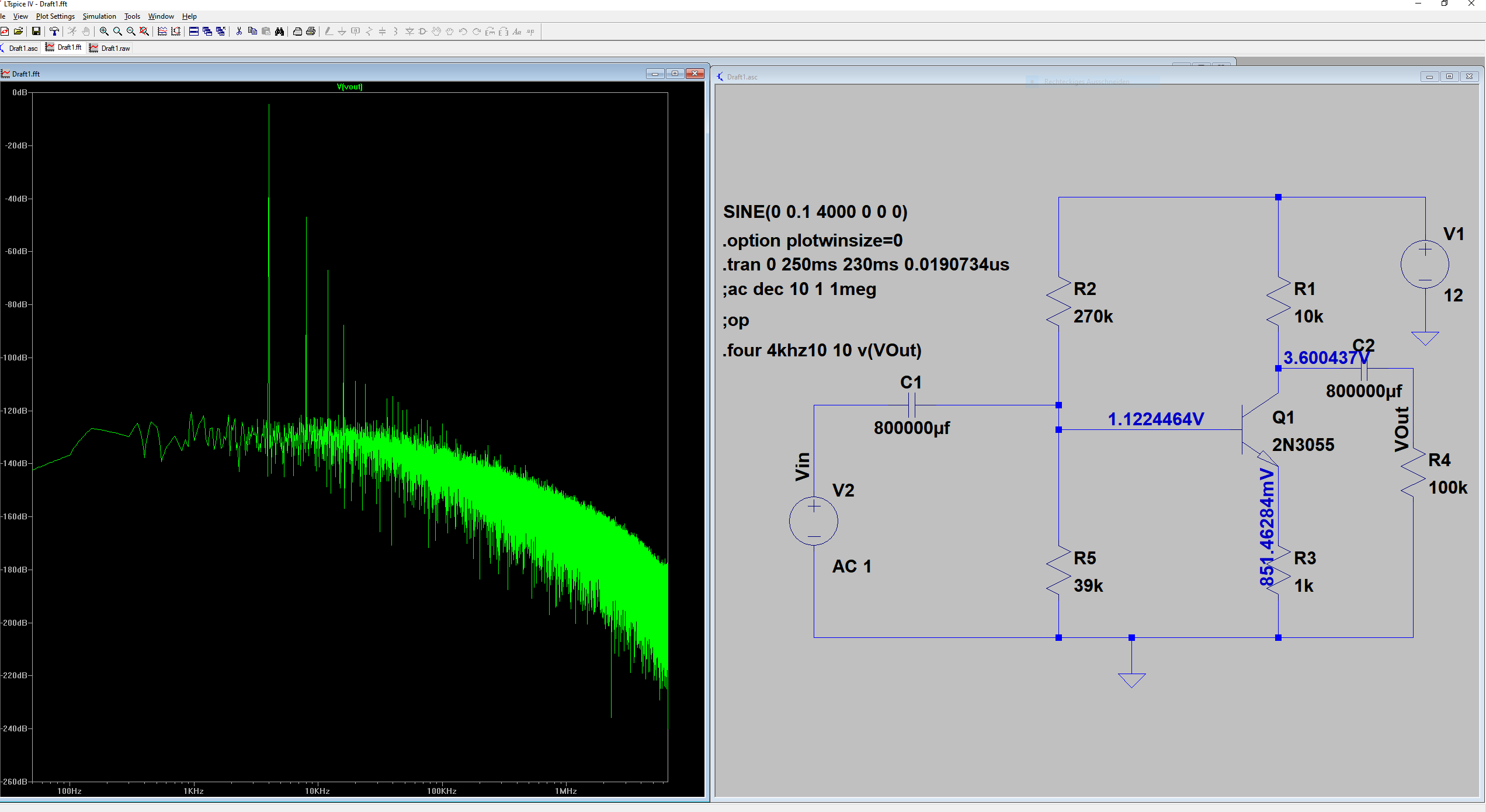

@Mooly
cannot replicate the FFT graphs under #19 with either transistor. Are you sure u really used 2N3055 or 2N2222 ? The pictures are too small to check, but the text label seems something else.
BR
PS: the same file produces different graphs on LTSpice IV vs. XVII also. But still not the same like in #19. I want to confirm first the transistor used. Other parameters should be identical.

Furthermore, the shape of the FFT graphs seems to depend highly on what is put in as timestep, plus the precision of that number.
If I put in the exact timestep for the 10ms run (0.03814697265625us) I'm back to the first simple FFT graph. This is confusing me.
The result for THD is almost correct (lest the last 3 digits): 0.744286%
EDIT: with 100ms/90ms (stop time/t.t.start) the THD is 0.744373%, so this is a matter of stabilizing.

I'm just running the file downloaded from post #14.
The input voltage on that file is set to just 10 cycles and so that needs clearing (deleting) for a longer sim run. Also have you set the input to 4kHz to match the timestep of 0.0190734uS in post 19?
Also have you got the command of .option plotwinsize=0 on the sim?

Thanks for taking the time, I know it was long ago
Yes, I had set to 1000 cycl and also tried clearing it. .option plotwinsize=0 is there, too.
Here are pictures of both 10ms run and 20ms run. I'll also attach my file, if you have the time, perhaps you could just run it.
Btw, how does that work? For 10ms you calculate 10ms/262144 = 0.0381469us, ok.
But previously, it was 20ms (230ms-250ms), not 20 cycles (5ms@4kHz), so should it be 20ms/262144 = 0.0762938us instead?
