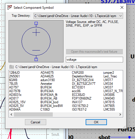

Carlos,
I think you are going to find that no matter what question you ask here you are going to get a number of different suggestions for how to proceed. The approach you are taking is to start with a subcircuit file and create a custom symbol for it. I do the opposite: I use a generic symbol and can attach any number of devices to that symbol without creating a folder full of symbols that can only be used with one device. To me, it's much easier to just include the appropriate subcircuit or library file and use the symbols that are already available.
The only time I would be inclined to create a custom symbol for a device would be if that device model had a non-standard pin order which was incompatible with the generic built-in symbol. But even in that case, I typically modify the model to match the symbol, instead of the other way around.
But the important thing is that you got your simulation working. Congratulations!

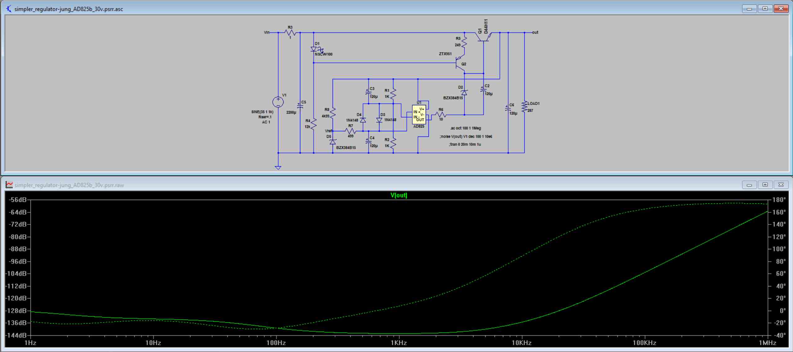

Very happy to apparently had managed to get things right. Once again thanks to all.
It would be great if you could explain your methodology more in detail, as it may proof interesting to me too.
OK, now the bug got me. And I started to make more models from .cir files. Hopefully it will be another stage in the learning curve.
One comment I think it's worth mentioning, even if it may not be accurate. It's amazing, or surprising, to see how the LTSpice sim curves resemble the Super Regulator curves John Walton got.
Now let's start with the apparently tricky AD797. Everybody mentions its instability and tendency to oscillate in the Super Reg since day one, since first WJ article series. Is there a definitive way to tame it?
I do have a few DIP-8 AD797 from the days samples were distributed, and if there's a way to try them and not burn anything, I would love to to listen to them and make comparisons.
Creating a unique symbol for every device (subcircuit) you use is very inefficient. This is manageable if you only use a few devices over and over but will eventually become overwhelming as you acquire more models. I have hundreds of models for various devices and I can't imagine having to deal with a special symbol for every one of them. As mentioned earlier in this thread, the .inc and .lib directives are the most efficient way to use third-party models in your simulations. I do suggest that you try to grasp that concept because it will make things much easier down the road.
As long as you have a subcircuit file for your device (as you do if you are creating a custom symbol for it), then the process for including that device is straightforward. Draw your schematic with the built-in LTspice symbols, rename the instances to match the subcircuit names, and include the model or library files on the schematic with the .inc or .lib directives. If you examine the files I provided in my post #2354 this might begin to make sense.
Ray, I respectfully disagree. Whenever I import a 3rd party model, I auto-create the symbol and save that in my 'my symbols' folder. It just takes a few moments, and I end up with a library of symbols that have names for the part they represent. Exactly like the list of parts whenever you look in an LTspice list. No need to bother with .incs or including complete netlists on the schematic.
I really don't see your method as easier or faster. But I realize this may be a personal preference.
