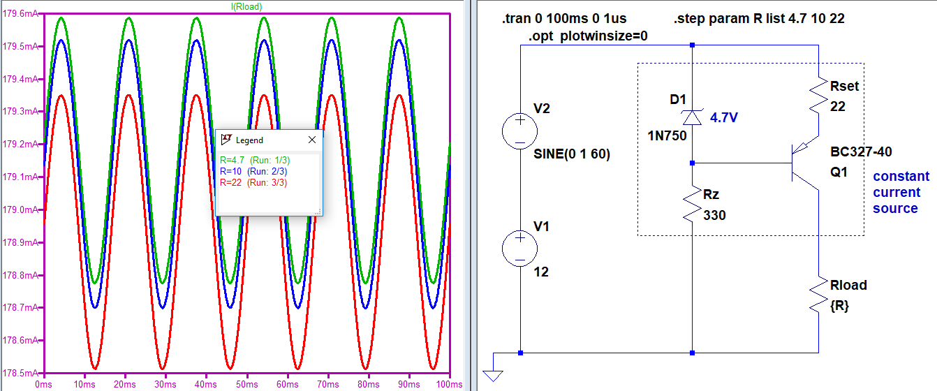

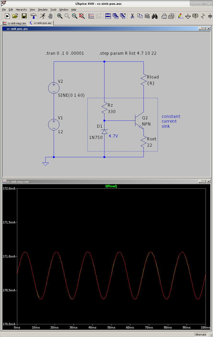

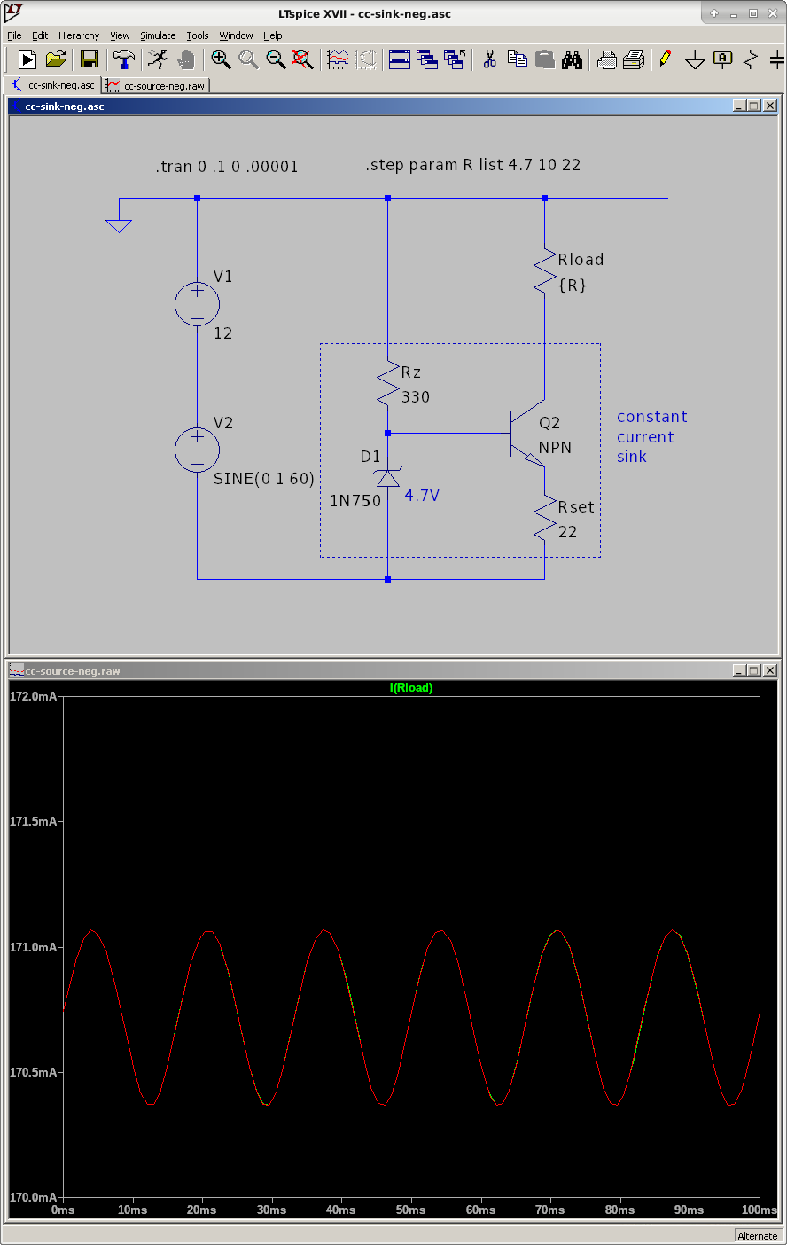

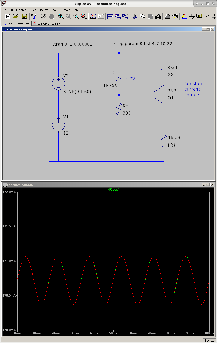

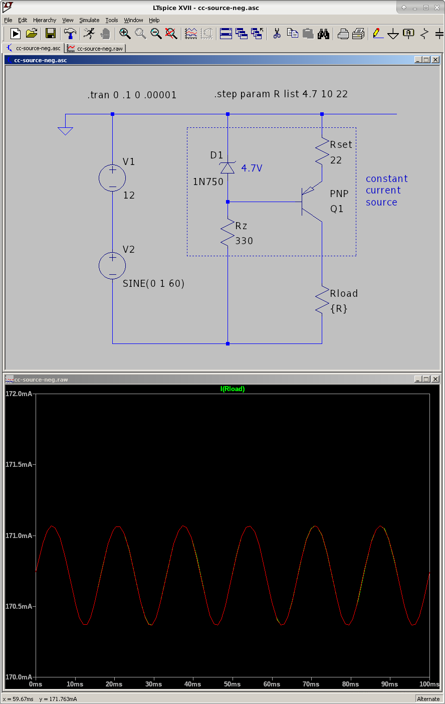

Here are basic positive and negative constant current sinks and sources using zeners and BJTs. I always forget the exact arrangement of the parts, so it is useful to see all four configurations at once for reference.
The voltage source is 12V +/- 1V @ 60Hz, which approximates a filtered but unregulated 12V rail.
The simulation shows that the current through Rload is the same for three different values of Rload (4.7ohm, 10ohm, and 22ohm). It is difficult to tell that this is actually three graphs, because the sine waves are directly on top of one another.
These are useful as a conceptual base to start from, but of course the performance isn't spectacular, because the zener regulation isn't great. From here, you can try to improve the performance (try cascading two zeners, or replacing Rz with a jfet, etc), or try modifying it to use fets, etc.

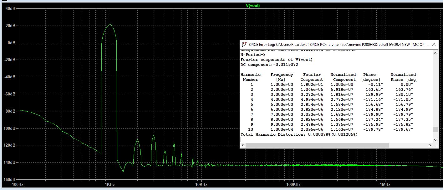

Hello Mooly
I am designing a new amp and naturally I depend on LTSpice for sim and THD measurements.
I hope you do not mind I ask this noob question:
When I perform the FFT analisys I get a graph showing the harmonics but then I select the error log window and the values presented are never consistent with what I see in the graph.
In the image below we see clearly that 2nd harmonic is lower than 3rd but error log indicates the inverse.
Why do these two information do not correlate ?
I have no quick answer to that without being able to play around with the sim.
Have you got the timestep set correctly and also compression turned off (.option plotwinsize=0)
Hello Mooly
Here you have the sim and the models I am using.
Please try with power = 20w and do the FFT.
Error log does not give the same results.
I do need to be sure about the values presented in the error log because I have a spreasheet that I use for comparisons.
Yes. I will post the sim asap
You seem to be anything but a noob.
The error log result is less accurate as the FFT, both seem to be made by different persons.
Change the numcyc or dlycyc and the error log will change with it but the FFT will stay the same.
In this case results are close, but sometimes the can be much farther apart.
I wrote Anolog Devices about this anomaly but their response was that they had no resources available to investigate this.
