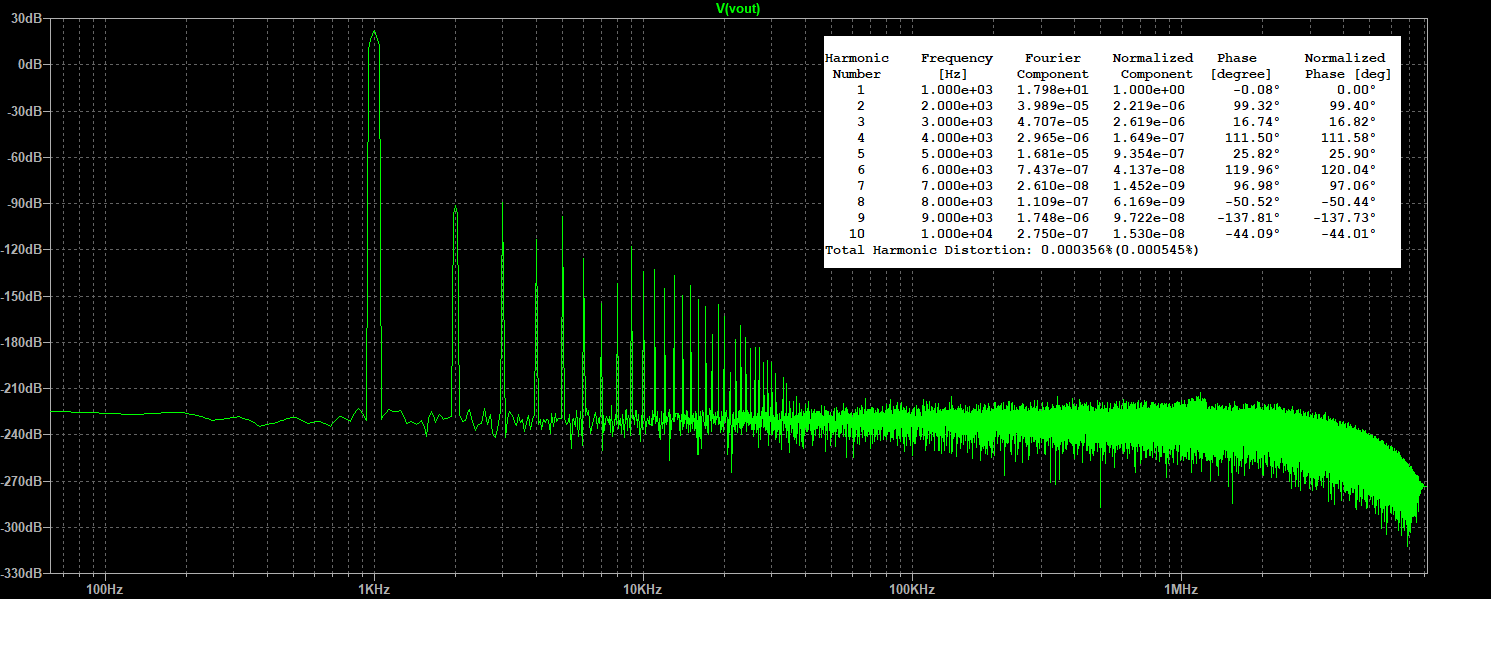

Hi Ricardo,
I've found that I need to do a few things to get good FFT plots that match the error log
I'm sure there's other tricks to get similar results without the brute force method. I'd like to hear them if anyone has suggestions.
I attached the results of my edits. I takes about an hour to run on my machine (which is a workhorse). I also attached the asc file in case there's any other edits I made that I forgot to mention.
- Plot cycles should be between 16 and 32. More cycles makes the spurs narrower.
- Long delay. I often need 2k to 3k cycles to get the noise floor to settle at -240dB. For your file, it needed a 6k cycle delay.
- Significant digits of 7. Haven't found a difference when setting to 15 or higher other than longer sim times.
- Keep the PSU bypass caps reasonably low. Higher values require very long delays. I removed the large caps that I assume were meant to represent the PSU caps. In addition, I believe these only really matter if you are trying to simulate the effects of a noisy PSU.
- I also disabled the reltol and ptrantau options you had set. Not sure if this mattered.

I tried a few different variations on this. These all use 16 cycles from the FOUR analysis.
With a 6 second delay, these scenarios produced the exact same results in the error log numbers:
Using the same 6 second delay, this produced very close to the same error log results, and the FFT plot was materially the same but isn't as "pretty", with the same high frequency spikes. It did run in 30 seconds though.
The real factor seems to be the delay. The value needed is a time, not just a number of cycles. Meaning siming this circuit at 20KHz would need a 120k cycle delay, meaning significantly longer runs times. And the value needed will vary depending on the circuit being sim'ed. I should also note that I removed all the power supply caps for these sims.
If the delay is too short, the THD number won't really change, but the composition of the distortion and it's phase shift will vary significantly. The trick seems to be running the sim long enough for it to stabilize and with enough resolution for it to be meaningful... assuming to believe simulated results. 🙂
262,144 points | significant digits 15 | Model=trap (default)
65,536 points | significant digits 7 | Model=gear
16,384 points | significant digits 7 | Model=gear
The first takes 30 to 60 minutes to run. The last 2 to 3 minutes. The FFT plot in the last scenario isn't as pretty and has some high frequency spikes.
4,096 points | significant digits 7 | Model=gear
When having produced the FFT, you can "export data as text" under the "file" button.How can I extract data from the graph window so I can treat it in a spreadsheet ?
There you can select whether to export it as a polar file, dB & degrees or as Cartesian file, Re & Im.
This text file can be imported in Excel for further processing.
But it is a rather large file with all the FFT points, so restrict the FFT as much as possible.
The other way is to use your cursor to follow the peaks in the FFT.
In the lower left corner you will see what amount of dB's correspond to the position of your cursor.
Exact to within a dB, but for most situations good enough an a lot faster as waiting 60 minutes for a .four or all the steps to be taken to Excel just to find a few harmonics.

The excel treatment of the four command info is easier but results are not very consistent but I found a compromise:
I am now using this setup from Kean:
;turn off compression and use double precision
.options plotwinsize=0
.options numdgt=8
;set frequency and timestep
.param freq 1k
.param num_fft_pts 4096
.param timestep {1/{ {freq} * {num_fft_pts}} }
;perform FFT out to 9th harmonic over last 8 cycles
.four {freq} 9 8 V(ampOut)
For the simulation command, enter the following (modify as desired):
Stop time: {20/freq}
Maximum Timestep: {timestep}
For the voltage source driving the input, enter {freq} for the frequency.
So whatever frequency you choose, the simulation will run for 20 cycles with the appropriate timestep and input frequency.
If the THD result changes depending on how long you run the simulation before the .four command is executed, that typically means there is DC drift in the circuit. See Slanted FFT below for causes and workarounds."
For a better resolution I am using (.param num_fft_pts 16384)
It is simpler than the one I was using and results of four command seem useable for my purposes.

After some experiments i found that any delay larger then 100ms gives similar results. Only 0 delay shows big discrepancies. 100ms gives results very near those found with 6s.
I guess this is more a property of the circuit than of LTspice. The circuit needs some time to become stable.
