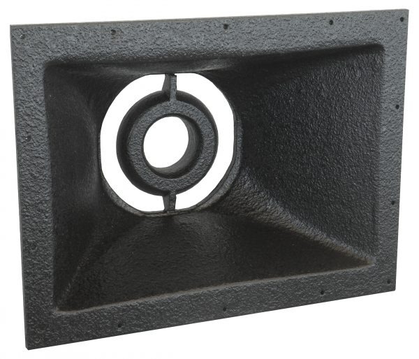

Is the cut off for this Ramsdell Pro Audio horn for real? Seems like based on the physics/size that Iv been fighting that it’s impossible.
Anyone used these?
15″ driver 90 Hz Cut Off Horn90º H x 40º V23.75″ W x 17.5″ H
