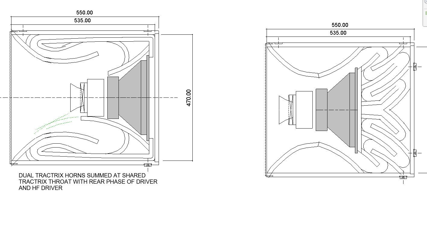

It seems like the tractrix curve has everything going for it, uses less horn length and mouth, helps with low frequencies, directiveity, smooth phase alignment etc..
But has anyone attempted to fold one? or would the folds inherently destroy the curve no matter what? I can barely draw a tractrix curve unfolded at this point, but im fairly sure I could CNC one with a lot of scoring for bending material. Im even open to alternative materials and methods that could wrap the horn path around the main larger horn mouth itself in a spiral for example.
So far GPT said (with a grain of salt) that I could get down to 60/70Hz with a 20 db gain and 3 times the thow as compared to un-vented.. LOL
Attached are some "very" rough ideas for comment.

That depends of how you define 'works'. Yes, something will come out. No, you will not like the result. The vast compression will cause very high distortion and non-linearity and the non-existant phase compensation will cause additonal severe FR unlinearity and bandwidth limitation. Or in other words: Utterly crap.
Folding can be done successfully if you understand the limitations. These are complex and can be difficult to explain in a simple post.
You'll find that builders are reluctant to use folding for a horn that plays through the mid and higher frequencies.
First of all, you need to understand that this contraption has to work in the midrange, LF can't be reproduced because the horn mouth is too small. For the midrange, you'll experience severe phase changes at multiple frequencies and that in a range that's very sensitive to the human ear. It will sound horrible, even to the lowest standards. The fact that on the 2nd picture the 'horn' goes a lot narrower shortly before its final expansion shows there's NONE of the theoretical or practical knowledge applied. It even happens several times on the horn path. I've never ever seen such a bad horn design even from 1st time builders. the first design is even asymmetrical, leaving the cone with asymmetrical load and tumbling motions! If that's what AI is able to design today, you need to wait for 30-50 years to come to something working.
No, folding it like that will not be a TracTrix, it will be more like a rear loaded horn only amplifying lower register, without using the drivers front radiation capacity.
Will not work very well
There have been occasional attempts to save space by gently bending the curve. Specially in the early days when amplifier power was very limited.
Some still like it and use it out of interest and hobby. Some of these designs have pretty decent performance with low distortion output.

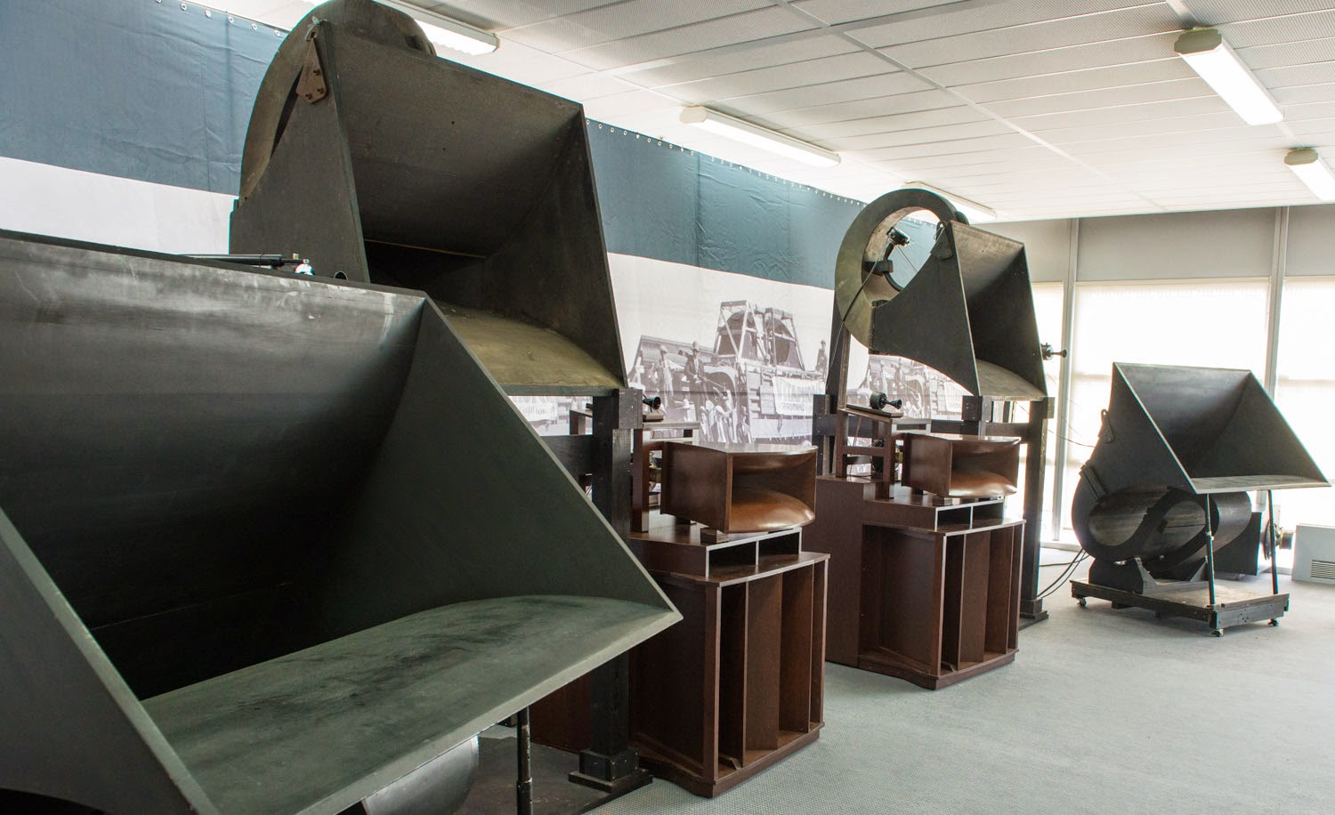

I would say that this picture, showing Western Electric horns from early days of cinema, tells you a lot about where limits goes when discussing bending a front loading horn.

Ok lets check this off as a fail. It seems like the trend for a small speaker is a beefy driver and a lot of power and unvented.. was hoping to avoid that but it seems inevitable. synergy is patented. bass reflex is ehh whatever.. But Im open to suggestions to get more db for the buck from a small box if it exists.
But yes there are much more I need to learn. Thats why I appreciate the guidance of this community on my exploratory sketches..
A main take away from this, is that the horn mounth is too small for lower end frequencies, GPT indicated that if the total horn length inceased, then the mouth opening size could decrease, and there would be the same frq cut off. Hense my trying to extend the lenght. Turns out not true GPT.. LOL
ICG: I appreciate your feedback. One thing I want to point out regarding the provided schematic, it that its just that, a loose schematic out of 30 iterations, roughly sketched to show general intention, and non-symmetrical in parts to indicate different design options, with the assumption that as co-collaborative interpreters, we all know that the horn is supposed to not be more narrow as it expands.. But Ill make that more clear next time I submit a design for feedback. The funny thing is that any more work drafting on my end would have been pointless because it turns out that this design " concept" is a dud.First of all, you need to understand that this contraption has to work in the midrange, LF can't be reproduced because the horn mouth is too small. For the midrange, you'll experience severe phase changes at multiple frequencies and that in a range that's very sensitive to the human ear. It will sound horrible, even to the lowest standards. The fact that on the 2nd picture the 'horn' goes a lot narrower shortly before its final expansion shows there's NONE of the theoretical or practical knowledge applied. It even happens several times on the horn path. I've never ever seen such a bad horn design even from 1st time builders. the first design is even asymmetrical, leaving the cone with asymmetrical load and tumbling motions! If that's what AI is able to design today, you need to wait for 30-50 years to come to something working.

Here is a better design objective question: how would one capture the rear 1/4 wave phase of the driver in a traditional tracxtic horn and combine it with the main horn? For a reasonable full range or mid/high response, in a reasonable sized box?
For example how could these beauties integrate the rear phase of the driver? Also lets assume they were designed as are coaxial semi-full range 🙂
