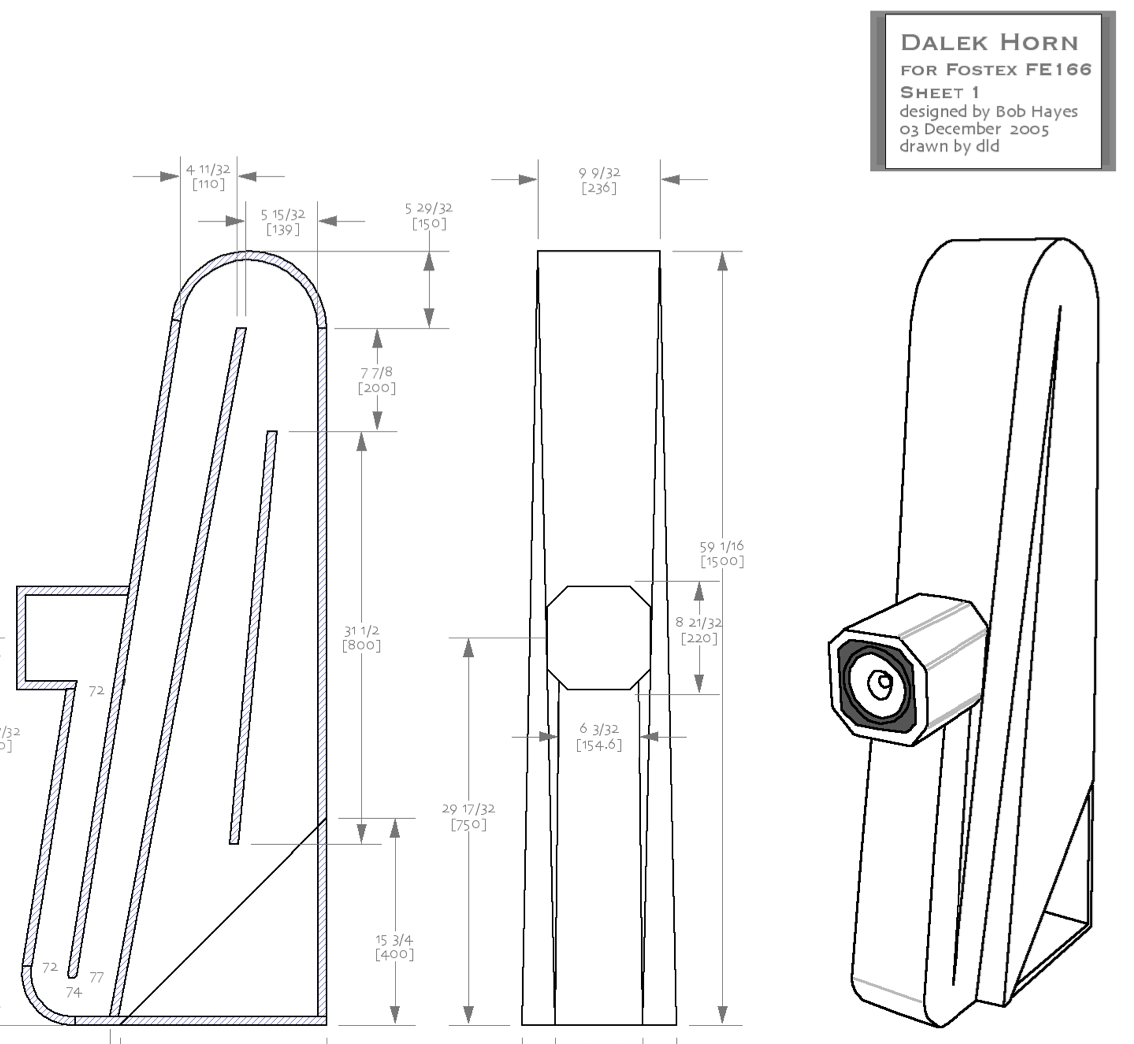

The Hedlund & Del Rio are similar to The Daleks, https://frugal-horn.com/daleks.html
All 3 of these are “air cavity” back-loaded horn that try to be as smooth as possible. Only bass frequencies are horn loaded (they are direct radiators above that frequency) , typically below n250-300 Hz. The smoothness is actually counter-productive as it tries to pass maximum HFs, notsomething you really want to come out the mouth.

Any fold in a horn is creating problems and since Dalek have two fold while Hedlund and Del Rio have no folds, but curves keeping most of the sound wave intact they will have a quite different sound. There is no folded horn like those without folds.
Because too much HF is radiated out the mouth — and a front mouth exacerbates things. Not taking advantage of a rear mouth typically means an octave or more less bass extention.
Given the frequecnies involved the curves in Dalek are close enuff to be considered really close to the other 2.

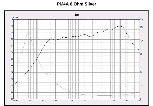

Some examples that eighter need a front horn to lift 200-2khz region or a BL that extends up in the midrange, or both.

Both these Lowther drivers need some midrange support from the horn. PM4A more than DX2, but neighter will sound good if they don't have it.
