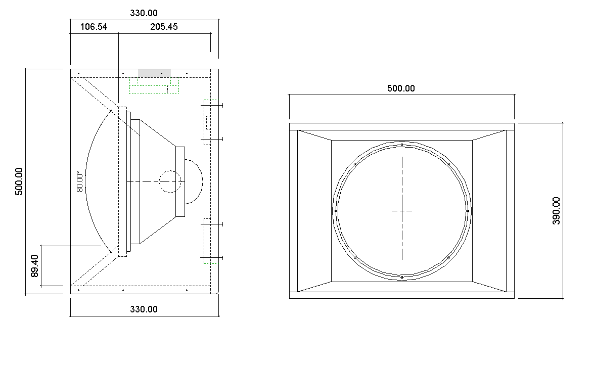

Ok Im getting close. If possible, please help me narrow this down, I was originally headed towards a "front radiating with a shallow lense" as another user described it in the begining of my journey. But my ambition of loosing rear phase power, blined me LOL
I was thinking a coax would be the fun way to go.
Some of the coaxials are indicating a natural dispersion of 70-80deg, and others 100deg, and I was afraid, maybe unfounded, of introducing some artificial constraint (waveguide) that would ruin the natural coaxial phenomenon.
So the good news Is that Im down to 2-3 fairly similar designs.

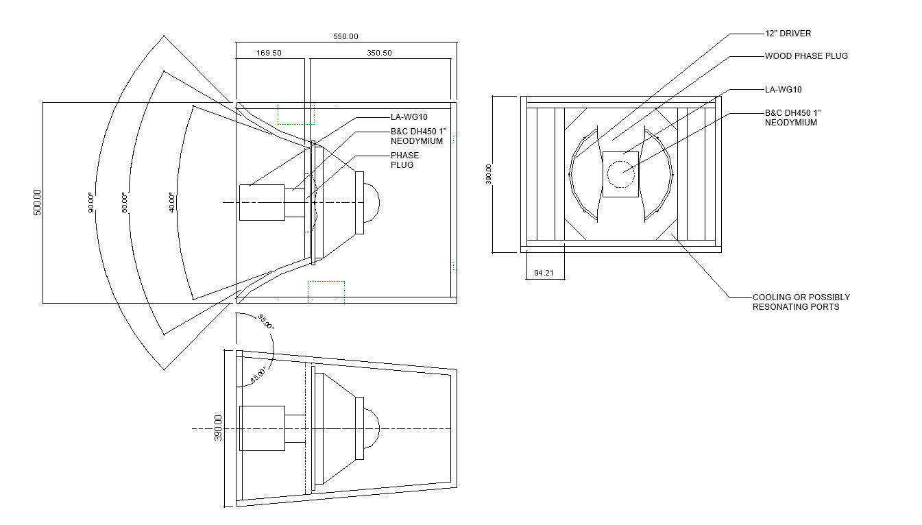

Plan B
  • use a separate 12" LF + shallow HF driver in front as a qasi-coaxial configuration
  • line array style HF wave guide? Eminence LA-WG10, with some kind of reverse bullet behind it for flow. Honestly Id love to cnc this HF waveguide out of wood as part Two in this design process.
  • same 105mm waveguide length, straight or arc of some kind.
  • un-vented

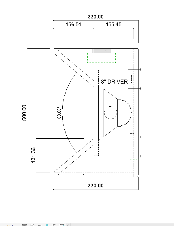

** In both options, driver size can be reduced, in exchange for longer waveguide depth as needed.
An beefy 8" driver would have a 150+- mm waveguide depth for example.
A beefy 6.5" driver would have a 180 mm waveguide depth for example.

Am I splitting hairs here, or am I headed for a realistic target?
(loose!) Schematic plans attached
No, 70-80° is perfectly reasonable, the horn of a coax will not have a wider dispersion anyway.
Hopeful constants
  • stack these like a small cheap line array later down the road to at least gain some coupling, so Im thinking 80deg? horizontal x 15deg+- vertical? More research to do on line arrays...
Uhm, no. These coaxes aren't stackable. The distance from the middle of the driver to the next make it impossible, you get very ugly lobing and interferences. Either you accept the max spl limit of the coax or you need a completely different concept.
You can't stack that either except if you put 3 of the LA-WG10 in front of the 12". Each of these needs their own CD too btw.
Here is a single driver with horizontal dispersion angles that seem to feel right, and vertical dispersion that seems common? for a line array coupling effect, and can be notch CNC'd to meet a mathematical arc of some kind if it helps., and a phase plug.
There is cooling in the form of front ports that can be resonators if there end up being enough volume.
I realize that the I need another HF driver and guide, and even that is probably not enough. Im hoping to look into CNCing a HF wave guide to fit this design top to bottom that uses only 1 HF driver.
At this point Im just trying to get close to something that has a percentage of being successful. It seems like all my other sketches end up as duds. But Im feeling Like there is some practicality to this one.
Any comments suggestion are very welcome.

Your new drawing/plan of the speaker includes the Eminence LA-WG10. If you don't build a (real) line array, you will not be happy with its behaviour. It disperses the sound 140° x 15°, that is extremely wide horizontal and extremely narrow vertical, practically laser sharp vertically. I still don't know what you want to do with such a speaker and with such a dispersion the use of it is limited to just very rare circumstances. Before making further plans it would be a good idea to define the requirements of the speaker(s).
  • Use (PA? Home-HiFi?)
  • likely room/venue size, # of audience
  • dispersion requirements
  • needed spl
  • size requirements (truckspace) and weight limit (if moved often)
etc (because I probably forgot a lot again)

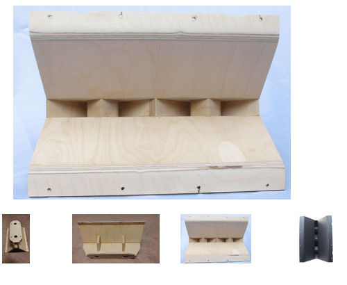

Im not in any understanding on the wood horn image attached, but I feel like something like it can be done in a ..reasonably useful way...
That might actually be part of the mission statement of this design objective "reasonably useful way"
My scope has been a moving target, because as I get feedback on the reality of physics, the design objective changes.
I Im going to post an update to the objective, to help us all hone in on design outcomes..
PS wchang I appreciate your comment but I cant internalize it. could you bring it into a more general layman form/feeling/result?
Well, that is a horn for a flat wave front, for a line array. It's made for 2 drivers.
Well, the problem with that is, every time you're changing your target, all the help and time invested up to that point is wasted. Every time you see a new shiny thing, you want it.
That makes helping you not especially rewarding.
Tell what you need to do. If you don't have anything to describe what you want, nobody can actually help you. I feel I have invested enough efforts, I'll concentrate on other things in the forum now.
