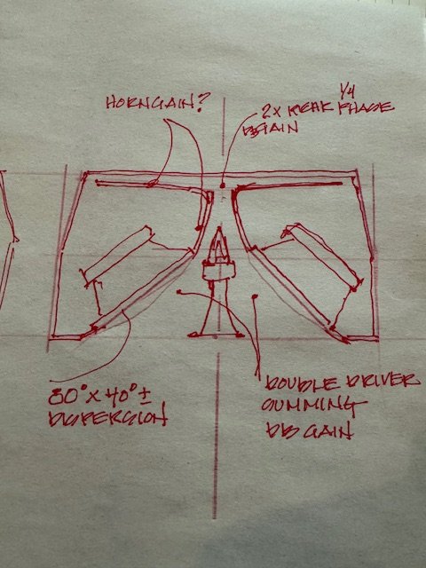

Ok lets get this thread back on track..
Based on all of the acoustic design principals (that I understand so far anyway) the attached design is full of db gains for a PA mid/high. . At this point Im afraid to suggest adding one more horn baffle on each side🤐
Can I expect to get any meaningful extra db and cut off increase from the rear wave? or is it just creating phase and other problems, and I should just stick with front radiating? Assume an 800-1000mm outer dimension box width.
is there a Hz per mm rule of thumb, for horn cut off vs horn mouth size? I guess horn length just dedicates db?
I think this might be the area where im in fantasy land.
I tried volvotreder's spreadsheet but I dont fully understand it.
The rule of thumb, the mouth perimeter is the LF cutoff wavelength.

Personally, using a front horn, I would focus more on directivity control than on loading. As @ICG already stated, a front loading horn has its cut off, and you make things worse below the cut-off. What I mean is to match directivity of the LF to MF/HF at x-over point and then it turns out to be more or less a waveguide for LF. It is easy to design a waveguide that does load less in the intended frequency range.
What is the difference between a wave guide and a horn mouth for low/mid? Doesnt the wave guide suffer the same size vs cutoff constraints? or are you talking about a HF wave guide?
if your referring to LF/mid, what are the design parameters for a wave guide? just angled dispersion baffles at some degree at some depth?
- insane question: can a tractrix horn be folded?
