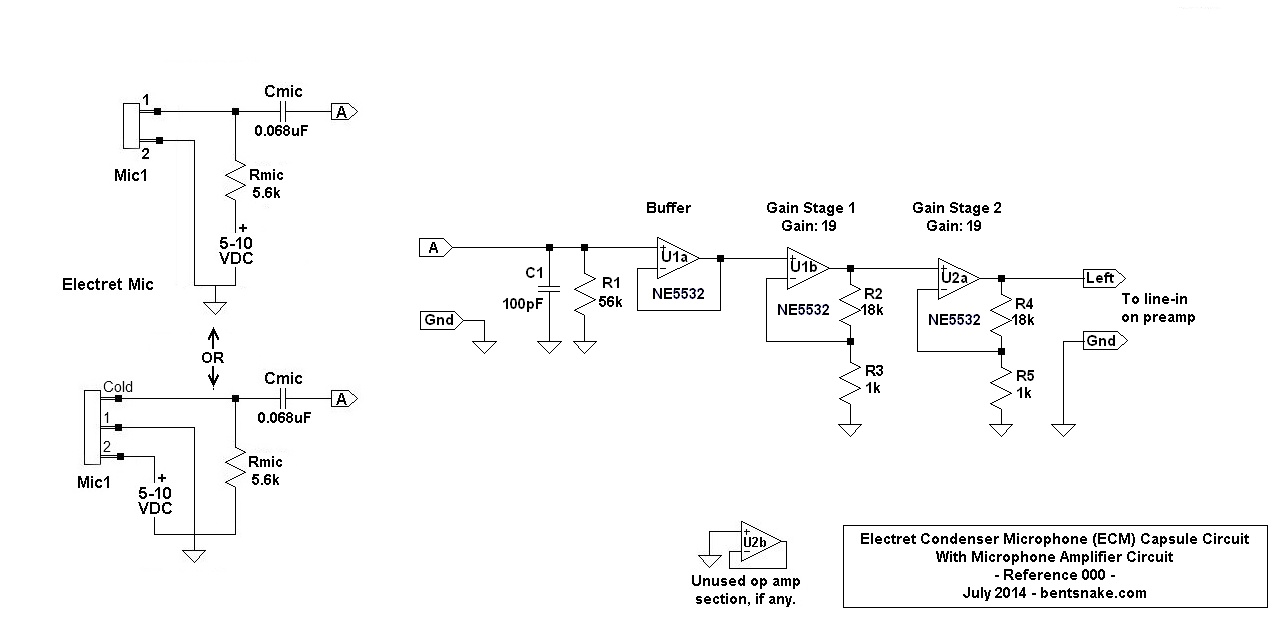

input load/mic impedance

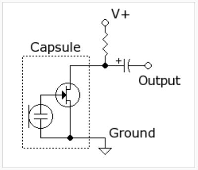

<< 50k is getting up into the Johnson noise region, yes, if that is the source impedance seen by the stage...Your mic is NOT that. The 50k is parallel to the 5k6. That reduces the source impedance seen by the amplifier to 5k >>
My understanding is otherwise. The short explanation is that the 5.6k resistor doesn't count as part of the buffer circuit, it counts as source.
Being more long winded, the 5.6k (in this case) resistor is load resistor. Its function is to drop whatever might be the operating voltage of the capsule circuit, so a voltage will be present at the capacitor. This voltage is the input to the buffer.
When the buffer "looks back" at the capsule circuit it sees this voltage, accepts it as an input voltage, and does what buffers do.
Worth a brief consideration here is the FET (Field Effect Transistor) inside the capsule housing. Panasonic calls this an "FET Impedance Converter." I've attached an illustration from Wikipedia.
FETs are extremely high impedance devices, and here the 5.6k resistor is in parallel. The result is that the FET effectively becomes an open circuit as far as the buffer is concerned, and the buffer sees only the 5.6k resistor.
But it's not a resistor as far as the buffer is concerned, it's source. This capsule puts out about 5millivolts, so the buffer is seeing "a 5millivolt power supply with a Zout of 5.6k." And it's this 5.6k that we multiply by 10...or 7...or 20...or at this point by the winning lottery number that week.
Or of course I might have the whole thing wrong. But that's my story and I'm sticking to it.

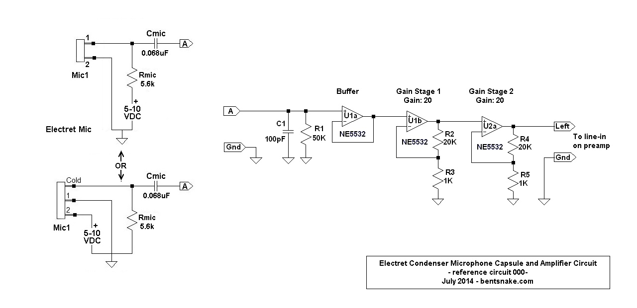

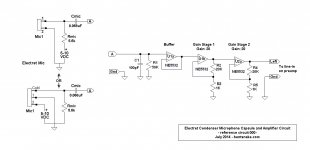

The circuit I've attached has no attenuation. It's a compendium, more or less, of what's been discussed before, and is intended as a reference point.
The circuit has the 40 Hz rolloff you mentioned, but I still suggest just using a 1uF capacitor for all testing. For your present purpose rolling off bass seems beside the point to me. The important thing is just to block the capsule power supply voltage from the NE5532 circuit.
To power the capsule, I'd think a battery(s) would be the best way by far. Otherwise you're into power supplies and additional wiring, with things getting my least favorite thing: complicated.
At once you wonder: but the two grounds, the battery circuit ground, and the amp circuit ground, are at different voltages, so what do I do about the grounds?
You connect them together. The battery circuit is isolated unto itself, so its ground will "float" higher or lower to match the amp's power supply ground, and that's that.
So here's the reference schematic. Tomorrow, or when I have a chance to check my figures, I'll post additional.
<< I agree that for my purpose that a volume control is an addition and unnecessary complication... >>
It would be, if it weren't for that gain of 400, I belatedly realized.
The working number I use for ECM capsule output is 200 millivolts. But the data sheet you posted shows 500 millivolts output (if I read it correctly). This 3 millivolts times 400 is significant, it can overload your preamp line-in circuit, causing distortion and making the whole thing an exercise in futility.
Sooo attenuation will occur. Sec.

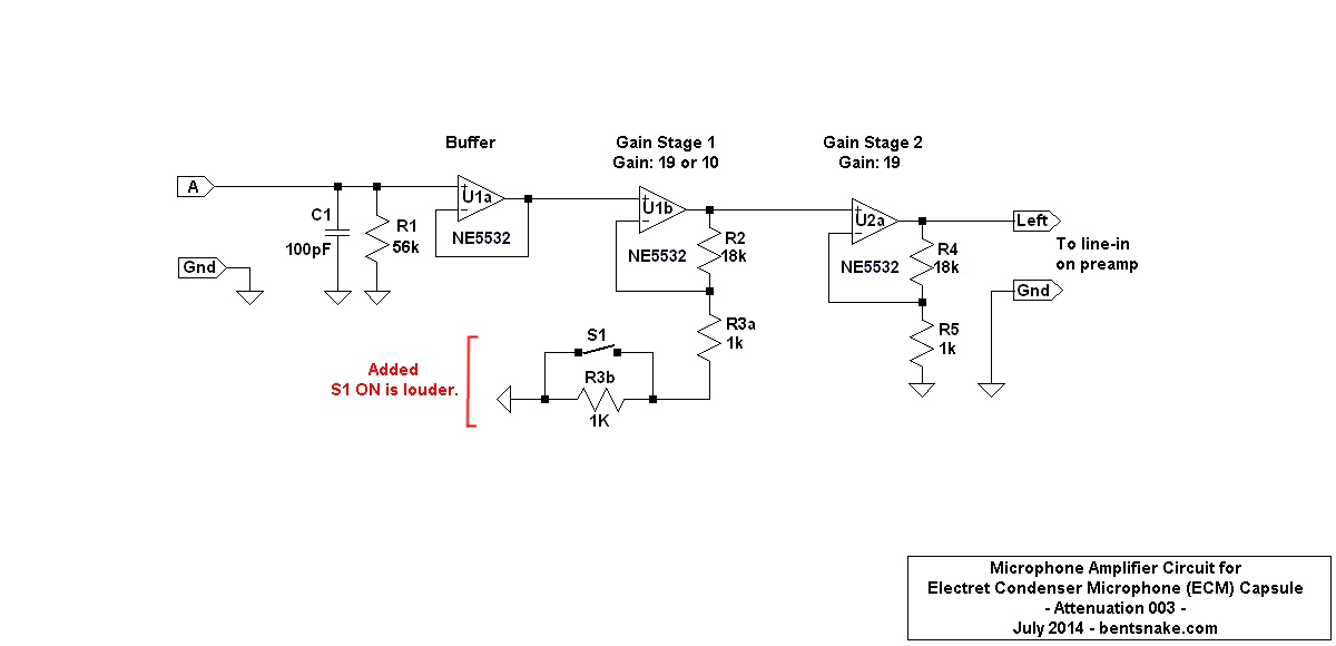

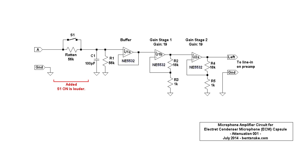

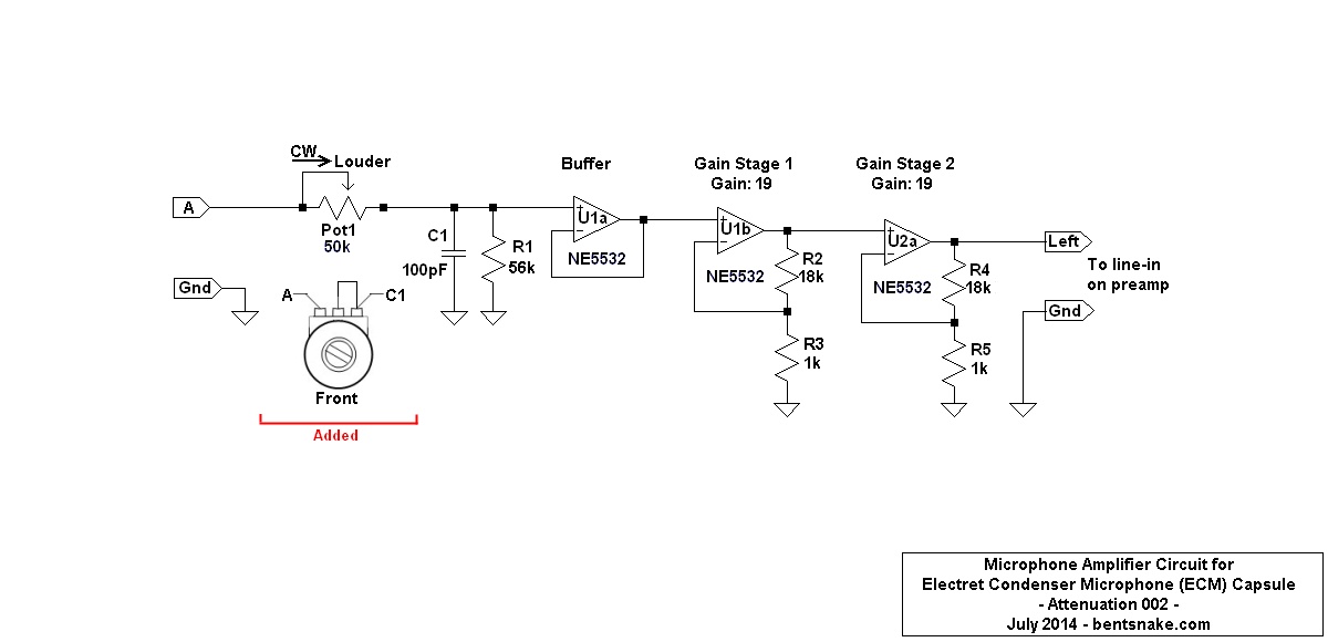

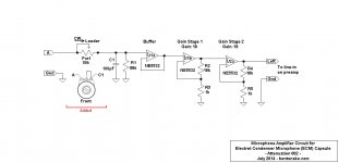

As advertised:
ERRATA: In the circuit I posted earlier I neglected to change the resistor values to standard values. That's corrected in the new Reference 000.
Following Reference 000 there are three circuits. WAIT! Please don't get excited and start cussin' me, shouting things like, "Pick the one I need? How am I supposed to pick the one I need?! If I knew what I needed, I wouldn't be asking you in the first place!"
Let us proceed calmly. The question now has nothing to do with electronics, it's purely mechanical. The parts we use are small and (preferably) close together, and mistakes are regrettably easy to make. Sooo...which circuit do you find the least irritating to build?
Attenuation 001 would be my own choice, unless I had compelling reasons to do otherwise. It simply decreases the level of the incoming signal, unless the switch is closed, and then it does nothing.
Attenuation 002 is the same thing, but adjustable. Adjustable is nice, but the pot body probably needs grounding, and generally things are a bit more mechanically complex.
Attenuation 003 has the theoretical advantage of not affecting the incoming signal in any way. It's after the buffer, at which point you're working with a low-level, low impedance signal, which is home free for an IC (integrated circuit). But I don't think the theoretical advantages accomplish anything in the real universe, and the thing might be a bit of a pain to wire up.
All three circuits do approximately the same thing--allowing for using standard component values--so it's just a question of which you think might be easier to build. And then, in any case we're not talking about wiring up the starship Enterprise. You could easily make a case for just flipping a coin--I guess you'd have to flip it twice.

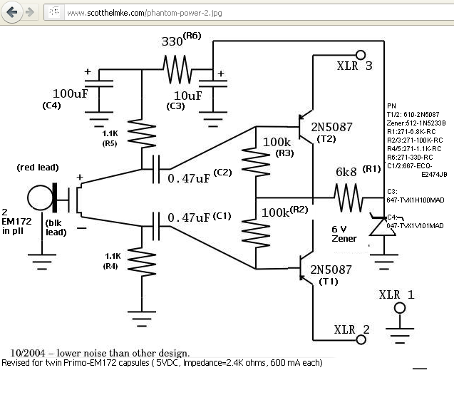

<< a couple of more informative pdfs on Primos mic >>
Strangely, what you call the Primos mic also seems to be Scott Helmke's Alice mic. Same schematic: Alice Microphone
The audio part of the mic is JLI's Transound TSB-165A capsule. Data here: TSB-165A
Looking at the capsule data, you might notice a certain of-a-muchness. I'm trying to suggest an idea, there. No doubt there's a difference between a 50 cent capsule and a $7 capsule...or...hmmm.
The circuit shown by Mr. Helmke--or whoever--is a mic amp only in passing. It's main purpose is to convert the mic's single output (true of all mics) into a dual output that will travel on a "balanced line." (hence the XLR connectors)
Briefly and not very clearly, with a balanced line the mic's single output is first split and amplified, then one of the signals from the split is sent down the line as-is, but the other is flipped to be out of phase.
At the receiving end, the flipped signal is flipped again, so it's in-phase, and the two signals are combined. The resulting single signal is then sent on to a buffer, preamp, whatever, the same circuits I've posted in this thread, plus or minus some gain as required by that particular system.
It's important to realize that balanced lines, and their associated XLR connectors, have nothing to do with audio directly. It's all about reducing the noise picked up by the connecting cables, and only that.

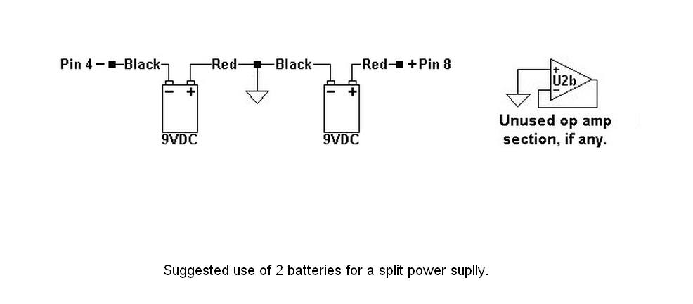

My heart sinks. You intend to run a single-supply circuit, using just one 9 volt battery? Could you possibly not? Posted below is how to hook up two batteries.
I'm not even sure the NE5532 will run on 9 volts, which is +/-4.5 volts. The circuit is more complicated (to split the 9 volts into +/-4.5 volts, for one thing), and performance is less. With the sheer quantity (as opposed to volume) of sound that a cello puts out I have deep misgivings about using a single supply.
<< P48V >>
And 48 volt phantom power to boot? Then I'm off the hook because I know nothing on the subject, since I don't use it.
But I don't think any electret capsule uses 48 volts, or anything close to it. Would you consider using batteries? Electret capsules draw so little power that the battery life is pretty much their shelf life--as long as you remember to turn things off.

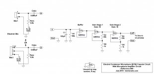

<< As this looks, isn't the power only going to the NE5532 and not the capsule >>
Yes. The circuits you posted have a power takoff for the mic capsule, while in the circuits we were discussing the mic capsule had its own battery. But either way is fine, six of one.
OK, so I don't like single supplies, but if you do then you do. I have no argument a'tall with the circuits you posted. I especially like Simple Stereo Electret Mic Preamp because he draws a nice schematic, i.e. you can make some sense out of the thing. However, it does have a maximum gain of about 20, which might not (or might) be enough.
<< I haven't seen to 2 battery in a NE5532 circuit before >>

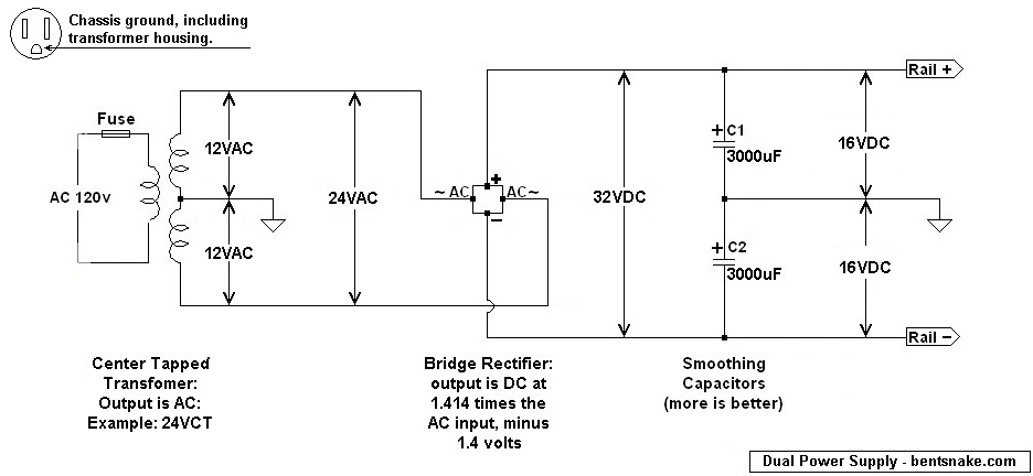

Then good thing you ran into me. Whenever you see a power supply you can just as well think of it as a battery, and vice versa.

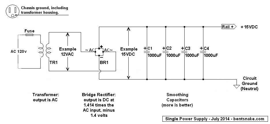

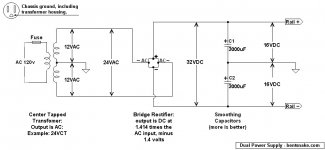

But that hookup is not for the single-supply circuit you want. But wait...do you know about single and dual supplies? Now I'm thinking not.
Single supply = a single, positive, power supply voltage to the circuit. The hookup is positive voltage to pin 8, ground to pin 4.
Dual/Split supply = two power supply voltages to the circuit, one positive and one negative. The hookup is positive voltage to pin 8, negative voltage to pin 4. Additionally there is a zero-volts ground which never connects to the NE5532 at all, but is circuit ground.
Just in case I'm posting an illustrative circuit for each kind of supply.
Totally unrelated to you is the fact that some on this forum go into a rant whenever they see these circuits. Those should know that they're looking at a close adaptation from Douglas Self's, "Self on Audio," so they should send their complaints and corrections to him.

Moving along from there, all op amps are designed to run on a dual power supply, that is, a plus and minus voltage, with a center-point ground. This is not a law of nature, it's just how they're designed and intended to be used.
However, they can be made to work by creating a "virtual ground" circuit. We usually think of ground as being...ground, the earth, and usually it is. But actually "ground" is an arbitrary, it's just what we agree on as the zero-voltage point. So we can call anything ground and just measure everything from there. As with a virtual ground circuit.
I've posted the same circuit powered two different ways. In the top (single supply) circuit the indicated +4.5 volt point has become ground, the zero-volt point. Just because we say so, we created a virtual ground.
So put one lead of your voltmeter at the +4.5 volt virtual ground, which we re-define as zero volts. Measure to point A and you'll see +4.5 volts. Measure to point B and you'll see -4.5 volts. The op amp sees a plus and minus voltage supply, so it works. Only that the circuit is more complicated, to create that virtual ground. And by the way, most op amps of interest to you are not really designed for +/-4.5 volts, most are much happier working up around +/-15 volts.
BUT note well C1 and C2. Both are needed to isolate that +4.5 volt ground, because previous and following circuits probably have the expected "ground" ground.
Ummm...remember how I mentioned MIT?
GENERAL NOTE. Yes I've left out some components, notably smoothing, bypass, and decoupling capacitors. And yes C2 in the single-supply circuit, and C1-Ri in the dual-supply circuit, are unexpected values. None of which is, for crying out loud, germane to this discussion. The idea here is to give useful information, which means K.I.S.S.
