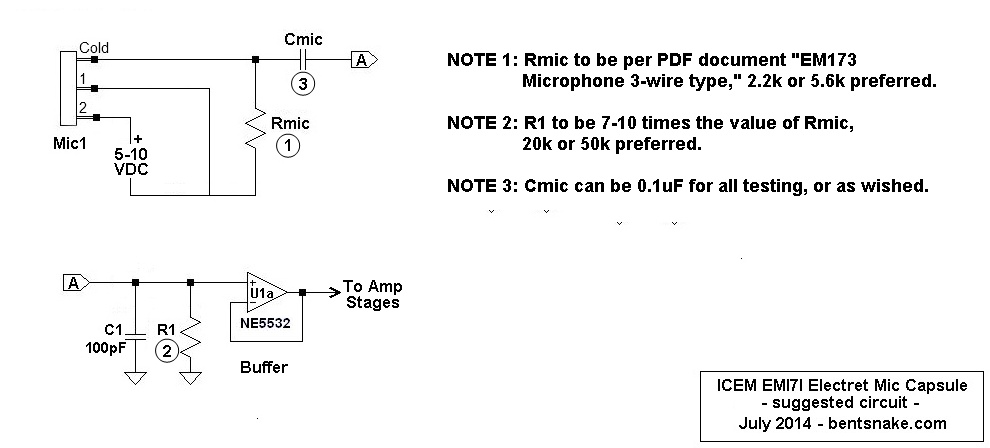

Well, post #16 is how. In the "Electret Mic with Mic Amp" circuit change R1 to any value, and that's the input impedance of the circuit. If this seems too simple to work, well, that's why we use those little black chips. The engineers already did the math for us.
But testing is rarely simple. I've re-posted the microphone spec sheets you posted before. I've also posted a schematic that matches this capsule to the schematic in post #16.

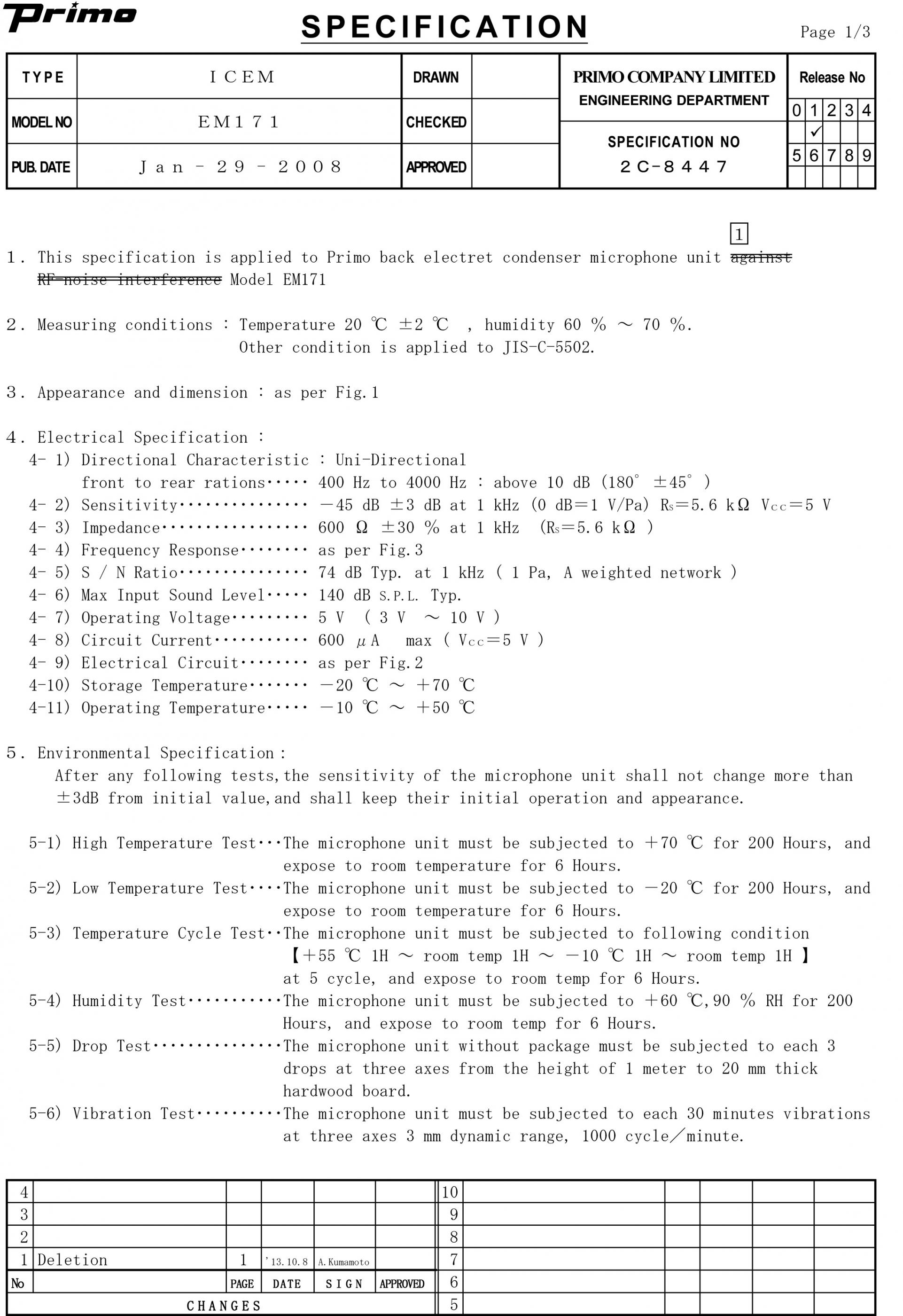

Circuit note: The spec sheet states that the mic impedance is 600 ohms. This implies, but does not state, that impedance matching is required. So should the input impedance of the following stage be a matching 600 ohms, or a "times ten" 5K? I dunno. Either have to ask the manufacturer, or experiment. Asking is usually easier and cheaper. (It's expected that the internal circuitry of the capsule interacts with the specified 5.6K resistor to give a total output impedance of 600 ohms for the capsule.)
If you ask, be sure to find out how close you have to be to the stated 5 volts. With batteries you can get 4.5 or 6 volts, and I expect either would be fine, but better to ask.
The stated 600 ohm impedance implies an expectation of the "balanced line" that sreten spoke of so long ago. As an item of information, a balanced line has nothing to do with audio directly. Its purpose is to reduce noise picked up by connecting cables, and only that. So balanced lines can be ignored for testing.

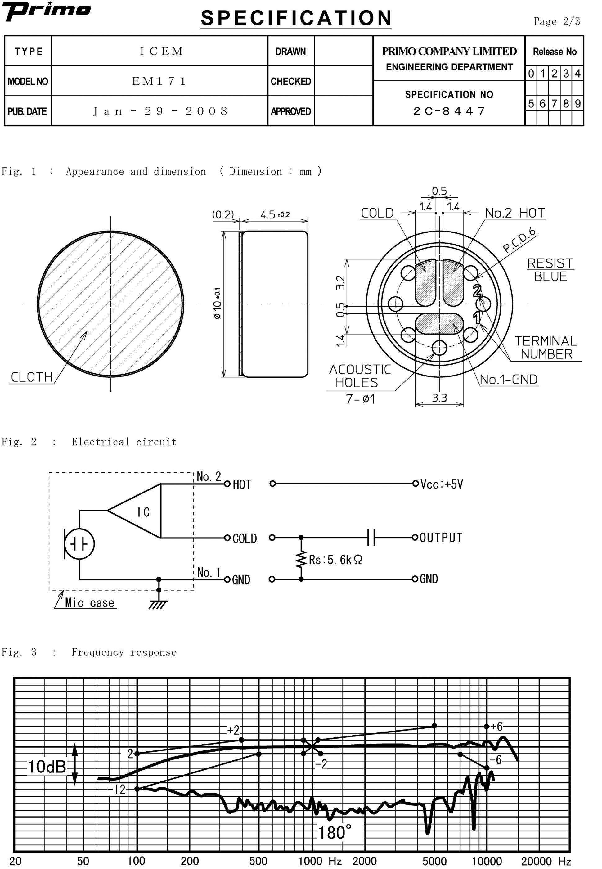

page 2/3 shows the circuit connection.
It has Hot into pin No. 2
Cold going into the unlabeled Pin
GND going into Pin No. 1
Hot = Vcc = +5V
Cold = the output line but must include the two components shown.
GND is the common between power supply and signal.
The suggested load is 5k6. This is also stated in line 3) of the electrical specification, They call it Rs (why?)
line 7) also confirms the 5V for Vcc but gives a tolerance range. This range may be absolute maximum rather than a recommended range of working Vcc.
Back to page 2/3
the mic shows an IC.
This IC has 4 connections. I suspect this is an amplifier as well as a power supply to the electret condenser. I can't see any reference to piezo.
The output is not balanced impedance.

Moving along to my personal problems, all electret capsules use a preamp housed inside the capsule.
Wikipedia: Electret microphone - Wikipedia, the free encyclopedia
Panasonic: http://industrial.panasonic.com/www-data/pdf/ABA5000/ABA5000PE44.pdf
My [latest] confusion comes from the ICEM-EM171 data sheet, page 1, line 4-3, the symbol Rs.
"Vs" in schematics means "voltage: signal," i.e. the incoming audio signal voltage. (N.B. Vs does NOT mean "volts: supply," as in power supply voltage.)
So if Vs means "voltage: signal, I took "Rs" to mean "resistance: signal," translating that to mean the impedance of the device, the "device" being the mic capsule complete with battery, resistor, and capacitor. Read this way, the output impedance of the capsule complete is 5.6K.
But while line 4-3 gives an "Rs" value of 5.6K, at the same time in the same line it states that impedance is 600 ohms. The upshot is that I don't know what to think, and I wish these people would make up their minds.

Rs is usually reserved for source resistance, i.e. the resistance seen by the load looking back at the source connection.
The 600ohm could be the output impedance of the amplifier inside the capsule.
The 5k6 looks like the recommended load for that amplifier.
If you add on an external amplifier it will look back and see the output capacitor and then 600ohm||5k6 resistor.
I would expect that the capsule amplifier would not like to see a load significantly lower than the 5k6, unfortunately the spec does not tell us.
I suggest an input impedance/resistance (Rin) of around 20k for your amplifier. But that is just a guess.
It is this external amplifier that should be designed to drive your connection cable and to bring in the 5V for the PSU.
The output of the external amplifier can be unbalanced or balanced.
It can have the ability to drive a few tens of pF, for short cabling, or a few thousand pF for much longer cabling.

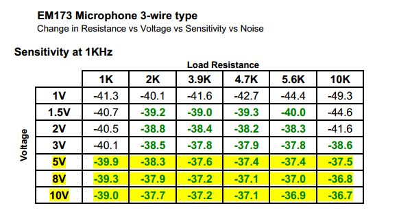

Remembering that I am a mic newbie, it looks to me that the mic capsule can accept a very wide range of Vcc from 1V to 10V. Is that correct?
The low load values of 1k and a bit over suit low SPL
the high load values of 5k6 & 10k suit high SPL
is that correct?
High SPL will require higher Vcc
Very low SPL could usefully use the lower Vcc & Lower load values since noise and s/n ratio are better.
Is that correct?
So that's how you find stuff out. Ask somebody. Whatta concept.

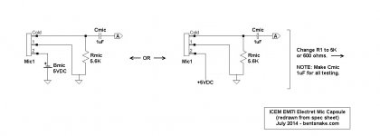

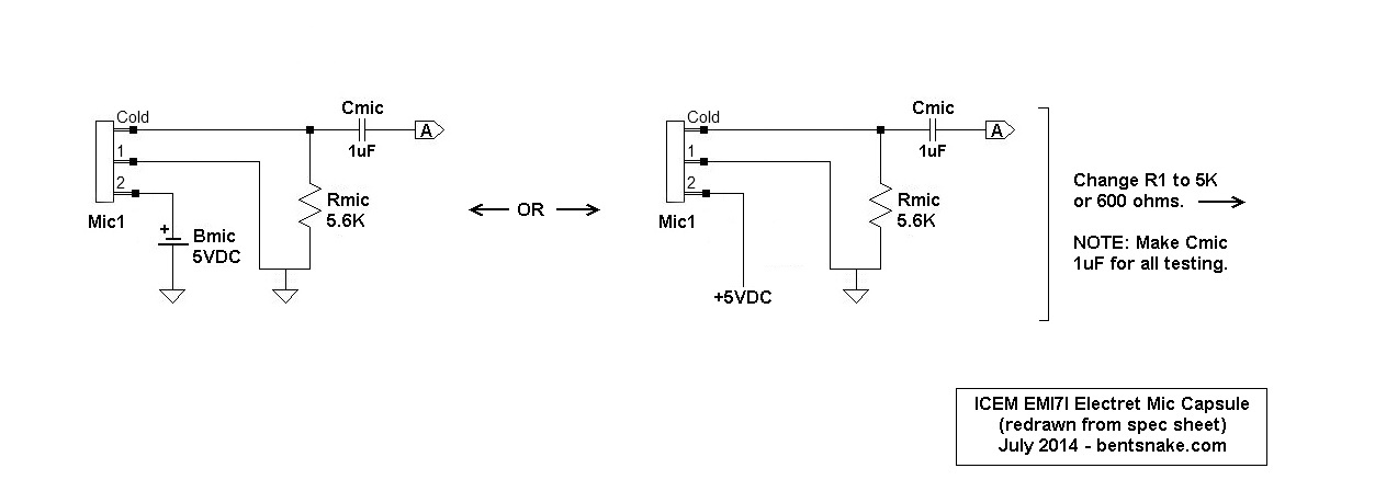

Speaking of power applied to the capsule-resistor-capacitor combination, the new graphs answer all questions. From 5 to 10 volts, inclusive, does the job. Comparing the graphs to the charts confirms this, there's no difference I'd call significant. I've posted one chart with highlighted values just as a for-instance.
The impedance situation is still not as brilliantly clear as I personally would like. But in my mind the critical fact is that nobody says anything about impedance matching, which puts the whole shebang squarely into the "output impedance times ten" category.
By the way, we're somewhat into the nitty gritty here, so I'm going to mention that the "times 10" rule is actually "from 7 to 10 times." This complements the fact that electronic values are never exact to begin with. This means you don't design on the edge unless you're NASA, everybody else designs in the middle of a range.
Getting back, I look at the new charts in combination with Panasonic's notes regarding ECM (Electret Condenser Microphone) capsules, which I've also posted. I take into account the fact that these capsules are usually designed for use in a vast array of devices, very seldom do you run into a single-purpose ECM capsule.
The upshot is my conviction that, in a word, it don't matter. This capsule can be used like any other.
For 20-20k Hz audio purposes, the resistor in the capsule-resistor-capacitor combination can be chosen from the chart, or at random. The most common value I know of for this resistor is 2.2k, practically the whole world uses it. This would call for R1 in the schematic I've posted to be 20k.
However, the capsule's data sheet calls for a 5.6k resistor, making R1 50k, so...why not? Sure.

50k is getting up into the Johnson noise region,
yes, if that is the source impedance seen by the stage.
Your mic is NOT that.
The 50k is parallel to the 5k6. That reduces the source impedance seen by the amplifier to 5k
In the passband the capacitor passes signal. In the passband the mic internal amplifier has an output impedance of 600ohms.
That 600ohms is parallel to the 5k calculated earlier.
The effective source impedance in the passband is 5k//600ohms = ~540ohms
The input noise that the external amplifier adds on to it's own noise is that created by 540r, in the passband. The LF noise (because the capacitor blocks the LF signal) will be based on the 5k. Will this matter?
Then choose the capacitor to get the best compromise between LF noise and width of LF passband.
