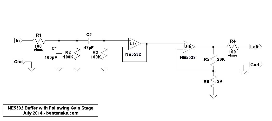

Another way to go is with a buffer. NE5532s are very commonly used this way.
Buffers have unity gain, and extremely high input impedance. For practical purposes a buffer loads the preceding circuit not at all.
I just happen to have a schematic handy. Circuit notes:
R1 and R4 are overcurrent protection for the NE5532, they may be omitted.
C1 is to shunt radio frequencies to ground, it may be omitted.
R2 provides a path to ground for the input signal, to ensure there will be a voltage at the input side of C2. It's there because you usually don't know what the input signal is going to be, and might not be necessary. When R2 is used, then input impedance is the parallel value of R2 and R3 (in this case 50K).
R2 (if used) and R3 may be changed for whatever input impedance is desired. Remember that high values (megs) can multiply noise problems severely.
C2 and R3 are the actual input circuit. Adjust their values for whatever low frequency rolloff might be desired. If R2 is not used, then R3 sets the input impedance.
The amplifying circuit (U1b) is just there to use the other side of the NE5532. It could be another buffer for the other side of a stereo circuit, or whatever you desire (but putting two buffers in series would be pointless).
In a sidebar, I don't know that a piezo source really needs to feed a 10meg input impedance. On the other hand, I can't prove it doesn't. But 0.5meg to 1meg are values more commonly used, as far as I know. Up at 10meg noise problems can be horrendous, every passing breeze can throw things out of whack. Shield everything!
Credit where it's due, the input side of U1a is a rip from Douglas Self. Hope this might be of some interest.

Thanks for the replies! I have considered a buffer as an option, and I appreciate your explanations, this makes more of this clear to me. I would like the bass roll of to be @30hz, so what mod to R3 would accomplish that?

There is no positive or negative output on the NE5532. You're thinking of the inputs, which are correctly called non-inverting (+) and inverting (-). The output is just the output.

Ten megs (10,000,000 ohms) is astronomically high in audio terms, and noise problems can be severe. Resistances in the thousands of ohms (K) are much more common, and 1meg is pretty much the limit. So you balance theory against reality and come up with a 1/2 or 1meg input impedance.

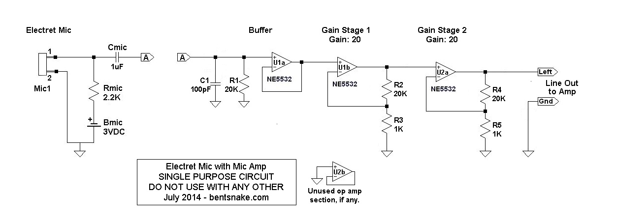

I really should have modified the schematic I posted to your needs--although come to think of it I don't know your needs, except I'm guessing you want to mic your chello. In any case, with the schematic otherwise as posted, changing C2 to 0.1uF would fulfill your needs.

Expect an output from an electret of about 2 millivolts (0.002v). This require a gain of 400 to get up close to line level, which is nominally 1 volt. Amplifiers expect a line level input, preamplifiers don't.

Moving right along, as advertised, here ya go. You're not supposed to start soldering this together this afternoon (although you could, and it would work). This is intended to give you a frame of reference.
Circuit notes:
The two points A are the same point. They're separated only to acknowledge that the mic circuit and amp circuit might be physically separated.
Battery Bmic is chosen to suit the capsule used. Resistor Rmic is expected to be universal, or if not then to suit.
Capacitor Cmic is actually part of the input circuit to U1a. It blocks battery voltage to the amp circuit, and also forms a high pass filter in association with R1. This association between Cmic and R1 is what makes this a "single purpose circuit." Move Cmic over onto the amp board and the whole assembly can be used for anything.
C1 is to shunt radio frequencies to ground. Stage environments can be expected to have a very high level of radio frequencies. As is common practice when dealing with radio frequences, keep the leads as short as possible (this actually applies everywhere).
Op amp U1a is a buffer.
R2 and R3 set the gain for op amp U1b. R4 and R5 set the gain for op amp U2a.
Input impedance as shown is 20K, which is right for both an electrec mic, and for general purpose use. For 50K input impedance make R1 50K, and Cmic 0.22uF. For 500K, make R1 500K, and Cmic 0.1uF. For 1meg, make R1 1meg, and Cmic 0.068uF. The capacitor values are not critical.
Capacitors are film type. This means Mylar film capacitors costing pennies, not the dollars-each stuff that some say you need. Or as you judge best, of course. The most common value available is 100 volt, and these are fine.
Same with resistors, which are 1/4 watt. Metal film does have advantages, and they don't cost all that much more, but they're probably not on the shelf so carbon resistors will do just dandy. By the way, carbon resistors today are far superior to what they once were...I read someplace.
In case of an unused section of op amp, terminate the unused section as shown. With the input grounded the op amp has a unity-gain output of ground, so it does nothing. Connect power to an unused section of op amp as to any other, do not leave it floating.
Thanks so much for all of this info, you are a mensch! Most of the inexpensive electret instrument mics are not made with quality pres, in my experience, and the piezos are awful. They really don't have to be as far as I can tell. Mounting is also an issue, but most people who do this really don't understand what the instrument should sound like. It is a different mindset, but that is kind of off topic.
I have an old Benchmark 4x4 mic pre that uses the NE5432 (the manual that came with it is really an amazing document, lots of research papers, schematics, etc.), and to this day, there aren't a lot cleaner pres out there, hence my interest in this piece for this project. Tried and true, cheap and available. I am considering the OPA627 for the piezo, as it is supposed to deal well with high impedance, but that is a little bit down the pike.
The film sensors handle high physical pressure really well, so placing them under the bridge is a natural, and because of that location, little body resonance is an issue so I don't think that feedback would be a problem at all. I have played in very loud events using DPAs, and was shocked that it worked. Of course, the venue was very large (Radio City) and the tech team world class (MTV music video awards- some years ago ago), so that counts for a lot, but players and situations, this would not hold out. Most of my work is not so important for feedback rejection. I've been using DPA and Sennheiser mics from wireless sets converted for phantom power, and they sound quite good, but there are lots of situations where that is not possible. Mics obviously sound more natural, but there is a need for something better for loud music in small venues.
Looking over this schematic, it appears that this could be made stereo with just one more NE5532 as a second buffer, if I am not mistaken.

<< it appears that this could be made stereo with just one more NE5532 as a second buffer >>
Yes, and this is expected. And by the way, for a power supply you might a look at posts #30 and 31 of this thread, he said with a simper of false modesty:

<< I am considering the OPA627 for the piezo, as it is supposed to deal well with high impedance... >>
Not to argue but to discuss, the input impedance of the buffer shown is off-scale. Anything hoped to be higher is more in the realm of theory than fact. This is not unique to the NE5532, it's the nature of op amp buffer (unity gain) circuits.
As you know, for over two decades the NE5532 was the top of the line. The result of significance is that any recorded music anywhere in the world had been massaged by dozens of NE5532s. As a matter of fact this continues partly so today, since most studios don't junk their equipment every time a salesman promises new and improved.
