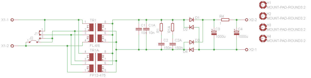

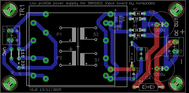

Power supply PCB for the input board
Here is a power supply PCB I put together for the 7V supply. It is intended to fit in a low profile 1U case, so the transformer choices are limited. It will accept Block FL4/6, FL6/6 and FL8/6, as well as Triad FP12-475 transformers. 115/230 V input voltage is configurable by installing wire jumpers.
It will accomodate optional transformer snubbers using SMD or through hole parts.
I will order a batch of 10 pieces from one of the Chinese manufacturers, and can sell the extras on a first come, first serve basis. When they are gone, they are gone. Feel free to order your own PCBs from the included gerbers. The board size is 50mm x 100mm. It is not tested yet, so may contain errors.

People had been waiting for the input boards for several months, so I did not want to delay the GB for another month or so. That is the minimum time to do a PCB for a proper group buy.
This PCB uses low profile transformers, which are relatively expensive, so it may not be to everyones liking.
Anyway, I should have a few extra PCBs sometime in January. Don't know the costs yet, but if you need more than one, you will probably be better off ordering a batch directly.
