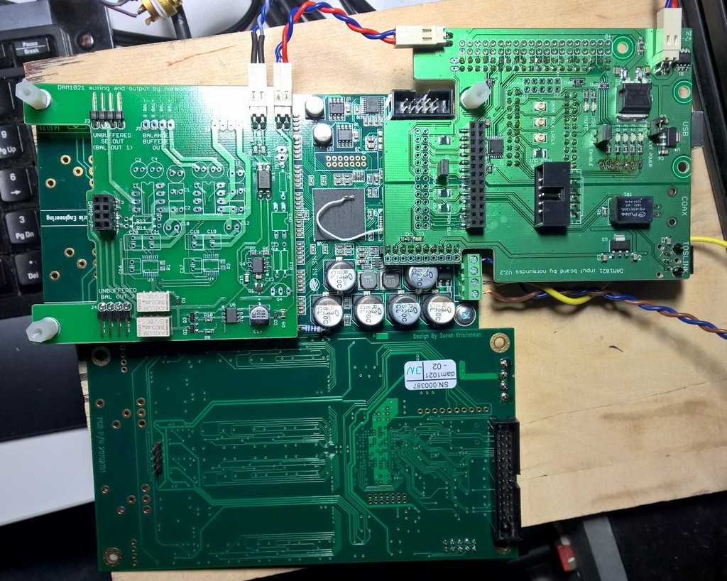

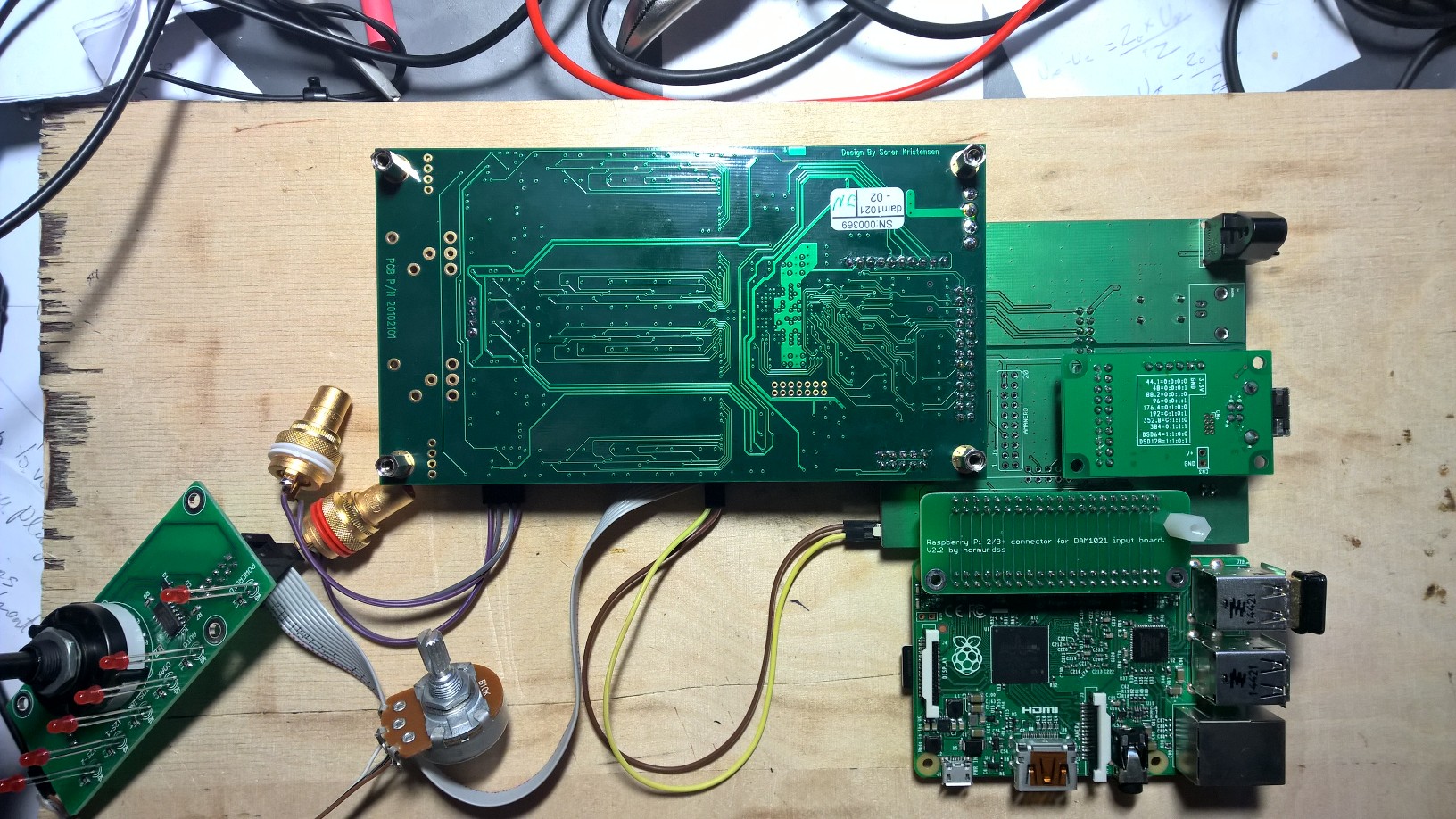

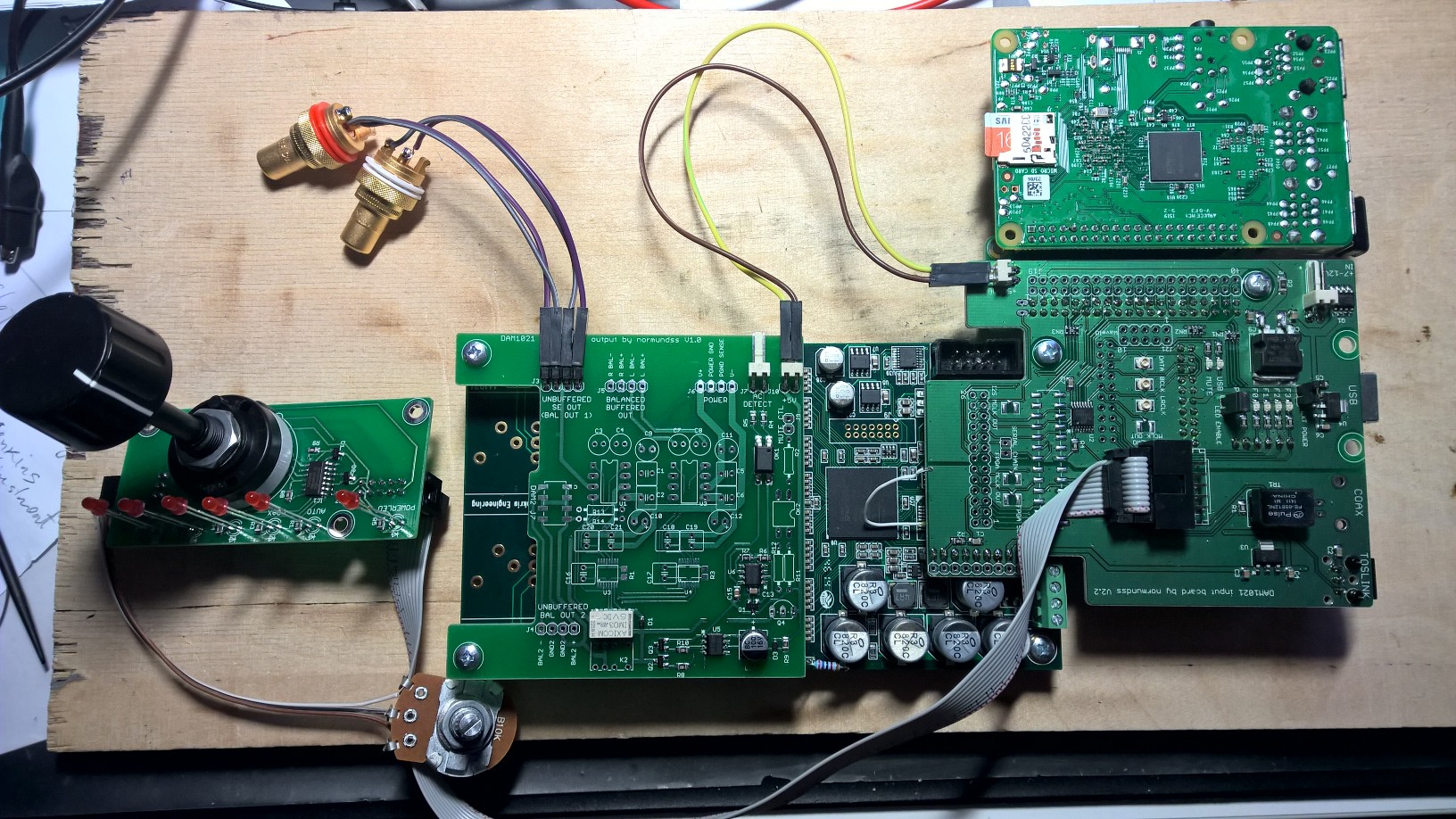

Meanwhile, the test PCBs are ready, I will be assembling and testing them this week.

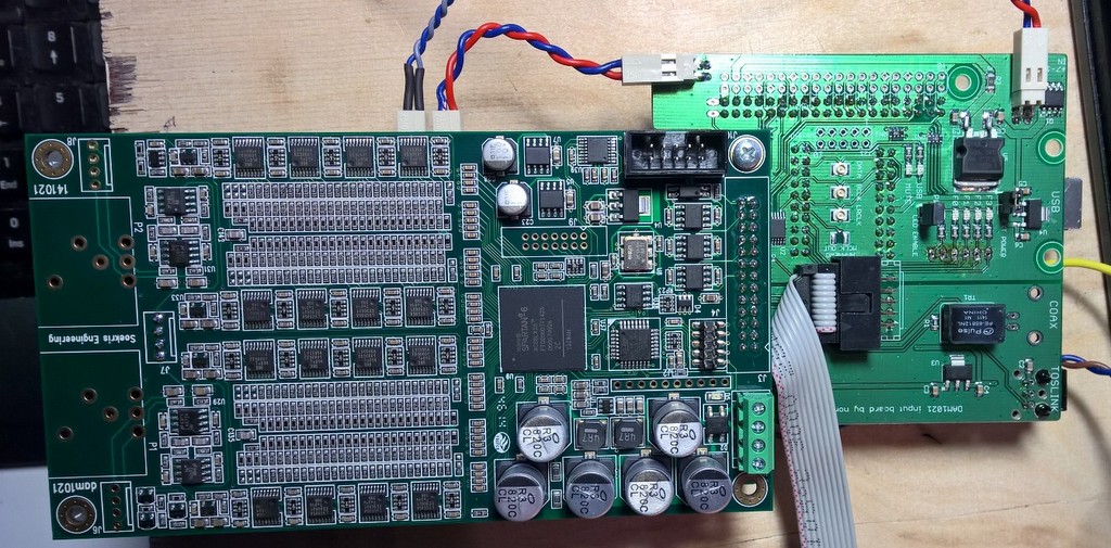

This is how it all looks together, top and bottom. The white wire sticking out from the dac is connected to U37 pin 18, the DAM mute control signal. It is not needed to use the muting board, but later I will test the option to use it.
The optional output buffers are not assembled at the moment.
How about second DAC connection ?
Best
I will test it after I have verified that single dac works. The second dac will stack on top.

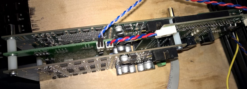

And a balanced dual dac assembly. I will provide better pics and description later, this is just so that people can get a feeling how it all goes together. It also gives an idea how the input board looks without a Raspberry attached.
Note that the J3 and J7 connectors are soldered on the bottom of the second DAM.
The muting board has a second relay, a top connector and an additional output header installed.
The input board has a top 2x13 connector for the second DAM, and a jumper for chaining the serial ports. The R1 resistor should also be removed if coax input is used, but I have not done it in here.

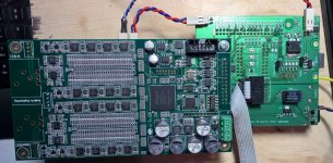

I have tested the dual mono balanced setup and it works fine.
However, the test boards need a couple of small corrections for status indication lines. I will also adjust the layout of onboard voltage regulators to improve thermal management and allow attaching an optional heatsink. The heatsink is not needed for typical use, but may be required if the onboard regulators are used to power Raspberry Pi peripherals with high power consumtion, such as a large(-ish) display.
I will also make some tweaks to muting board layout to improve physical fit of some output buffer parts, and add pads for installing alternative capacitors for DAM output filter.
It will take another week to produce another test batch of modified boards, but overall the design works and we are getting closer to production run.
