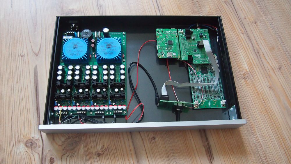

Here is my build with huge psu 😀
Is there anywhere a drawing with raspberry to make my back panel of the enclosure ?
I find some drawings, but not all need measurements.
Not at the moment.
Another forum member (who actually knows something about mechanical engineering) is working on it.

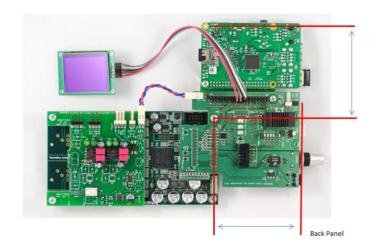

Do you have the two measurements in attached picture ?
In this case i can build my casing bottom .
The distance from the DAM mounting hole to input board edge is 75.53 mm.
The distance from the DAM mounting hole to the LOWER mounting holes on RPi (that attach to the RPi connector PCB) is 29.21 mm. You should be able to find the to find the RPi dimensions on the Internet.

Do you mean 75.53 mm to the edge of the PCB or the edge from the toslink and bnc connectors?
I forgot one distance marked with ??? This distance is from mounting hole to the middle of Raspberry 40pin connector to get the distance to the mounting hole (left top) of the Raspberry.
http://www.raspberrypi-spy.co.uk/wp-content/uploads/2014/07/raspberry_pi_model_b_plus_dimentions.png
I hope you can call it.
That is to the edge of PCB. The Coax connector is protruding a bit beyond that, but the exact amount may vary somewhat depending on the connector model. If using standard M3 standoffs and mounting screws for the USB interface, they can also be protruding a bit. That was the main reason I moved the Coax connector outwards, so that the back panel fits against it.Do you mean 75.53 mm to the edge of the PCB or the edge from the toslink and bnc connectors?
That is 21.03 mm.

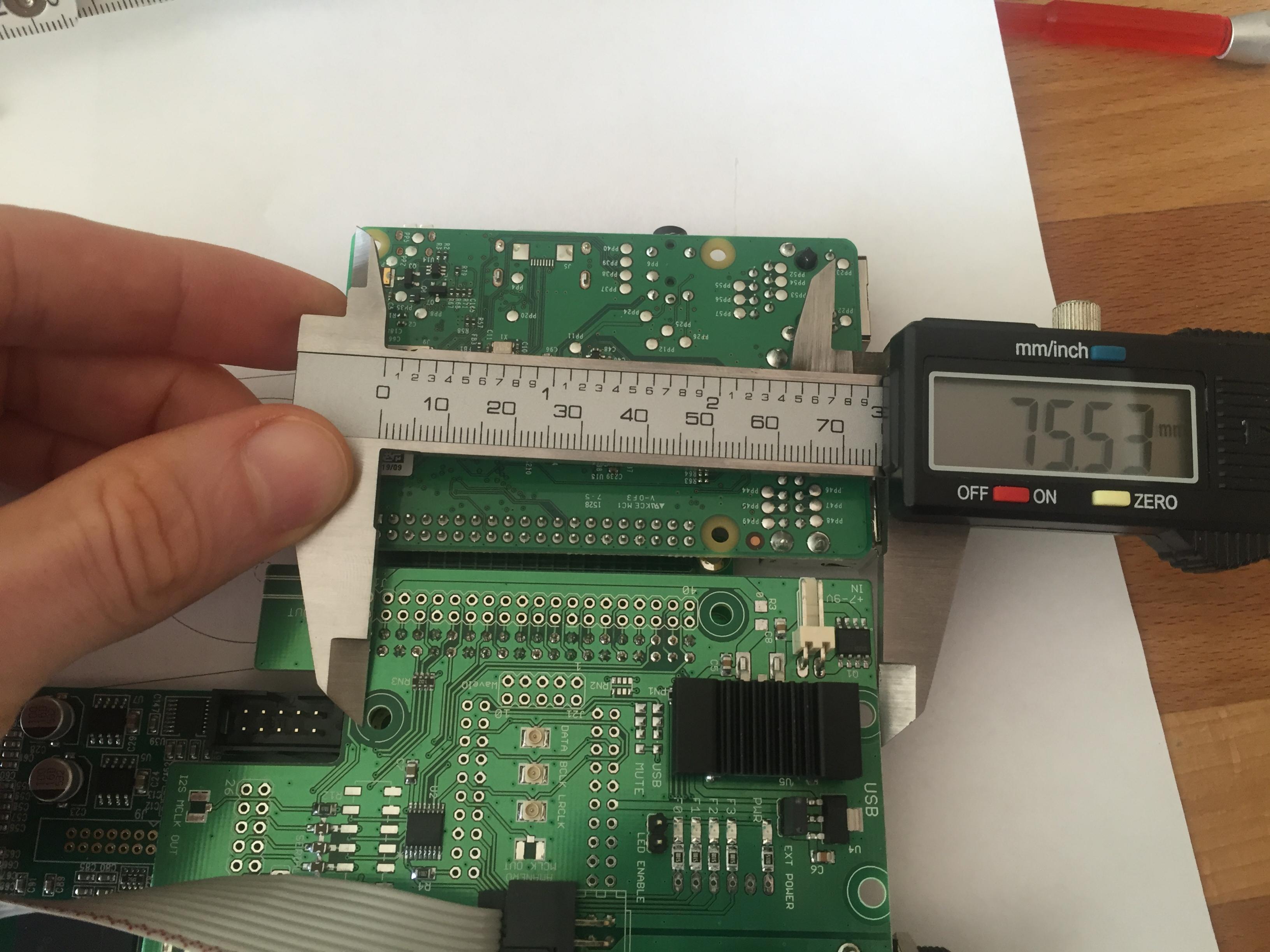

this distance is not correct (see attachement) . Please send me the correct distance.
this distance is not correct (see attachement) . Please scend me the correct distance.
You should measurements center-to-center or outer side to inner side of the holes not outer side to outer side, which it looks like you have done.
