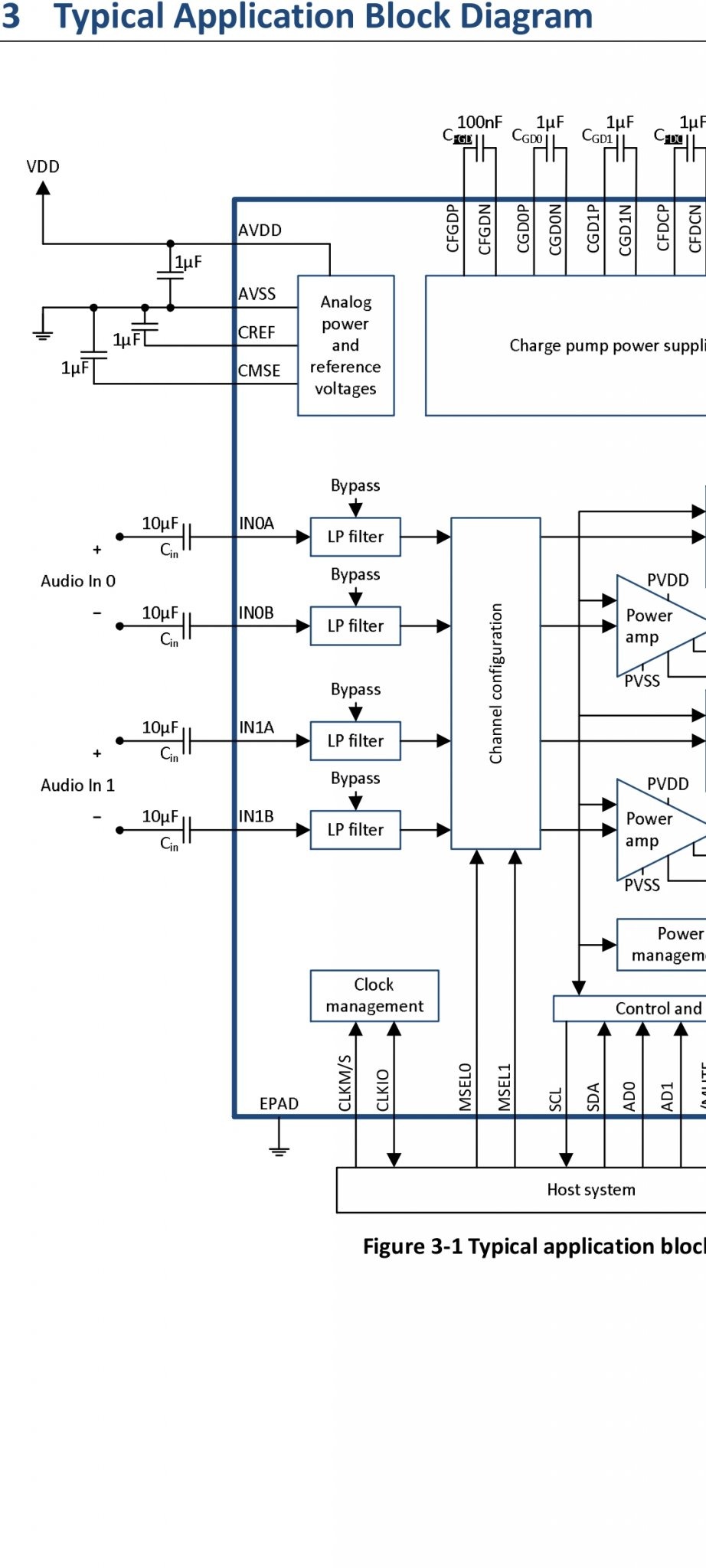

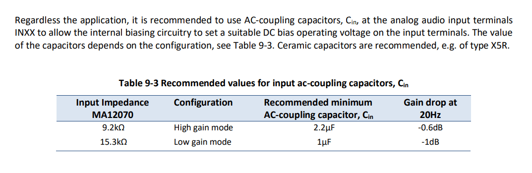

I wonder why they show 10uf coupling caps on the block diagram?
ma12070 manual page 24
It can be assumed, that 10uF caps are just for good measure, leading to a lower gain drop
Reasonable assumption is also that X5R caps are used which can be half the value when DC is around (as usual).
