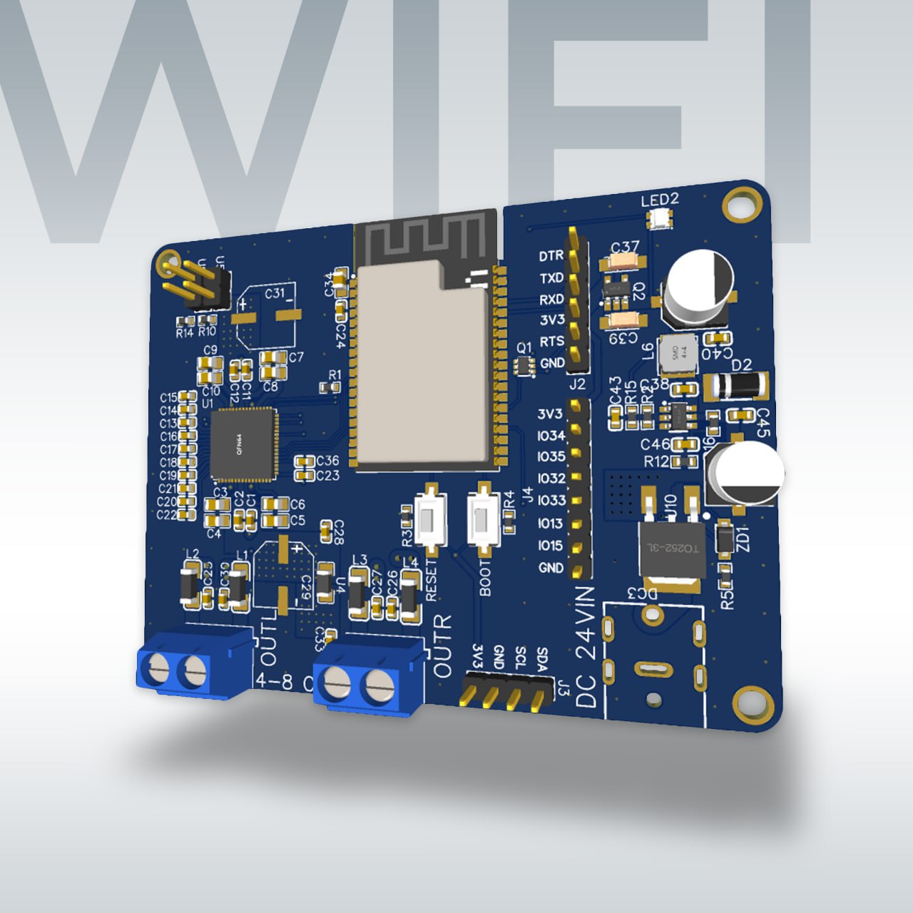

@altus fidelitas - your amp looks brilliant, thanks for the pics!Finally completed my MA12070P (i2s version) amp. My first SMD design and build. Thanks to similar projects by matt_garman and Fabianmu in convincing me that QFN packages can indeed be soldered at home with a bit of practice.
I'm running it at 24v and works fine. All my SMD MLCC caps are rated 50v to take into account any degradation of capacitance due to voltage biasing.
The amp is quiet. I implemented the output filter with a 1.5uH inductor as recommended by Infineon. I took a chance with the lowest recommended inductance since I could get a decent 30A saturation current rating without a monster sized inductor. At least I know that the output currents are far from saturation and the filter is operating in the linear area of the inductor.
The board also has space for input film caps when I build the analog version later
So far liking the sound. Either its my imagination, but there is a 3D like sound, perhaps better imaging? I'll do some A/B testing at a later date. The efficiency of the amp is as advertised and the chip gets just warm while the inductors remain cold even when pushed hard. I won't bother with a heatsink for this one.
The only issue I face is in the software side. Some bugs with the volume control via I2C. Like theAnonymous, I'm not a software person and will probably take longer than most to iron it out.

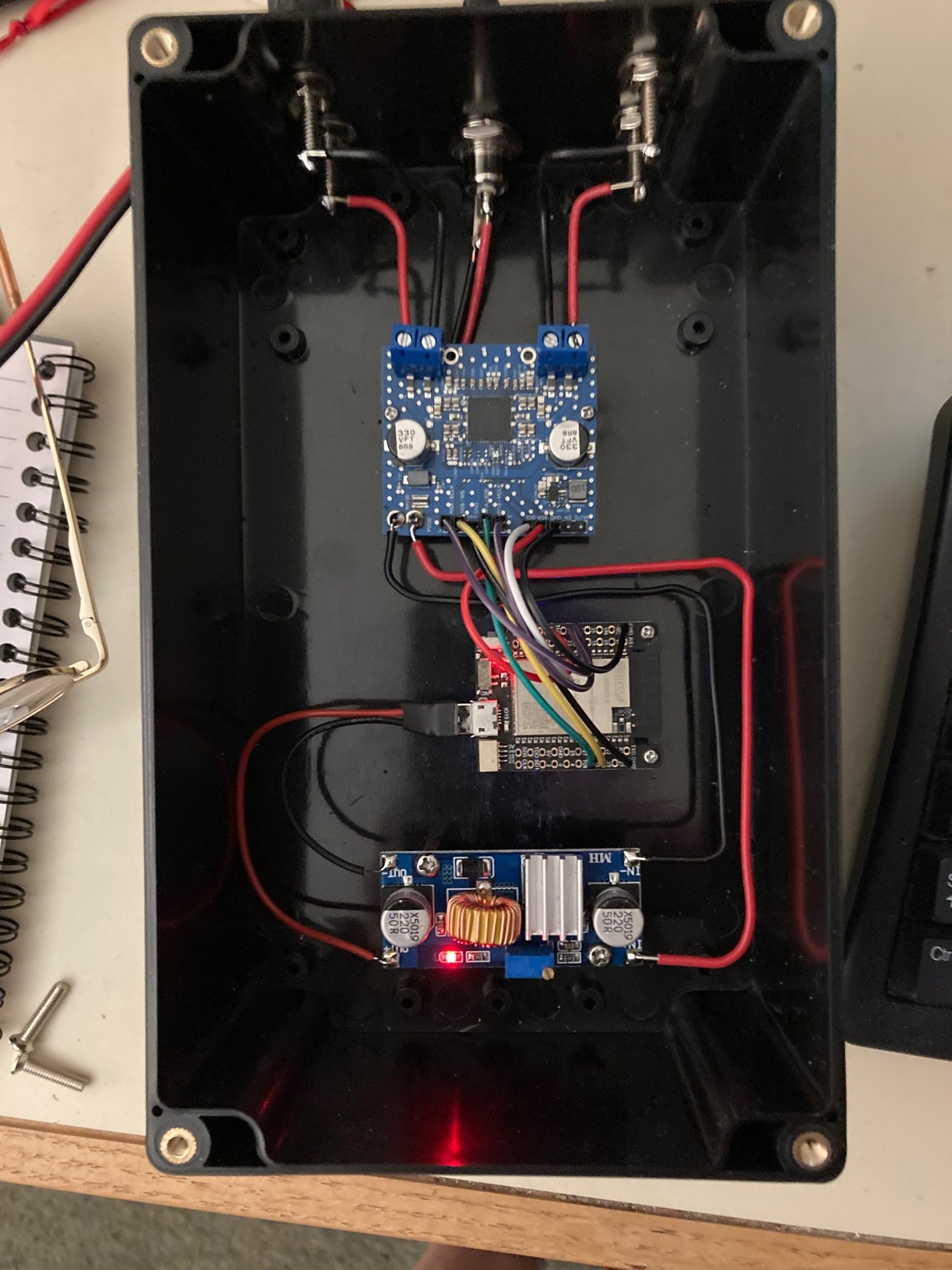

I'm now wondering if the 5V AVDD/VDD from the TPS62175 buck converter on this board is the cause of the noisy output. It looks like the voltage divider used for feedback has three times the recommended resistance in the TI datasheet, which remarks that higher currents are better for noise immunity. Or maybe there is some bad modulation with the regulators used on the SBC.
Did you get ESP32 squeezelite working with this chip in the end, by the way? That was my original idea for driving this board!
Yes I did, but not using that board. When they released the 32 bit version of Squeezelite-ESP32, I installed it and it worked! Later, I realized that it only worked because the 32 bit version created a BCLK that the MA12070P accepted. Using the 16 bit version, a 44.1K sample rate gave me an invalid BCLK.Did you get ESP32 squeezelite working with this chip in the end, by the way? That was my original idea for driving this board!
By forcing a sample rate of 88.2K or 96K the generated BCLK became acceptable.
They also added MCLK as an output, and that worked, but I got more noise using it so I went back to shorting BCLK and MCLK together and feeding BCLK only.
I haven't fired that amp up in a while, but I would be happy to do so and send you the NVS parameters that worked for me.
Mike
A look inside. Currently feeding the amp and buck converter from a 12 volt battery. The 5 volt output from the buck converter powers the ESP32.
