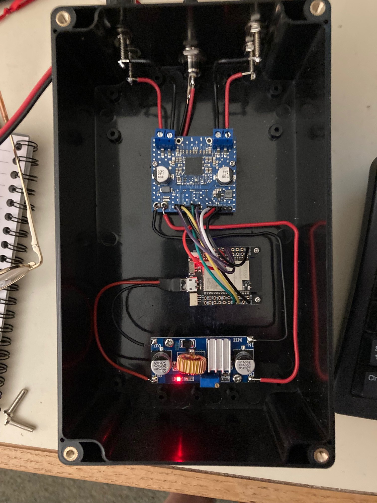

A look inside. Currently feeding the amp and buck converter from a 12 volt battery. The 5 volt output from the buck converter powers the ESP32.
Nice - simple and neat! May I ask where you got your MA12070P board from and if the output is reasonably noise/hiss free at low volumes?
The Lusya/Shenzen Pillor board cost £30, the most I've spent on a bare board chip amp. There are cheaper MA12070P boards available now but it's a bit disappointing if this board or chip can't do better than the old Tripath TA2020 board I've got connected to a crummy PCM2704 USB stick in an Altoids tin as my current desktop amp!

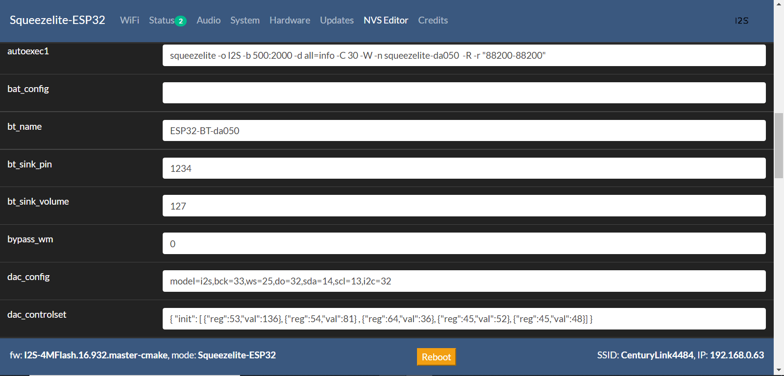

The NVS parameters I use...
autoexec1 squeezelite -o I2S -b 500:2000 -d all=info -C 30 -W -n squeezelite-XXXXX -R -r "88200-88200"
dac_config model=i2s,bck=33,ws=25,do=32,sda=14,scl=13,i2c=32
dac_controlset { "init": [ {"reg":53,"val":136}, {"reg":54,"val":81} , {"reg":64,"val":36}, {"reg":45,"val":52}, {"reg":45,"val":48}] }
For the most part I copied the init code from the Merus lixux driver for the MA12070P. The main change was to allow for a 32 bit word length (16 bits left and 16 bits right). I set the sample rate to a fixed 88.2K, but 96K will work as well. Again, I'm not using MCLK, but sending BCLK (SCLK) to both clock pins on the MA12070P.
If all goes well, you should get this via telnet...
I (3052) I2S: APLL: Req RATE: 88200, real rate: 88199.977, BITS: 16, CLKM: 1, BCK_M: 8, MCLK: 22579194.000, SCLK: 2822399.250000, diva: 1, divb: 0
[00:00:01.349361] output_init_i2s:319 i2s DAC using I2S bck:33, ws:25, do:32, mute:-1:0 (res:0)
[00:00:01.349730] output_init_i2s:339 Initializing I2S mode normal with rate: 88200, bits per sample: 16, buffer frames: 512, number of buffers: 12
The SCLK value generated is a valid value for an 88.2K sample size, and can be used on the CLK pin of the MA12070P.

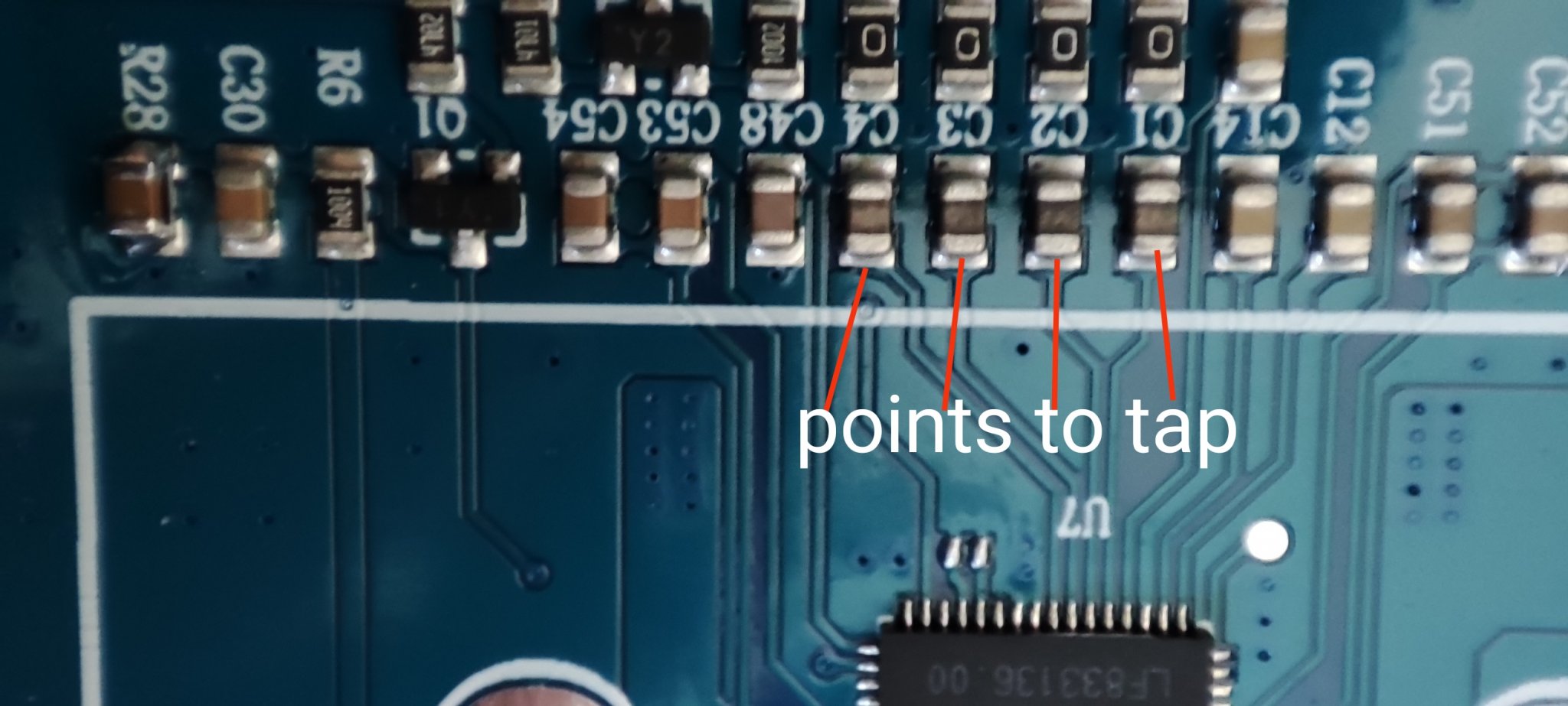

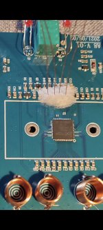

Little progress here except for the drilling of the chassis and casing. Klaus, do you have some pictures of your A08 after the mods? Volume control with the DAC (dangerous)?

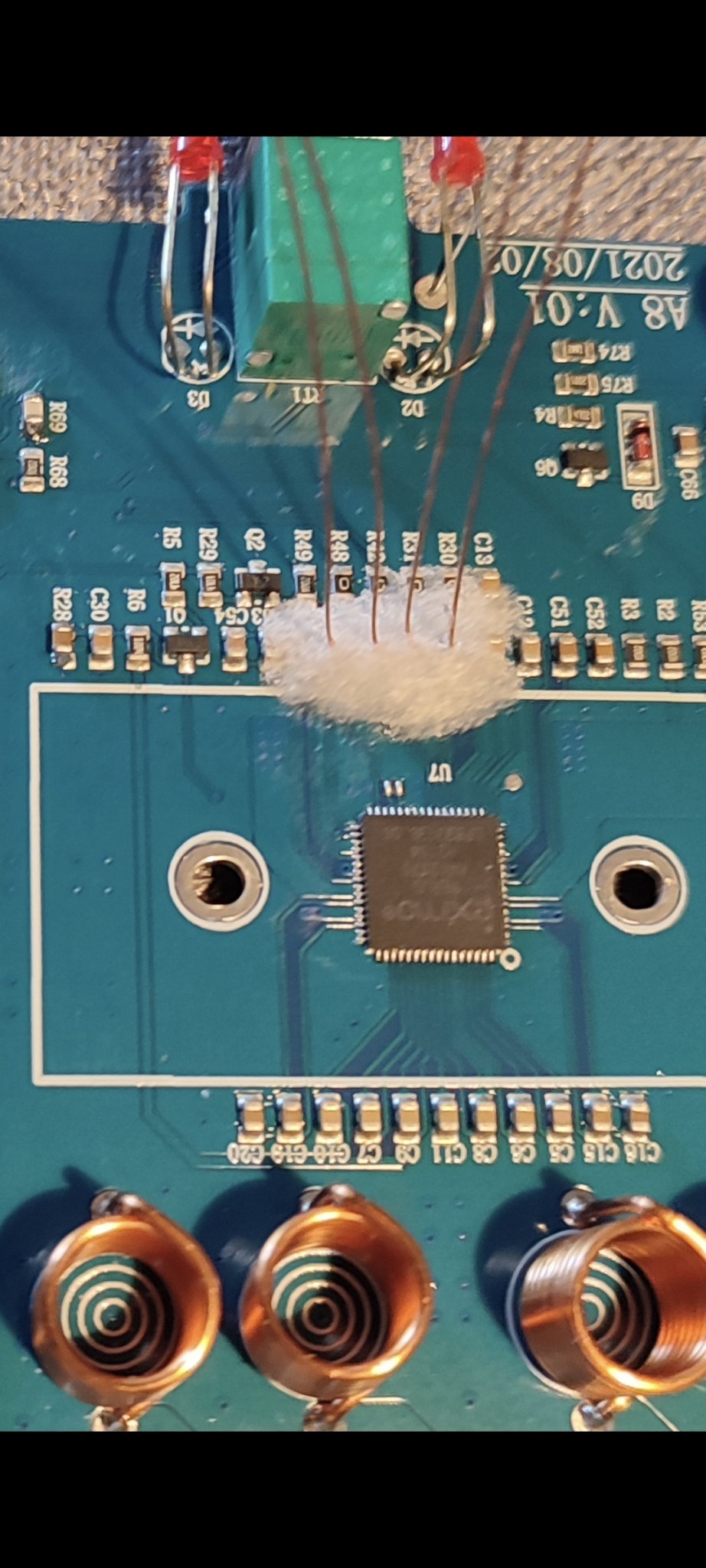

The lack of caps after the coils is what worries me a little. EMI probably.

After I tapped the caps, I put on instand acrylate glue with baking Soda for tension relieve. I left the active stage untouched because I did not know if the signal detection is managed by separate Pins.

Sound impression was based on only one song after which we had no time to further evaluate. The unit never played a single song in stock form. Power supply was the one that came with the unit. There is certainly potential for further mods.
