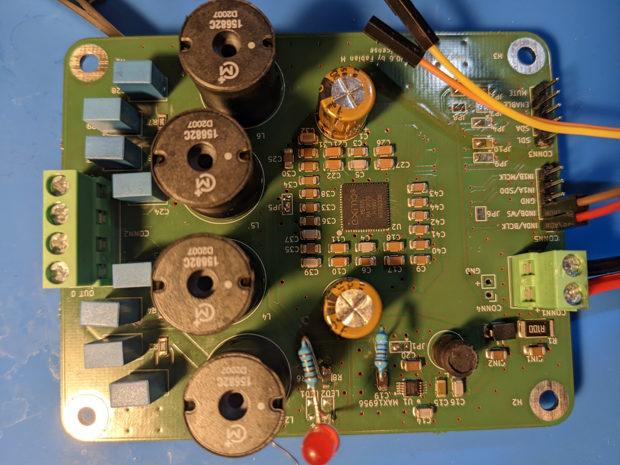

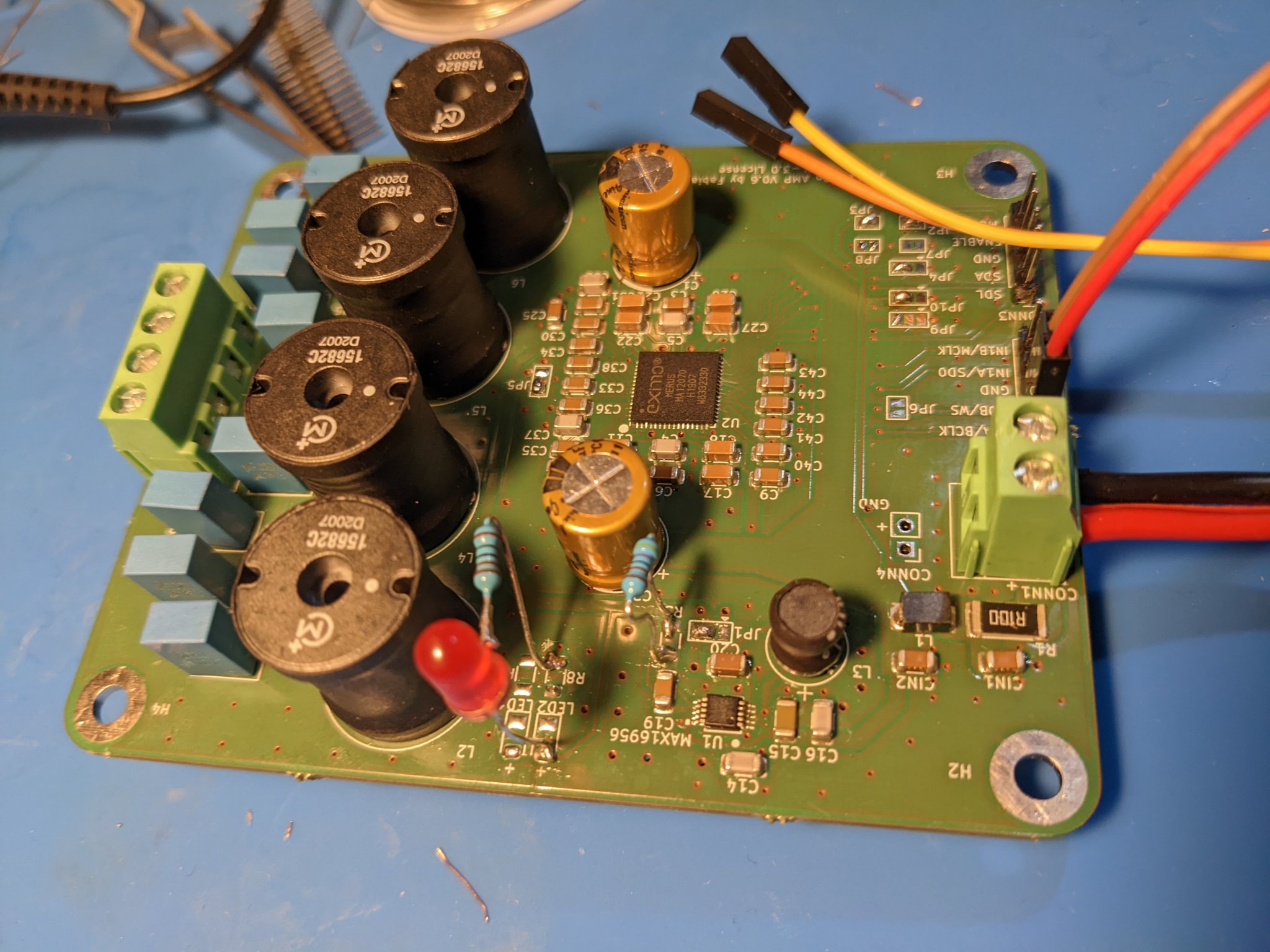

HI,
just a short update on my project:
I finally got my PCBs delivered and soldered the first board. I have bought the analogue and I2S versions of the chip and used the analogue version for my first test.
Having a reflow oven and a heat gun is great to get the job done, I don't think I could have it done without it.
Had to play around with the jumper for the correct setting but actually made no routing mistakes on the PCB, I'm super happy that it worked out that well 🙂
View attachment 1019408View attachment 1019409
The problem I have right now is the increasing noise when I supply the board with more than 10V... below 7 it's not really noticeable. Any suggestions for improvement?
Best Fabian

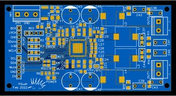

I've also just finished designing my board, and double and triple checking it for errors before sending the order in.
Your strategy for doing the analog version first makes sense, at least you don't need to deal with digital input set up issues. Noisy sound is at least sound, so confirms you are in the right direction. I was originally thinking of building the i2s version first, but now will do the analog one first.
I'm very confident with my though hole soldering skills, but have zero experience with SMD. In fact, I just bought my first tube of solder paste. 70:30 just to stick to something familiar. I've got a heat gun but no reflow oven. Really nervous with getting the MA12070 soldered right.
How did you apply solder paste, with a stencil or by hand? Also did the MA12070 self align easily when the solder melted as seen in many Youtube videos? I'm planning to use 70:30 tin/lead solder. Any advice in that?

Hi altus,
If you are new to SMD soldering, get some practice boards for learning, or order some cheap SMD 0Ohm resistors and some boards that are just chains of resistors.
The MA12070 was by far the hardest to solder I did so far. I used the T-962 reflow oven and it is a project on its own to make it useable... it's far from perfect, but when dialed in it is ok. There are good heat plates out there, and I think that it is easier to use one of those with a heat gun instead of an oven. I've heard that the SainSmart Miniware MH30 is very nice, and I might give it a try.
You definitely need a good soldering station/iron with a fine tip for fixing solder bridges between the pins of the MA12070 chip, there are some very good JBC clones if you are on a budget.
Last but not least, you need some kind of magnification for the inspection of the chip and removing bridges between pads. A stereo microscope is nice to have but cheaper camera microscopes will do the trick.
I used the CHIPQUICK SMDLTFP solder paste, it has a very low melting temperature and therefore is relatively easy to handle without the risk of damaging components. Don't forget to use flux 😉 Having a reliable multimeter with a temperature sensor helps get your profile correct when using your heatgun and/or hotplate, use some Kapton tape to fix it near your chip.
double-checking the board is crucial, and there is a big chance you miss some stuff anyway. I ordered the first batch from JLCPCB when I was sure that I had everything correct and noticed on arrival that I had grounded my VDD :|
...after rechecking I ordered a new batch of PCBs with a stencil. This makes it way easier to apply the correct amount of paste to the pads.
The most important thing I learned is to be patient and allow yourself to make mistakes 🙂
Best,
Fabian

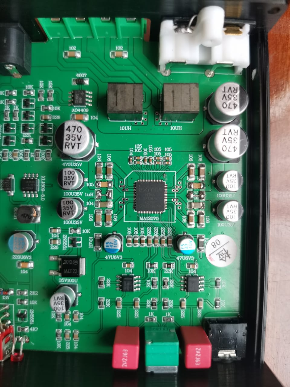

Here the internals of the $24 MA12070, taken from my friend's amp.
Looks like it has implemented a LC filter, but the 10uH inductors are more than what's recommended by Infineon. Also perhaps swap the 102 MLCC for a film cap for the LC filter.
Noise level was also a bit high, suspect the TL072 op amps are clones, but more challenging to swap as they are SMD
Reactions: notakosan
On the reference board by Infineon, the only inductor on the +ve supply line is a ferrite bead configured as an CLC filter. From what I understand its more to prevent RFI leaking out. And that ferrite bead is nowhere near 1uh.
So I don't think the 1uh coil being shorted out will affect sound quality. I doesn't make sense for it to be there in the first place. 1uh is a very large value to be squeezed into such a small SMD footprint relative to the current demanded by the IC.
They probably got it wrong and realised it after making the PCB. Would be curious if the later amps have the same configuration replicated.
And no, there was no heatsink mounted.
It more looks like that a ferrite bead was planned/used just like on the reference board but simply got named "1 µH" on the board (the fact that the other beads at the board are called "10µH" supports that). There is a shortage of ferrite at the moment and some types have absurd long delivery times. The omitted one "1µH" has a larger footprint (1210?) and another value.
I think the designer went the extra mile compared to the minimum as presented in the datasheet. The paralleled decoupling caps show that. I have seen branded amplifiers with a worse layout than this cheapo.

Fabian,
Thanks for the tips. I guess its practice, practice, practice.
I'm waiting for my PTC heater to arrive, then build a simple Arduino based temp controller for it. Plan to set the heater plate to take the board to 'pre-heat' temperature, then hit it with the heat gun. I'm planning to put just enough heat on the board so the heat gun can ramp up temp quickly and melt the solder
I suppose the right pre-heat and heat gun temperature will be critical and will be determined after lots of test runs. Just as well I've got a few pieces of pre-ROHS junk boards to practice with, so they would mimic my tin-lead paste I'm using.
And yes, need to order some Kapton tape to attach my temperature sensor to the board to get a good feedback. Still thinking about low temperature solder and stencils.
Patrick
