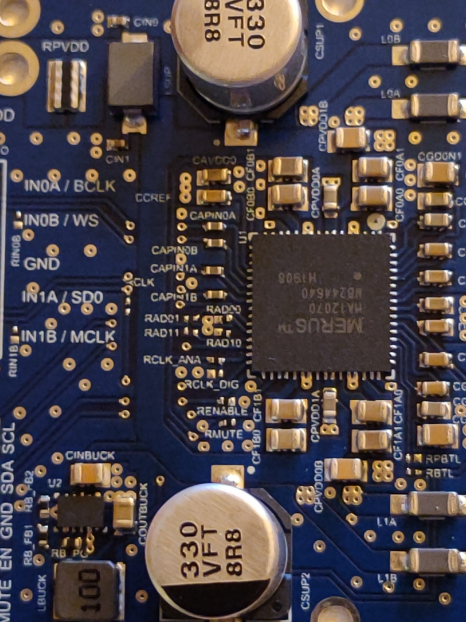

I had to change the Inductor, due to availability. They are Murata´s 15682C, I thought I had some space left on the Board, now it's getting packed. What is a post-filter feedback?
I noticed that that kicad released v 6.0, my nightly build is stable now, therefore, there isn't an issue anymore with my filetype
I attached a pdf with the board layout.

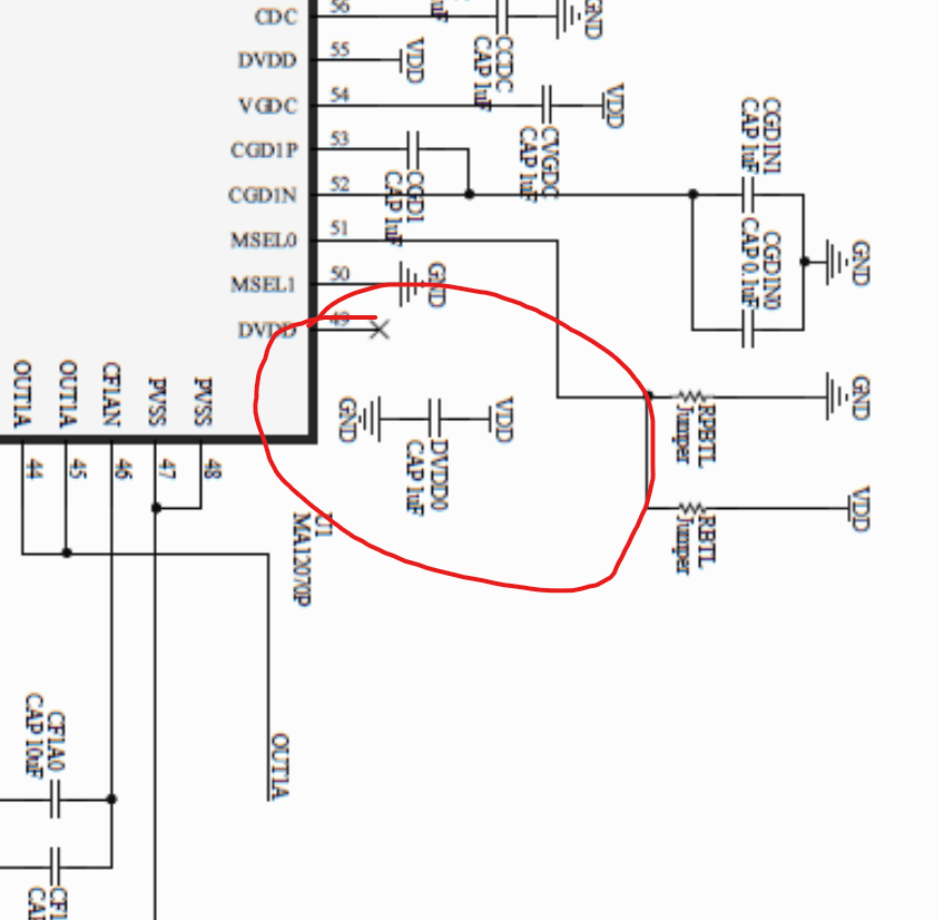

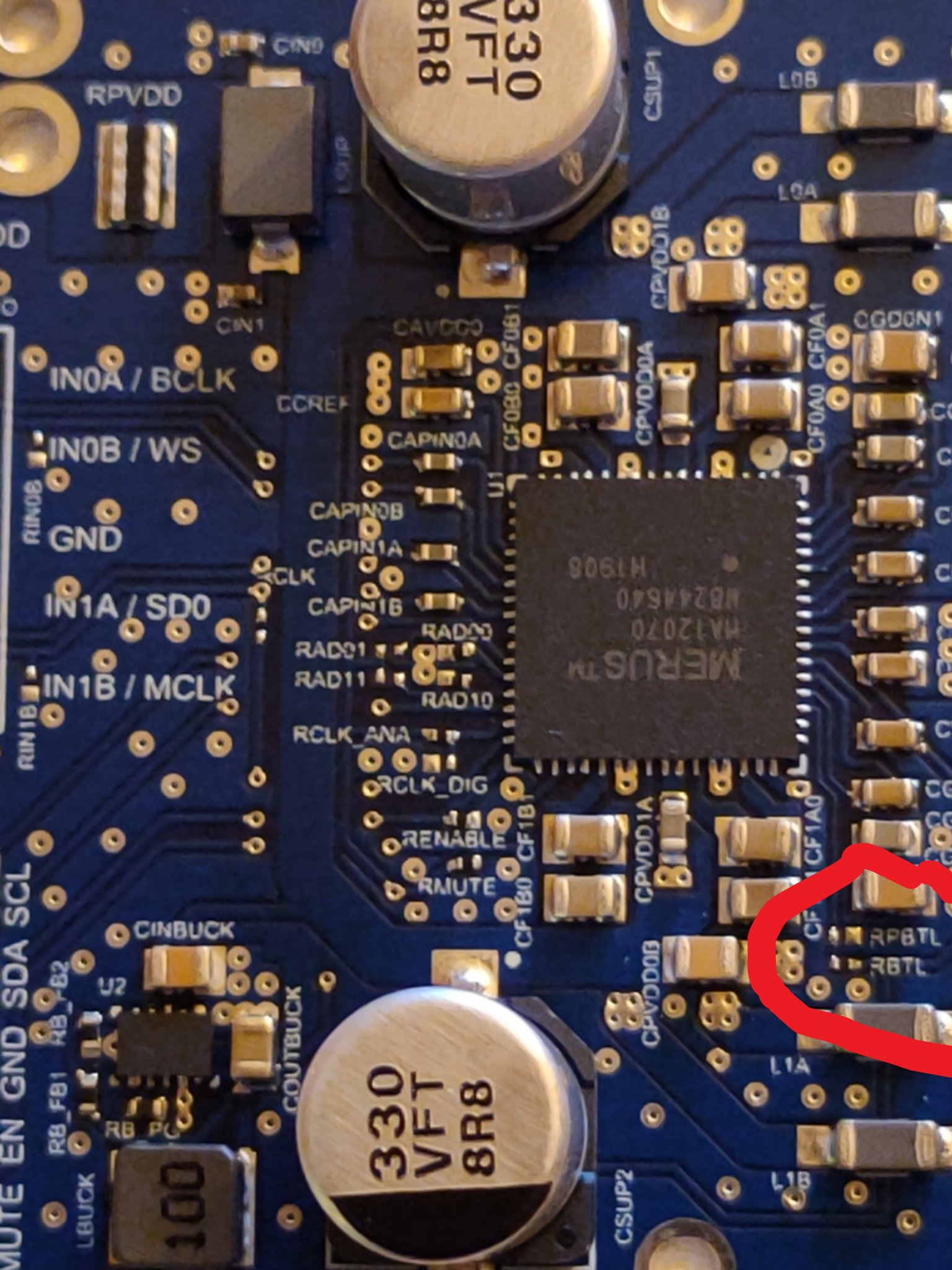

I would have a little modification to make on the bravest one, to put it in PBTL mode.
From what I understand, there is only one solder bridge to reverse ...

the following photo may help you ...?
Maybe ... it's not necerry...
looks like I placed it in the right area, thanks for taking a look. Phone cams make pretty good microscopes nowadays
There are 2 undocumented holes, on half of the PCB from top to bottomNo mounting holes is a serious mishap IMO. Not all of use like melt glue or velcro tape.
Nylon spacers ... To avoid magic smoke!

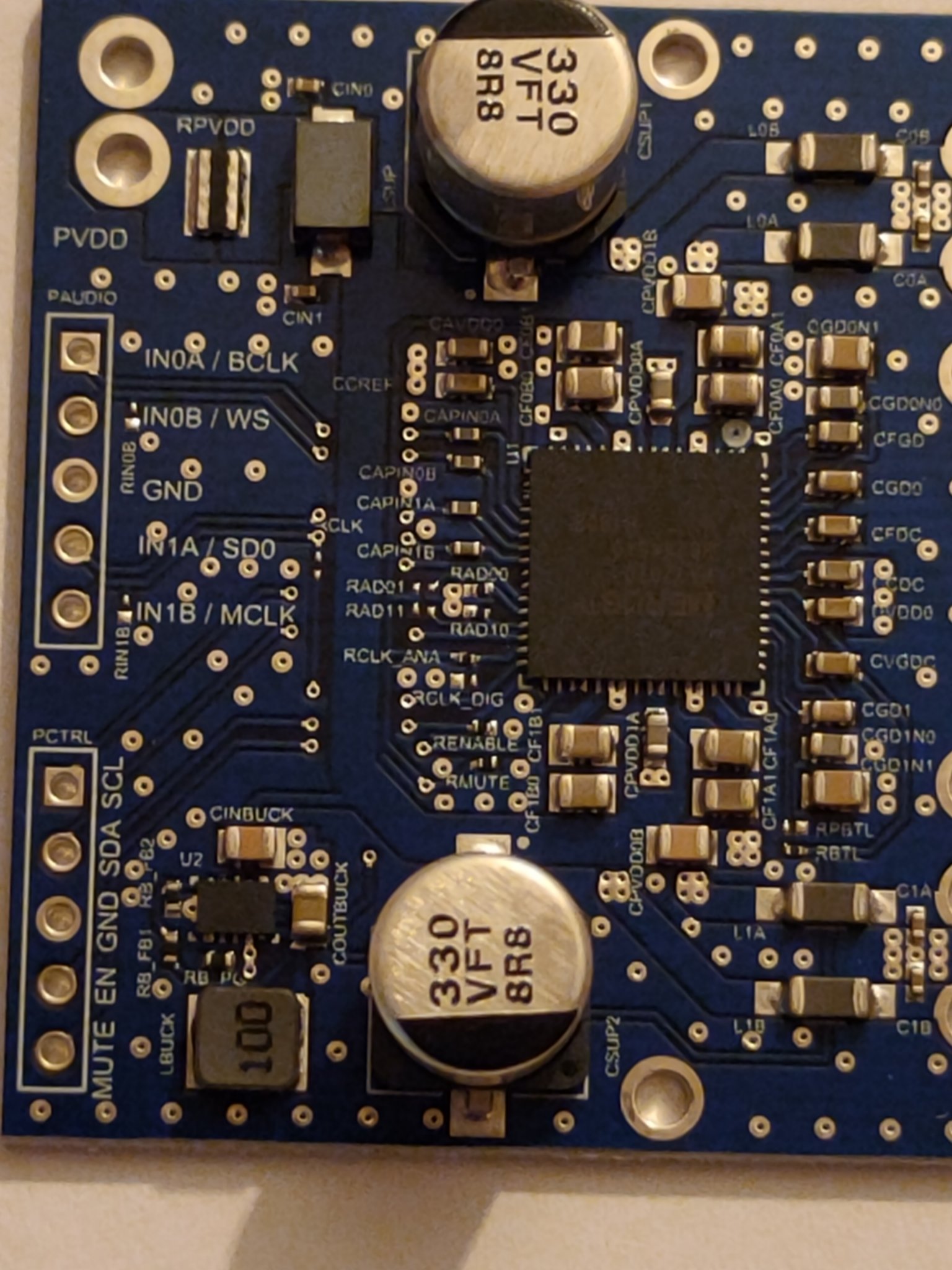

HI,

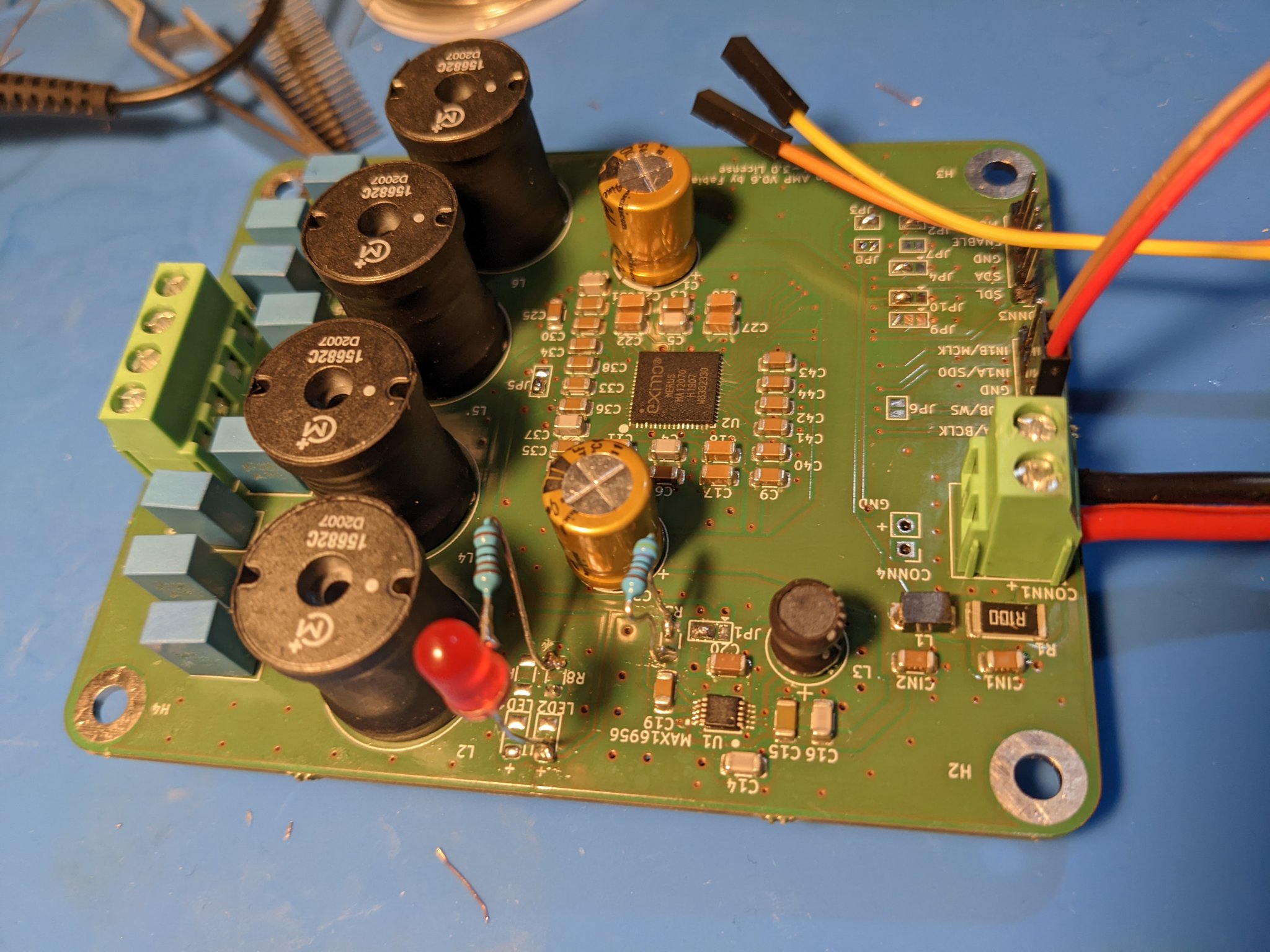

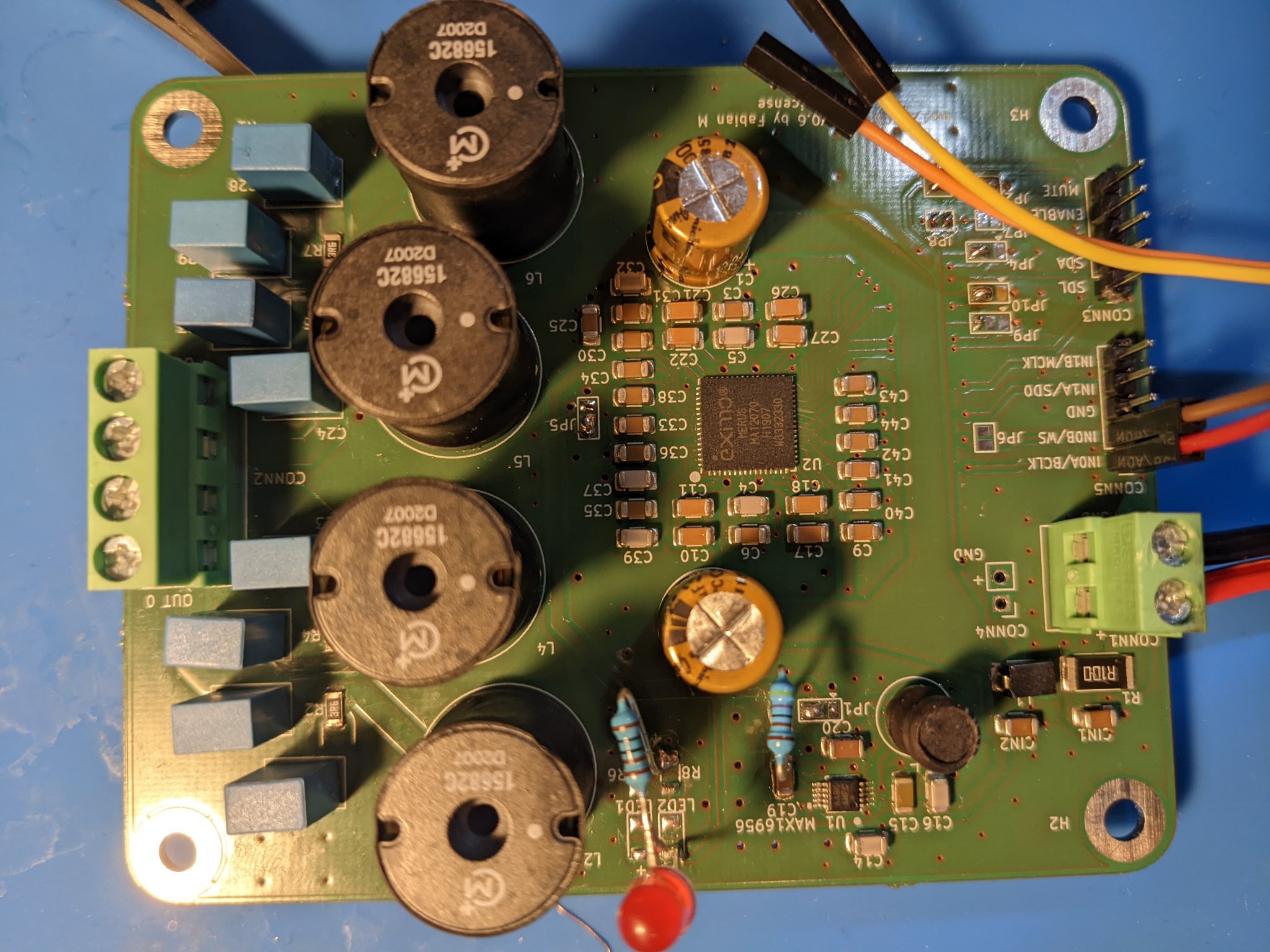

just a short update on my project:
I finally got my PCBs delivered and soldered the first board. I have bought the analogue and I2S versions of the chip and used the analogue version for my first test.
Having a reflow oven and a heat gun is great to get the job done, I don't think I could have it done without it.
Had to play around with the jumper for the correct setting but actually made no routing mistakes on the PCB, I'm super happy that it worked out that well
The problem I have right now is the increasing noise when I supply the board with more than 10V... below 7 it's not really noticeable. Any suggestions for improvement?

The problem is caused by inductors You used in output filter. I have the same issue with cheap chineese boards, I'm waiting for new inductors delivery.The problem I have right now is the increasing noise when I supply the board with more than 10V
https://www.ebay.com/itm/3249886979...tprHaCpSDmakmfuZ|clp:2334524|tkp:BFBM0v-5j9df

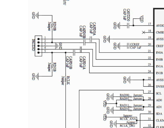

I figured out that the open Input pins generate the noise. As you can see in the picture, I had only connected IN0A and IN0B, connecting IN1 to a source removes the noise. The board will be used in an active speaker, therefore this should not be an issue, since it will be connected to a source anyway. I did some tests with cable lengths and audible noise starts above 3 m with simple 2x1mm2 wires.
Is it recommended to put in resistors between the inputs and ground? I guess this should help if no input is connected

I ran into the same problem.I figured out that the open Input pins generate the noise. As you can see in the picture, I had only connected IN0A and IN0B, connecting IN1 to a source removes the noise. The board will be used in an active speaker, therefore this should not be an issue, since it will be connected to a source anyway. I did some tests with cable lengths and audible noise starts above 3 m with simple 2x1mm2 wires.
I have a scope, but I don't think I can measure THD with it. I've heard that it can be done with the ARTA measurement box, should I build one?

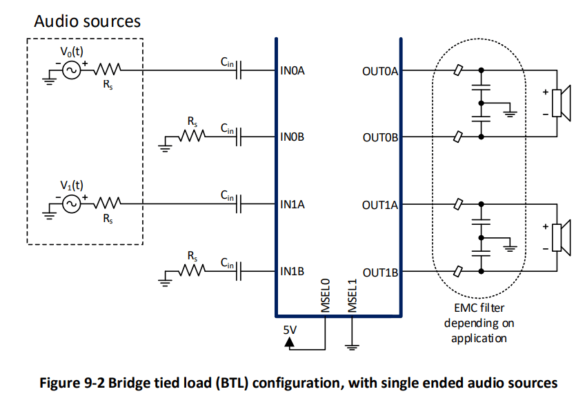

If the input is used as an unbalanced input using IN0A and IN1A, noise will occur when the input is open. I stopped connecting IN0B and IN1B directly to GND and tried various things such as grounding with a resistor, but it did not improve.
Eventually I added an op amp to the input.
This noise does not occur when the input is used with a balanced connection of IN0A-IN0B / IN1A-IN1B.
that's exactly what I noticed. I looked up the datasheet (page 22) and it states, that IN0B and IN1B should be tied to ground with a resistor Rs.This noise does not occur when the input is used with a balanced connection of IN0A-IN0B / IN1A-IN1B.
The application example (page 8) shows the Resistors RIN0B and RIN1B, but it is not included in the BOM. Maybe a 10k ?

The op amp I used is NE5532.that's exactly what I noticed. I looked up the datasheet (page 22) and it states, that IN0B and IN1B should be tied to ground with a resistor Rs.

Infineon's output filter description is a countermeasure against high frequency noise related to EMC, and is probably different from the noise you are currently looking at as a problem.That's right, but read cerfully this document, please. :
