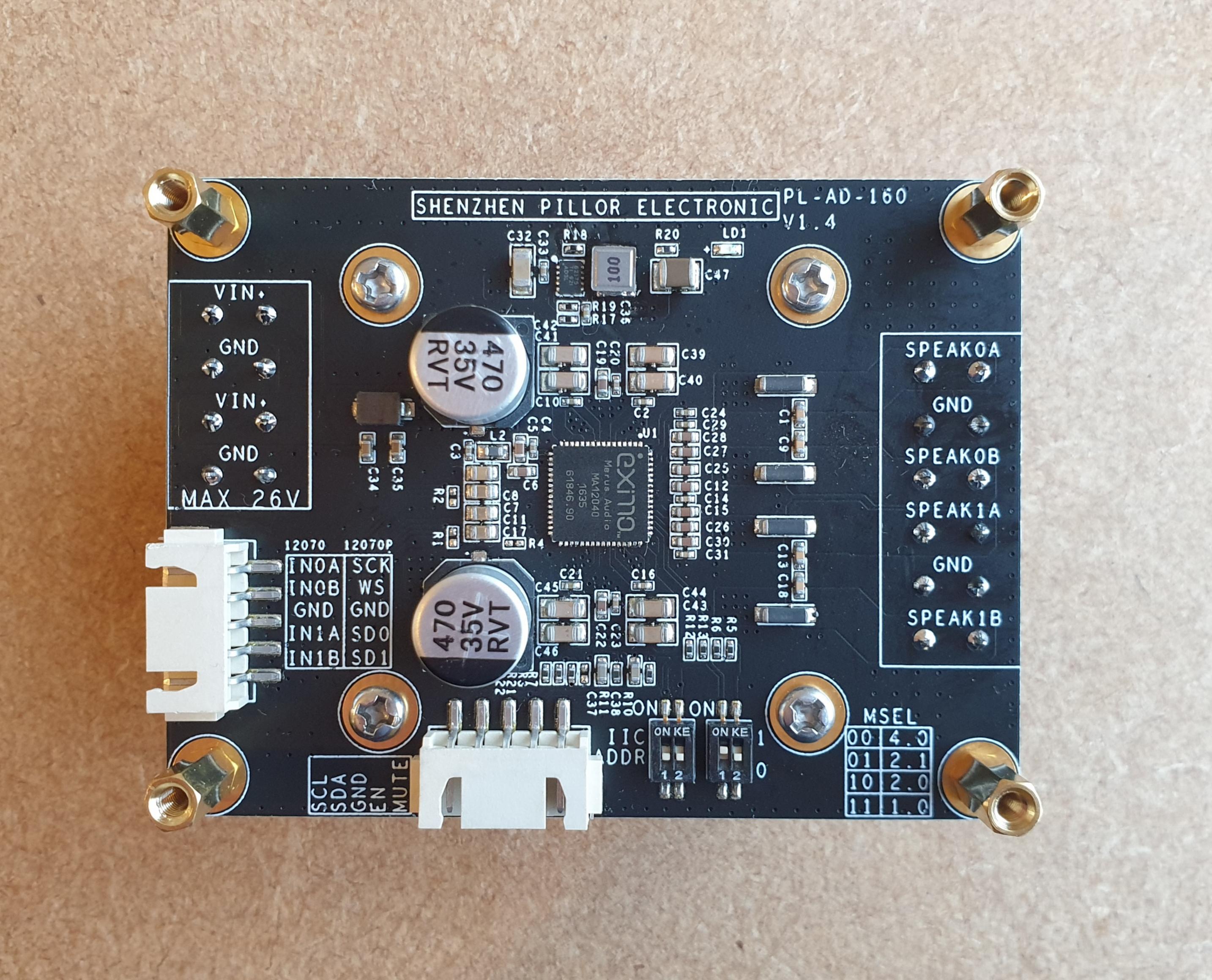

DATA to SD0can I put an i2s signal directly on its input? I use Amanero.
Amanero Outputs: data, bclk,lrck,mlck, grn
ma127070 inputs: sck,ws,grn.sd0,sd1
BCLK to SCK (bit clock)
LRCK to WS (word clock)
GND to GND
MCLK would normally go to CLK input, but I don't see a connection for this, so I think the board is configured to just use bit clock.
DATA to SD0
GND to GND
I know nothing about the amanero board, but...
Hopefully the BCLK is a valid frequency (the MA12070P is a little finicky).
Will you have an I2C connection to the board to access/change the MA12070P registers? If not, you will need to flash the amenero board to match the MA12070P defaults of left justified and 32 bit.
I would assume the EN and MUTE pins are floating. To play, EN needs to be grounded and MUTE pulled high using the 3.3V output from your amenaro.
For BTL, verify the MSEL0 is 1 and MSEL1 is 0.
I hope I have all that right. Good Luck!
Mike
thanks Mike, Linuxfan.
I'm trying to connect and modify i2c. If it doesn’t go, I need to order an original amanero board and modify the firmware. I am now using a Chinese clon amanero board. this cannot be updated, just spoiled.
DATA to SD0
GND to GND
Yes ,the board is configured to just use bit clock.

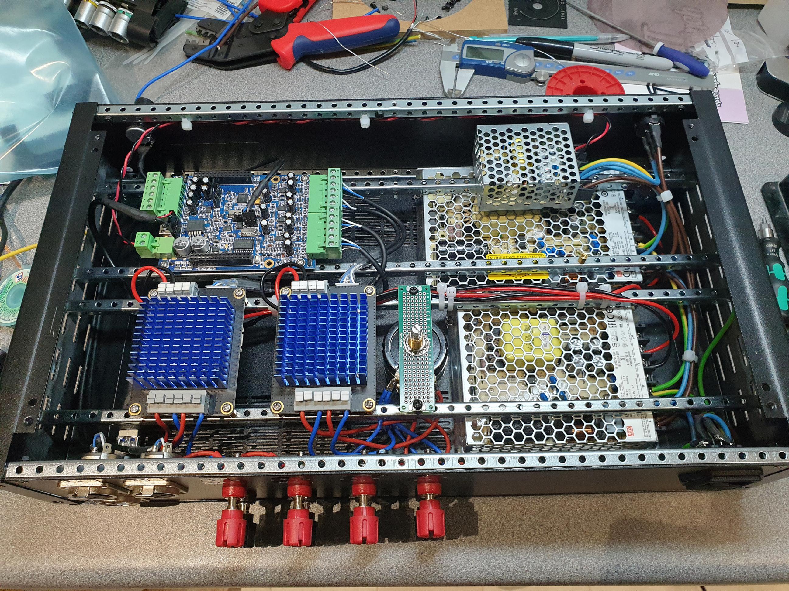

Hi Michael et al,
Can you clear something up regarding the MA12040 board I have, please?
As detailed in my thread (Workshop Co-ax Mini Bangers - B&C 5CXN44) I have put together a 4 channel amp from 2 bvoards. One MA12070 with 24v/150w PSU and one MA12040 with 18v/100w PSU.

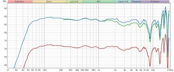

When I did distortion tests on my speaker I noticed that the tweeter powered by the MA12040 board (crossed at 18k) lagged behind by 2db output.
It's very confusing, should this MA12040 board actually be powered by 24v? Is this the caused for the difference in behaviour?
- Red is level I designed the crossover at
- Green is the level I tested disortion at
- Blue is the same as the red but lined up with the distortion test to show the discrepency

Hi ,
For MA12040 the max voltage supplly is 18V, so you can't supply with 24V absolutly. If you want test this two ICs in the same condition, you can supply with 18V both.
From the two datasheets, it shows some wispy different originaly. And I think MA12040 is the rest form product line test. If it pass all of the test so marked with MA12070, if it failed with some test item it marked with MA12040(Just my guess). So it will have some different parameter like internal power MOS Rdson and so on.

Both chips are 20 dB gain in their default configuration, but you can easily measure the gain of each at 1 KHz to verify. Other than than that I would investigate you woofer & tweeter frequency response (FR) measurements and your SigmaStudio program.
(In case you didn't know): SigmaStudio normalizes FR measurements when you load them. For example, let's say your tweeter measurement is 5 dB higher in SPL than your woofer measurement. Re-check them after you load them into SigmaStudio - they'll both have the same max SPL (usually + 5 dB). So you need to adjust the tweeter level in SigmaStudio for that.
Thanks Michael and Ed.
My thoughts were that there was some sort of throttling from an underpowered PSU but my understanding of this isn't top notch - obviously 🙂
Michael, that is very confusing. When I first got the PL-AD-160 board with the MA12040 IC I wrote it off as an unusable unit but after testing with 18v and it worked fine I thought different. However, I don't quite understand how a seemingly identical board would work with a younger sibling so well. The silk screen reads max voltage to be 26v. I wondered if there were some sort of voltage regulation for the MA12040 I can't see?
Ed, yes, this was my first thought that it was a DSP issue however, I am using a MiniDSP and doubled checked the compressor settings. I haven't had any issues like this in the past with this unit.
The chin scratching continues.

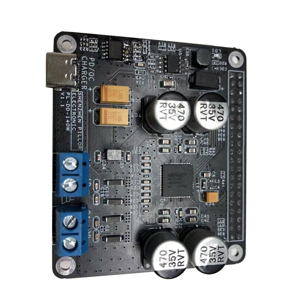

Has anyone changed the gain with I2C yet?
Hi Folks, I hope you are doing great, I have a question for you, I was giving a look to the Raspberry variant PL-DD-140W, this board has two fixed output connectors for stereo configuration (2X80W), but I was wondering if this one may be 2.1 configurable, I did not see any pin selector like in the PL-AD-160W.
I will appreciate any help you can provide.

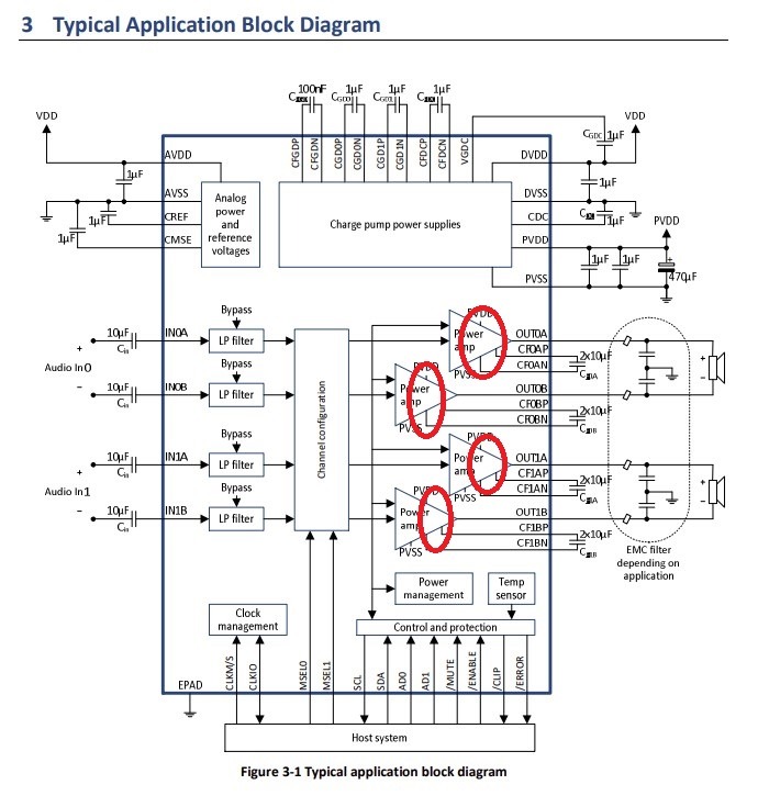

I mean the output transistors in the output stage on this block diagram of the "chip". They could be GAN Fets?
Or you know Infineon make their own fet output devices.

MA12070(P) and MA12040(P) family does not use GaN. Actually it also doesn’t use SiC. It uses a so-called BCD process which includes Bipolar, CMOS and DMOS technology in one process.I mean the output transistors in the output stage on this block diagram of the "chip". They could be GAN Fets?
