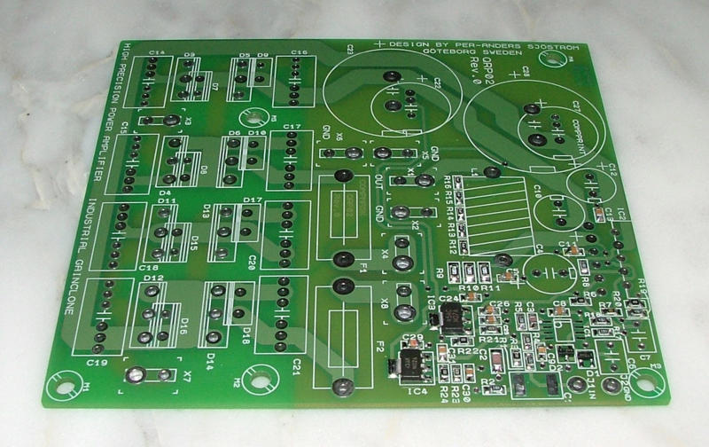

Hi P-A
This is were I am so far (see picture). I'm still missing C1, C6, C7 and C14 --- C21. Ordered those from Elfa and they should have arrived yesterday, but they didn't. I'm going to proceed now with the "magnificent custom made P-A coil", diodes, fuseholders and the electrolytic cap's C4, C10 and C12.
Cheers
Walter

Looks good! A proof of that it isn't so hard after all to solder this.GeWa said:Hi P-A
